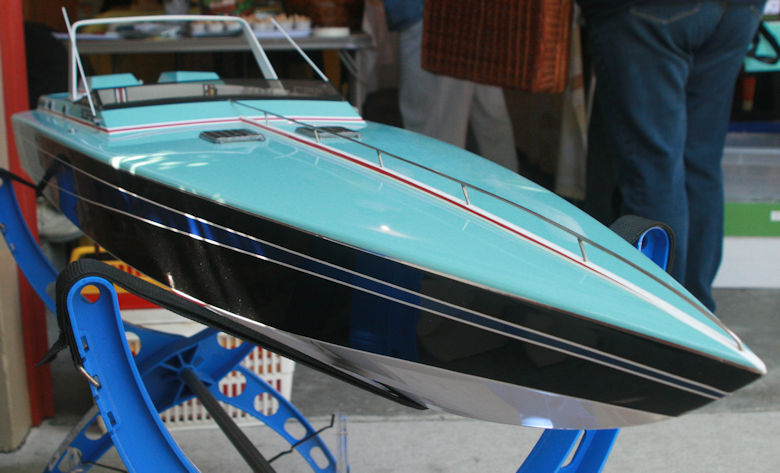

OK, I'm sure you are wondering what the @^%$*& is this greenhorn doing starting on this monster of a kit? Well, I built tons of kits as a kid and when I was in college I built Revell's Cutty Sark and the Thermopylae, both fully rigged. Then, about 15 years ago, I bought the Scarab 38KV kit from Dumas boats. For those of you who don't know, this is a radio controlled model of a 38 ft Wellcraft Scarab racing boat. Those of you who remember 'Miami Vice" - well, this was Don Johnson's boat. It took me several years and a couple thousand dollars, but I did turn this into the Miami Vice boat. It was 60 inches in length, powered by a 15 CC gas/nitro racing engine, and topped out at about 35 MPH (actual). I know this is supposed to be the start of a build log of a battlewagon, but I'd like to take a minute and show you a few pics of this Scarab I built. Frankly, I'm quite proud of it.
As you can see, I painted it exactly like the Miami Vice boat. In the next post I'll show you a few more pics and then get into my thoughts on why I'm tackling this "Monster Mo".

Hello & welcome,Larry.Nice Scarab. :thumbs_up_1:

Larry, welcome aboard! Your Scarab is very impressive. I'd like to see some footage of her running at speed. And so you'll have your nomenclature right, around here it isn't "greenhorn", its "newbie" or "noob".

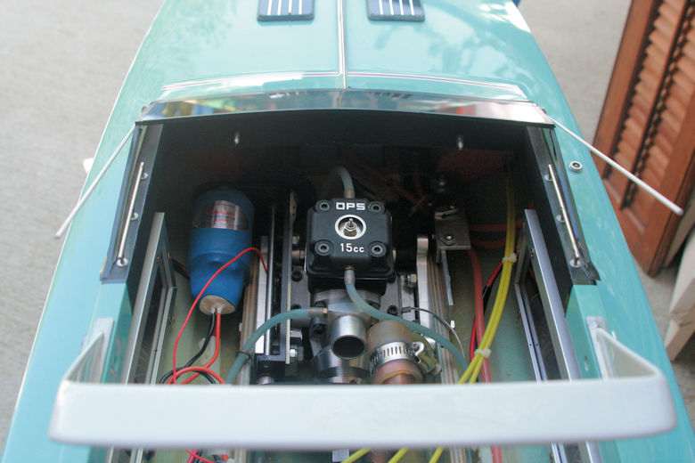

At the end of my last post I said I’d show you what was “under the hood” of my Scarab. Lets, take a look and then we’ll get to the real purpose of this thread – Battle Wagons, or more specifically, the “Monster Mo”, as I’ve named this beast.
Here’s the Scarab with the cockpit off. A couple things of note: I found this guy out east who made me an electric on-board starter for the engine. It connected to the output shaft of the engine by means of a belt-driven one-way clutch gear and was powered by 24 “C” size rechargeable Ni-Cads. You can see the cases for these batteries on either side of the inside of the hull. Not only did they power the starter, they also added just enough weight so that the stern sat down in the water at just the right depth.
The attachment Web04.JPG is no longer available
The second thing to note is that I had the engine exhaust routed through a muffler and then to a manifold made from copper water pipe that exited through the 4 exhaust pipes at the stern. Plus, I also soldered nipples onto this manifold and ran the engine cooling water out these same 4 exhaust pipes, just like the real boat. Not to brag, but the effect was awesome!

Gee, I don't know what happened to the two missing photos, but they still exist on my computer!
Here they are!

Neat Scarab Larry:
I am not into RC but I can sure appreciate the effort and craftsmanship that went into this model. The finish is truly outstanding.
