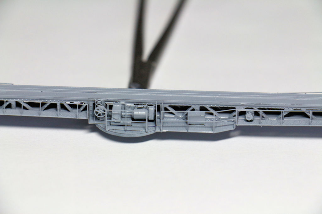

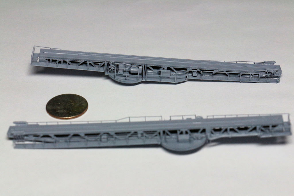

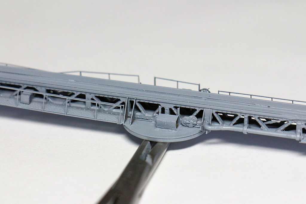

OK, you gents like pictures, so here are a few. The first ones are the catapults. Dang little critters are sure delicate. Ya can't hardly pick them up without bending a railing (or two). And by the way, the coin is a US dime - placed there to give you an idea of the relative size.

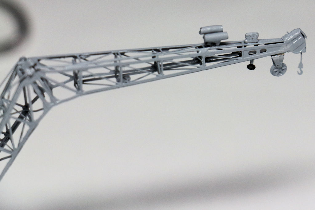

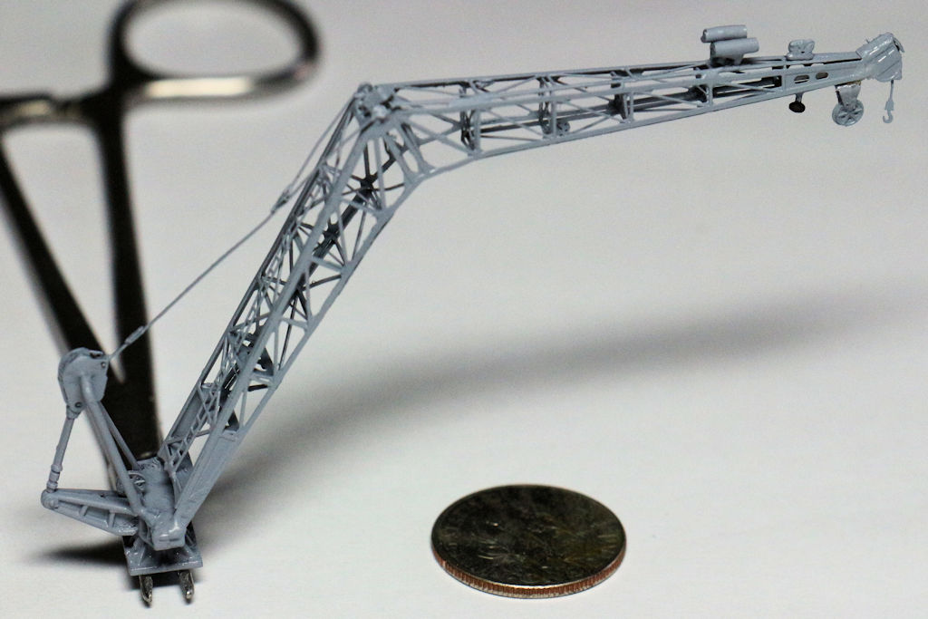

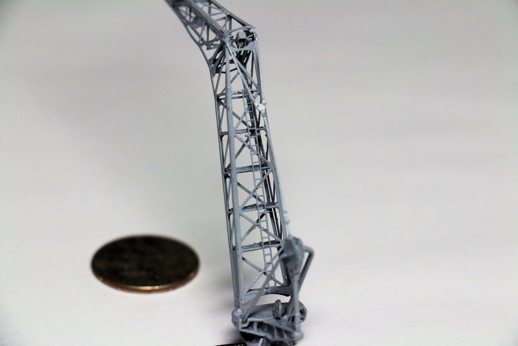

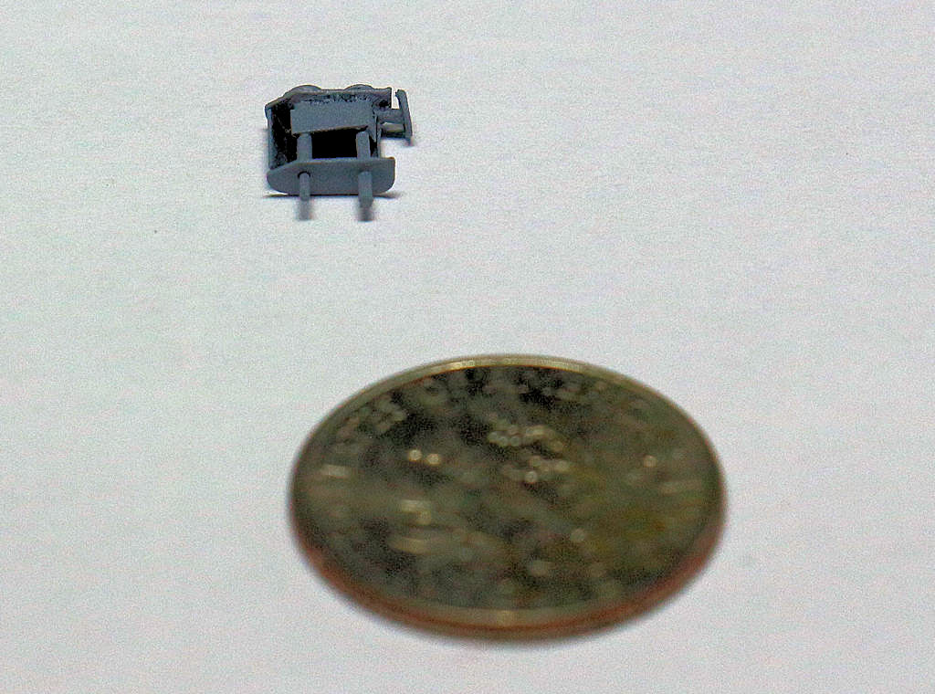

Here's the Crane.

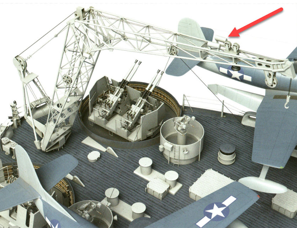

I really don't like the plastic dual upper pulleys that comes with the ship kit. It makes a very nice looking part look bad. I'm going to keep my eyes open for something else I can use to replace this clunky looking part. You also might wonder about the two cylindrical looking parts on top of the crane. I have no idea what they are, but they appear on TFD's plans and in their plan book on this ship. They also show up in Stefan Dramnski's book of 3-Drawings of this ship
I'm not sure how many photos you can have in one post, so I'm going to break this up into 2 posts. More to follow -

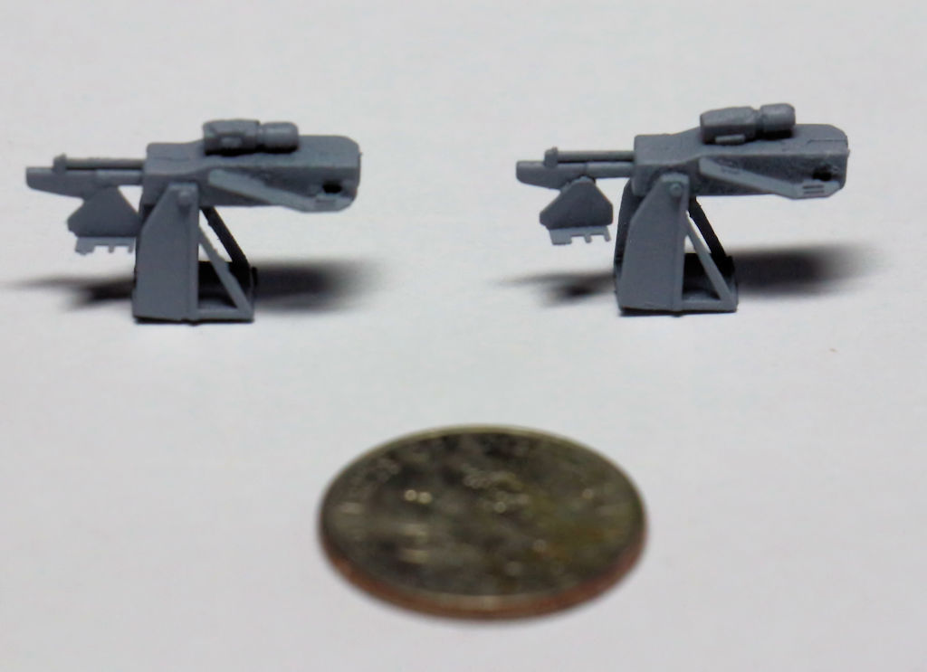

Next comes the two 5" dummy loaders. I'm surprised that the Pontos kits for this model doesn't provide any added parts for these. The 2 pieces of PE used on each loader comes from the kit itself.

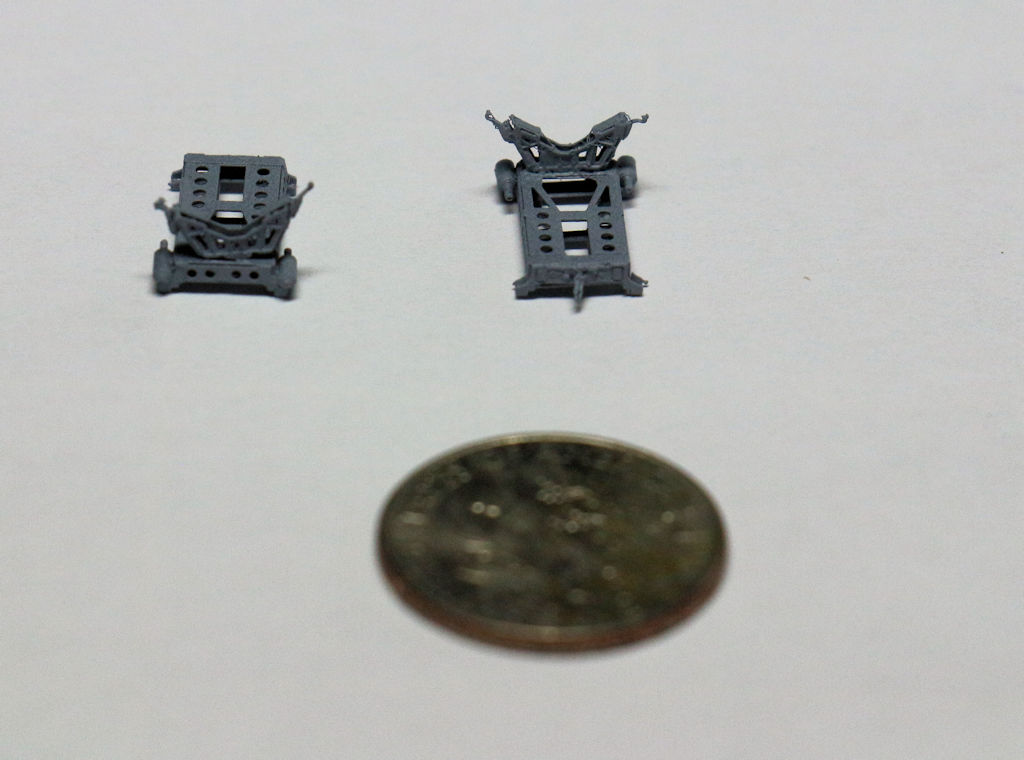

Here are the load carts for the catapults. I said earlier I wasn't going to put the tow bars on them. I lied. I also have a dummy car done, but I don't see a lot of point in showing it here.

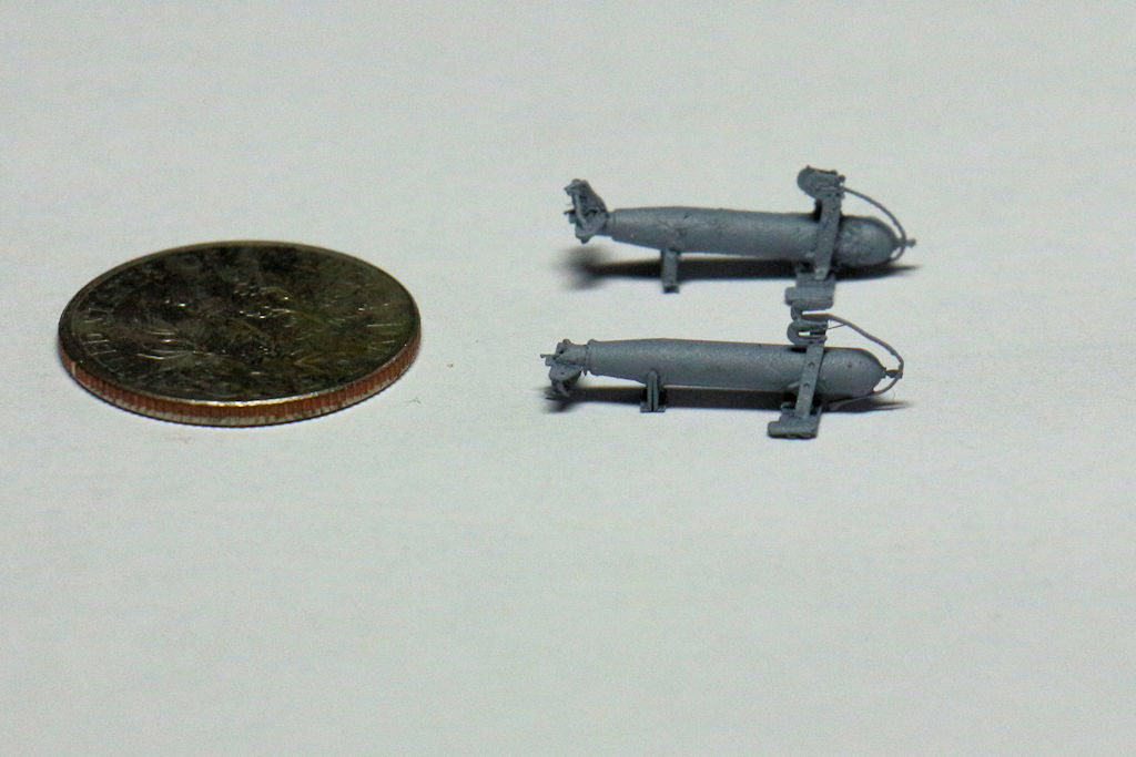

Here are the Paravanes. These were really nasty little buggers - to me anyway!

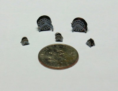

And last, here's the cable reels. For the bigger ones, I used fine copper wire I got from a coil out of an old TV set I tore apart. For the small ones, I wrapped a couple layers of this same wire around a toothpick and after I painted it black, I coated it with clear Krylon to keep it from unraveling when I cut it into small pieces.

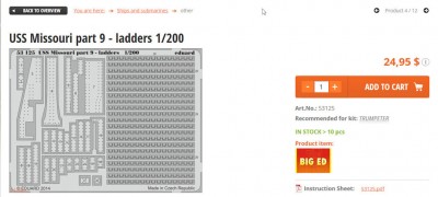

I'm getting ready to do some stuff to the outside of the hull. I've noticed on pictures of the real ships that all the individual handholds (ladders) are bent down.
So, I bought a sheet of parts that you can bend from Eduard. One sheet looks like it will be enough to do the entire ship. Then I have to figure out a way to put the anti-corrosion bars on the rudders and shaft supports, etc...........

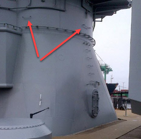

Larry,
!st - Very nice work!!! Your model is coming along really well.
One comment here - while you are correct in that the hand rungs are bent and the Eduard set reflects this, I think it would be advisable if you used photos of the ship for reference from the time period you are building her - not modern photos which may or may not reflect the ship in your build. Here is a photo of MISSOURI in 1944 showing the bridge WITHOUT those hand rungs:
Hope this helps!

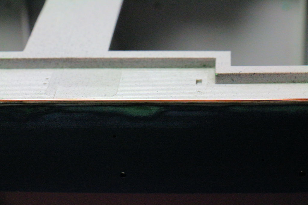

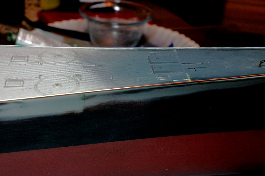

Now, for those of you who are crazy enough to attempt to add a lip to the top edge of the hull and then top it with wire to achieve an added element of realism, I have a couple comments and suggestions.
1: If at all possible, do this before your final finishing of the hull. With all the sanding and handling of the hull, I guarantee you, you will mess up your paint job.
2: Be prepared for a LOT of filling, sanding, filling, sanding, filling......... No matter how careful you are the seam between the top edge of the hull and the strip you add to the top will need to be filled and sanded. I used Squadron Green putty and wet sanded with 600 grit wet/dry paper. Then I reglued the places that sanding broke loose and did it again. And again. And again.
3: Don't be in a hurry gluing the strip in place. Patience is a virtue here. Go slow, and if it doesn't look right, cut the strip out and do it over. I used Evergreen #00101 styrene strip (.010" thick and .030" high). This gave me a scale lip of 6", which is slightly more than actual, ( I think about 5"), but it's the best I can do.
4: Make sure your wire is straight. I used .020" copper wire and put one end in a vise and stretched the wire until I felt it give as it shrunk slightly in diameter, leaving me with a perfectly straight length with no kinks or irregularities.
5. When gluing the wire, work slowly and carefully. Do about 2 inches at a time, holding the wire in place until the glue sets. I use Gorilla brand super glue (not the gel) and apply it with one of my wife's sewing needle that I've filed down to a sharp point.
The whole process is a big pain in the you-know-what, but the results are worth it. Like anything on a model of this size, patience is the key to making all this added detail look good. Here's a few shots of where I'm at now. I have the wire glued down on one side, but not the other yet. Still have some filing and sanding to do first.
It really does screw up any painting you've already done!
Take your time and realize this isn't going to be done in one evening
The wire goes on fairly easy if it's straight and free of kinks. Put one end in a vise and stretch it till it's straight.
The hardest part is gluing the styrene strip to the top of the hull. Lots of puttying and sanding. Here, I'll use a needle file to get the corner clean before I glue down the wire.

That's the one thing I didn't like about my hull. Every picture of the real ships has that rounded lip. Now you go and do it.....crazy!
That's some serious patience and smooth work. Definitely will be looking the part once you've finished. :cool_2:

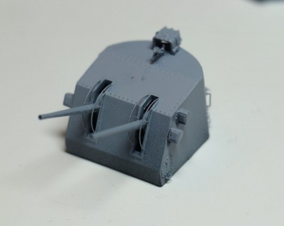

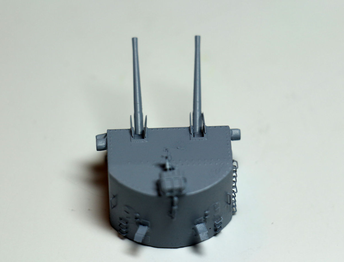

I did assemble (1) 5" turret with all the brass detail to see how it went together. It was OK, at best. I started out using the Eduard grab irons as I planned to bend them downward like the real ones. Well, they were so thin and flimsy that even with tweezers I had an impossible time with them. After fighting with them over a couple days (and ruining 8 to attach 6) I decided to give up with the bending idea and use the ones from Pontos. These are more sturdy, but the hole spacing is sightly different from Eduard's, which brought on a whole nother set of problems! The final result leaves a bit to be desired, but this gun will be placed on the opposite side of the ship so it won't be so obvious. Live and learn, I guess.

Is there ANYTHING on this ship that isn't difficult? I finally finished five of the 5" gun platforms - only 5 more to go. The first one took me close to 8 hours because of a big screwup, but each one went a little bit better as I gradually figured out how to build them. The grab irons aren't perfect, but with my 75 year old eyes and fingers, in my opinion they're just dandy.
