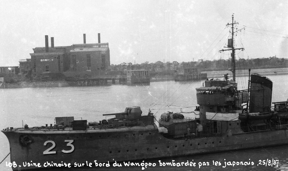

You seem off to a good start. I responded to your CASF Minekaze/Kamikaze/Mutsuki class question.
That first link is to the Vanguard site is highly recommended.
While there may not be a lot of photos of Satsuki, there are a lot of good photos of many of her sisters from the late 1930s in the modernized fit, which is essentially the same as '41/'42, save for the addition of degaussing cables and some 25mm AA for some ships.
Building techniques aside, good references are very helpful. Here's a good view of a modernized sister, unidentified.

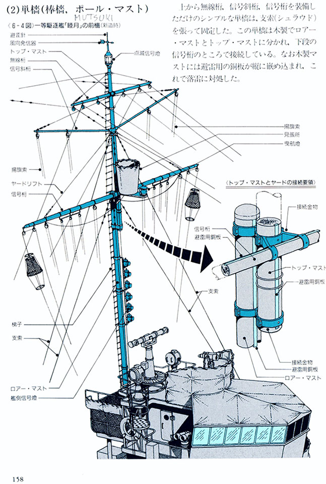

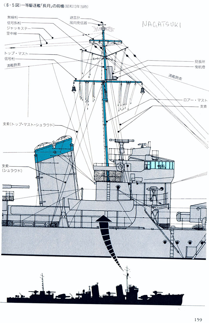

Im not sure why, but all the builds Ive seen of Mutsuki class did not bend the angled part of the mast backwards a bit, as there are photos which clearly show them angled a bit towards the back, like the one Dan posted above.
The upper yardarms rarely aligned in a 90* angle perpendicular to the hull. The halyards would get tangled up in the lines from the main spar below. In 1/700, it's just cheaper to make a mold with those upper yardarms sticking straight out in line with the ones under it. Brass rod replacement is really the way to go, as you have figured out.
to install the main mast onto the back of the bridge, how deep do I have to drill down usually?
Well, if the drill bit is thin enough, 2mm deep and mast secured with CA glue is preferred. Shallower is fine as long as there isn't much rigging stress upon the mast. Speaking of which, some details to aid you below.
Just fyi, the single guns mounted to either side of the bridge in 1941/42 were either 7.7 or 13mm machine guns The 25mmAA came later. That said, I can't recall the smaller mounts being available in PE. FineMolds does make nice 13mm single mounts in styrene plastic.

One other thing about building masts:
I have discovered that a lot of the Yardarms were rectangular in cross-section.
And that attaching them to the mast is made easier by filing a small notch into the mast and yardarm so that they can slightly interlock (unless you want to spend $80 on making a set of Photoetched brackets that the yardarm and mast slide into to create an interlocking joint).
Also, using a drill and a file or piece of sandpaper to taper the mast and yardarms really does help to make the mast look more realistic.
I have become very skeptical of these Photo Etched masts, which are too flimsy.
MB

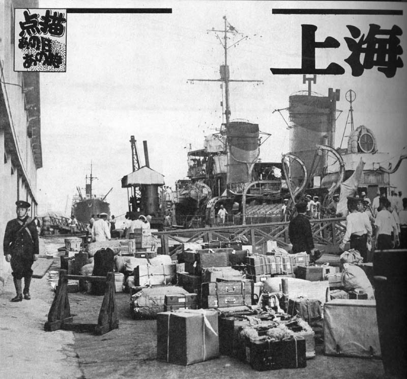

When were the loop antenna installed? on the 1937 picture of Satsuki I can see something that might resemble it in the place where I assumed it will be at, but in my photo of Satsuki(with the yellow circles) it doesnt show them installed
Mikazuchi seems like it has the room behind funnel #2 like Minazuki, but from what I can see Yayoi doesn't.
Ill probably just put the loop antenna right in front of the searchlight. One issue though, it wont be tall enough :P but that's my problem to fix.
Posts: 9073
Re: 1/700 IJN Satsuki(from Pitroad Mutsuki)
Post by Dan K »

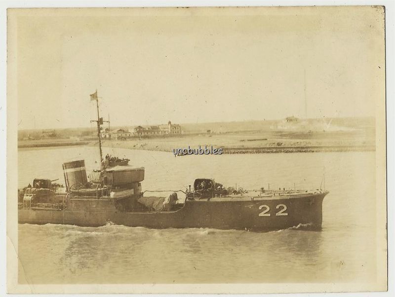

The RDF loops weren't installed until the late 1930s. That compartment also holds the emergency/auxiliary steering and compass. Originally, that equipment was placed onto top on the platform, but subsequently relocated inside during the refits/rebuild of the mid 1930s.
To help distinguish between as-built and the modernized versions, note that the as-built ships have flatter topped funnels and a triangular shaped compass bridge deck with a canvas covering. They were rebuilt with a compass bridge deck showing a rounded facing, a steel top to the bridge, and much more rake to the funnel tops. If you look closely at those two GPS illustrations of Nagatsuki, the first one is of her as built; the second is as modernized.
Or, if you compare the very first photo that I posted of the unidentified Mutsuki class ship, it is modernized (and likely Kikuzuki), versus this as -built photo of Fumizuki.

On a side note, I believe your attached image is most likely Satsuki mislabeled as Fumizuki, as the latter was part of the 30th DDiv, while Satsuki was in the 22nd and had one bar on her 1st funnel.

You are probably right about the mislabeling. Can't recall my notes on this photo.
The other big difference between as-built and as-modernized is the addition of the shielding to the torpedo tube mount for the latter.
