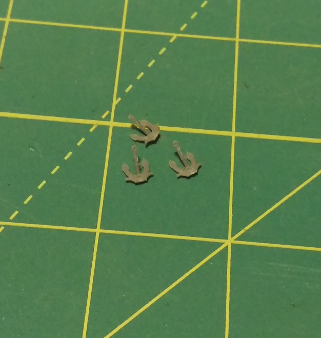

File comment: The anchors. Normally I would not both posting these except to say that sanding these without marring up the detail SUCKED!

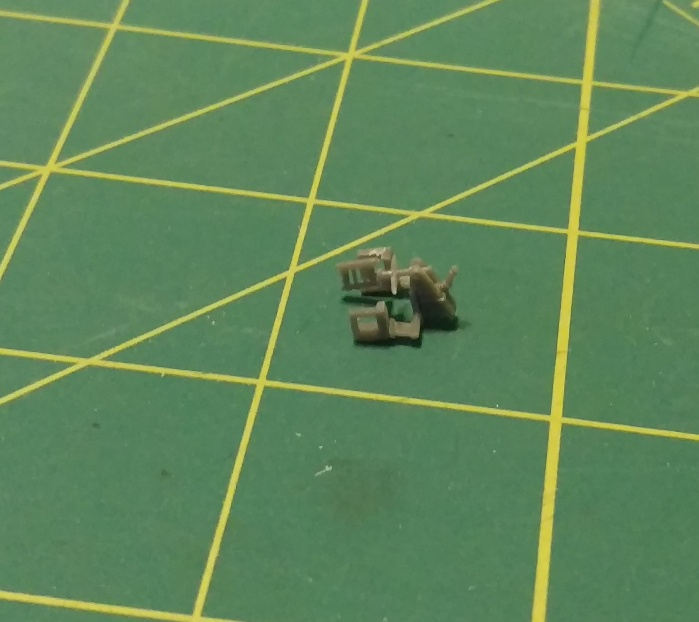

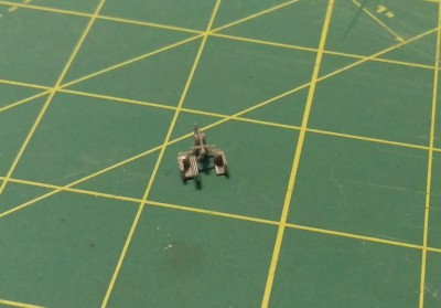

File comment: I think this is supposed to be a practice loader. With seven parts and suspect attachment points this thing was also interesting to put together....(as in Chinese Proverb - interesting)

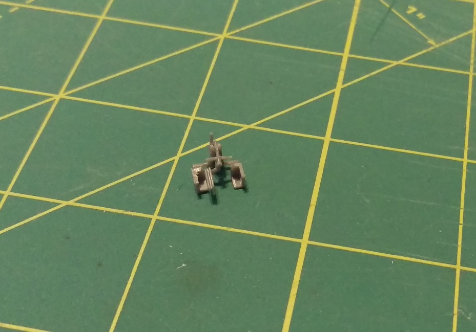

File comment: Different view

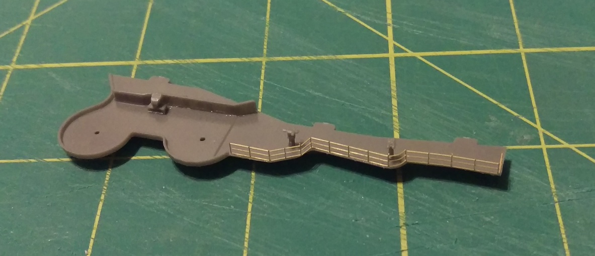

File comment: This is the gun gallery that would be just below the flight deck and just forward the funnels. I am very pleased with how the railing turned out on this. Suggestion: This is one continuous piece of railing from the set. Do the curved segment first. The rest have predetermined bend points that make it really easy.

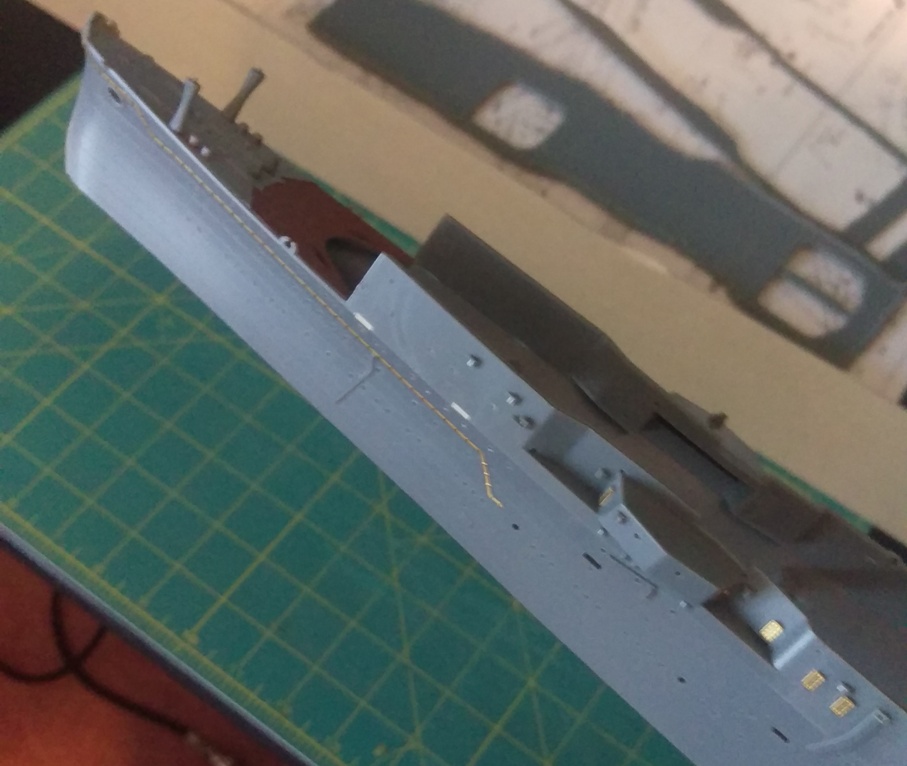

I have added most of the bits and bobs to the hull. The catwalks and gun platforms still need to be done. I am starting on the degaussing cable next. Not much to show that is noticeable enough to post pics of though.
For part M10 (there are several of them) they do not have a connection point on the kit. So you are stuck eyeballing it. Same with the flood lights for the flight deck. Rather annoying. The support beams for the front section of the flightdeck have two minor issues: First, the locator pins are too big for the foc'sle deck guide holes. Drill them out a skosh. Second, there is nothing to indicate proper orientation. You will need to match it with the flight deck and kind of eyeball it.

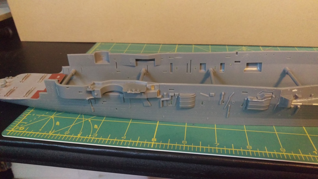

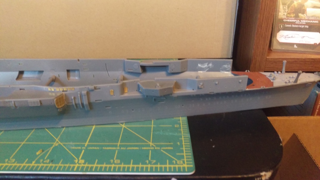

Hey look! Something to show for some of the work. Other bits and bobs on sub assemblies were also done but no pictures of those at the moment. But I have started the part that I am questioning my sanity for attempting to do it this way....the flight deck.

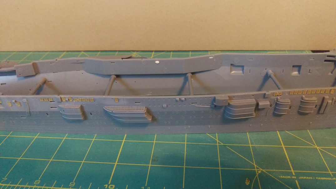

File comment: Some of the smaller pieces added to the starboard side.
File comment: More on starboard
File comment: starboard including bow

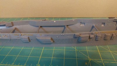

File comment: I started the port side degaussing cable and realized that there are still parts to add. So work on the cable stopped at the moment.

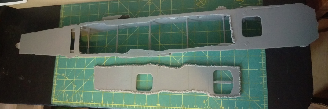

File comment: After spending too long with too little accomplished using a file, I braved the dremel on it's lowest setting and really took my time. Edge cleanup will need to be done on the remainder of the deck still but the majority of the cutting out is done.

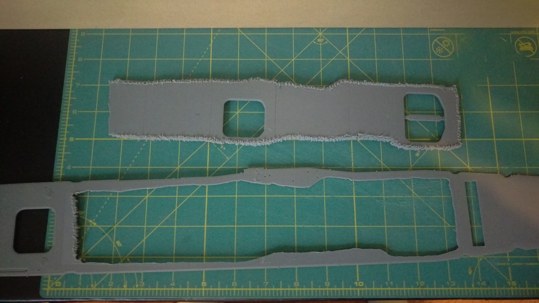

File comment: And this is test fit on top of the hull.

If that hole were placed a bit differently you'd have a good start for this!
Good progress - mine's all been digital this week.
I thought about making some smart reference to that, but could not come up with anything decent :smallsmile:
Starting to sand down the rest of the planking now. Once I have that done I will fit a piece of sheet styrene to match the hole. That is what the wood deck will eventually attach to.

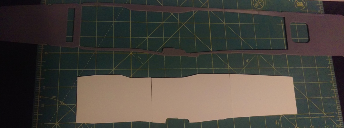

Some work has been done on the deck. First attempt on the styrene was scrapped. Second attempt already showing much better progress. I am hoping to get some photos of this before the end of the weekend to show everyone.
Gabriel
