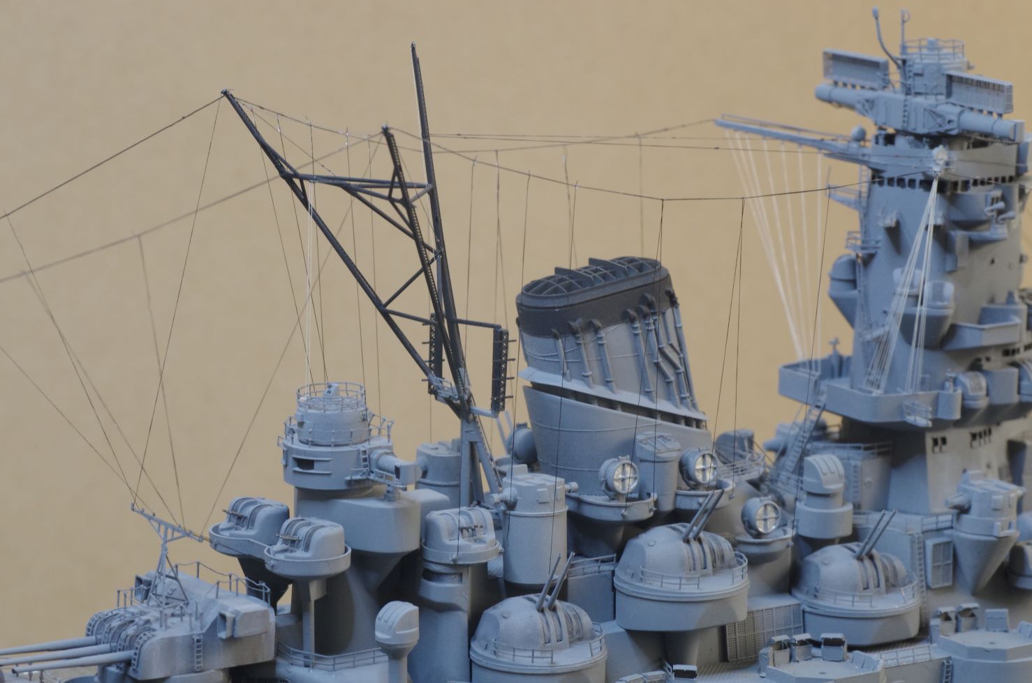

This model has been recently finished, but if the Moderators allow, I will now afterwards write a short build history. Due to persistent health issues, this project took longer than planned. And as most of Yamato class fans know, this version is not the best model from Tamiya (in many cases historically incorrect plus poor quality in many parts), probably due to lower technology level during 1970s & 1980s.
This was actually the first kit I bought when I decided to restart this great hobby. But after doing some research in the web and seeing the quality of todays modelling (eg. masterpieces from my fellow Finnish modeller "Koppalakki"), I decided that I needed some practise before I can tackle this monster. Also, it is easy to say now, that if I had known that Very Fire is going to release their new version of Musashi, I would never had bought the old Tamiya kit. Furthermore, I made the mistake of buying Eduard's PE sets instead of Flyhawks (or Pontos) comprehensive set. So, in the end I had to purchase several generic PE sets from Flyhawk, FStar, Infini and Tamiya, which was even more expensive. Additionally, I purchased a wooden deck from Pontos, binocular set from Bunker Studio, barrels from Aber plus used boats from Tamiya IJN Utility Boat Set and planes from Hasegawa IJN Ship-borne Seaplane Set A. Altogether there were more than 2000 PE parts plus around 200 other extras, so not a kit for beginner :cool_2: !
I will divide the story into 5 categories: Hull + Deck & superstructure + Armament + Rig + Auxiliaries, just to make it more readable. And this will not be in chronological order.

RIG
After seeing Katana's comprehensive study of the Yamato rigging, I was a bit afraid to start the job. In the end I decided to do a rather simple version since the target of this build was never to reach any award winning level. If I remember correctly, I used three different kind of thread: AK Interactive's Thin for the longitudinal wires & Ultra thin for the verticals plus Infini's Super Fine white for the halyards. I also added some white cylinderical insulators & brown ball insulators (some white glue + paint). Despite having a few disasters, the end results was quite ok.
File comment: I added the white halyards for the command tower already before glueing the tower into the deck. I think it was easier this way.
File comment: Command tower in place.
File comment: Unfortunately, Eduard set did not include brass bars for the main mast and also the radars were a bit wrong.
File comment: Mast in place and rigging in progress.
File comment: Wiring in front of the command tower done.
File comment: Midship wiring finished.
File comment: Longitudinal wires connected with the crane.
File comment: Everything ready with insulators.
