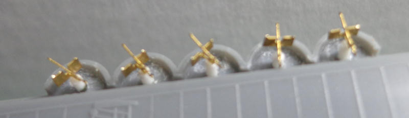

Hello, my name is Steven from Belgium and I'm going to show my 1/700 CV-5 Yorktown and destroyer build, which is already quite advanced by now. The carrier has been built up to most of the photo-etch details, I decided to use the WEM detail set because of the overscaleness of many tiny kit parts like the AA-cannons and DP-guns. Currently I'm building its escort, the USS Hammann, from the newest Tamiya waterline kit and - like some of my colleagues here - embellishing it with TMW's photo-etch. I'm very pleased that this configuration for the Yorktown has become possible by Tamiya's issuing the destroyer last year. I'll start my build log with some images of both models. The last three photos are from Hammann.

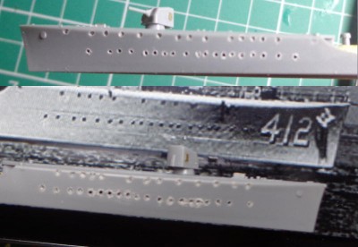

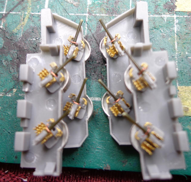

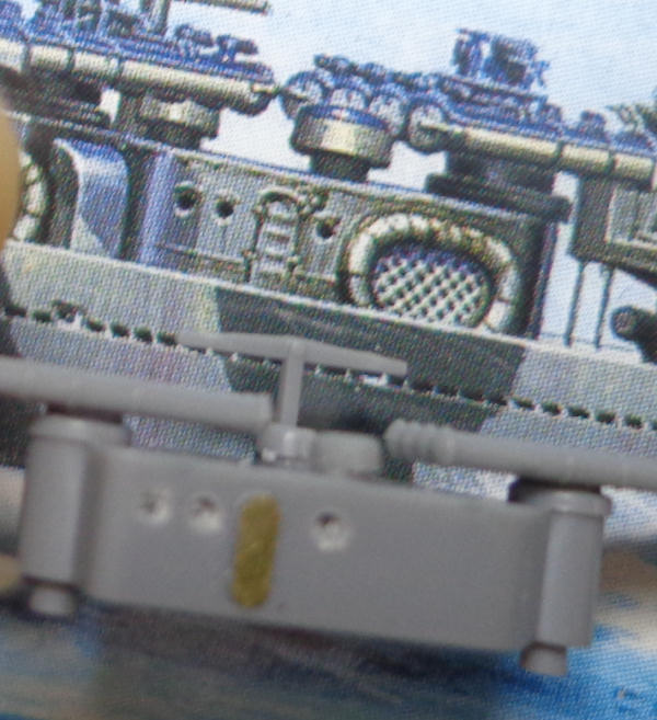

Thanks, Gordon. I'll comply to your wishes and show you an update of USS Hammann. I have been placing watertight doors and drilling the portholes on the partly undetailed hull. To complete the portholes on the bow section I had to use Wikipedia pictures of the Sims class that had been painted an overall light grey. Tamiya's box-art was almost useless on this subject, because they had omitted these portholes by splashing a giant wave over them. I only noticed their presence on an early picture of Hammann. Some had to be filled and redrilled because they were a bit off. The stern section was also undetailed and there had I started drilling. Because the propguards came loose again, I adapted them to the length of the Tamiya examples. This mistake turns out on the picture, Tom had them trimmed right. Oh well. Soon I'll be getting tangled in ends of railing and stanchions...

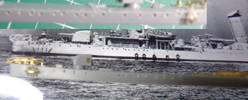

Steven, she looks very fine!
And I hate to be a bearer of bad news, but...
From this wartime photo, it appears the lower row of portholes were covered up by the time of her demise. I don't know what time period you are depicting the two ships, but with the lower row of portholes now drilled open, it seems that you can only portray them in prewar colours/fit.

Well, that is not very funny to discover, but at least it's not a terrible setback. I'll fill them up again. The picture dates from short before Midway, if I'm right. Thanks for this very valuable information, Timmy!

It took me a little while to recapitulate on the Hammann's porthole errors, but after almost 6 years and one address change I find the courage to end this project. I'm also armed with better paint provisions and some experience with waterline settings in the Princeton diorama, so I should be able to finish this in a few weeks.
I found this narrow base frame. They are quite close like this.
I had to redrill the wrong porthole row, to be able to insert the Evergreen slices. Now I only had to do a little clipping, sanding and filling up the seams.
