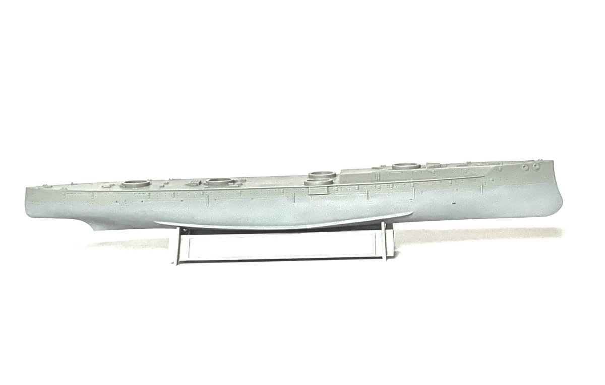

Im building Combrig's 1/700 HMS Superb of Bellerophon class.
A "production version" of HMS Dreadnought, quite good looking ship with her symmetrical profile - two tripod masts, same height funnels... So I wanted that, very much.
Im building the full hull version / which is not available out of the box. Instead I'm using a lower hull from Trumpeter's Dreadnought (Thanks to reigels here who sent it to me!).
It is not a simple conversion because Combrig's kit is a little too wide and Dreadnought hull is a little too small. So Im taking the lower hull, splicing it up to fit the contours of the deck and rebuilding it back. See below for more.
BTW - did they paint a boot topping on these early dreadnoughts?

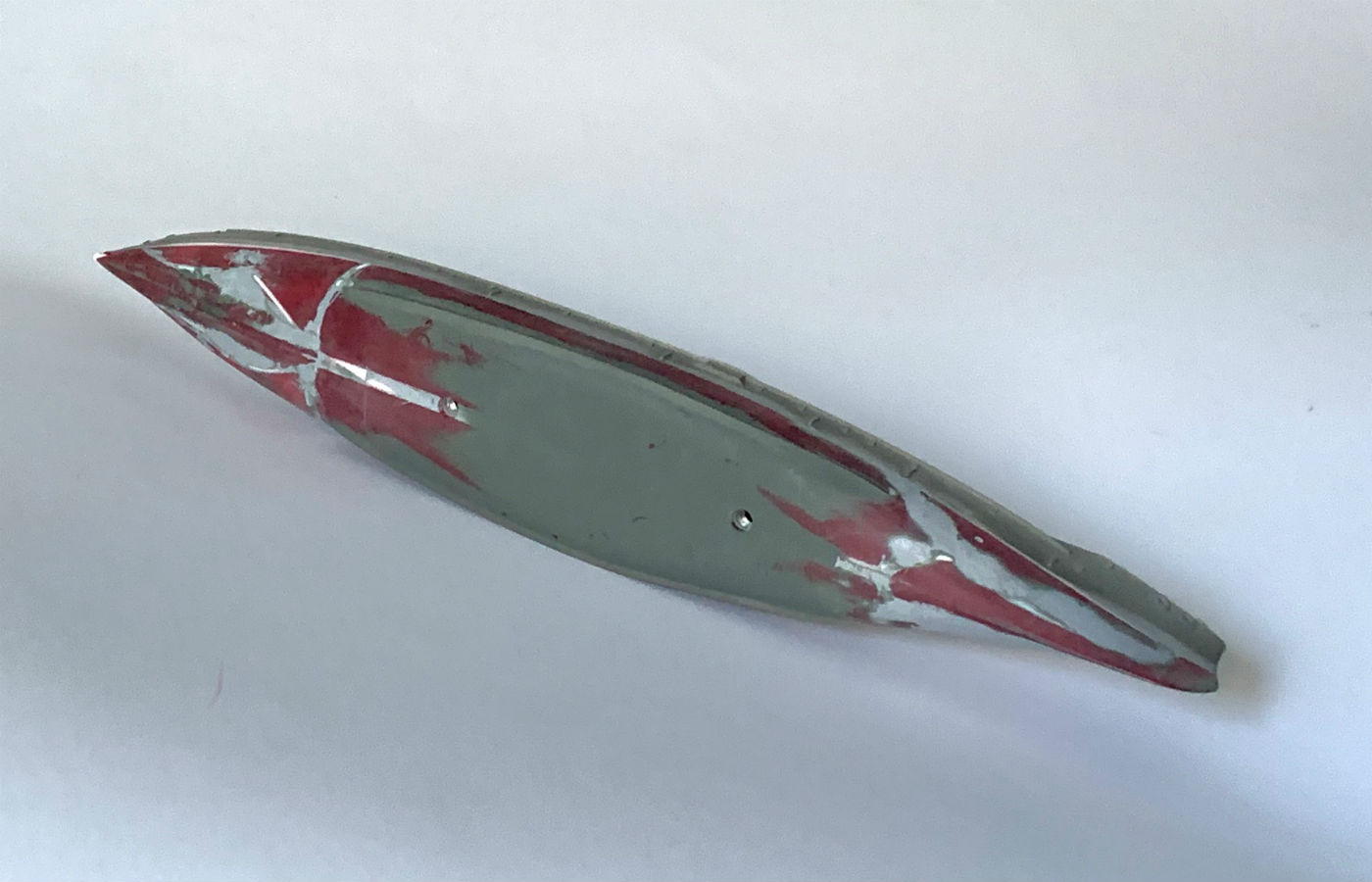

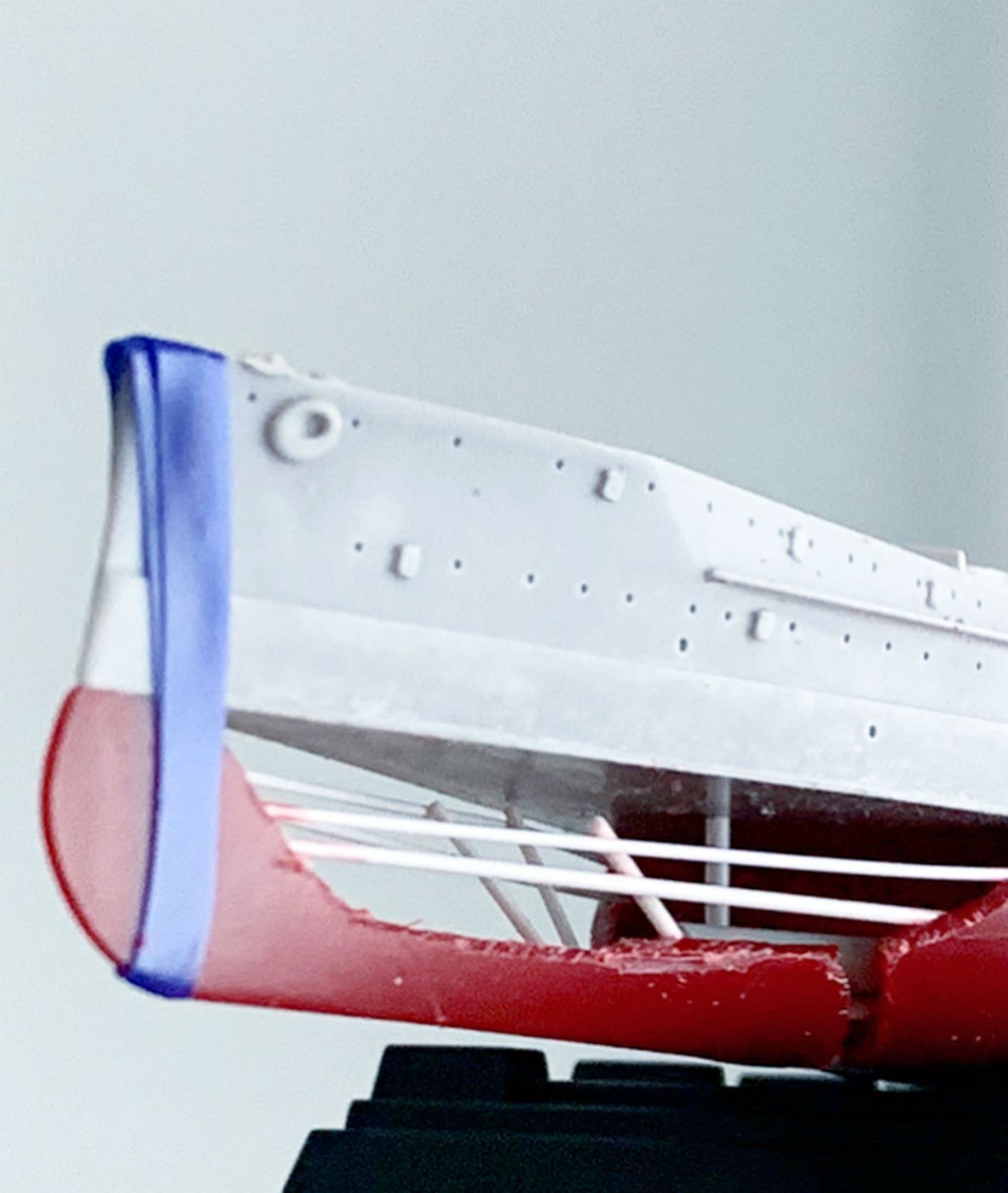

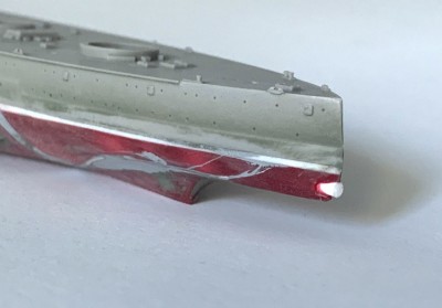

So here is some lower hull work in detail:
I used a little bit of styrene rod to create a support for the bow and stern plates. Because those rods are somewhat flexible, they allow a bit of movement when trying to fit plates as close to hull as possible without changing contours of the hull.
Im fully aware alignment will be impossible 100%, thats' that the sand paper and putty is for.

I applaud your hull surgery, the beam difference was a big hurdle to overcome but you've done a great job. Nice to see people thinking outside the box and mix-and-matching kit parts to get what they want.
I look forward to seeing her finished, I also agree that the symmetrical mast arrangement of the Bellerohpon class makes them very attractive ships (more so than Dreadnought herself :heh: ). there aren't many parts to the Combrig kit so I guess the hard part is over and the rest is plain sailing!
