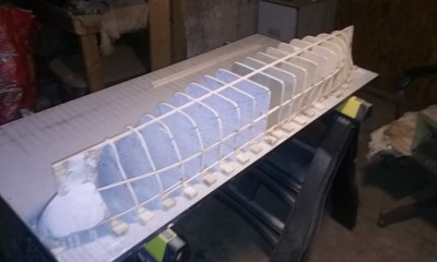

All bulkheads glued to the table using hot glue .The top stringer is the deck or sheer line .
File comment: Cut a notch in the bulkheads were the bilge keel goes .Painted them red so I will see them after mat is installed .Each hull will show were the bilge keel goes .
