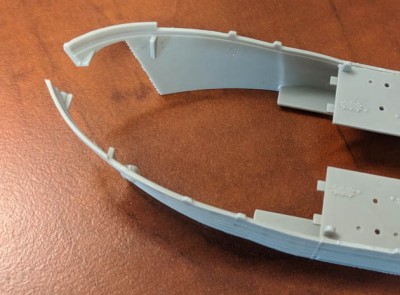

Now a bit on the hull. As you might notice, there is distortion and oil canning molded into the hull as well as some ribbing and bumpers. While LSTs did have this, it is a touch over done for my tastes. The oil canning is very well done where present, however it stops short of the stern and bow and it just looks a bit off to me. There should be less of it in these areas, but there should still be some. The box was neither too tight or loose with parts, however the bow had some visible stress discoloration and the bow is spread wide. The stern has a bit of a gusset plate so I focused on gluing that first and ignored the bow joint for now. The below photo shows the stressed plastic and how far the bow joint is spread with the main deck more or less in place:
File comment: This gives me a sudden desire to go watch "The Spy Who Loved Me."
Plan is to once again start with the stern and work my way forward. Once the hull is glued up to the bend I'll do some closer looking and work it into shape.

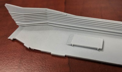

I did not get any painting done last night and might not this weekk - however I did get the lower hull about 75% glued on. It's attached up to the point of the "bend" that there was in each hull half:
I wanted to wait until the joints I had glued were fully dry before I start pushing the bow into shape. The plastic's thin enough I don't anticipate much problem, and I should be able to hold the upper forward deck in place to have upper and lower guides while the glue sets.

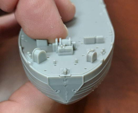

Fit is really well but one item of note I haven't really had a chance to think through for my next one. There's a doubler plate of sorts on the skegs - visible in a couple of photos here. Only the outboard side on the kt has them molded in, but anyone who gets close enough to figure this out is either going to be a contest judge or having their hand slapped for getting too close, so it's really not a big deal.
However, the doubler can give the impression of a gap at the joint that is not properly filled. I tried to show that with my photo, but it's cell-phone quality and perhaps a bit unclear. Fill it and smooth it anyway? Install the skegs on opposite sides with the plate on the inside so the step creates an illusion of a gap on the inside where no one will see it?

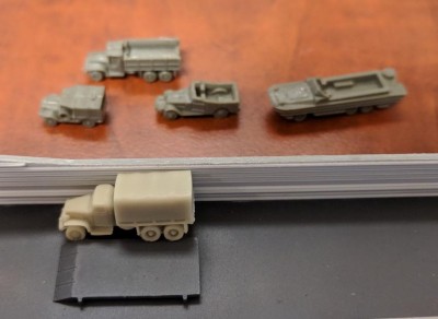

A quick update. I pulled out some old L'Arsenal GMC trucks I had (my set was all covered) as the AFV set, while nice, is essentially two each of a wide variety, which was not the usual LST load out. They are too wide, however, to fit around the elevator (aft tires are resting on top in the picture below):
The AFV club trucks are thinner and do fit, but Not with a clearance that I feel many drivers would feel comfortable with. I honestly don't know if this is L'Arsenal's fault or if the vehicles drove around or over the elevator and their dimensions are bang on. The plans show portable ramps at either end whereas the kit only has one, more permanent looking ramp. It looks like the deck to either side of the elevator platform might be too narrow for the larger trucks even in real life, but I don't have any good photos of a tank deck loaded up to know how this generally looked or how they unloaded.
