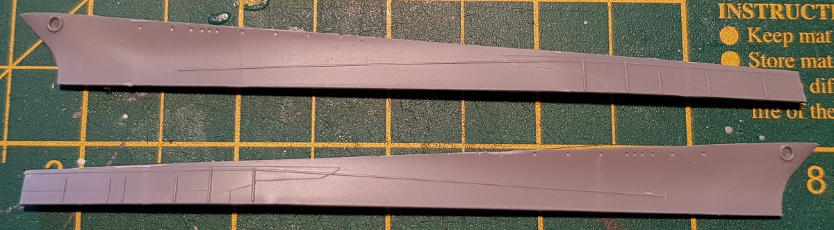

It's been a while since I've done a really big conversion project. I've taken a knife to a kit and made a start... but I'm not going to tell you what the end goal is (yet). I doubt this game will last very long but let's see who can work it out first? :heh:
Disclaimer: I'm not aiming for a 100% accurate conversion here, just seeing what I can get done with the donor kit and minimal scratchbuild.

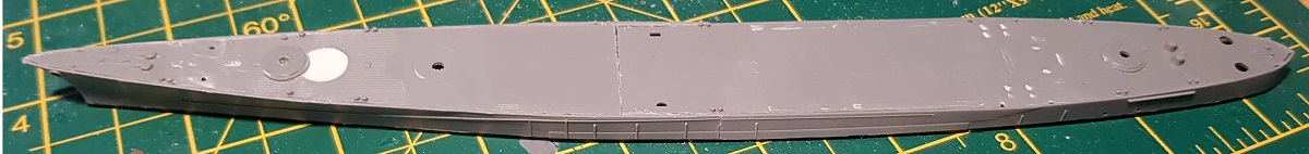

Well, the donor kit was pretty obvious and there's not a whole lot of places it could go from there. It's quite hard to tease more without giving the game away because the changes involved are pretty extensive. But I don't think this picture fits your answer, Matt. :wink:

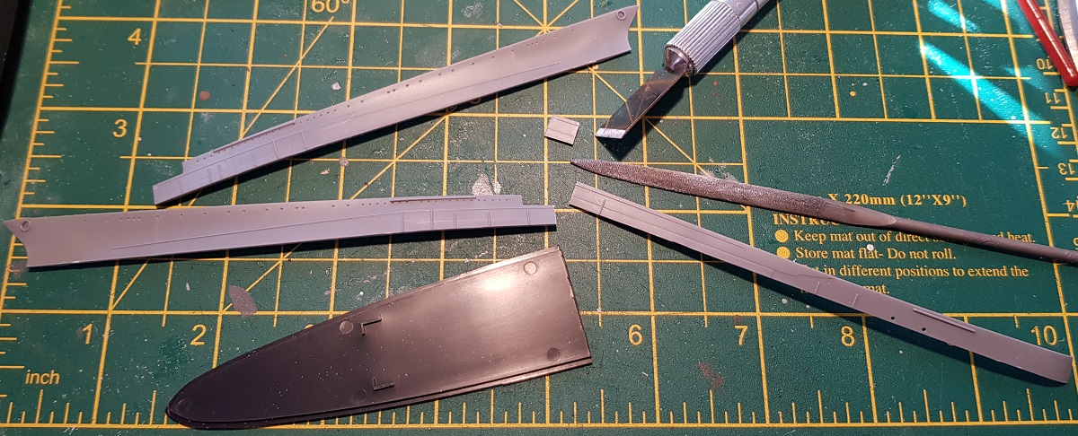

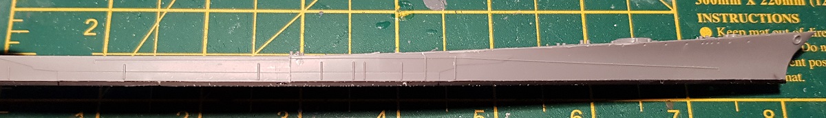

DavidP wrote:Vlad, are you cutting the foredeck down to get rid of that step?
They say a picture is worth a thousand words:

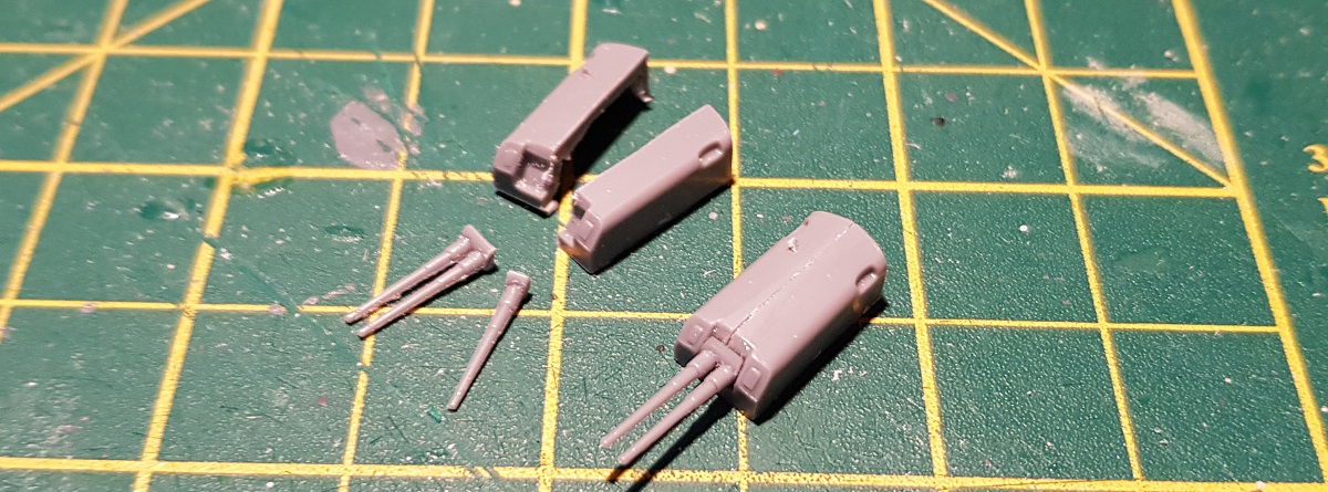

Thanks Steve, sorry I chose to cut up the kit turrets rather than buying yours 3D printed but I couldn't resist the challenge.
David, wow, that sounds like a huge project! How far did you get? Wouldn't mind seeing a picture or two if you have them.

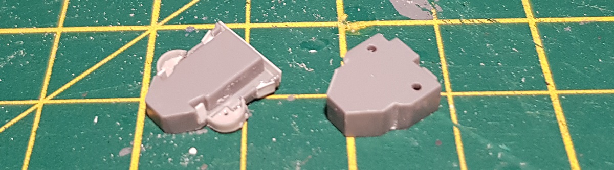

I decided to try to do the difficult bits first on this project so I can get them out of the way rather than putting them off and making "empty" progress. I should admit at this stage that I'm "cheating" slightly since I'm using one and a half Tamiya Indianapolis kits. The extra "half" consists of spare parts left from my conversion to Portland, where nearly all the superstructure was replaced with 3D printed parts. The double copies of certain parts have come in incredibly handy! Also there will be contributions from my spares box.
To that end, I've cut, sanded and generally beaten into shape some of the kit bridge parts. Here are the lower and middle bridge levels. Still some sanding to do to get them to line up, then the REALLY hard bit, making the upper bridge level with its wings!
