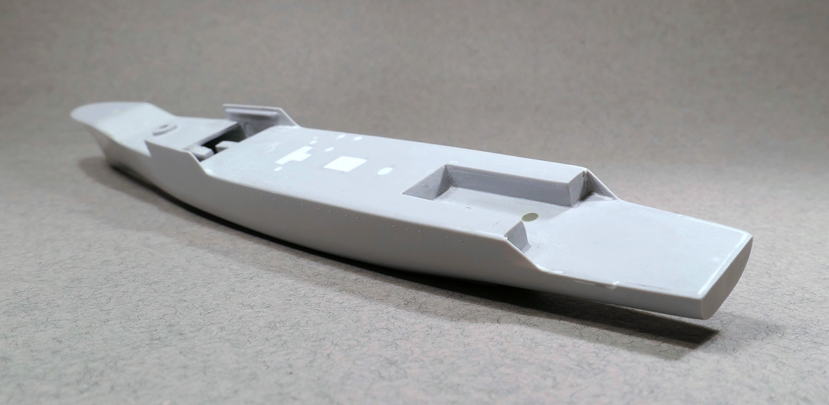

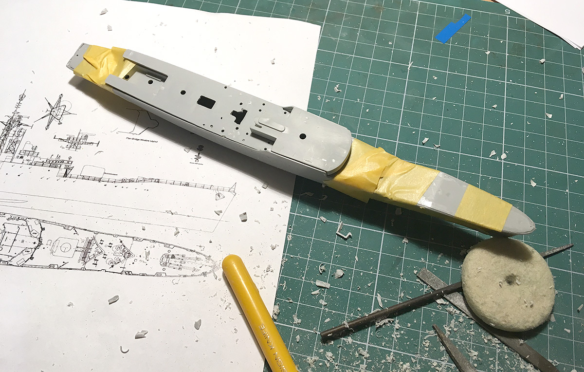

OK, the first cut(s).

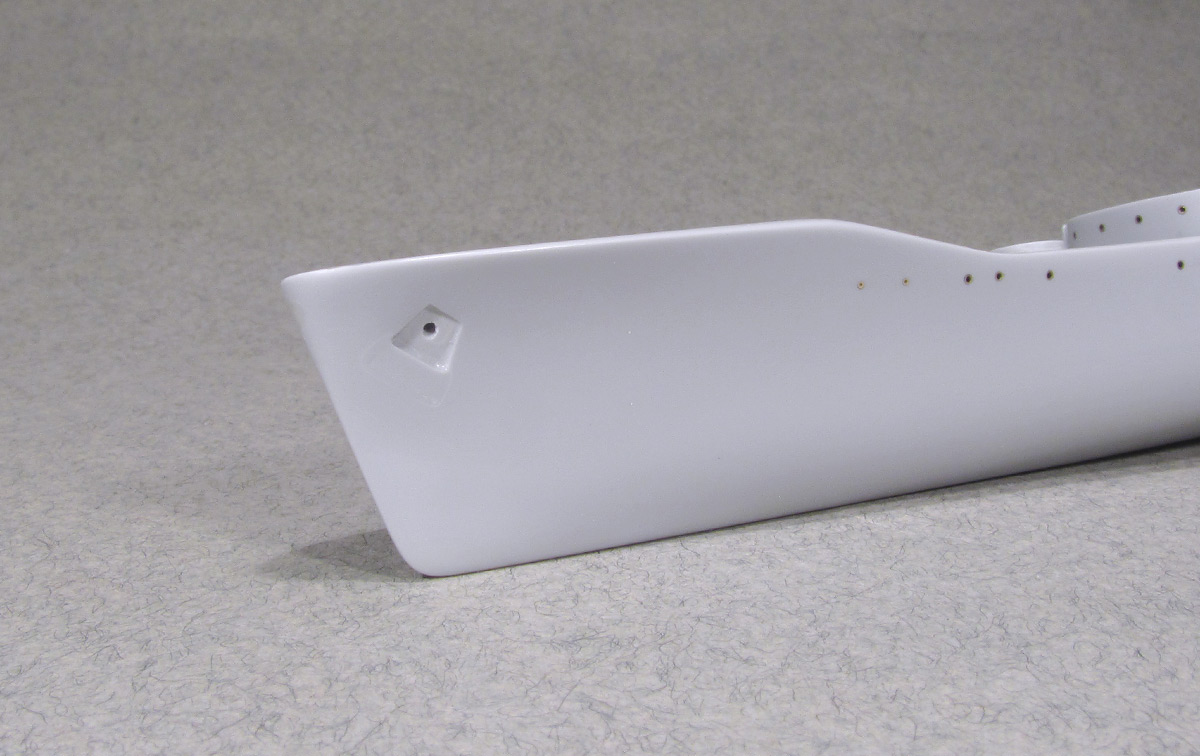

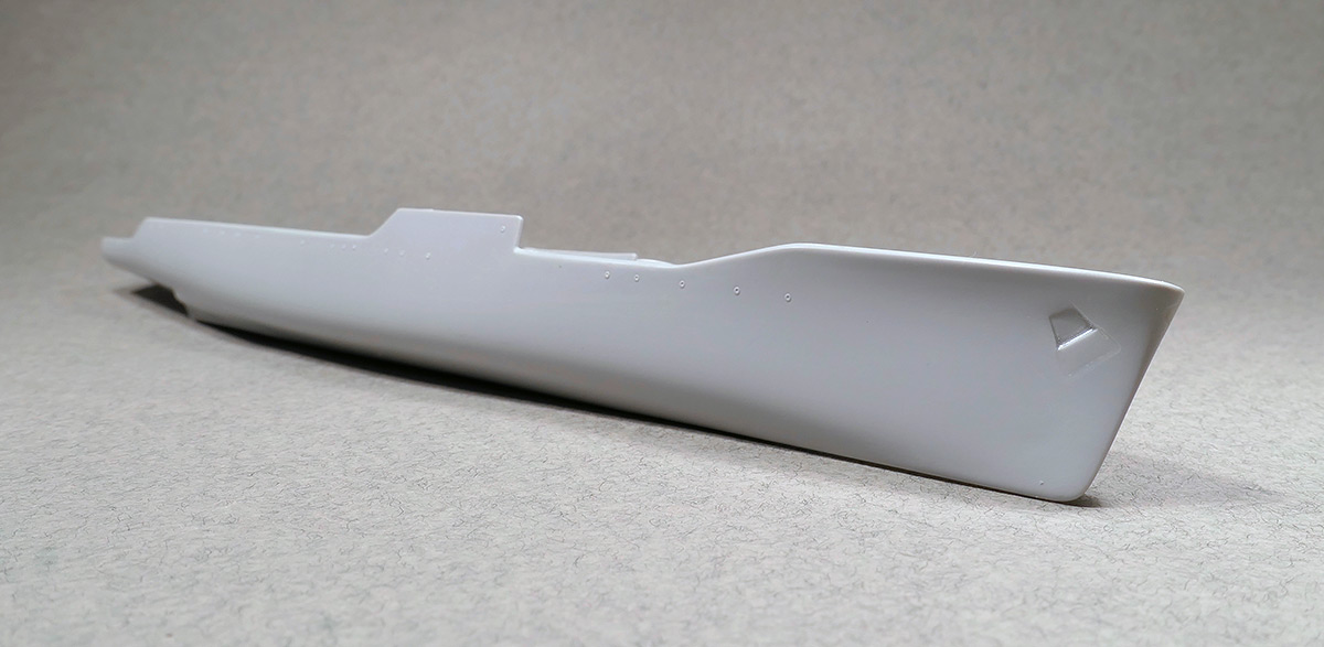

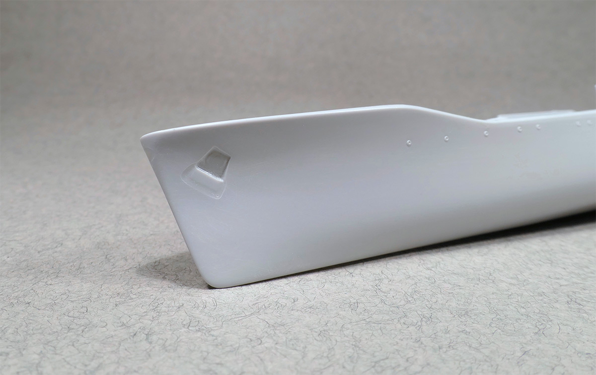

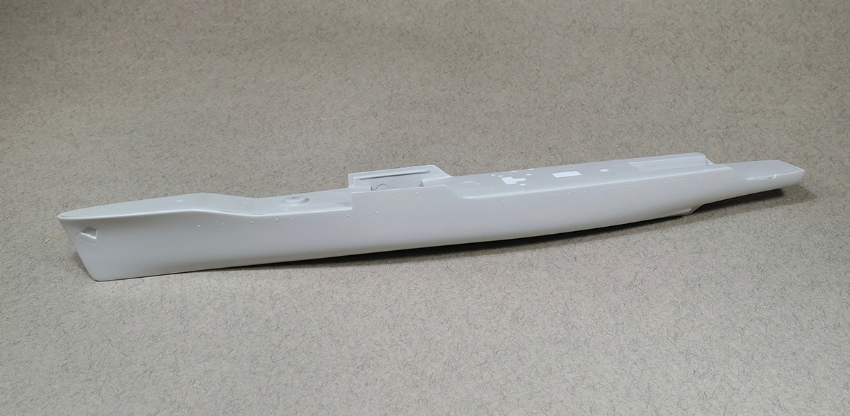

After the dust has settled the clean lines became to be visible (basically this is nearly all the plastic from the original kit I am going to use):
The styrene is quite soft but highly workable. I have downsized the hawser boxes a little to make it closer to the orginal. Tamyia Extra Thin glue made the plastic to settle down a little...
...but some CA glue came to the rescue:

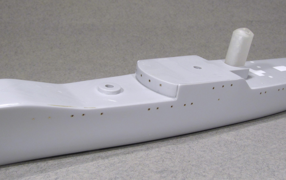

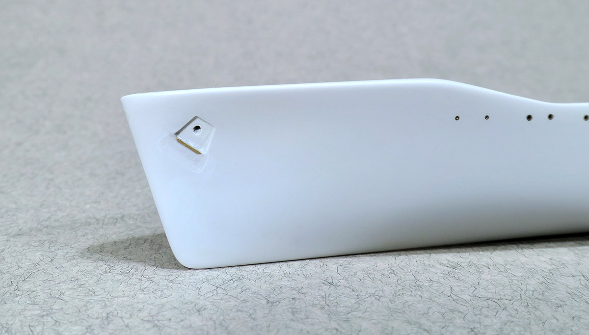

The portholes were drilled and filled with brass tubing of two diameters: 0.5 mm and 0.3 mm - the bigger and the smaller ones respectively.
The bridge deck has been just glued on and the funnel dry-fitted for the photo.

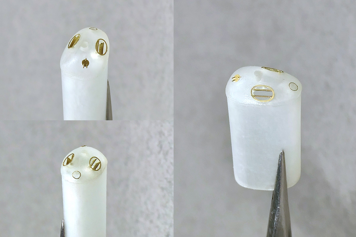

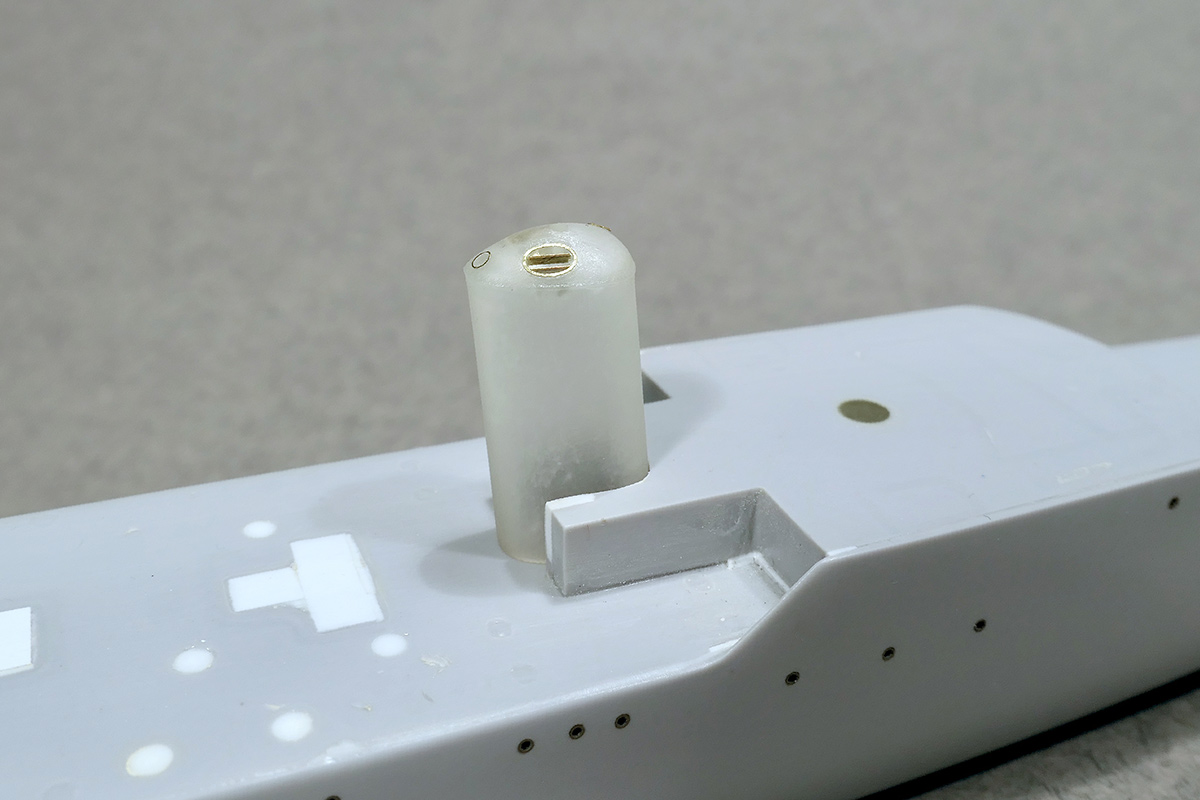

The funnel - Bogeys Bits offer the raked funnel used in the later guises of Type 12. The resin is very hard and a bit brittle but I managed to clean nearly all the grain from 3D printer as well as to drill the top openings. The confused alien has just been born. ;)

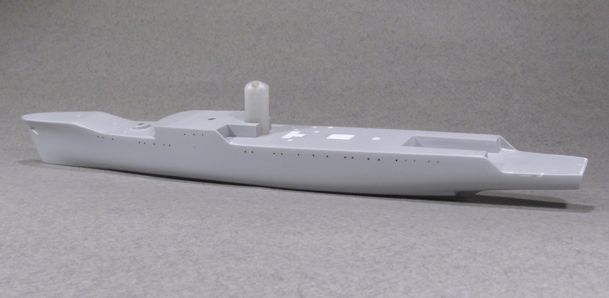

One last glance at the hull lines...

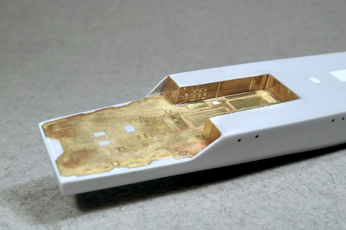

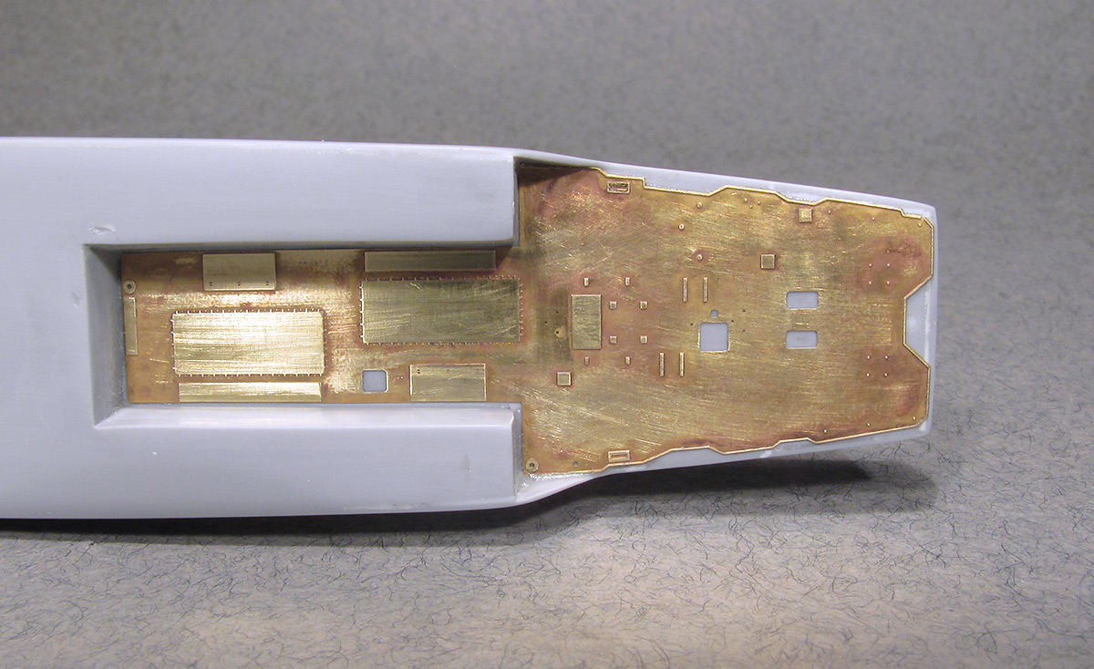

Meanwhile, the first deck is on. It seems like not much of a progress but at least I managed to get started. I drew the deck basing on photos of Rhyl and her siblings I have found in my books and online. When all decks are prepared it'll be practically half of the model done timewise.
The brass surface has been "wiped' with 1500 gradation 3M cloth - I wanted the small details to come out a bit. When large surfaces of brass are etched to half-thickness, the brass surface usually becomes dull and dark.

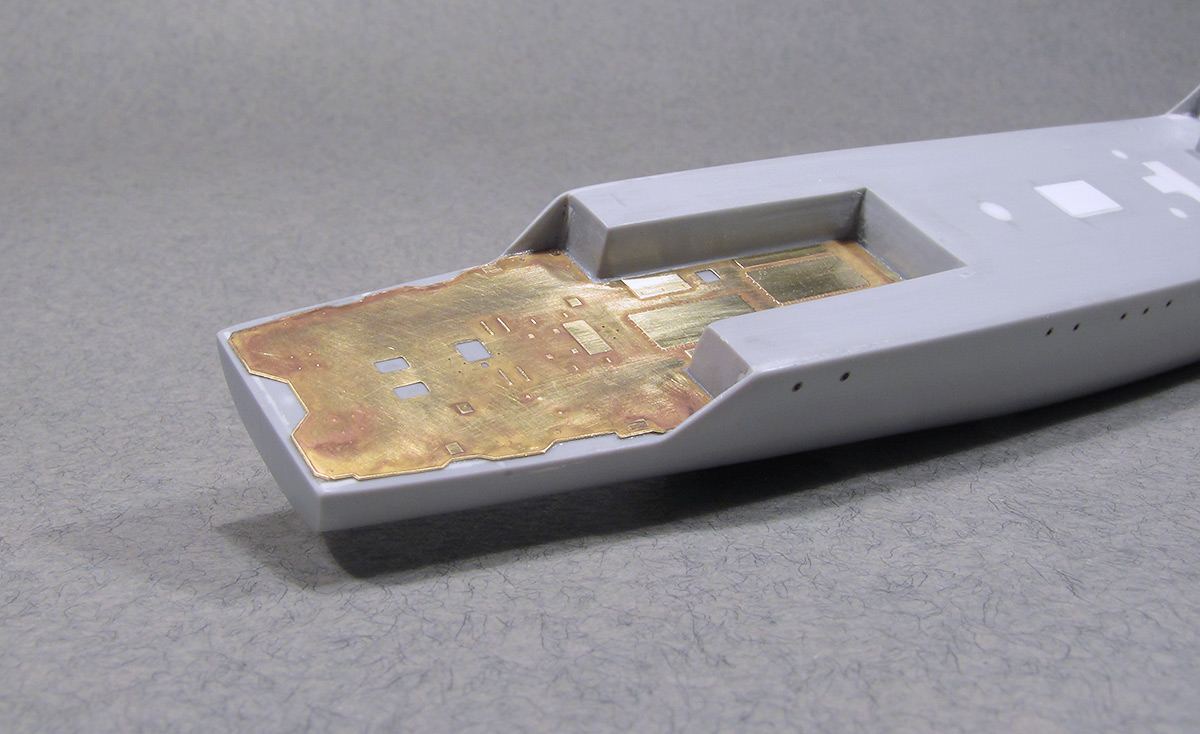

A next step in this slow build - more brass on the stern.
Not sure if it is the best order to fit the walls before the main deck is attached. I have another copy of the etched walls in case I will have to attach them to the main deck first an only then stick the whole set to the hull. We will see when the main deck is ready (the most time consuming part of this project).
The hawser bays got a small brass doubler underneath the opening.
More substantial progress is visible on the funnel - now waiting for the primer coat to see what is left to sand down from the 3D-printed surfaces.

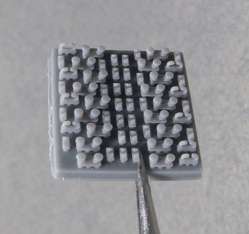

Finally thanks to Greg's help I have received a nice custom set of bollards and chocks.
