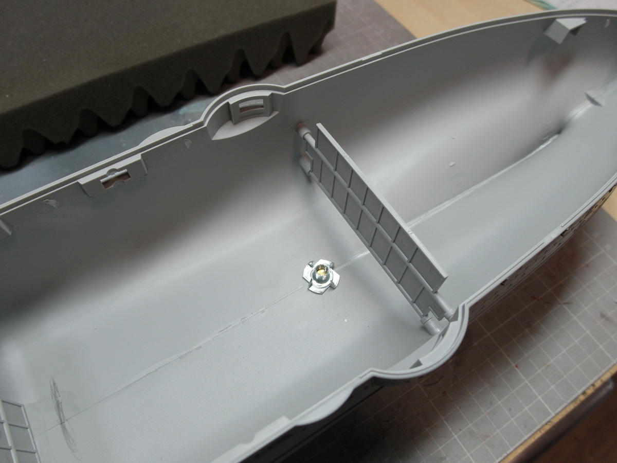

Let’s glue the fuselage together and drilled holes for the stand nuts.

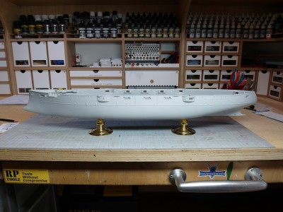

This time I treated myself to the elegant stands from Pontos. Look really great.

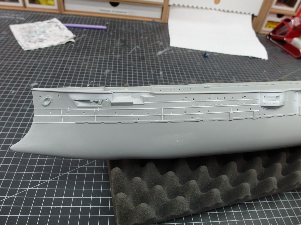

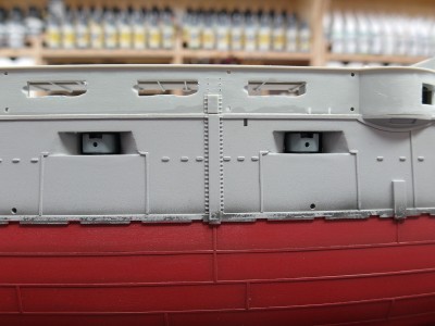

I use styrene profiles to imitate the seams of the armor plates. Back then, people still riveted, not welded. However, the rivets can hardly be seen under the paint on the original. So that's enough for me.
The same of course on the underwater hull.

A privacy screen must be created so that you cannot see the portholes from one side and the other side.
That’s why styrene plates were placed in the middle.

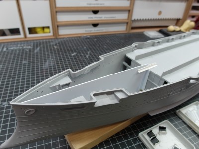

I will also raise the hull to the next level earlier than usual. It’s about the upper row of casemates.
If you glue this fuselage part later, which is actually logical and intended, you can get to the internal structures much better.
But you also end up with a very unsightly slot that can no longer be removed.

First I soldered the shields of the cannons on the bow and stern.
Then, since you can’t see anything behind the shields anyway, I simply replaced the cannon body with a small piece of styrene pipe.
This was then glued in…
…and I’ll simply put the barrel of the cannon through the hole later.

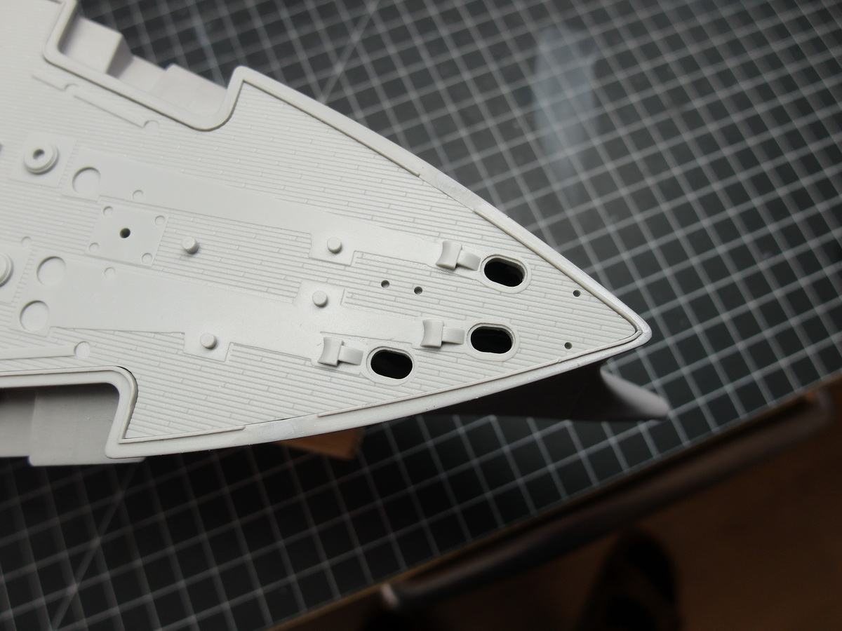

Now that all the cannons in the hull are installed, I can prepare the deck.
First say goodbye to unnecessary details. I got a small electric chisel, it simplifies things a lot.
Great, deck ready.

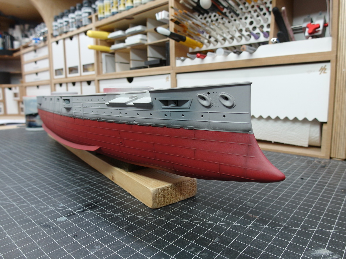

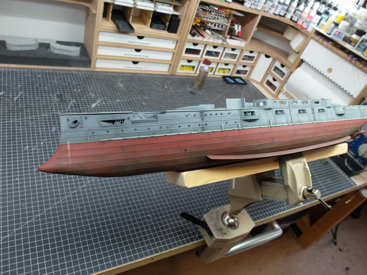

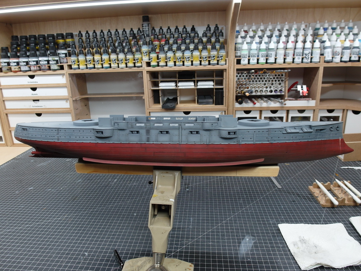

Let's start by painting the lower hull. First the preshading.

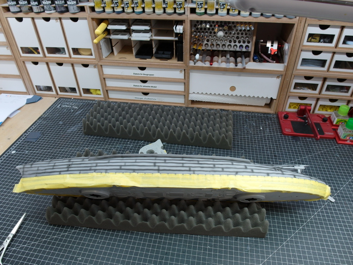

And then tape it off. I’m doing this relatively precisely, even though I’m only in the basic color.
Of course I could spray the red without masking it off, but then too many layers would overlap afterwards and the whole thing would be too thick for me.
And now the antifouling paint is on the underwater hull.
The waterline is running great. Profiles attached at the correct height. I really like the structure I made from the styrene profiles, and the preshading also comes into its own.

I must admit, I don't know anything about the MIKASA and there seem to be surprisingly few photographs on the Internet. Even of her as museum-ship there are only a few bad ones and none, that shows the hull properly.
I looked, because I was wondering, why you put sort of 'battens' along the assumed seams of the armour-plates? I didn't see them on the (poor) photographs of the museum-ship and haven't seen anything comparable on other ships of the time. The armour-plates were normally bolted (not rivetted) onto a backing of teak (to dissipate and distribute the stressed from impacting shells) and shipbuilders usually took great care to create a flush hull (at least above the water) for the sake of aesthetics. That's while normal hull plating was arranged in the more expensive way with doublings behind the plate-seams and countersunk rivets.

I have to admit that I don't really know much about historical shipbuilding. I just really enjoy building ship models with the knowledge I have and trying to represent them artistically as best I can. And I knew that the armor plates were not welded at that time. Now the hulls of the catchy manufacturers are always smooth, which is of course not true. I have this in my Bismarck, which you can also find here in the forum , adopted like this. But it was also the first ship model that I built again after a long absence. And in retrospect I now find the fuselage a little boring.
I wanted to approach this differently with the Mikasa. Of course I am aware that there should be a seam between the panels and not a slat as you call it. However, a seam can hardly be represented sensibly in terms of model building. You could do this with a carving knife that you drag along a steel ruler. But I think it wouldn't look good.
That's why I decided to imitate the push the other way around. Just with thin profiles. And that's how what you see here came about.

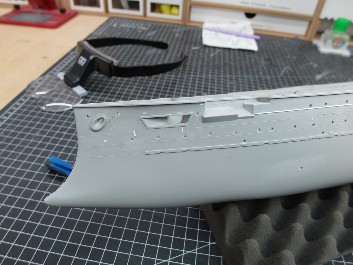

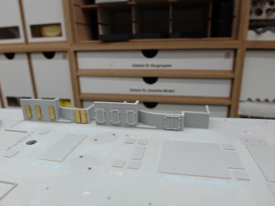

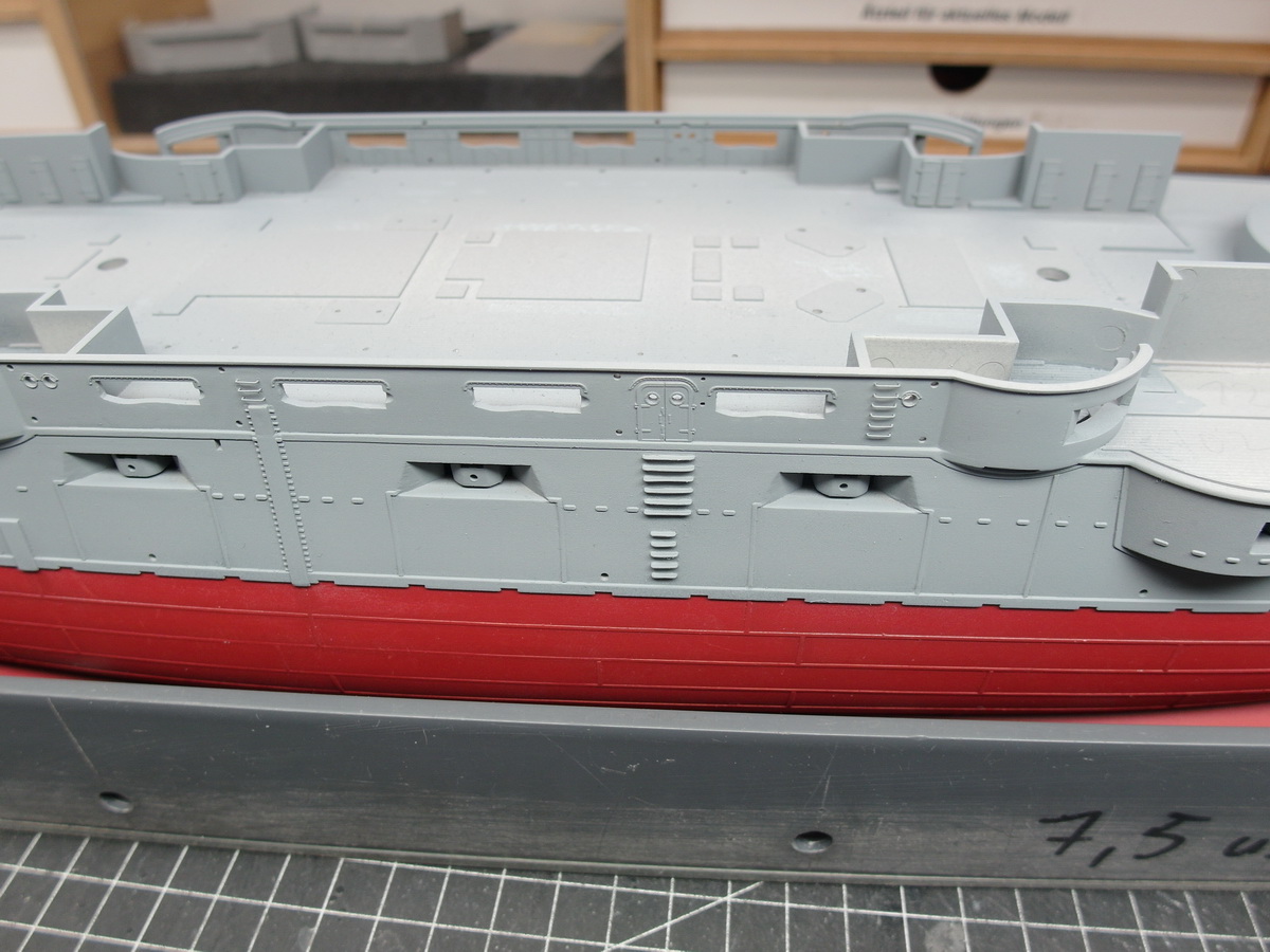

And it goes on to the upper casemates. Unnecessary holes closed again.

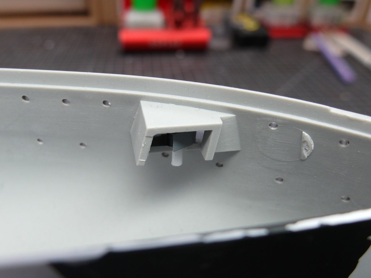

So the etched parts battle could finally begin. The MK1 set has already scored its first points.
Shortly before I had sanded away the rather rough details, I thought about taking a quick photo of them. Pontus had not planned anything here. Incomprehensible, even if you can hardly see it on the finished model.
So, one to zero for KA Models. Still processing the remaining door. Then the first superstructures can go on the deck.

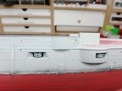

So I was able to add the next floor. Here are the pictures to show why I go to this length.
The slits in the four round casemates would still be manageable.
But this one isn’t very nice.
I think this is better.
After sanding three times and prime, I am very satisfied.

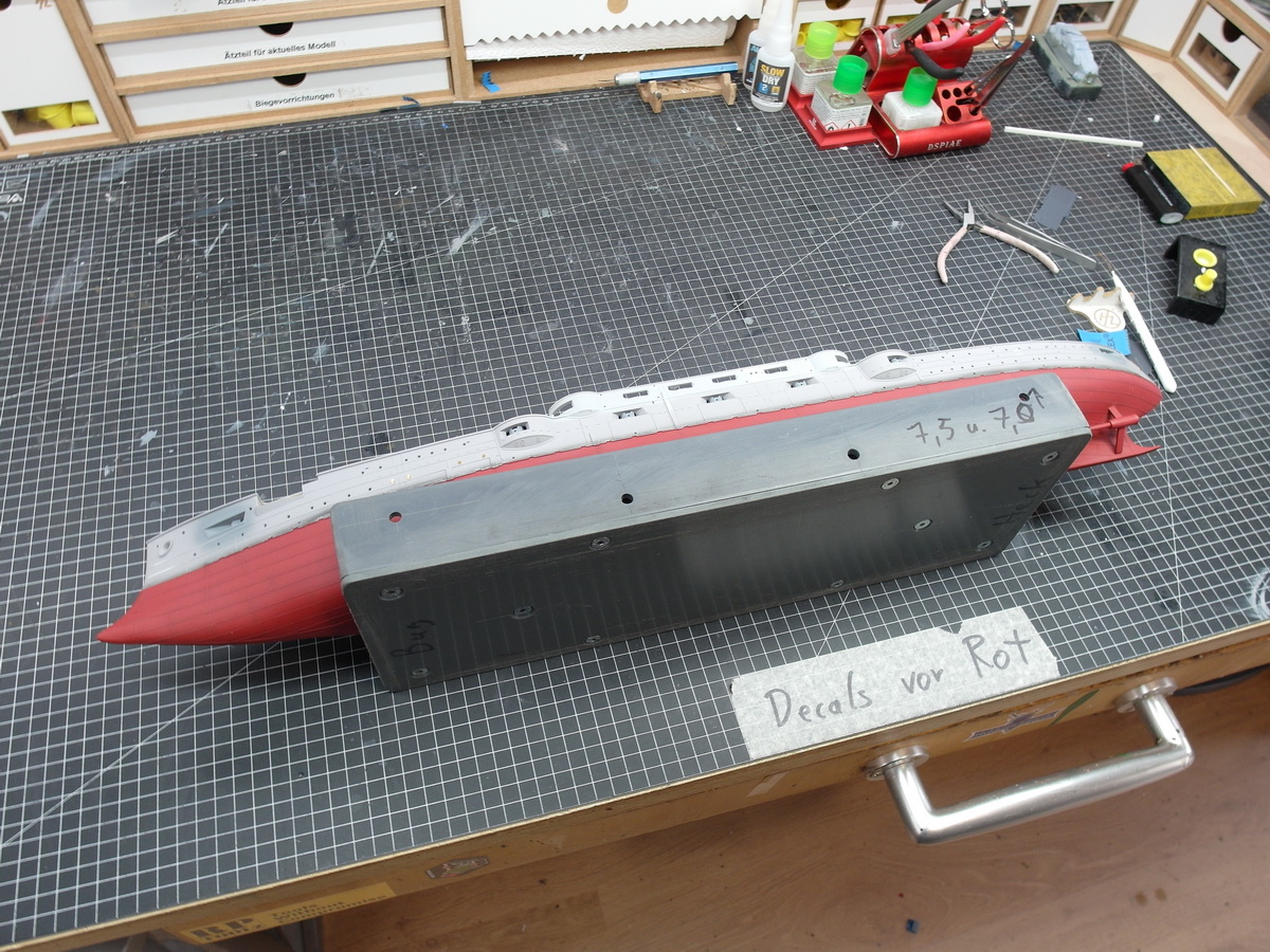

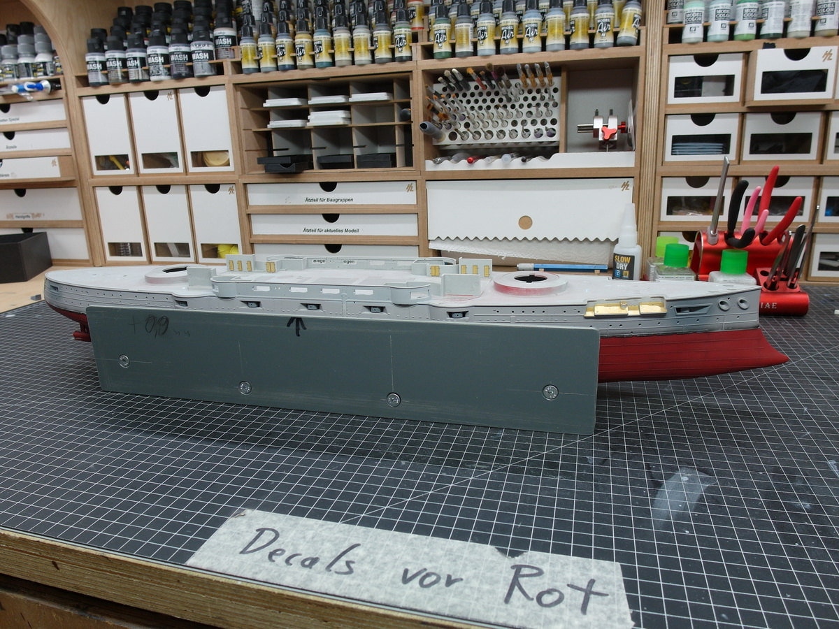

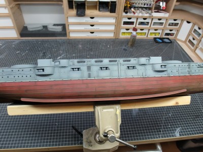

Then I built a dry dock for the Mikasa.
This means it can be safely laid on its side, for example to work on the portholes.
I can also attach sheet pile walls of different heights to further increase the protection at the top.

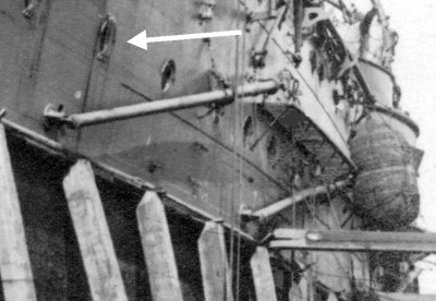

Next, onto the portholes. Some of them have grids and I had to find out exactly which ones are true.
The grid would only have had a right to exist at the height of the anchors. On this ship, the anchors were pulled back on board with the davits and an anchor could have hit the hull or the porthole. In addition, the anchor chains ran past the portholes.
So I looked at everything I had in detail again.
The fact is that during active service, here in 1921, the front portholes were barred. You can see this in the following and best quality picture of the ship that I have. It was taken in Vladivostok in 1921.

So the question arises as to where this protective measure went. The anchor area would be logical. I found the solution in the following picture.
The white arrow points to the same porthole in both photos. You can clearly see here that the portholes were protected with grilles right up to the anchor storage areas.

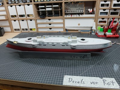

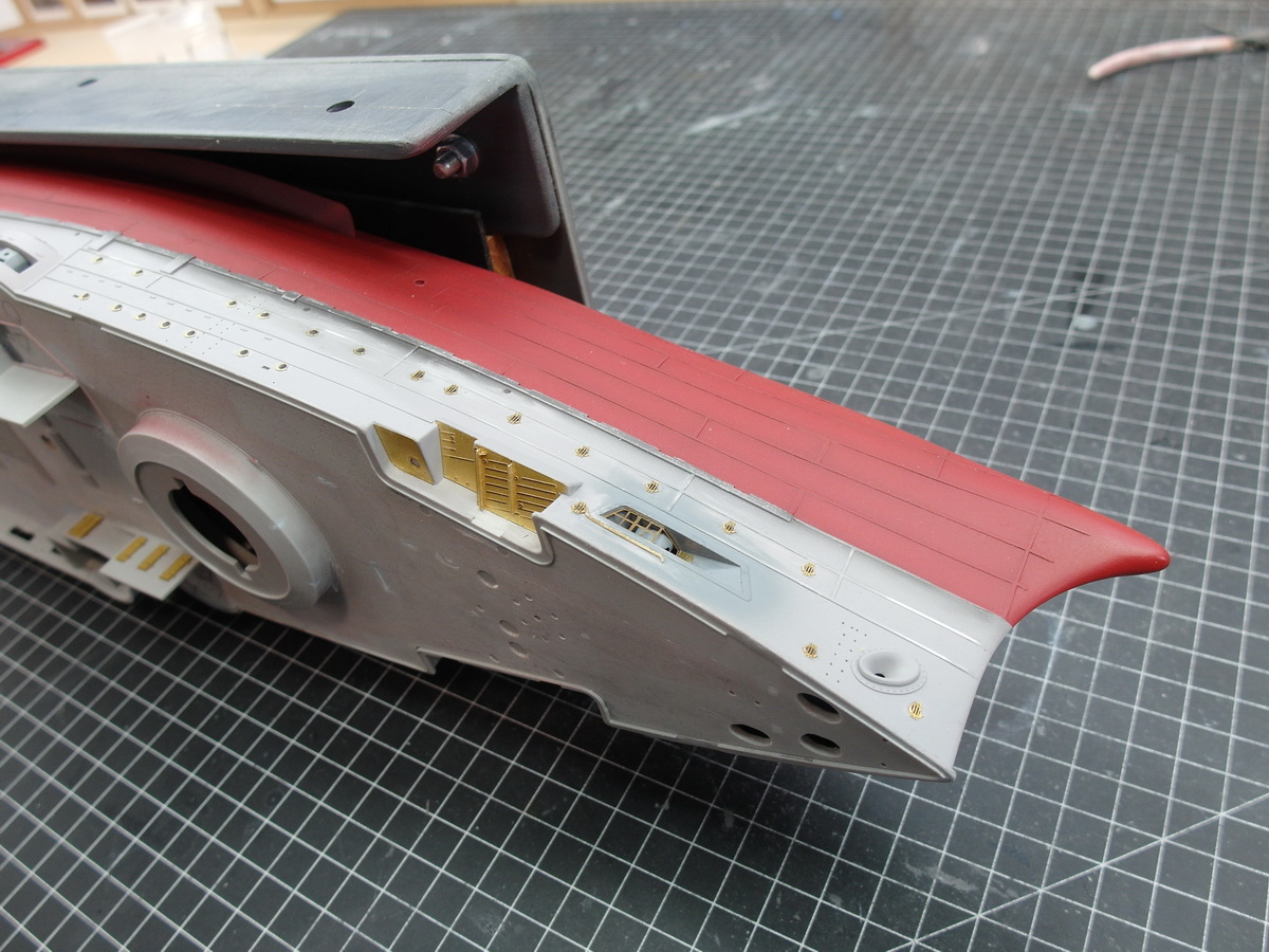

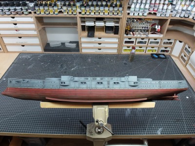

I finished all the rough work on the fuselage and was finally able to finish painting it.
After a proper preshading the whole thing now looks like this.
What followed was an accentuation. Which means nothing other than that I painted fine details in a lighter gray.
Which was a real fiddly job. The dry decals from Pontos are really impressive. The depth marks are razor sharp.
Here too, water-soluble acrylic paints have a big advantage. Small slips can be removed immediately with water without leaving any residue.
This gives a decent contrast to the preshading areas.

At the moment my progress is very slow because I have to take care of my sick wife.

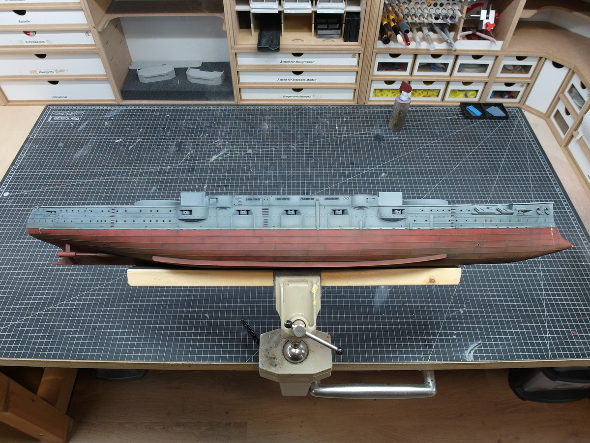

But I’ve already started aging.
As always, very tedious. But the result that a little diluted dark gray paint leaves on a painted surface still amazes and fascinates me. Even after all the years I’ve been doing this.
A little every day and I’ll report back when it’s done. :wave_1:

I’m a little further along.
The first round of aging is complete.
There are three filters on the underwater hull.
On the gray two.
Also a first washing.
Above and below.
I’m quite happy with it.
Greetings from Germany.
Jörg
