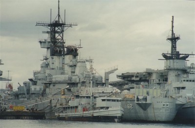

Re. your last photos -
The turned down corrugated items on the old 40mm tubs - they need to go - they weren't there in the NEW JERSEY's 1981-82 refit. Here's a photo of her in 1999 in storage in Philadelphia, PA prior to her becoming a museum:
Hope this helps,
PostPosted: Wed Jul 11, 2018 1:10 pm
Joined: Wed Aug 22, 2012 6:19 pm
Posts: 581
Location: Finland
Hi,
I'm doing her (Missouri) as in 1991 in the gulf and she had them on.
