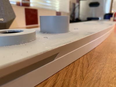

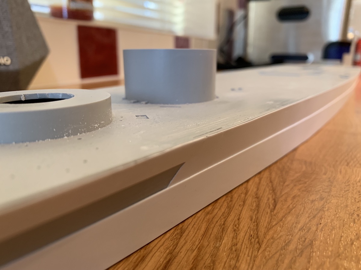

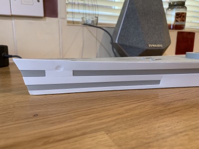

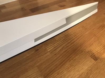

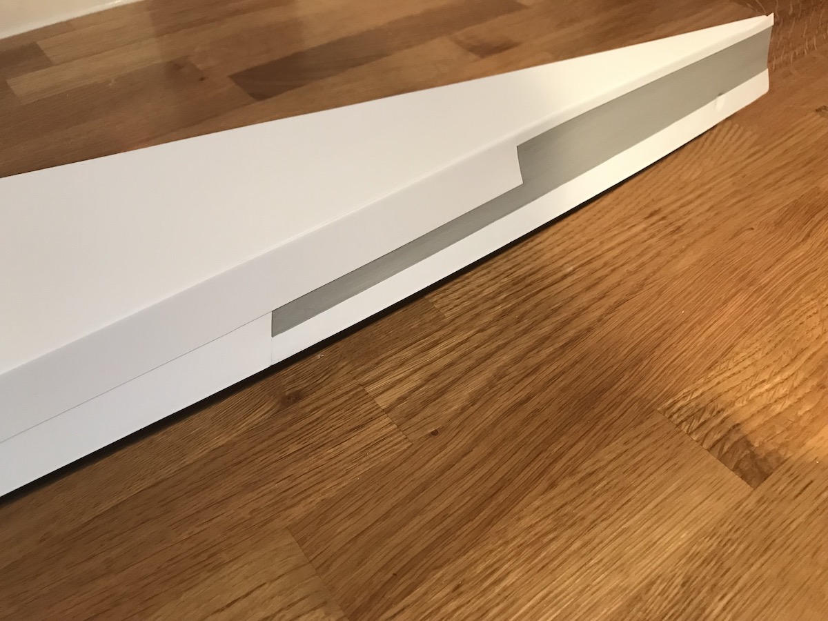

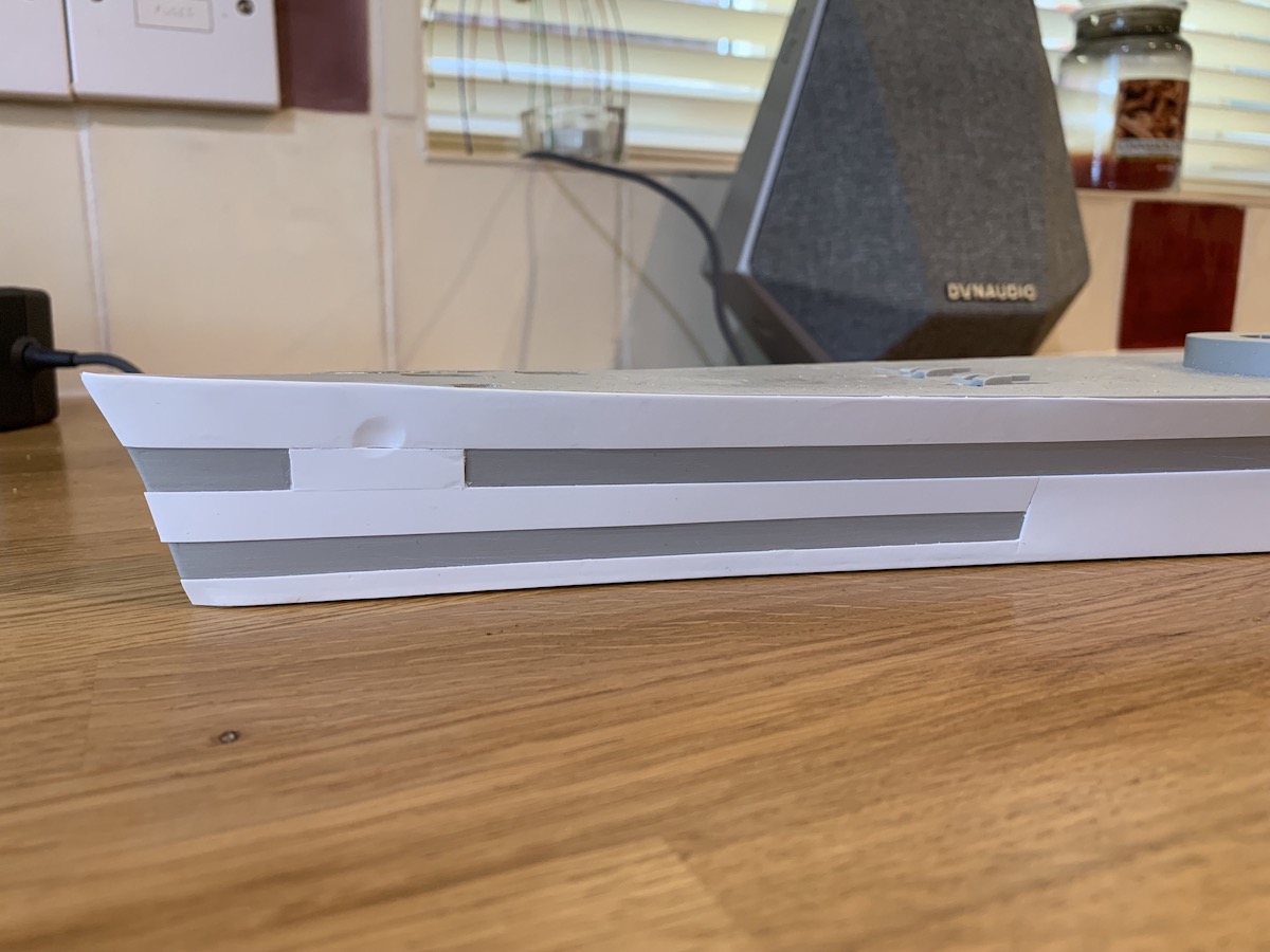

Thanks Jason... although I have a long way to go...!
200 Hood waterlined (which took ages...) with the armour being replaced with scale thickness plastic sheet...
What you don't see in these photos is just how massive this thing is!
File comment: Hull removed with 2mm plate added. (2mm is VERY thick when you are trying to remove the excess!)
File comment: Still need to put the bow armour on... and the other side!!
File comment: Armour plate at scale thickness...

Looks promising Bill... I have this kit too and yeah, she's a big girl!

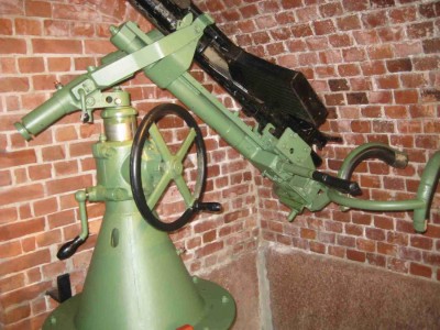

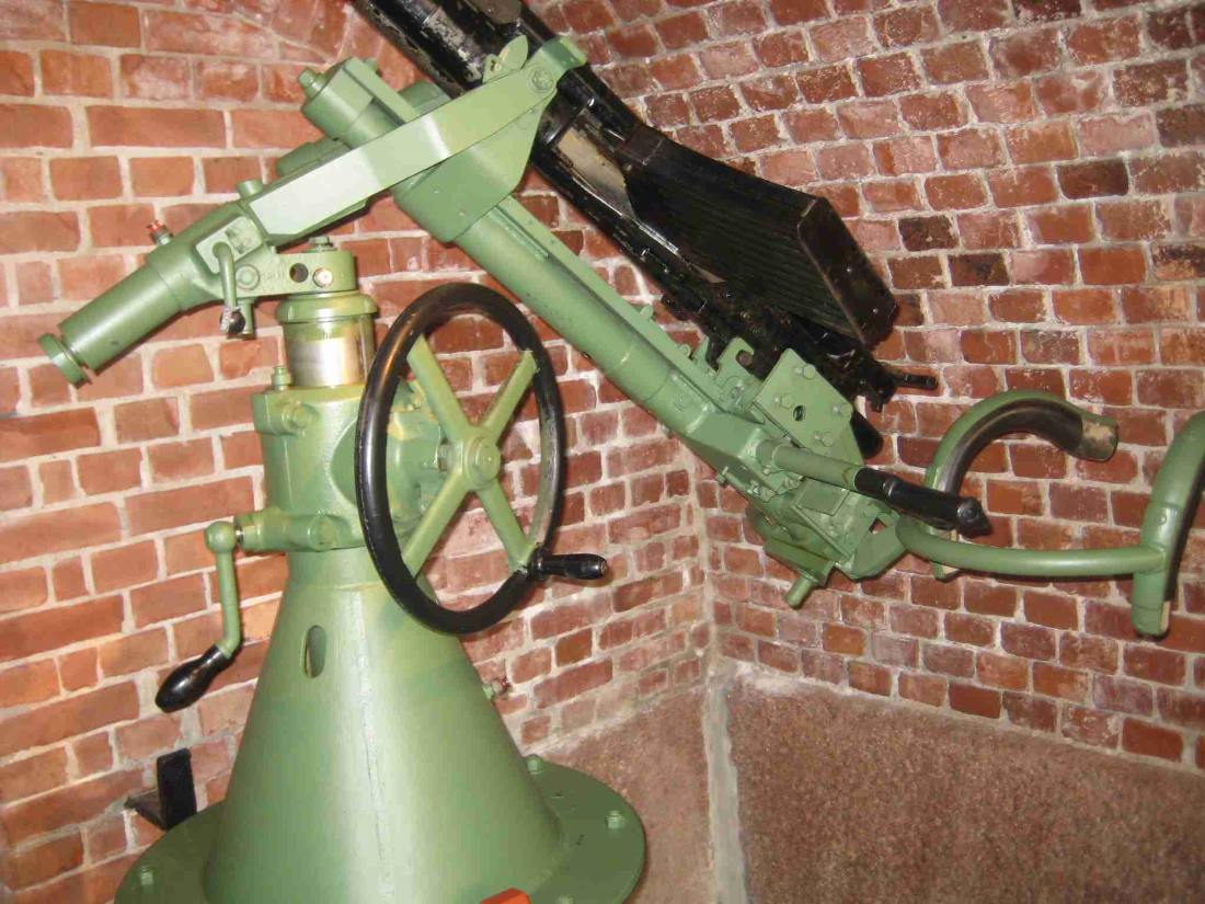

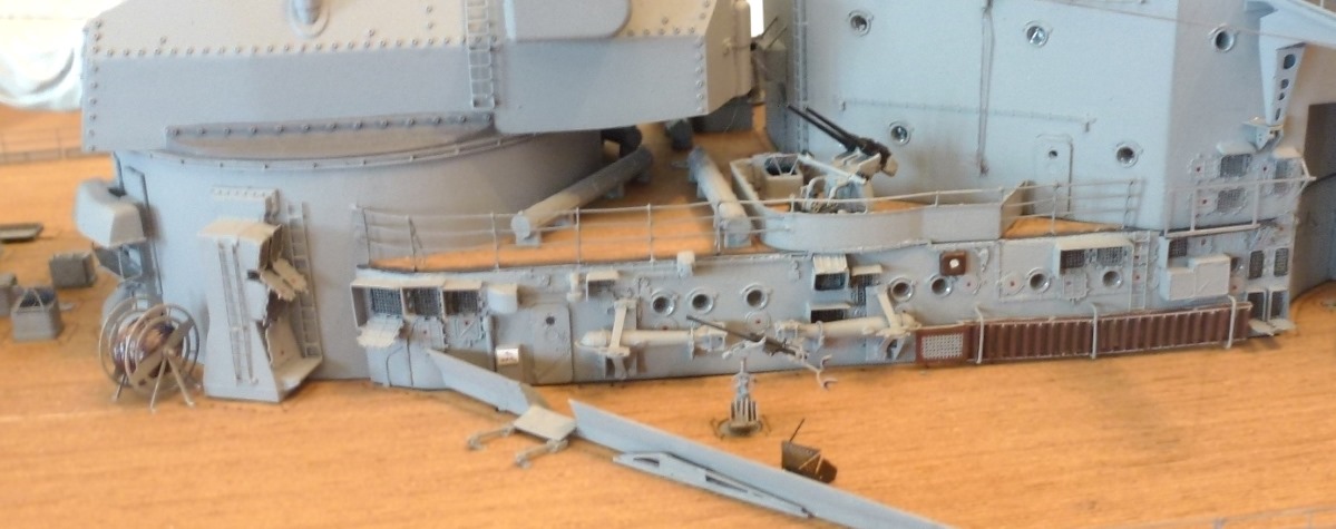

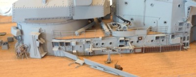

Very, very nice build with superb attention to detail!!! :thumbs_up_1:
One small correction to your 20mm's: The two "fingers" in front of the cradle is ONE round piece. You may insert a .1mm plastic strip and press the fingers togehter, or attach a round plastic rod instead.
See pictures to understand what I mean (pictures from Oscarsborg in Norway and my own 1:200 Bismarck).

Good catch Stein, I actually did notice that after I put the guns together... guess that's what I get for following Pontos instructions! :heh: It's an easy matter to just glue the two sides together and hit 'em with the the 'ole hairy stick I suppose.

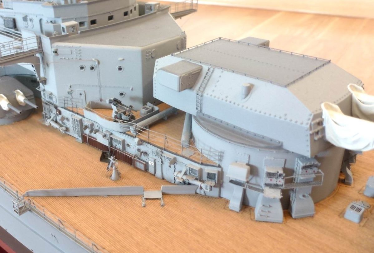

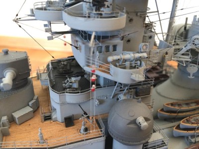

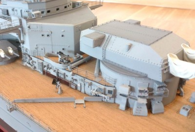

As you say: An easy fix!
Regarding my Bismarck, I intend to show it on the forum in near future. It was finished two years ago, and is quite extensivly detailed.
Your Bismarck, however, is even more detailed in some areas: The black kick-stripe for instance – I left it out, but I am really impressed that you took the job!
I’ll give away another small goodie for you – if you’re interested: Most (almost all) hatches, porthole shutters etc has a shallow dot in the middle. This dot is to be painted red (as can be seen in many b/w photos). Reason: Those hatches were to be closed in battle / rough sea.
I think it is still not too late to fix this on your model!
If you can get your hands onto Josef Kaiser's book "Das Original" and "Das Model", you can find almost everything you need on detail and rigging of your Bismarck!

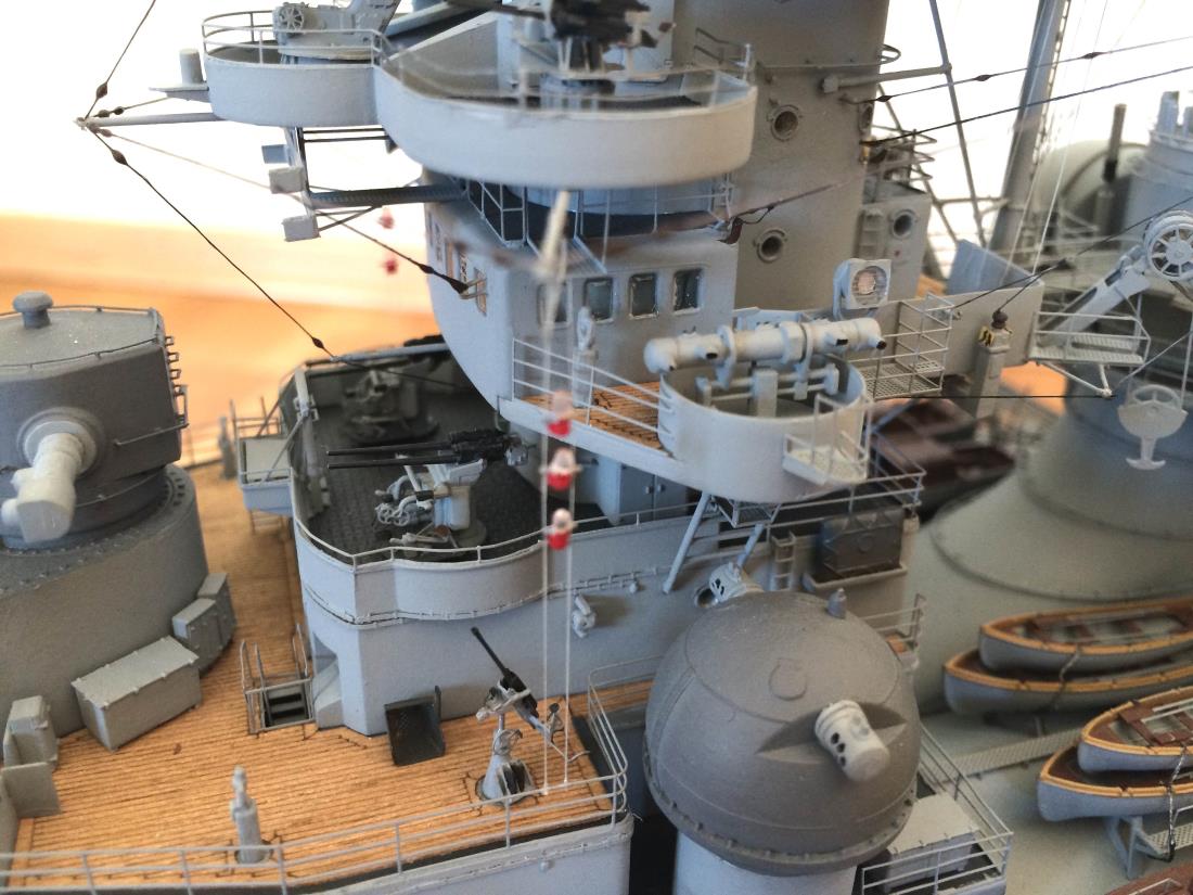

Summer is nearly over, amazing how fast time goes by. Anyway, I'm back to work on my big Bissy.
New progress thus far are a couple levels of forward superstructure, assembly of the aircraft catapult and some general clean up; I figure I'll focus on the lower superstructure sections for now, then branch upwards and outwards and see how far I get before I'm burned out again.
There's no big rush or timetable to keep to so I'll just keep my building strictly for fun and see where it takes me. :big_grin:
