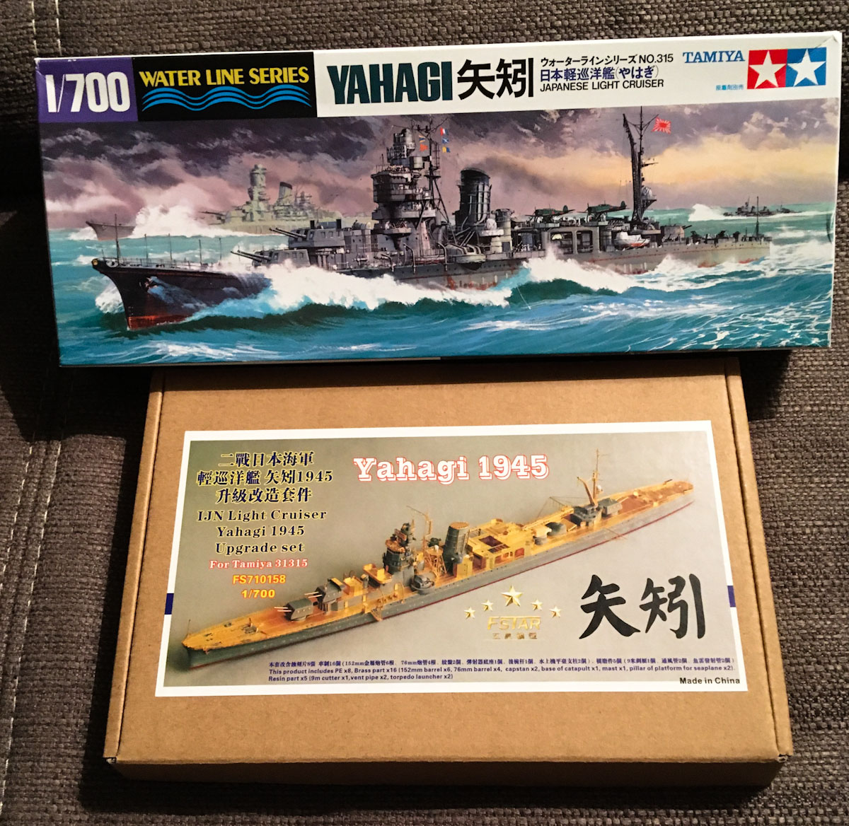

Hello everyone! I just start building Tamiya's 1/700 IJN Yahagi with the nicely crafted Five Star photo etch detail set. My plan is a small diorama that shows the ship during operation Ten Go.

This is my first building log - also my first post as well, so before share the first pictures I would like to write some thoughts about myself - be careful boring part is coming:D.
I used to built a lot of models in the past as a kid, but - I guess like most of us - just for my pleasure without any references about the planes, cars, tanks etc. After a 15 year pause I started this hobby again about two years ago, but with a more adultish approach.
During my childhood I wasn't intrested in ships, I built only a 1/350 Bismarck - which was such a waste, I know, I know. A few years ago I started watching modelling videos on the internet, and - I don't know exactly why - I found myself intrested in ship modelling. Then I clicked on modelshipgallery.com and I lost in the beauties of it forever.
In the past two years I have built the italian battleship Roma in 1/700 scale and after that a japanese harbour a with the Shimakaze on it. Okay, it is still on progress, haven't done it yet...
Somehow I'm more and more intrested in IJN ships, that's why I chose Yahagi. I think japanese cruisers were elegant, nice looking ships but I didin't want to start with a heavy criuser like Maya due to it's complexity. I don't want to ruin it. Yahagi seemed just fine for me rigt now. I hope I can learn a lot during this build about ships and modelling techniques and I hope you will enjoy it as well. :)
I will try my best but I am far from a professional builder so who expect a museum quality ship please leave right now (no, please don't :D ).
Anyway comments, remarks, opinions are warmly welcomed. And please keep in mind english is not my native language. Thank you, guys!
