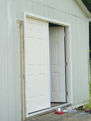

With a rotten door/frame my first task was to replace this with a new unit. We offset this with a new double door. Yes, the existing ramp is now out of line with the doors, but I hope to add a small 6'x6' covered porch eventually as a replacement:

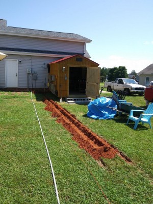

OK, so it's been a while since I updated this. Only a couple things have happened:
My electrician brought out the Ditch Witch and we buried 165 feet of #6 wire at the prescribed depth per code. This was done the third week in July and I've been working since that time on a new deck behind and beside our sunroom. I am in the lighting stages of that project, but felt I needed to update this build with photos and commentary, etc. :big_grin:
It was up in the 90s that day and took almost all day to dig the ditch, assemble the conduit & wire, bury, and then connect to the small shed, and add a 50 amp panel inside the "future workshop". Additionally, we wired up the garden shed you see to the right of the trench so it is "alive" as well!
The pictures are in order and the last one shows the small 50amp panel inside. Other than moving things around that space, taking things out, and putting other things back in the space, I haven't done anything else on it. That panel will supply power for the workshop as well as a dedicated 20 amp breaker for a future U.G. line to my wife's "she shed". So, that will require another visit by Ditchy Witchy but hopefully for only a short time as that shed will be much closer (but not THAT close! :heh: )
