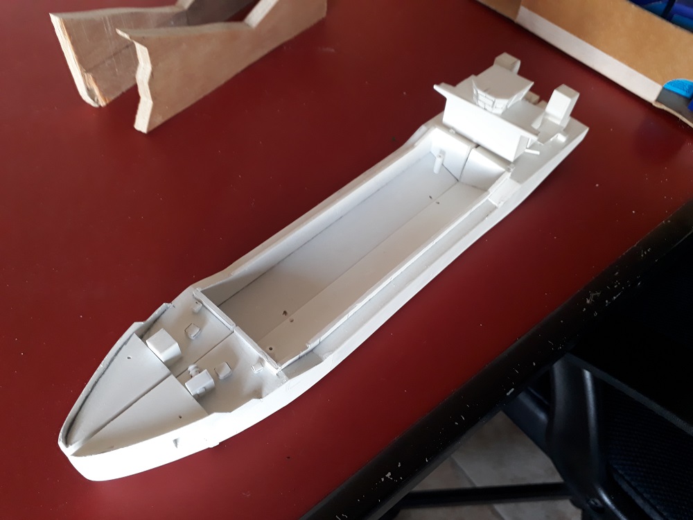

Well here's the next one. Increased the scale to 1/400 now, since it's a small vessel. Was supposed to be a quick-and-easy kind of build, but after a couple of days of building I have a different opinion :heh:
A split barge is used in dredging to be able to reach shallow places and be able to unload very quickly (high turnaround), they're used when a floating pipeline to a dredging vessel isn't possible (too remote, too much traffic etc.).
They're very simple ships, practically a floating box with minimal mooring equipment and accomodation. That's what I thought :heh:

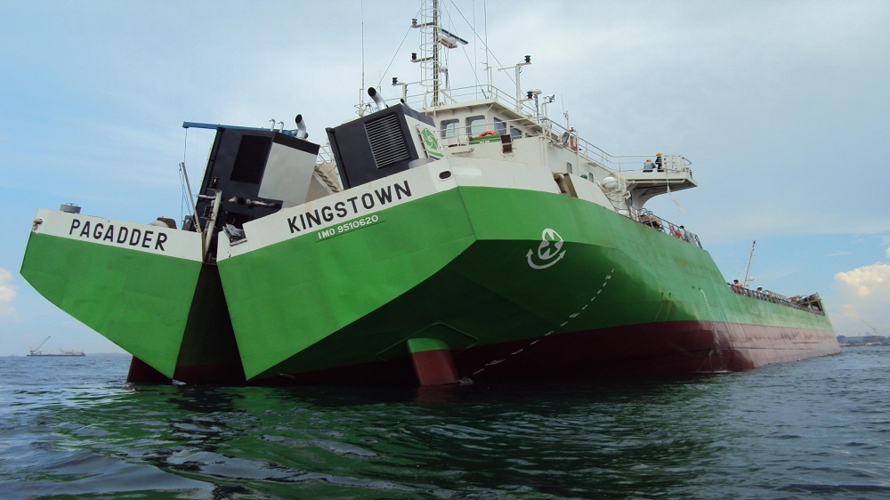

With increased size of the actual dredging vessels, split barges also had to evolve to full size seagoing vessels. The DEME (company with nice green ships) fleet initially operated Sloeber and Pagadder as side-kicks to the cutter suction dredgers D'Artagnan and Ambiorix. With the arrival of Spartacus (nearly double the capacity of D'Artagnan/Ambiorix), they needed bigger Split barges. Those became Bengel and Deugniet. (all of those names are Dutch words for rascal or scoundrel).
As can be seen below, the hull splits, the funnel casings go with it, but the accomodation stays straight...

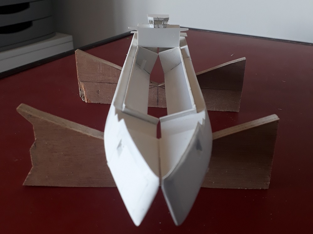

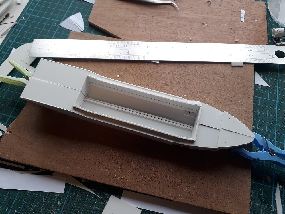

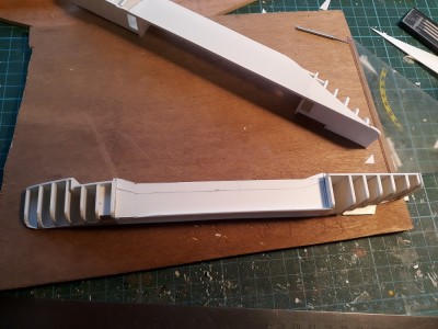

So easy enough, I'd build two half hulls without giving it much prior thought. Then of course I discovered I needed to build that hopper/cargo hold in the centre, which would leave me with little longitudinal strength and of course a bent keel. In a normal case I'd use a 1.5mm bottom plate to straighten things out, then add the frames and build the hopper.
However, the hopper leaves little in the centre to cut and attach to such a bottom plate.... So I went for a 0.5mm bottom plate.
The strength and straightness was eventually achieved by building that hopper as a sturdy box inside the ship. The frames in that centre part aren't very useful anyway.

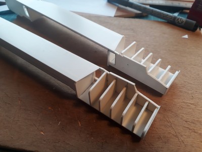

the idea of this build is of course not a regular display. I will attempt to show it in open configuration with the support being a pile of sand pouring down from the hopper. It idea would be to have a transparent plate inside the hopper and one in a straight angle forming a T-shape. The plates would then be treated with a sand-acrylic gel mixture (like I used on the bottom of the Living Stone diorama). Probably I'll add some milliput (painted brown) at top and bottom to give a hill-effect. I'll also see if some dyed cotton wool at the bottom would give a sense of turbulence. I'll be testing that set-up separately before applying it to the model of course.

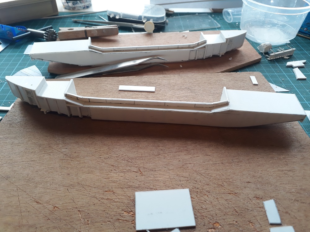

In the meanwhile it was time for framing.

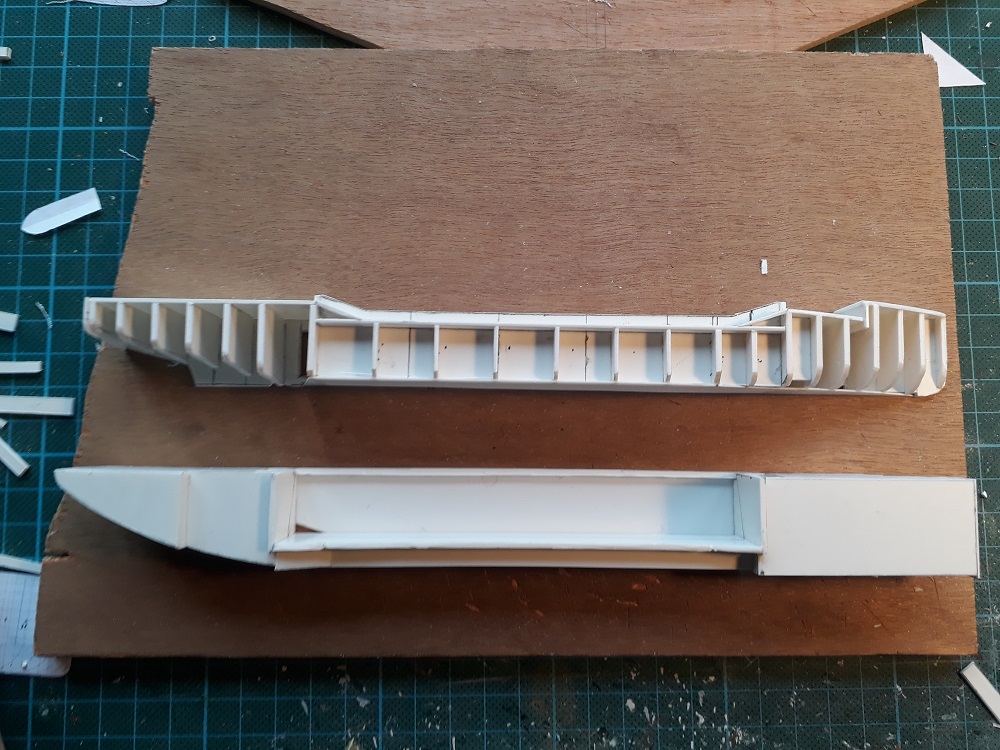

The holes for and aft of the hopper are the compartments that house the 2 big hydraulic cylinders that open up the ship.
File comment: Hopper side plate wedged between two full frames that takes over the longitudinal strength of the keel.

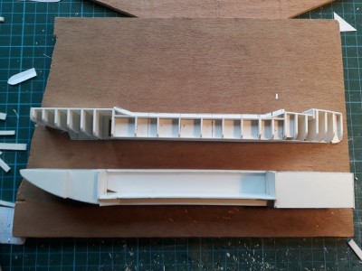

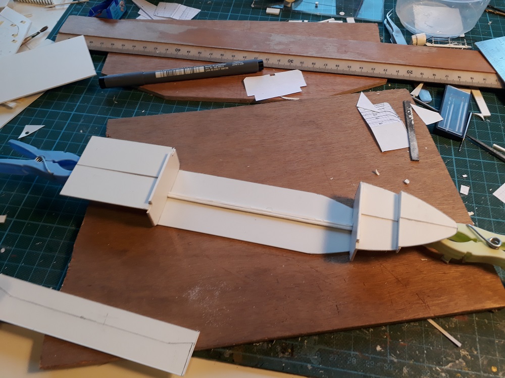

On to the model. Lots of progress made again. This hull needed a lot of preparation before application of the putty. Bulwarks need to be placed first, also the recessed anchor pockets (don't want to damage the anchor or mother vessel during approach) as well as the straight parallel body area as well as the bilge area (flat in this case, not curved as usual).
File comment: Framing completed
File comment: Parallel body area in place and framing filled with styrene (1.5mm) to reduce the amount of putty needed later on.
File comment: The overall shape, wide and shallow hull. Hopper bottom still missing. I first put styrene pieces to cover holes between fame and bottom plane for application of putty later on.

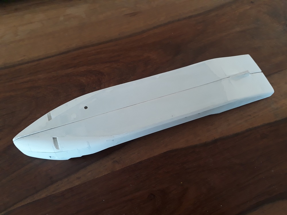

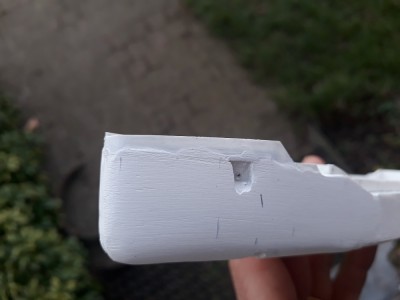

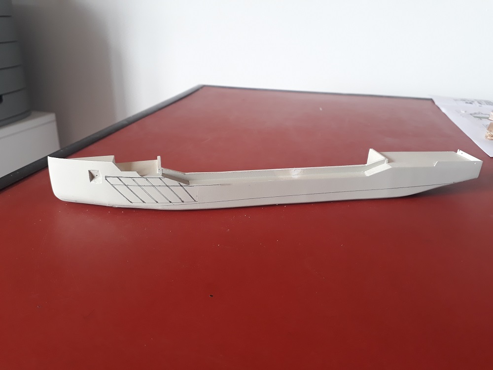

So it was time to apply the milliput cover and shape the bow and stern areas. Even after so many models I have never succeeded in doing this in one go. After sanding there are always dents or places where I need to add Milliput. On the other side, you can't put a huge blob of it everywhere as that would take a long time of sanding (and more risk of damaging the styrene structure in the process).

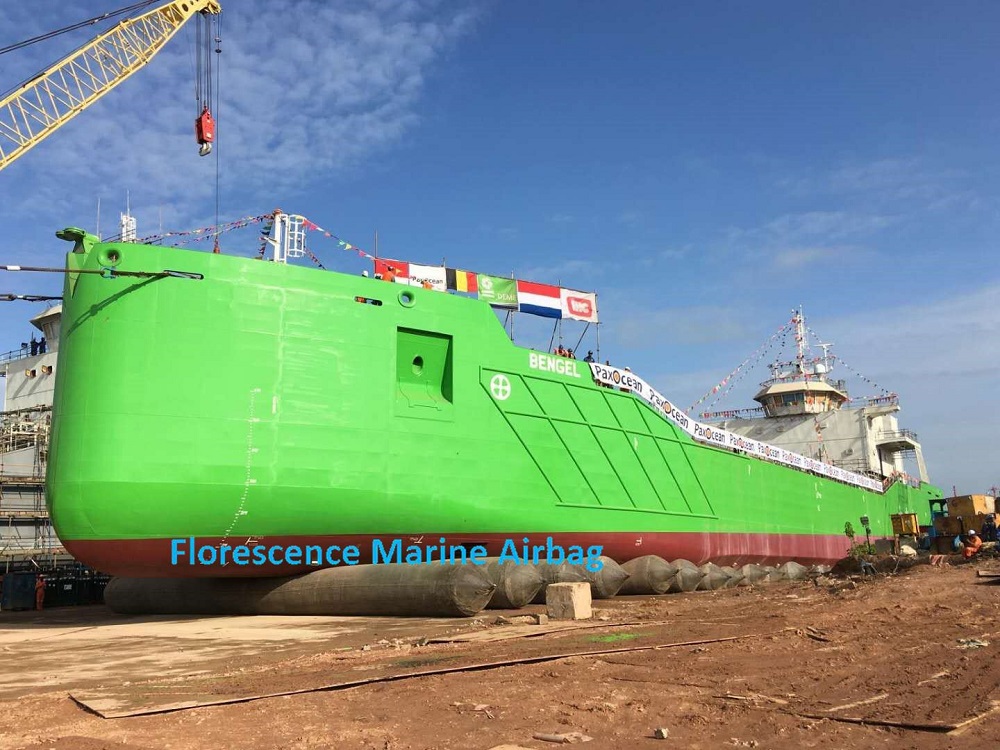

Based on below picture I assumed the hull was narrow enough to have only the bottom plate as a bow thruster tunnel bottom, however after sanding it just didn't seem right. After revisiting some info, I did figure it needed a real bottom. I put a small 0.5mm bottom plate on the tunnel, then inserted a beam the side of the tunnel to support everything and applied more putty to smoothen the whole thing with the rest of the hull. Now it seems right.
Additionally it seems the suction of the thruster is from the bottom, and use of the thruster is simply directing the jet towards one side or the other. There is also only 1 thruster, the other part of the hull simply has a tunnel. This type of bow thrusters is often used in inland navigation ships, occasionally also with an opening forward (like a 3-way valve) to help in stopping the vessel.
The hole in the bottom of the model is an overflow, a second one, on the starboard hull part is aft. You want to move sand/stones, not water, so there are two adjustable overflows which allow the material to settle while the water flows back to the sea through these overflows via the bottom of the vessel.
Currently I'm somewhat stuck on the hull due to lack of spray putty which I use as a final coat before sanding it very finely. Continuing on superstructures and base first now.
File comment: After drying, the raw material.
File comment: After initial sanding with coarse grain.
File comment: One side sanded, one still raw
File comment: Something's off here... That bow thruster doesn't look right.
File comment: Real thing, note the bow thruster tunnel behind the text.

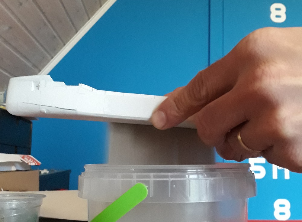

First I did a Sand test with the hull to see how it would come out. Secondly I already produced the base for it. Chose for an irregular base with an upstanding piece of Vivak plate. Initially I was going to make a full curtain, as shown on the test, but then I decided to first try with a partial curtain, like in the very beginning of dropping, creating a transparant piece between the actual bottom and the sand curtain. If it doesn't look right, I can still make it a full curtain to the bottom.
All major superstructure parts (including the forward deckhouses) are now built in the rough form, time to start detailing them. I'm also busy with the aft thrusters and final shaping/sanding of the hull. I will then first apply the spray putty and only after that I'll start making the fender framework on the hull as well as the holes in the bulwark etc.
In the meanwhile I also found a good movie of what I suppose is either Sloeber or Pagadder, one of the older sisters, which shows the whole project from loading from a Cutter Suction Dredger towards the discharge/opening of the barge.
https://youtu.be/KBoPBlLRIr0
File comment: On the jig with the fully opened angle
File comment: Temporarily mounted on the stand, emptying would obviously create a trim, so I put a very slight trim on the stand as well.

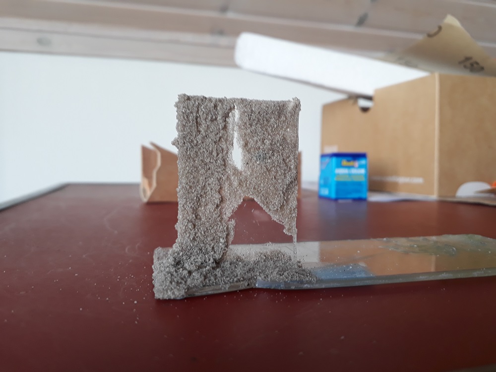

Not sure on that plan. I believe the CA would dry too quick to get to a decent result. With the acrylic, I just mix the sand in, like you would mix paint and then apply it. Then there are 2 options, or you leave it be, and you get a wet sand look, or you just keep adding sand on top of it, later on remove the excess sand, and then you have a dry sand look.
I tried to peel off the acrylic mixture, but it's too flexible to stand on its own.
In any case, I have two options, 1 is to make a partial curtain, simulating the beginning of the dump, or a full curtain. I'll try the first option first, see what it looks like, and if I don't like it, I can still complete the curtain all the way down. Below is the test piece for this.

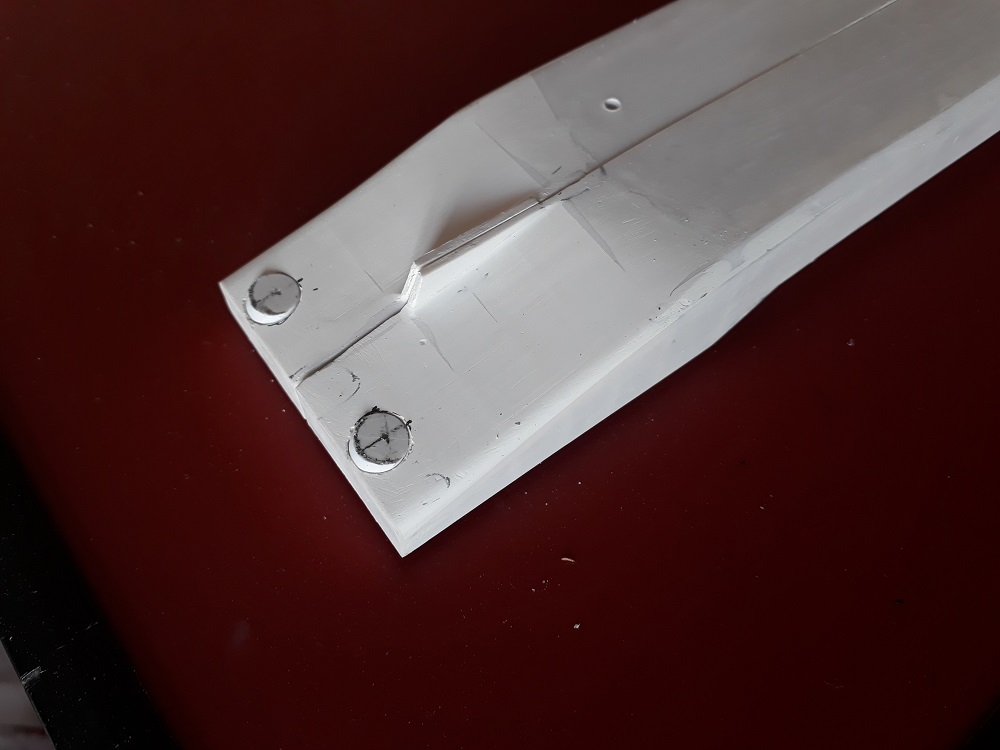

Also started on the base of the propulsion pods. Each hull half has its own engine room and own propulsion pod. They are mounted a flat base plate to enable a smooth rotation.
I will have to finish it with milliput, along with some tiny blemishes, before I apply the spray putty.

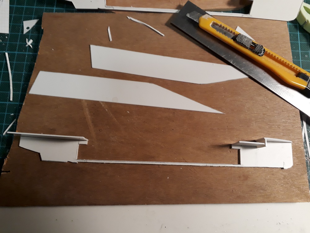

Succeeded in making some smaller items, like hatches and small deck houses as well as the angled roof of the bridge.
Additionally I've finally obtained the spray putty, from a car store and continued on the hull including the aft bulwarks.

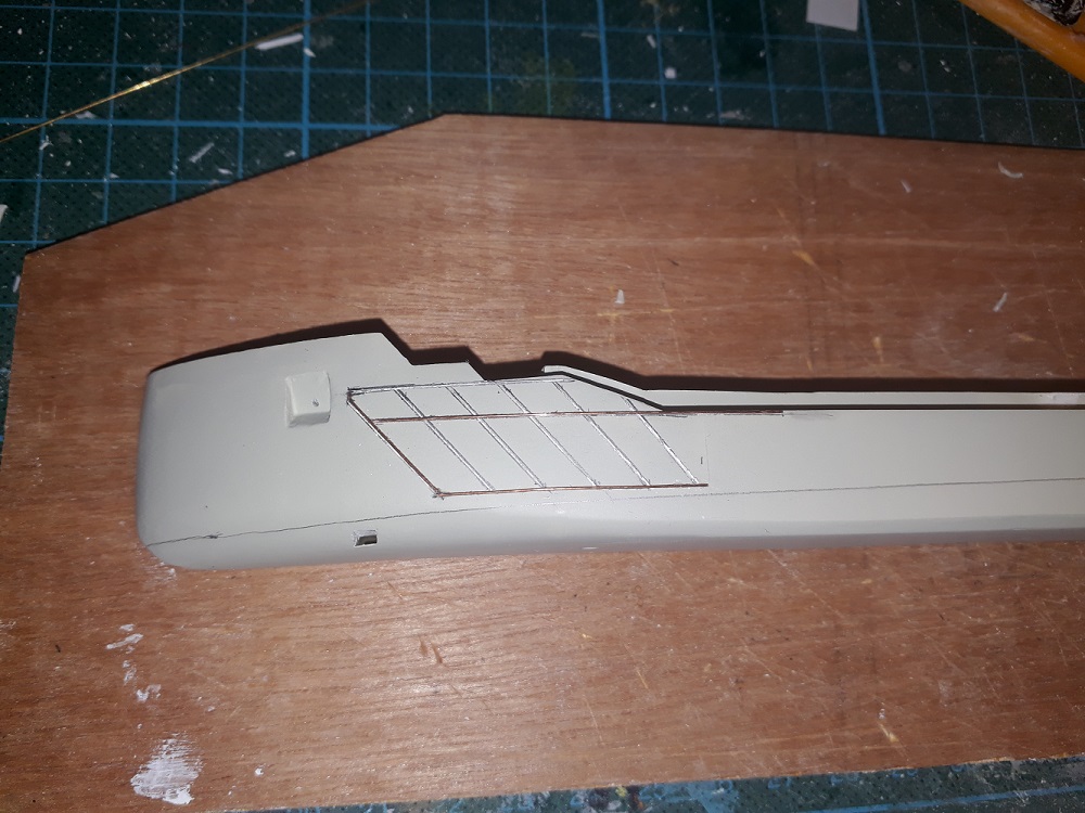

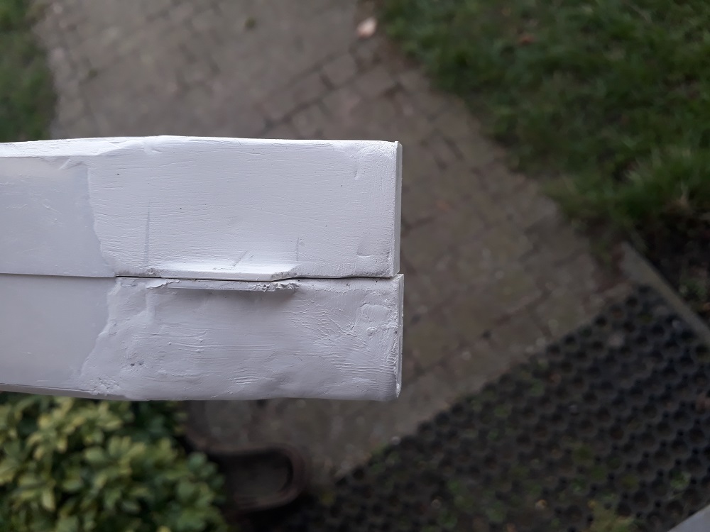

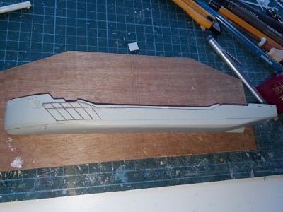

in previous pictures the "curtain" (which is basically steel fendering to protect the hull against damage from mooring against a rapidly swinging mothership), wasn't attached yet. It was just drawn on the hull. I then scribed it in and laid a 0.3mm straightened copper wire in it.
Due to 1:1 scale work, this project is on the back-burner. However, I did install the curtain and aft bulwarks on one side, and I'm slowly continuing with the second side. I'm nearly ready for paint. Also been testing more green-yellow mixes to get closer to the actual DEME colour. It was an issue with the Living Stone build and still remains an issue now. On Living Stone I used a Motip Spray can, but that was glossy and too thick, so I want to avoid that now.
You can see the waterline also marked on it. Since the ships have a very shallow draft forward when they are in empty condition, their anti-fouling is painted accordingly.
File comment: Fendering partly finished, partly scribed.
File comment: Fendering in place as well as the bulwarks and their openings. This part was then given a grey primer coating (pictures will follow).

How did you do the scribing in? Do you used a ruler to guide?
It appears to be difficult because of the bending of the hull there.
