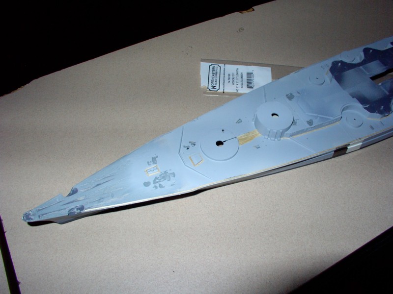

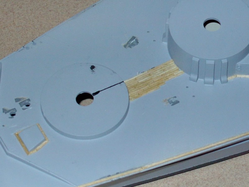

Amongst the zillion other projects I'm dabbling in, I've started on this bit of madness as well - planking the deck of the Tamiya 1/350 Bismarck with real wood. I only plan to plank the main deck, and use the WEM photo-etch superstructure decks for everything above the main deck. The margin planking is 1x3 planks (HO scale), while the deck is 1x2, cut to 1cm lengths.
To date, I've got most of the margin planking (which runs along the bulkheads and deck edge) down. I've also started laying some plank on the main deck, just to see how it looked. I'll finish the margin planking before I go any further with the main deck.
I figure this should keep me busy during lunch for the foreseeable future!

A few progress pictures...
I used up all the planks I had pre-cut....time to get the chopper out!
