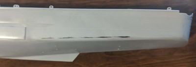

While the raised hull strake lines are better than the Trumpeter/Merit CV-5 Yorktown/CV-6 Enterprise strake pattern, I still wasn't happy with them and have been working to replace them. Simple enough, draw along the raised lines a couple of times with an XActo to make a recessed line, and then sand everything raised down (I'm leaving the armor belt(s) ). The goal is subtlety.
Doing so revealed one area on the stern where there was a touch of a depression. I've filled it in with black Mr. Surfacer here just to make it more apparent:
File comment: Port side
You can see faintly the lines that are left (and filled with sanding dust). I've got the hull about 80% done, just need to finish the starboard stern section aft of the armor belt.

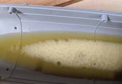

I prefer to have something to drill into to mount the models firmly (plus they just feel a touch "better" with some heft) so yesterday I put in about 5-6mm of resin.... just enough to not have to worry about the prop shaft strut mounting holes:
File comment: I love it when it kicks.....
I need to find a good piece of wood to mount it to before I drill the holes - going to try some places if I get out this week, otherwise I'll finish up the hull and start working on the midships AA tubs. I have some detail parts from Black Cat Models in the mail to wait for as well....

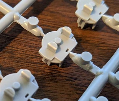

Here's kind of "a" state of things. Bridge levels are off to ModelMonkey so that Steve can make some replacement bridge wind screens. Looking at the main deck and 3" gun tubs to plan things out for construction and painting:
Given the tolerances in today's kits my gut tells me that the tight fit of the inboard edges of the tub platforms to the superstructure when held in place indicates that paint will cause issues. Yet, if I clue everything first and then try and mask the deck for multi-colored planking there's going to be a lot of work in difficult masking and even paint application. Still thinking through options.
Also would like to point out that there are slight depressions (sink marks) on both sides of the super structure around where the cross-braces visible in the photo are. If you look closely you can see a bit of Mr. Surfacer there - one coating was enough. There is also a sink mark on the forward starboard funnel where there is an alignment pin. Also a single layer of Mr. Surfacer thick and easy to take care of the same time one is filling the seam between the two halves. These five plus the hull one mentioned above are the only I can remember seeing in all of the kit off the top of my head.
The 3" gun tubs are largely one piece, but there is a separate bulkhead piece for each underneath the tub itself. There were knocking pins on the backs of these on all cases that needed to be sanded down for a tight fit and two of the tub pieces had a small raised knocking pin on the underside that interfered very slightly with placement. All were pretty easy to fix - the two that had the obstruction on the bottom of the tub were too tight to work in a sanding stick or file, so I merely sanded the top joining surface at an angle so the front was the same height, but the hidden back had more clearance.

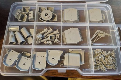

Here's the sum total of sanding implements I've used on this build. Fairly standard tools I imagine. The files have only been used for clean up of the details like the Ml 37 and Mk 56 directors. The "heavy lifters" for the majority of the work has been the two larger pink sticks on the bottom. They all were from my local hobby shop, which has a plastic holder of these things from Stevens International in various grits. These are the ones I use most, which I think is 400-600. The coarser grits are more reserved for big shaping projects, such as the Merit CV-5 (plated) hull or any of the badly fitting Trumpeter hulls that need a ton of filler and re-shaping. For something like this I'm more likely to stick to medium grits or higher.
*EDIT* Don't forget the picture, dork!

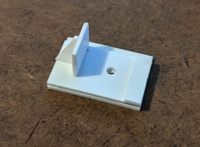

More progress - Search and Rescue was able to make contact and extract my drill bits from the garage so I was able to start in on the AA guns. My eye is critical towards things that don't line up, so quad 40mm mounts or galleries of 20mms with guns at different angles make me itch. My solution has been to build jigs for the different guns so that they all come out the same. Generally just some thick styrene with a hole drilled for the mount and then a vertical piece that I move around until it looks "right" for what I want.
The angle piece is both to stabilize but also for a convenient grabber for the tweezers for while I'm moving it around. The raised flat on the opposite side of the hole was a flat piece I pushed up against the mount base and glued in place so that all of the mounts are at the same angle and square.
In use:
One can use a saw blade or triangle file to make some grooves on the top for the barrels to rest but generally I've found I can position them well enough to not have to go this far.
