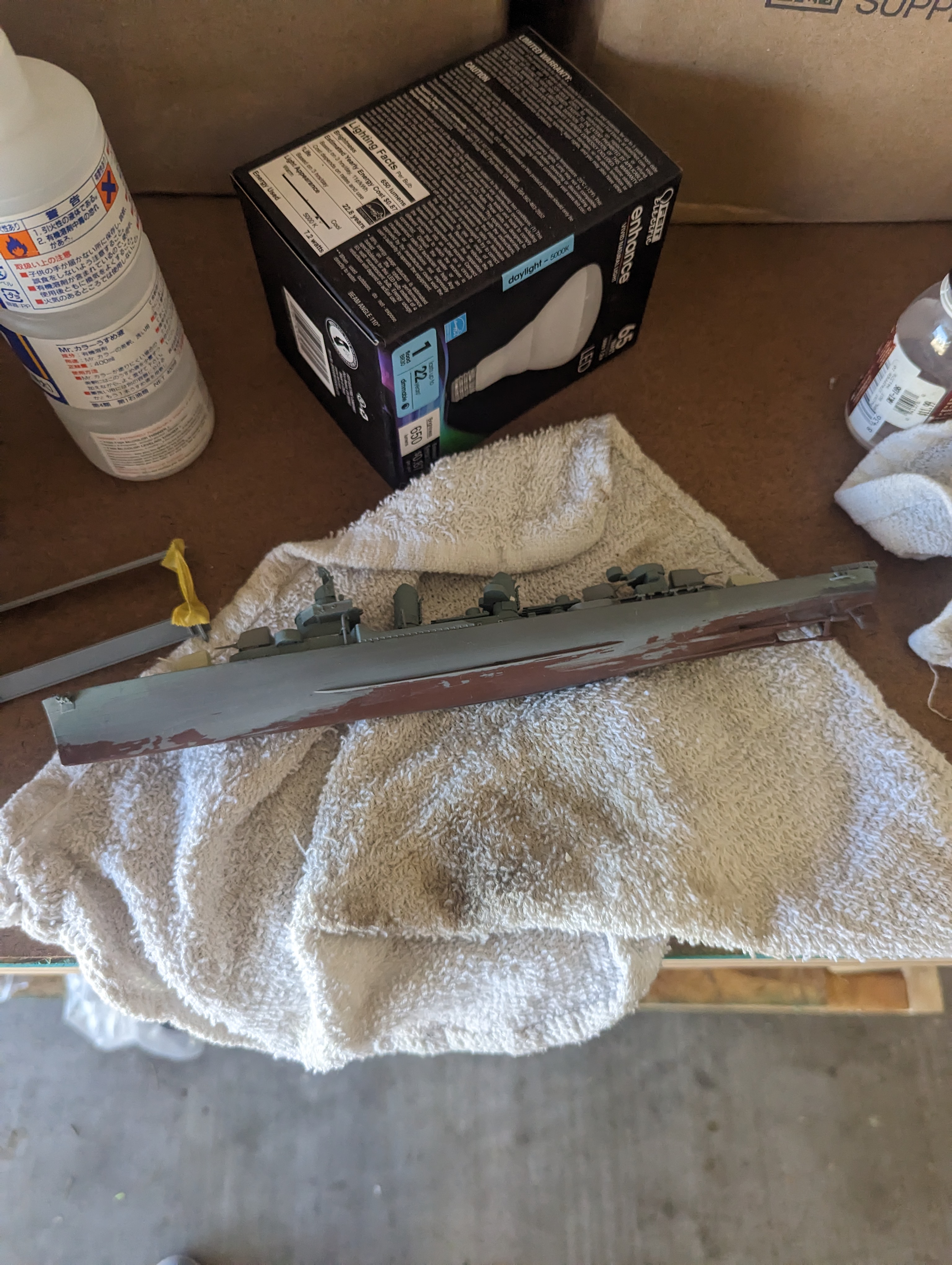

So I've started my first ship build after about a 9 year hiatus. Going to build, well refurbish a kit I bought at a local hobby swap meet for 5 bucks that was started and part painted already
. Going to build USS. Jenkins in Mid 43' got new weapons on order. And found I have to add aft 40mm tub and a centerline 20mm platform outside under bridge windows?
So far been ok except every paint stripping product I tried didn't work lol. From Laquer Thinner. brake Fluid, Brake cleaner to AK Paint Stripper. And the resin guns don't look right.

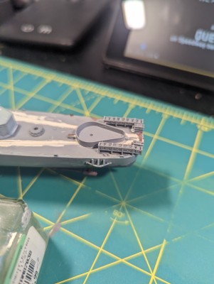

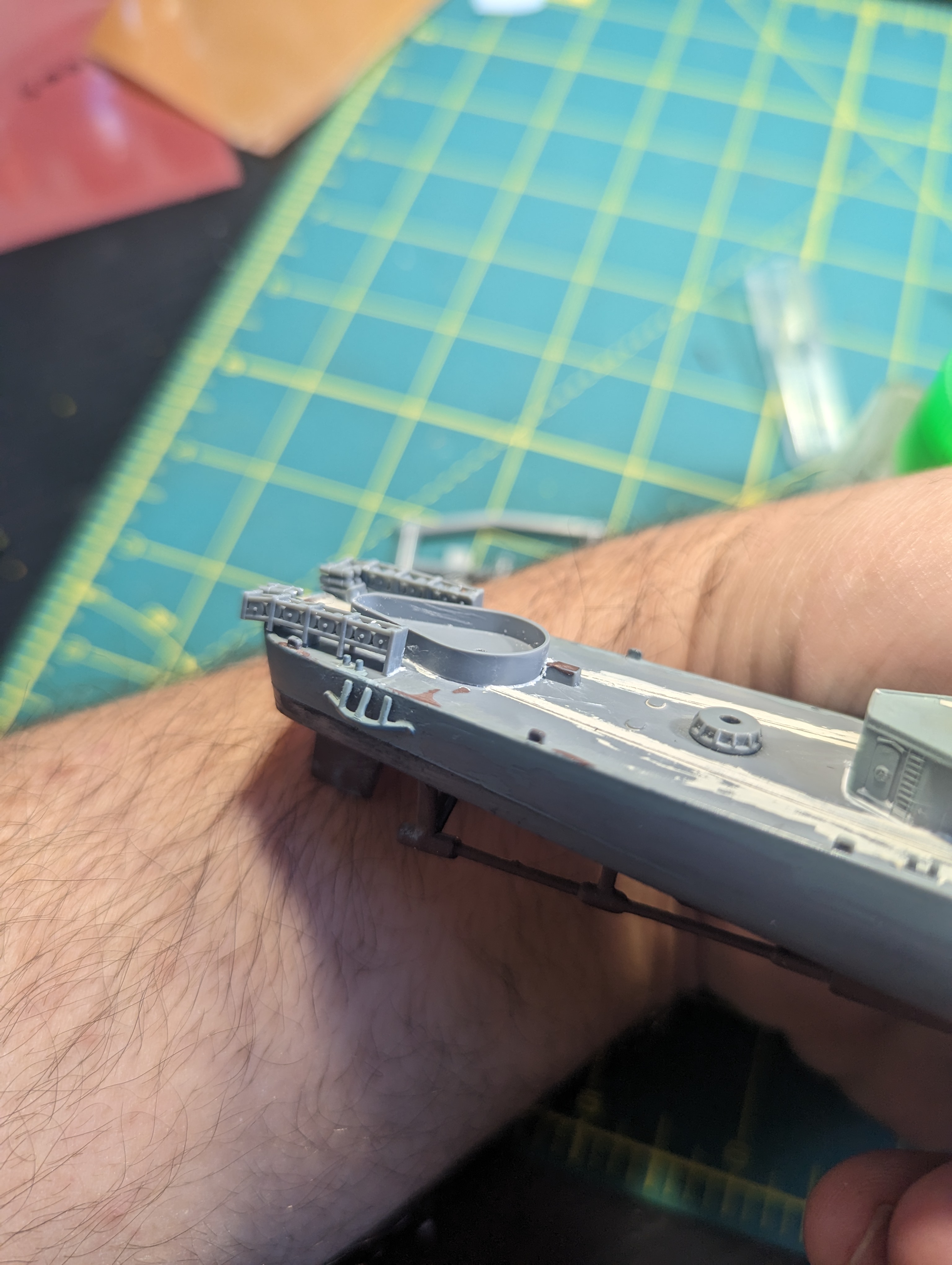

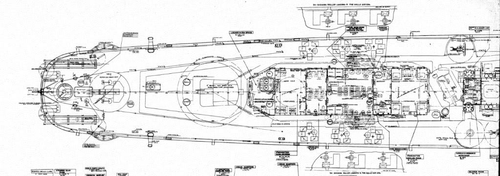

But my Hang up right now I think the 40mm aft deck tub is too far forward per my reference attached I think. So any help guidance would be awesome on that.

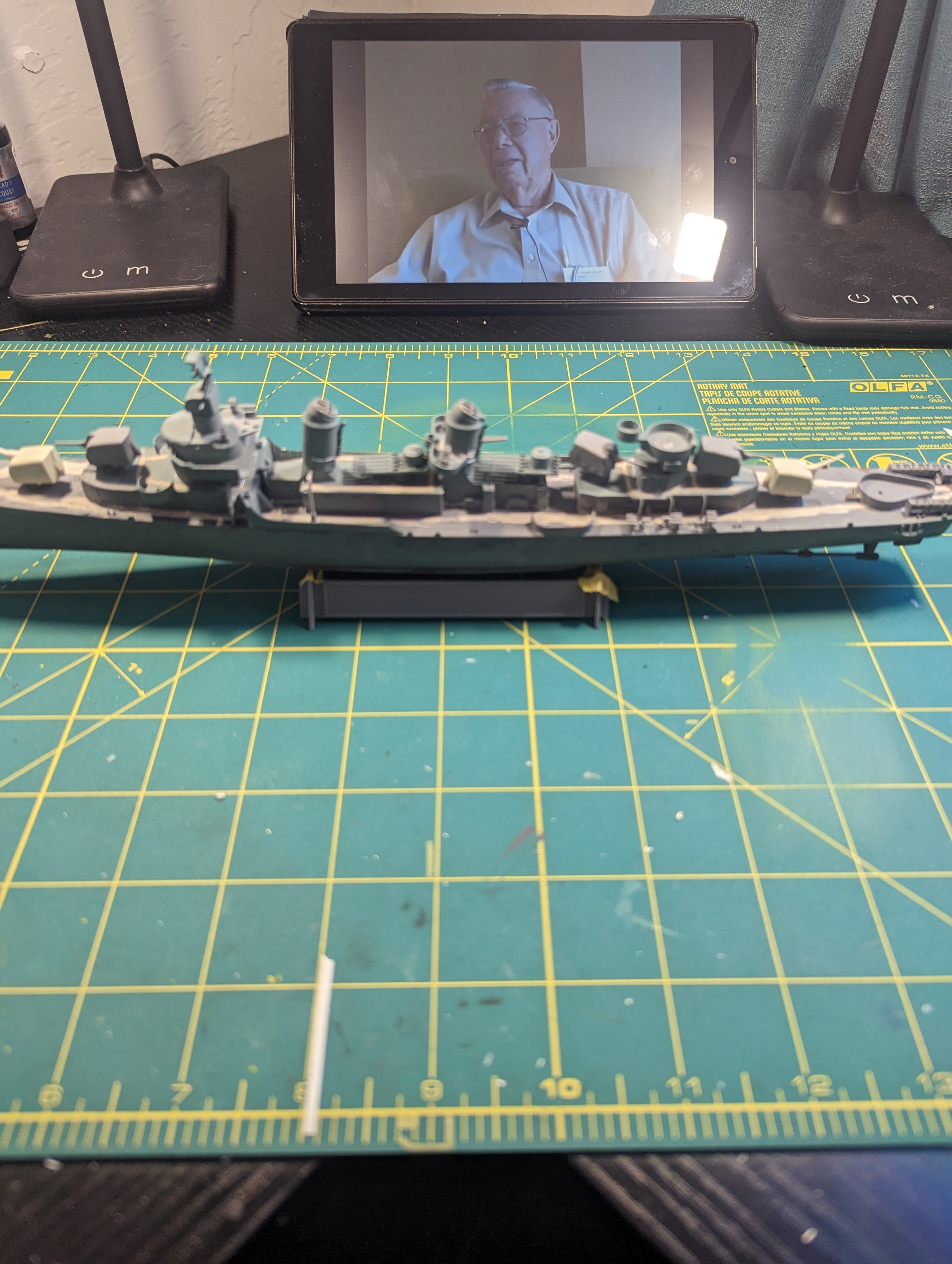

I thought the tub looked a little forward. How do I measure the Tub?? It's on by Putty in case I had to move it, second question for the aft 40mm I see the gun but is the director in the front in the small area closest to the smoke makers???? I can't tell. The 5" guns I think are Lionroar, they were in a Ziploc baggie. The guns looks to high or something. 5th picture. Ahh did not use easy off. Maybe I'll try that next.

I'm going to start with this question; Are you building for the fun or are you going to try and be as accurate as is possible?
What I recommend will be different depending on the answer. The Tamiya FLETCHER 1/350 scale kit (as well Trumpeter's THE SULLIVANS kit) has several errors, missing equipment or flat out wrong equipment (example, they included a "rectangular" SC-2 radar antenna when it should be a "square" SC-1 antenna). Placement of the aft twin 40-mm "tub" location is the least of your problems.

The issue of replacing the too small 5-in gun mounts on the Tamiya (or any kit) is to look at the foundations. The Tamiya kit has mount foundations on the deck. Some replacement resin and 3-D printed guns come with the foundations "on the mount". Hence if you simply install the mount on the kit as is, the mounts will be too high. I ran into this problem on the kits I have built (or rather started, I don't seem to actually complete a build?). This can apply to the 40-mm gun mounts as well. Removing or otherwise make adjustments is needed. Also, the forward mount, 51 mount, is on a steep sheer and the foundation needs to be shaped to level up the mount.
