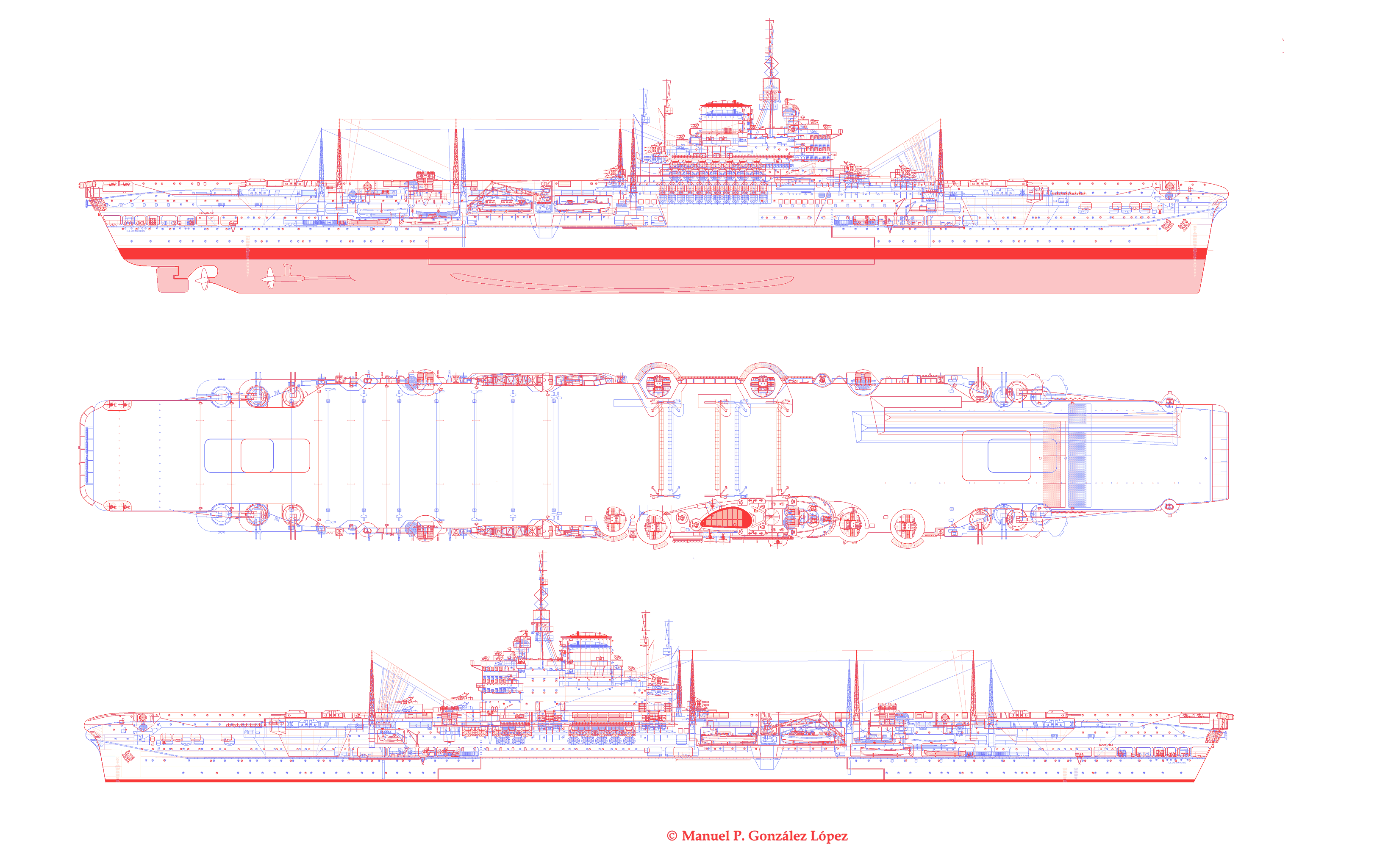

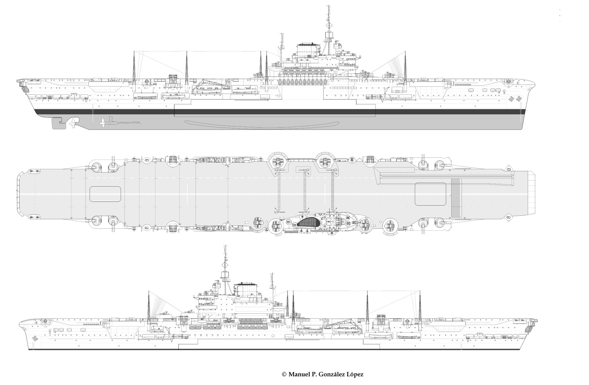

PostPosted: Sat Sep 04, 2021 10:35 am
Joined: Thu Jan 20, 2011 11:21 am
Posts: 109
Location: Madrid, Spain
Hello
My drawing can be interesting for you. Send me a PM for the full size file.
Regards
PostPosted: Sat Sep 04, 2021 4:20 pm
Posts: 1558
Location: England
Fantastic, thank you! I already spotted a few small detail differences I missed earlier. The size is fine for me, the red/blue is the most useful and is pretty big already.

Vlad wrote:
Disclaimer: this is getting very ugly before it hopefully gets prettier again.
That's some crazy modelling operation going on here, i can smell the enormous amount of putty already XD
Now i really look forward to the day she gets to be pretty again!
PostPosted: Sun Sep 05, 2021 5:52 am
Posts: 109
Thanks
My sources are:
- Victorious (Ross Watson)
- Aircraft Carrier Victorious (David Hobbs)
- Low resolution plans of the RGM (https://collections.rmg.co.uk/collectio ... 58385.html)
- https://www.armouredcarriers.com/
- Photos of the FAA museum model (I have many from different sites)
- Indomitable pictures (unfortunately, I have not many good pictures)
Some details are extrapolations from the Illustrious class.
This drawing is in constant revision, as it must be part of a book in development. If you see any details that are incorrect, please do not hesitate to tell me. I am interested in improving the drawing.
Regards
