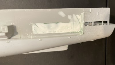

The first step was start removing all of the unnecessary sponsons and inaccurate chunks of plastic from the hull.
File comment: Starboard Bow - All lumps forward of the quarter deck removed.

File comment: Port Aft - Sponson removed

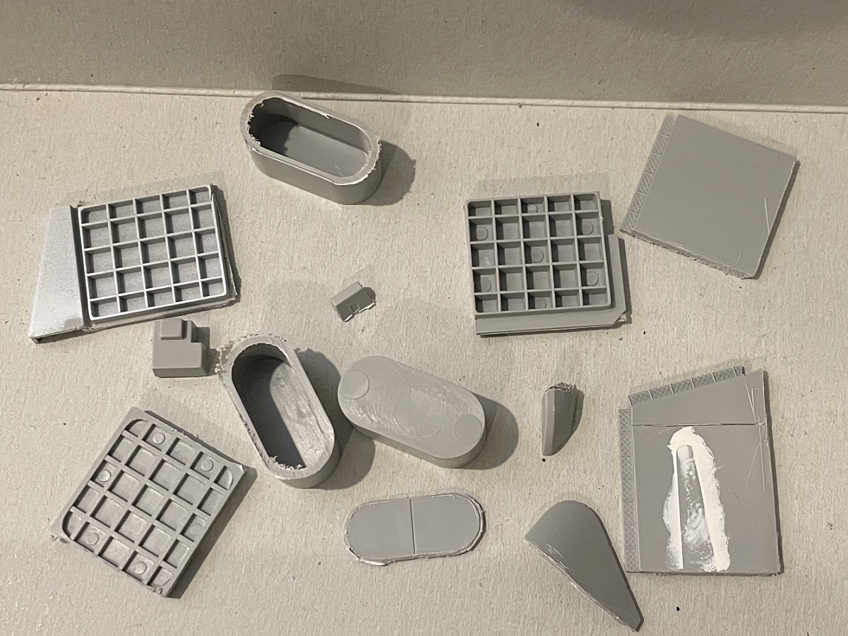

File comment: Dead Ranger Parts
