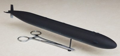

I’ve been sidetracked with several other projects, but decided to try to make some progress on this one so I can finish it up. Since I am more or less building it out of the box, it shouldn’t be as difficult to complete as the other builds I’ve posted threads on here. Here’s some photos of the latest progress.
File comment: I've painted the upper half of the model with a mix of acrylic flat black and flat blue. I'm hoping to capture the slight bluish tint actual submarines exhibit in daylight.
File comment: Next, I'll paint a homemade mixture of flat black and flat red from the waterline to approximately the mid-hull. If you look at photos of the ships in new construction, you'll see this area has a reddish tint because of anti-marine fouling paint.
