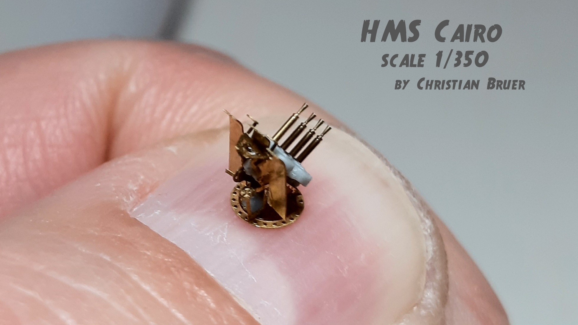

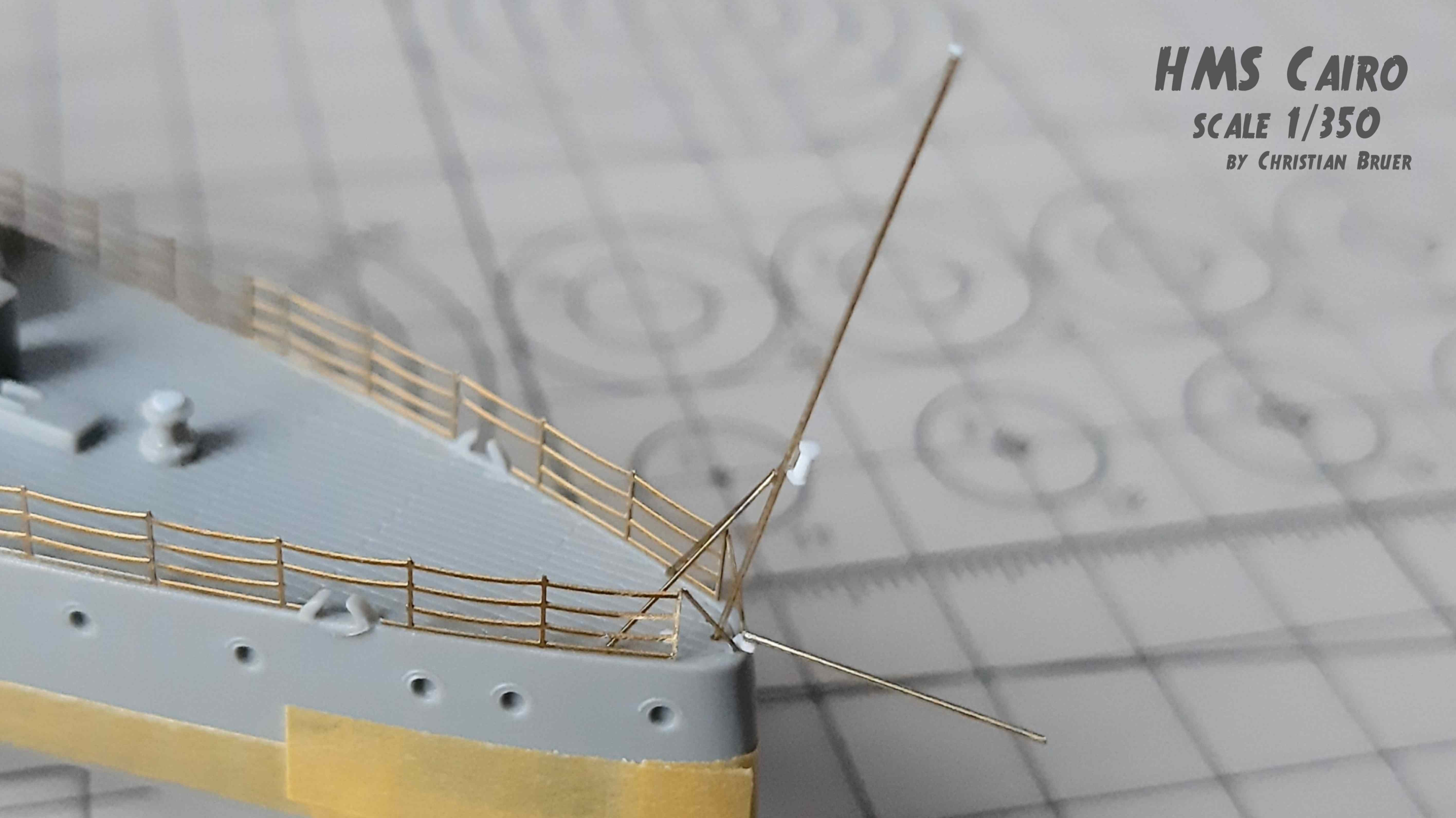

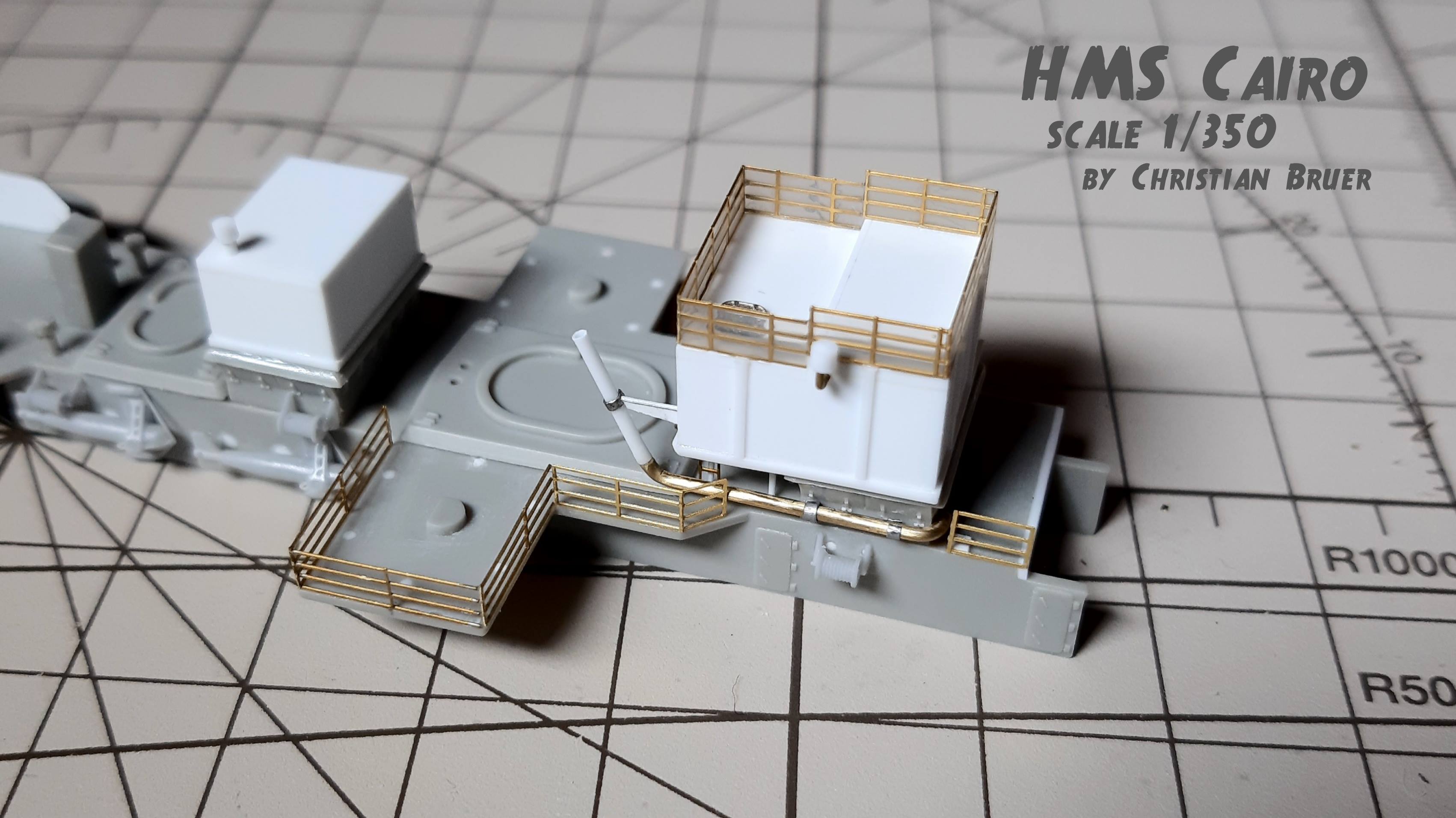

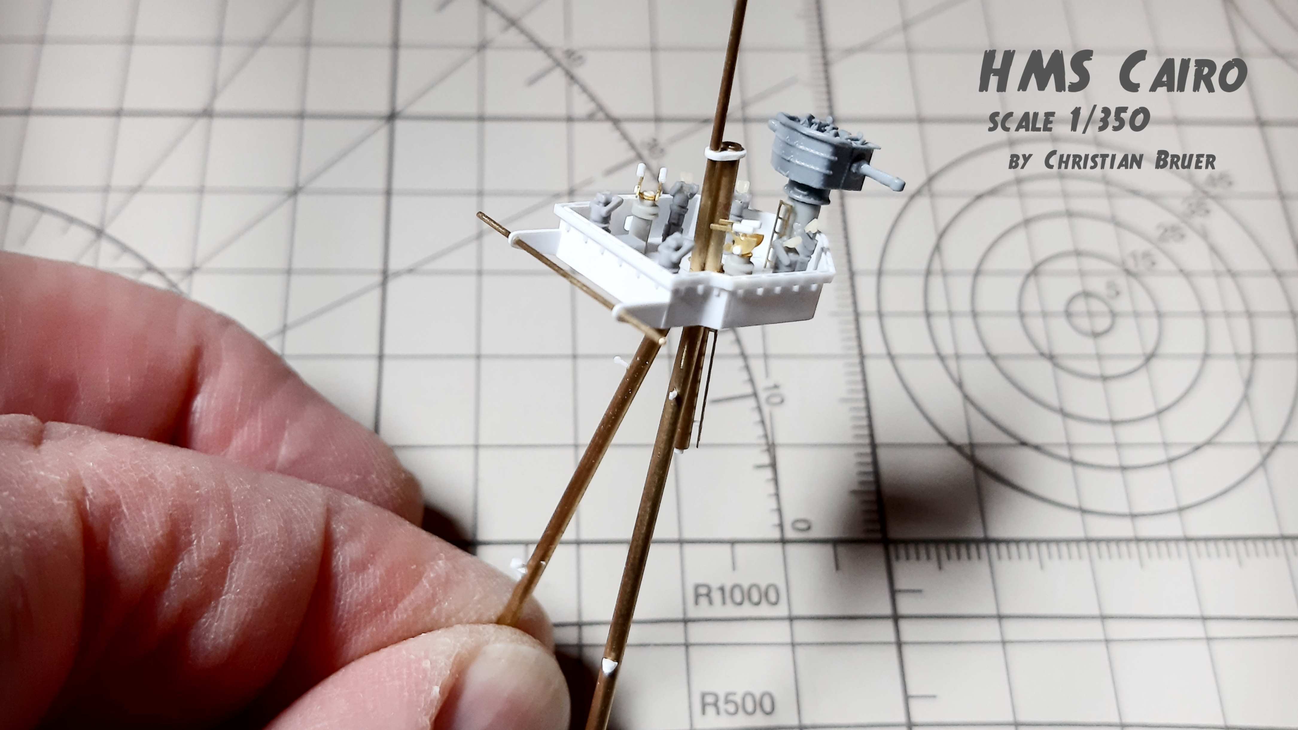

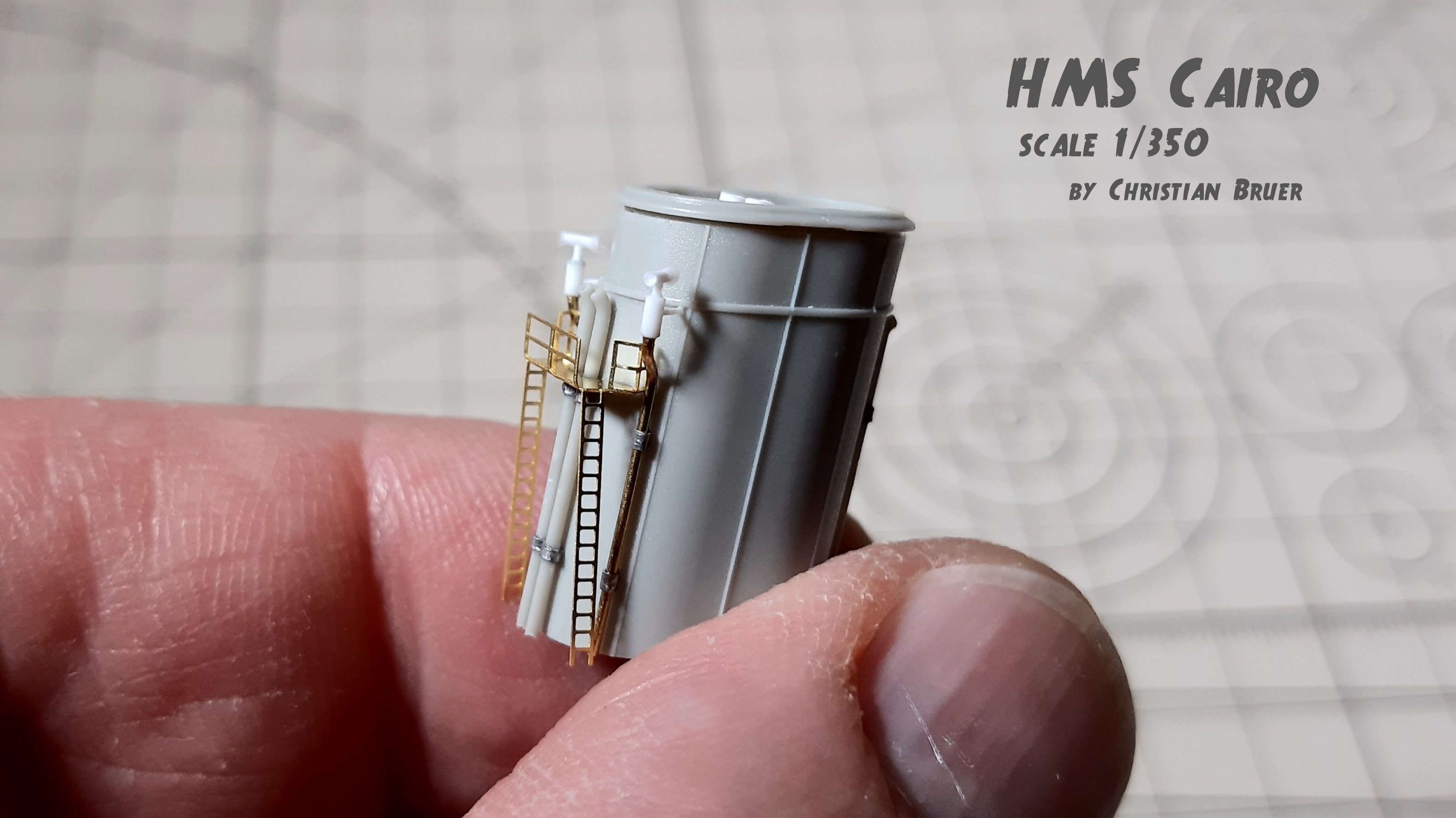

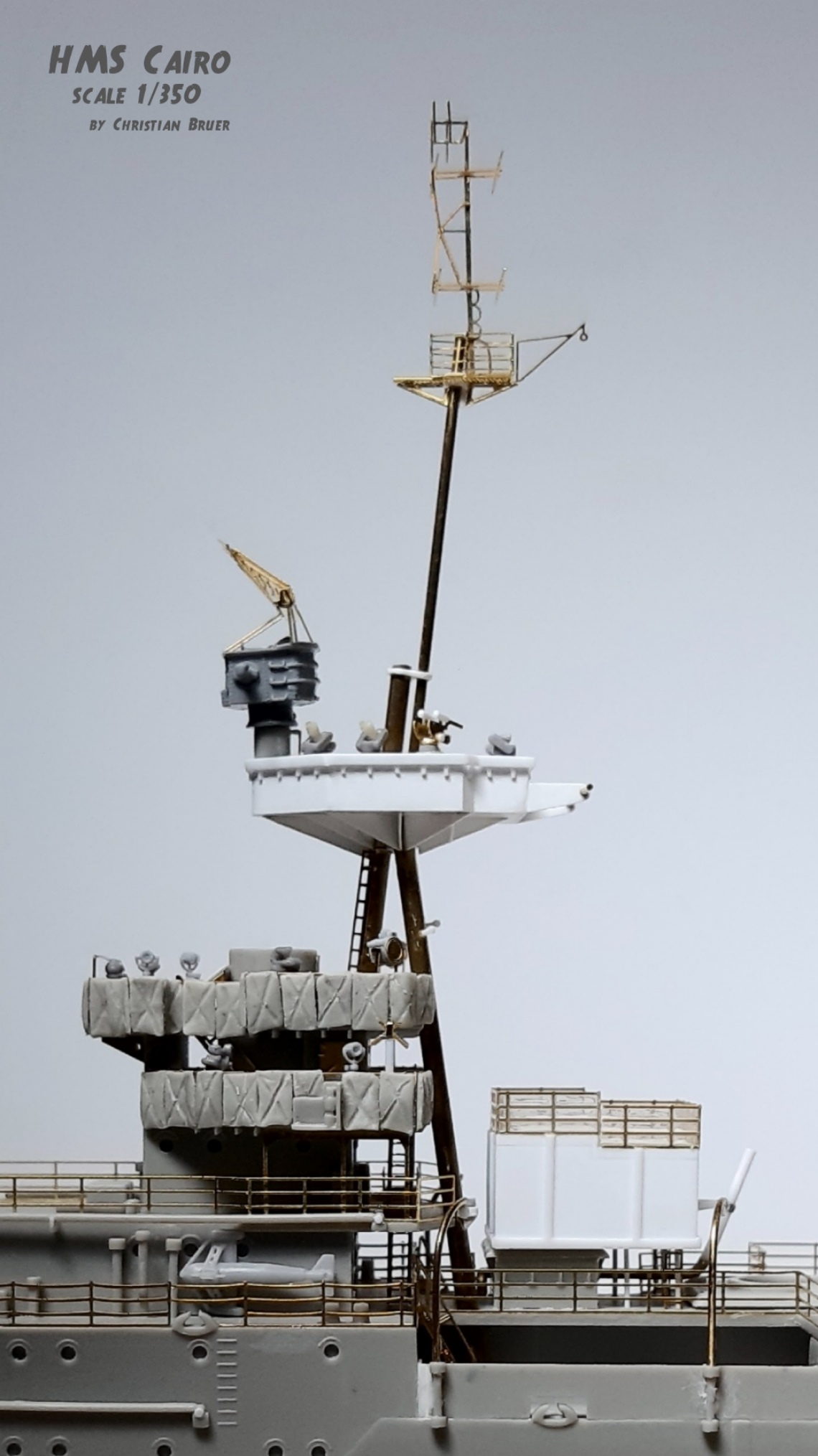

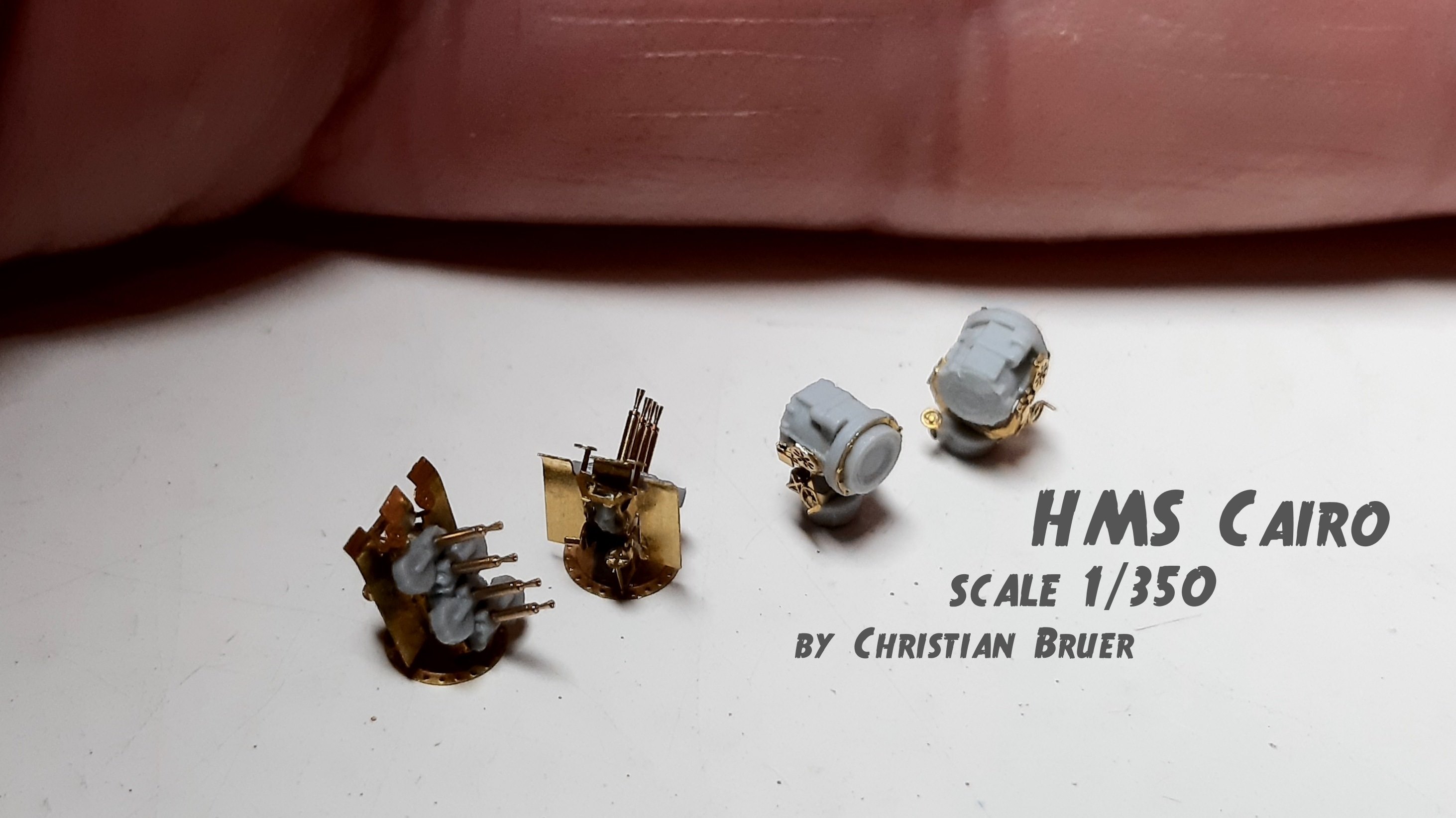

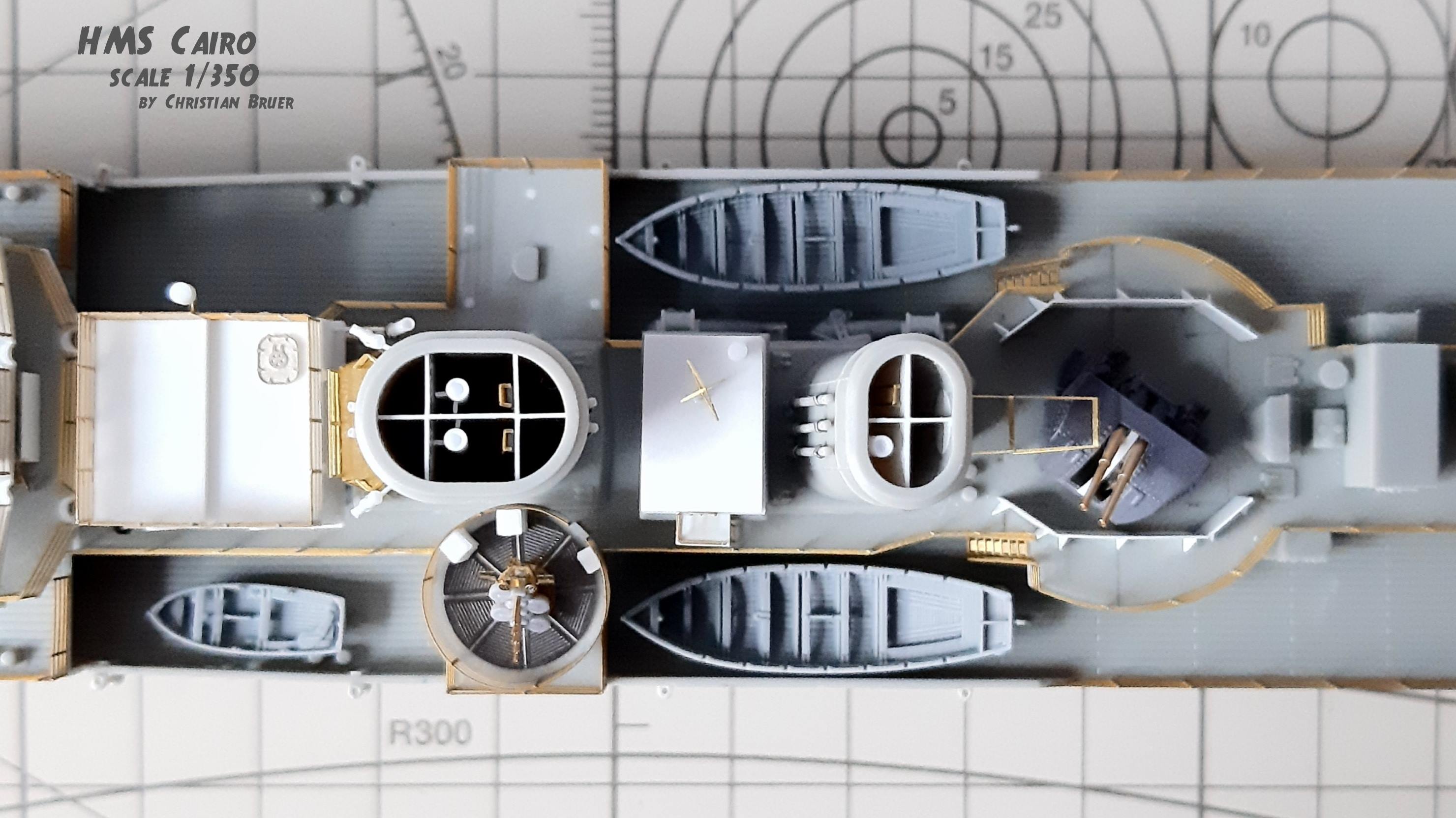

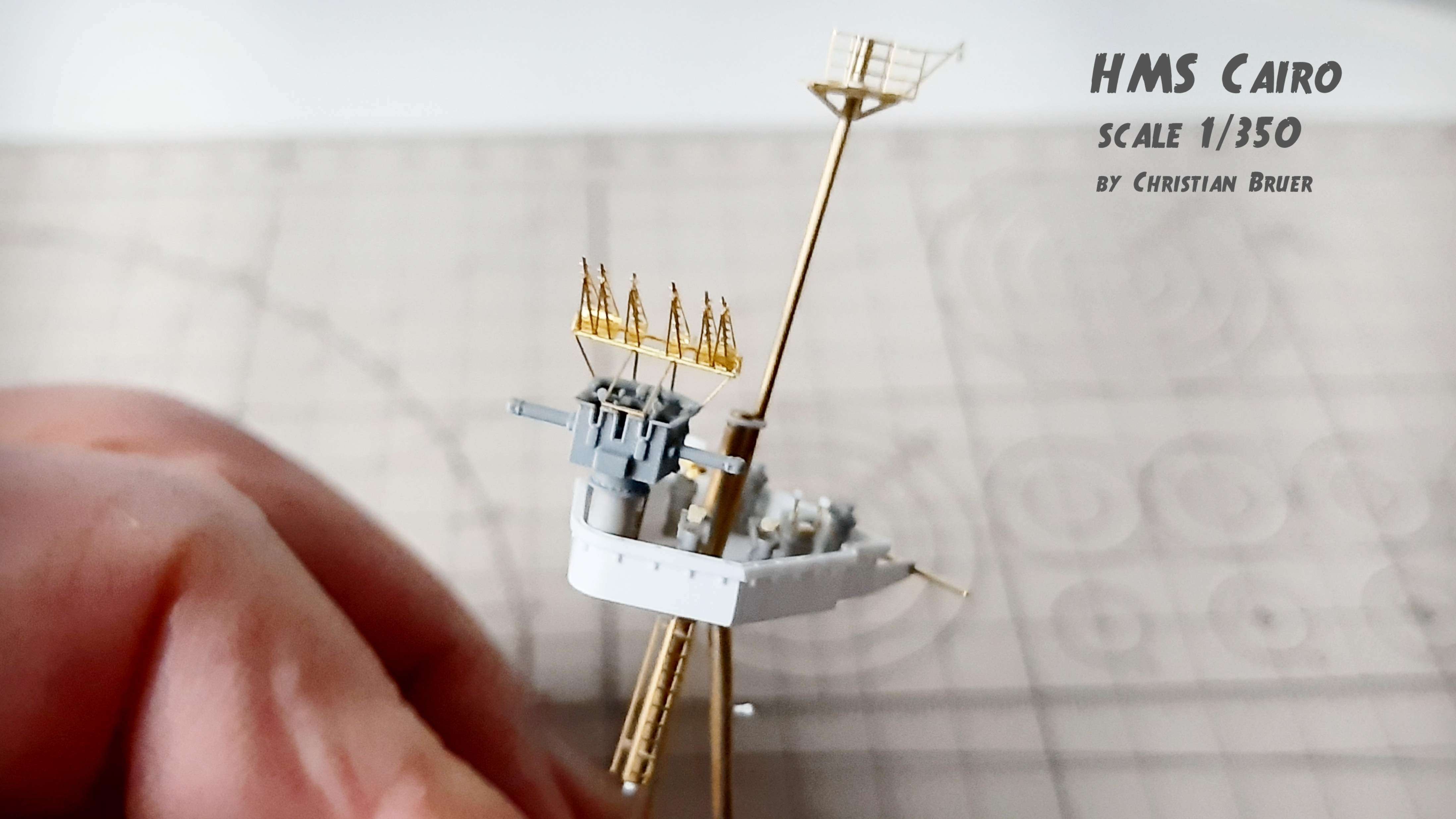

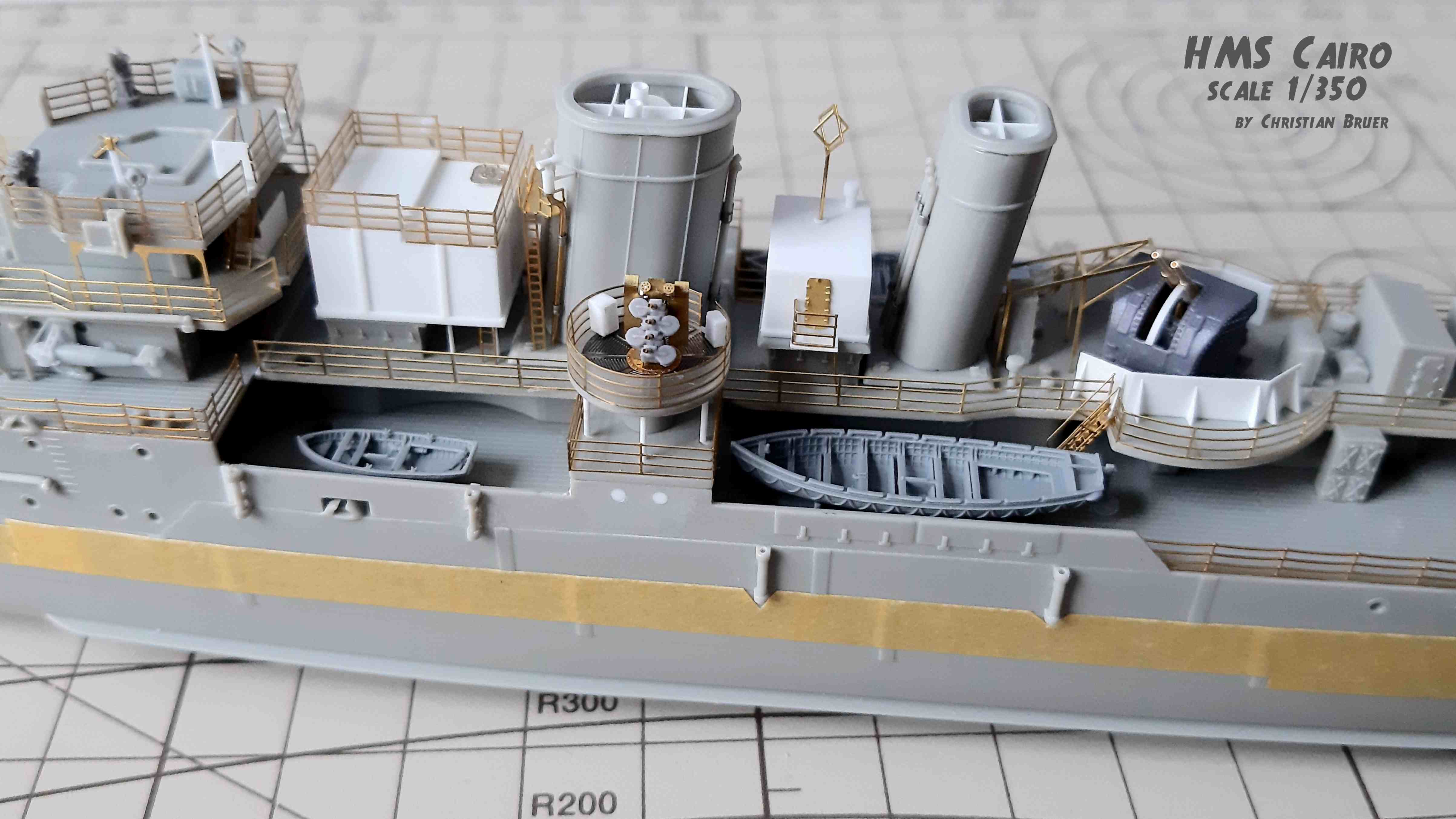

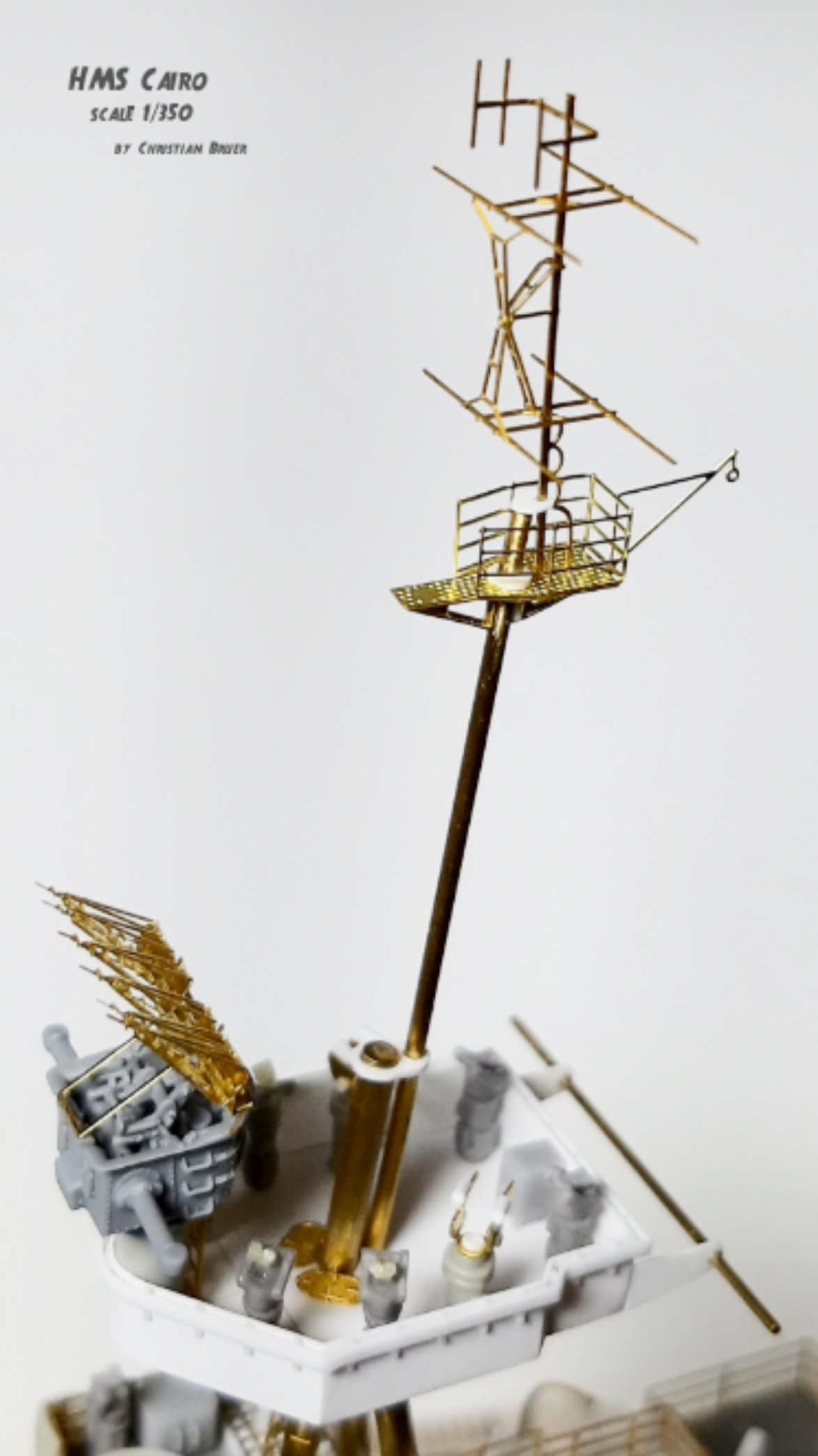

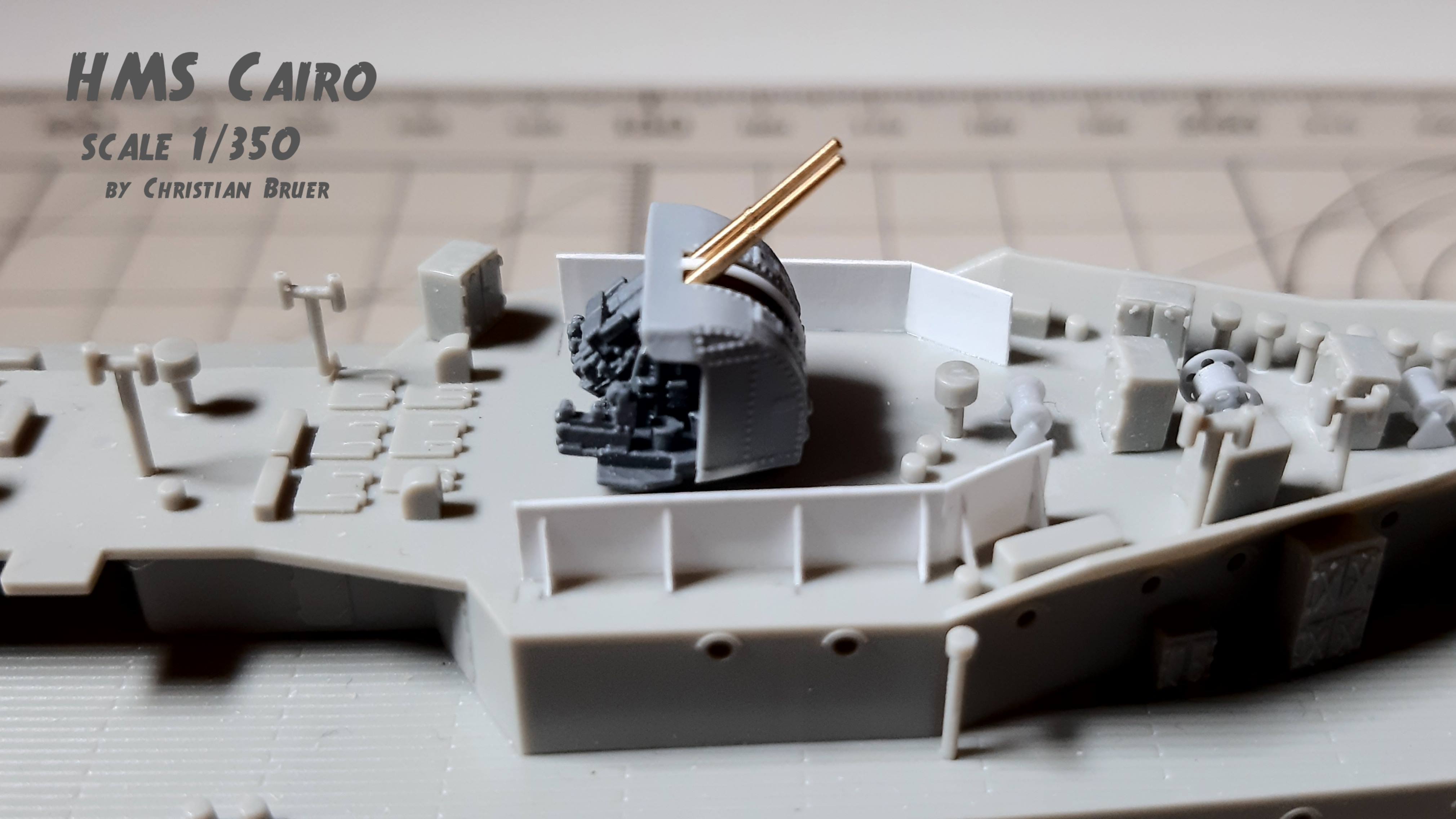

After a long absence from ship modelling I am back in the modelling yard with a conversion of Trumpeter's HMS Calcutta into HMS Cairo in her early 1941 outfit.
For a coversion into her 1941 configuration are the following modifications necessary:
- A shelter type structure aft of the bridge (housing for Type 279 air warning radar machinery and office?)
- A shelter structure in between the funnels (also a radar office?)
- Splinter shields an all 4" gun positions
- New fore mast platform and extended fore mast
- Type 279 air warning radar on fore and main mast
Other modifications and replacements of kit parts are:
- 4“ Mk. XVI Twin Mount, North Star Models
- 2 Pdr. Quad PomPom, Black Cat Models
- 0,5“ Vickers Quad, North Star Models
- HACS Mk. III direction finder, Micro Master
- 27ft Whaler, Micro Master
- 32ft Cutter, Micro Master
- 16ft Sailing Dinghy, Micro Master
- 8ft Carley Float, Micro Master
- 14ft Carley Float, Micro Master
- 36in Searchlight, North Star Models
- Bridge equipment, North Star Models
- RN anchors, North Star Models
- Paravanes, Black Cat Models
- Type 279 Radar, KA Models
- RN railings, Flyhawk
Some other modifications are done or are in progress using brass and styrene, like fore and main mast from brass rod, structure, pipes and ladders inside the funnels, steam pipes, replacing of bulwarks and splinter shields at the bridge and searchlight platforms, support structure below each bridge deck.
Still in progress, flag staff and davids will be made from brass rod, splinter matting from styrene, additional ladders from different PE sets.
The conversion is based on a few photos and information and because of the lack of more detailed information more or less guesswork and interpretation. I hope to come as close as possible to represent this elegant type of ship.
Happy Modelling, Christian

You are off to an amazing start, such clean scratch building always impresses me and makes me envious. Been seeing your posts on Facebook and glad to see it here now to better track along.

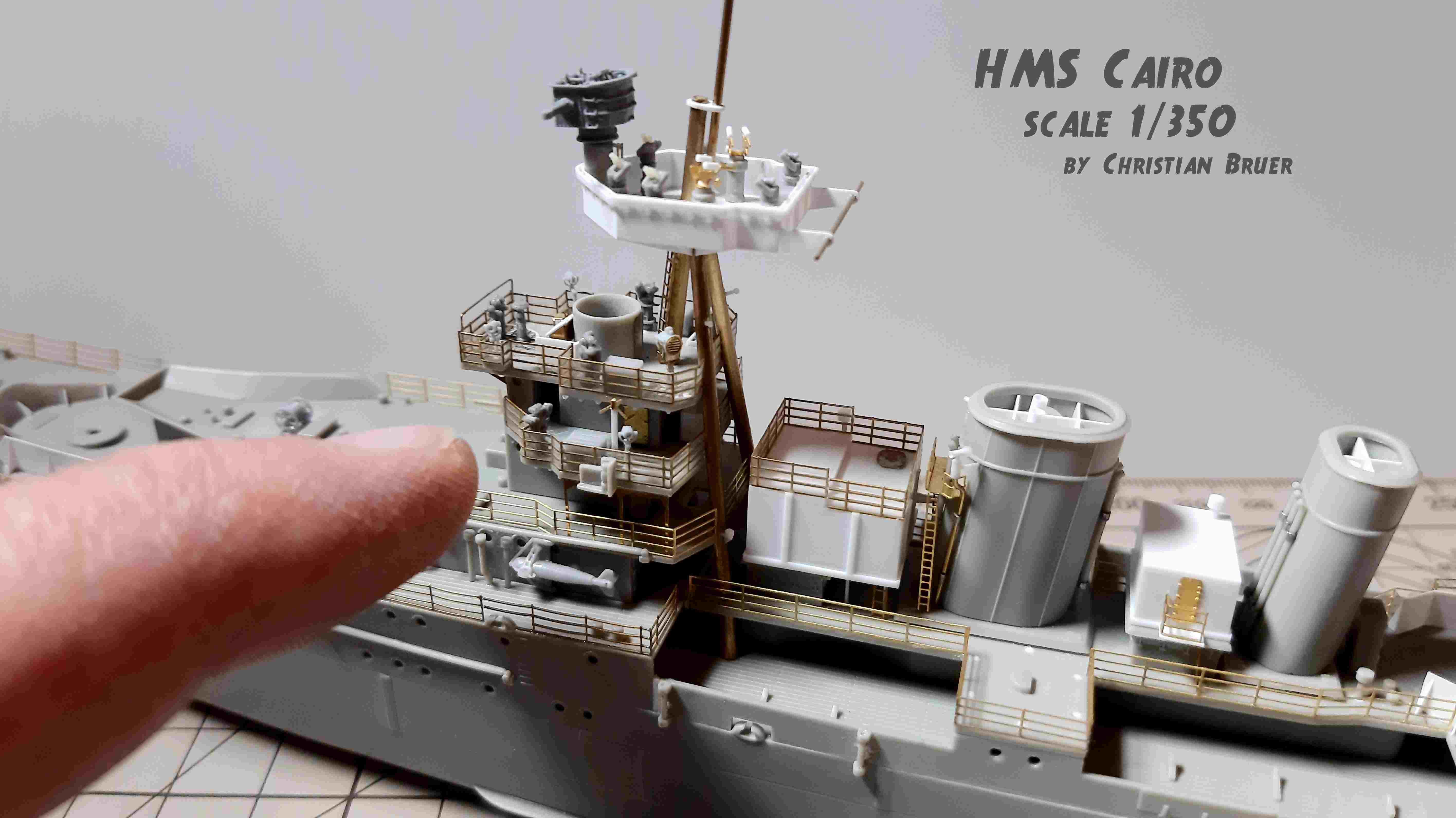

Good evening all,

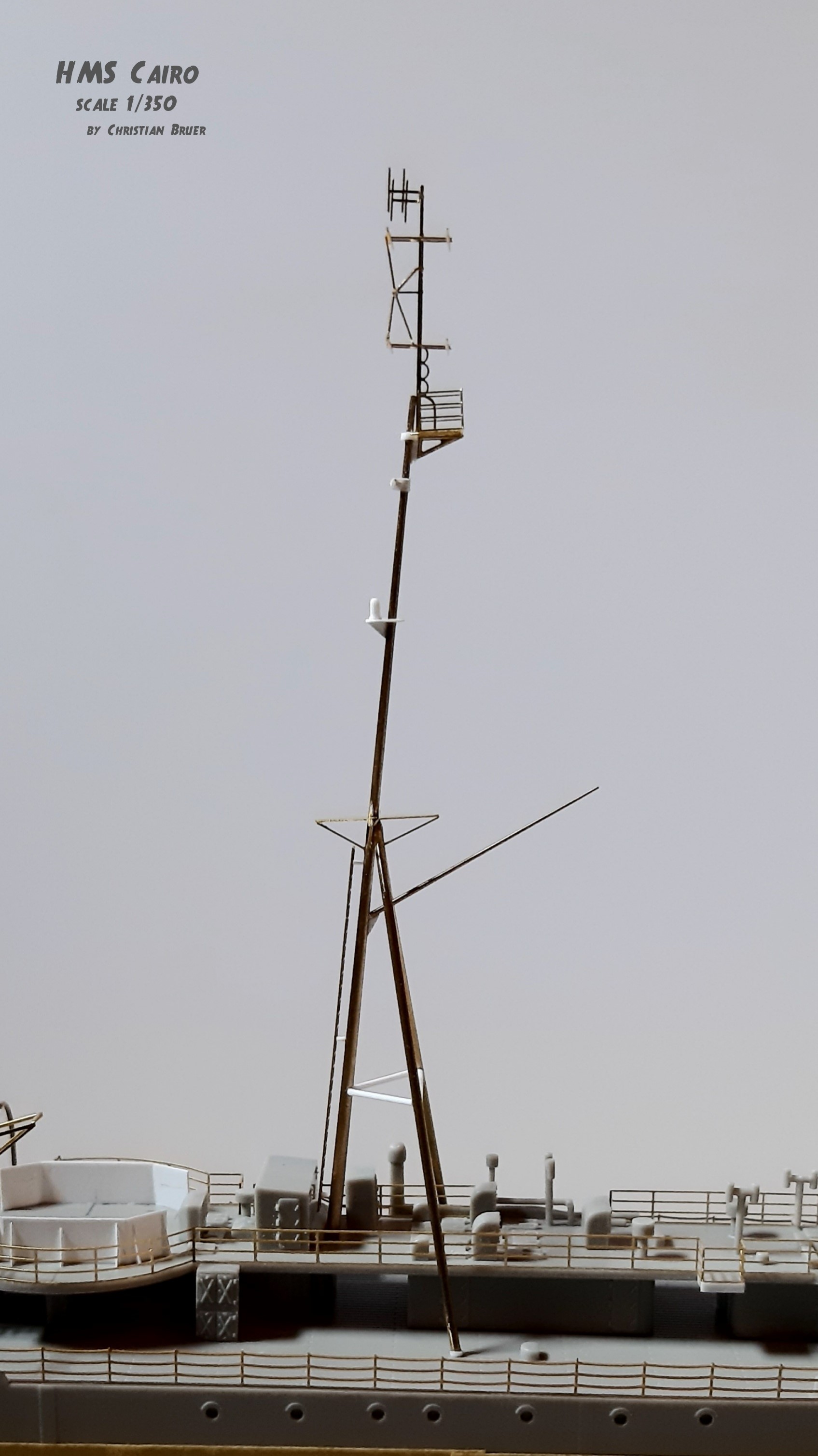

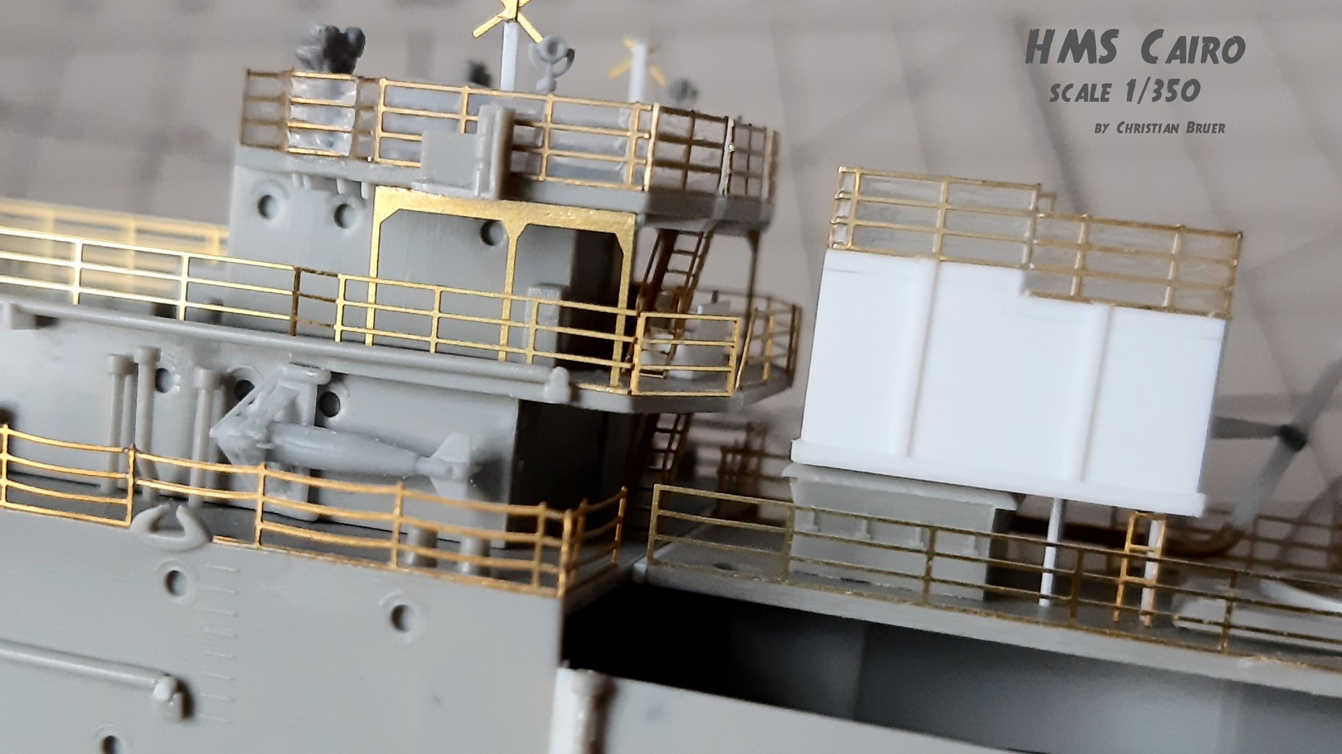

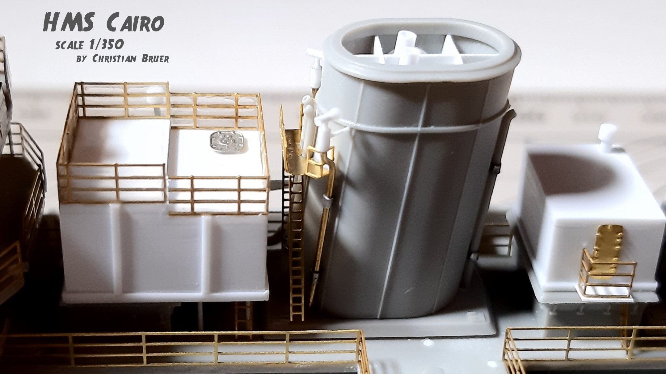

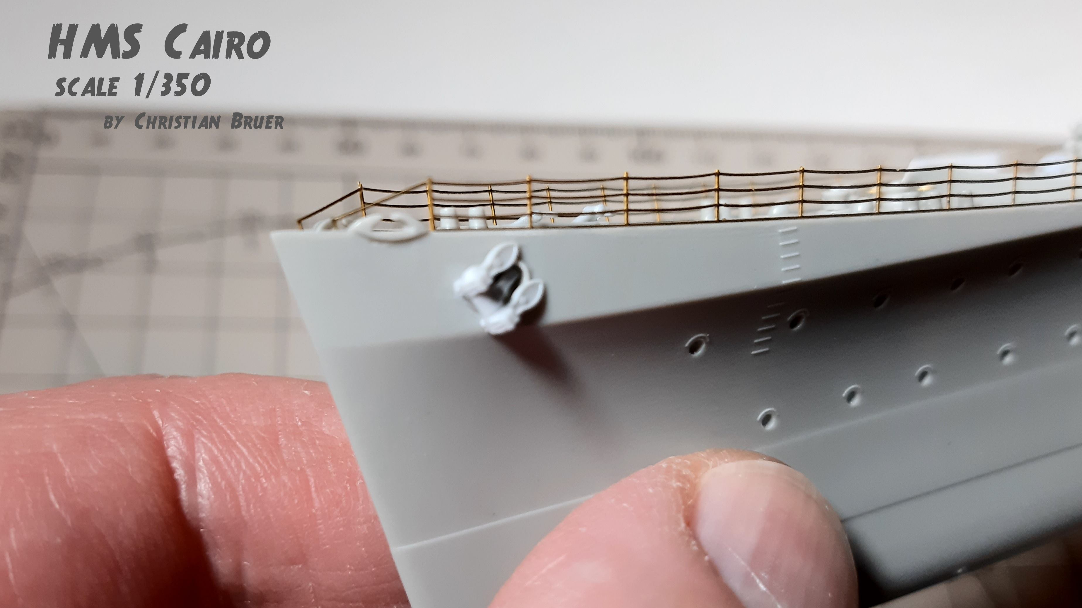

I added lately all the small details which brings a ship model to life, like ladders, flagstaff fore and aft, position lights. Next to this the last kit parts found it's place, like the structure in front of the 4" gun (a framweork to avoid firing into the superstructure?) and the loop aerial on top of the superstructure. The platforms for the Typ 279 radar are loaned from my spare parts from my Blefast. They fit quite nice with only slightly improvements because of the thinner mast.
According to my latest research the Typ 285 radar was fitted in January 1941. Unfortunately I ordered the HACS tower without the Typ 285, but hey, there are some Type 285 PE antennas left in the spare box.
Well, the main work comes to an end, there are just a few things to do before I can start the paintwork. But before I have to start the base to alinge the hull as good as possible.
Happy Modelling

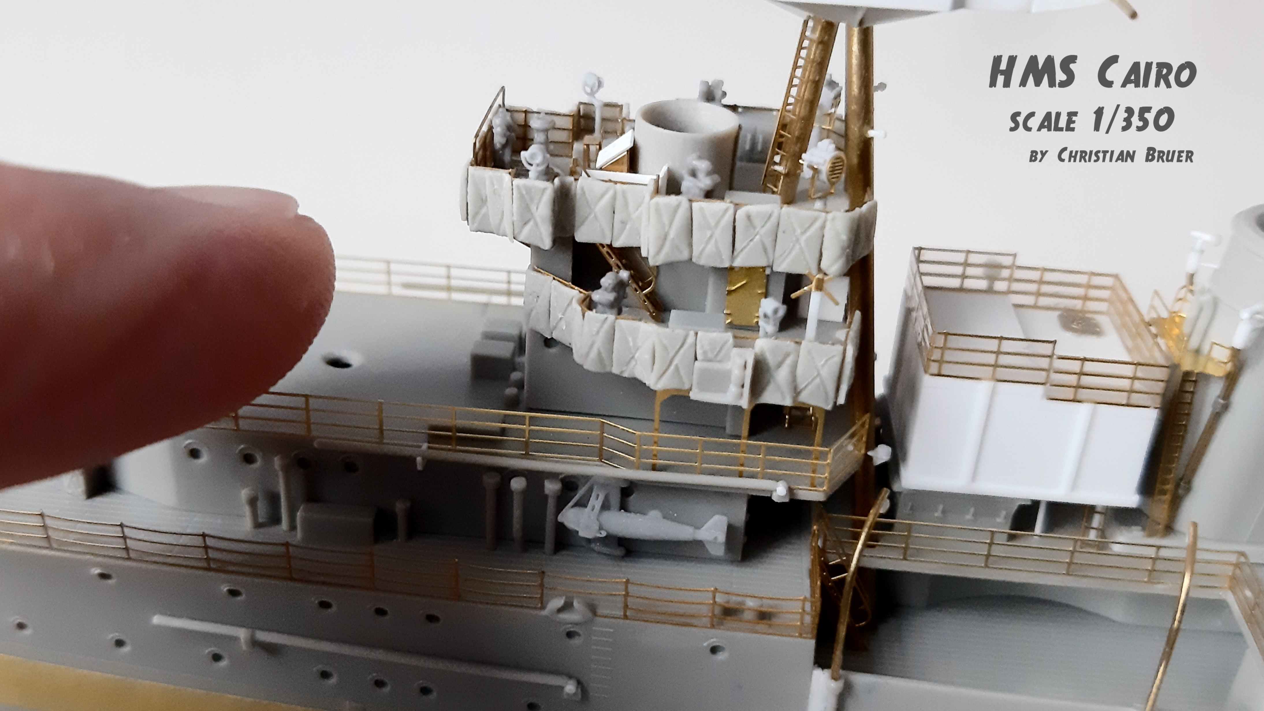

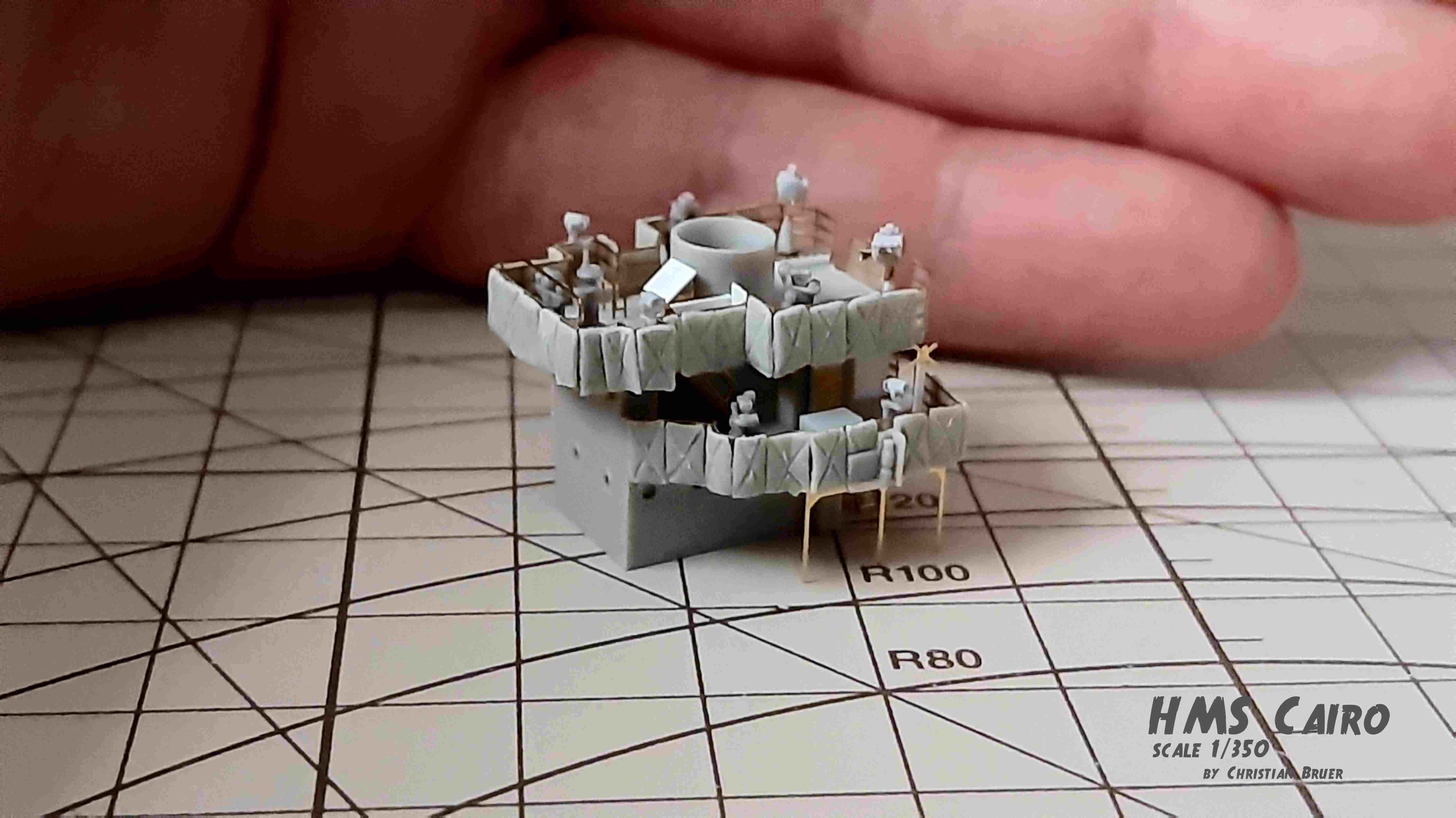

Meanwhile I have added splinter matting I made from Magic Sculpt, 50 parts in total, along the bridge. Each part was individually made, with a size of 2,4 x 4,0mm.

Nothing replicates the 'soft' look of matting like home-sculpted items!

I used it for the first time and I was impressed by the softness without sticking to much to the fingers, great stuff :thumbs_up_1:

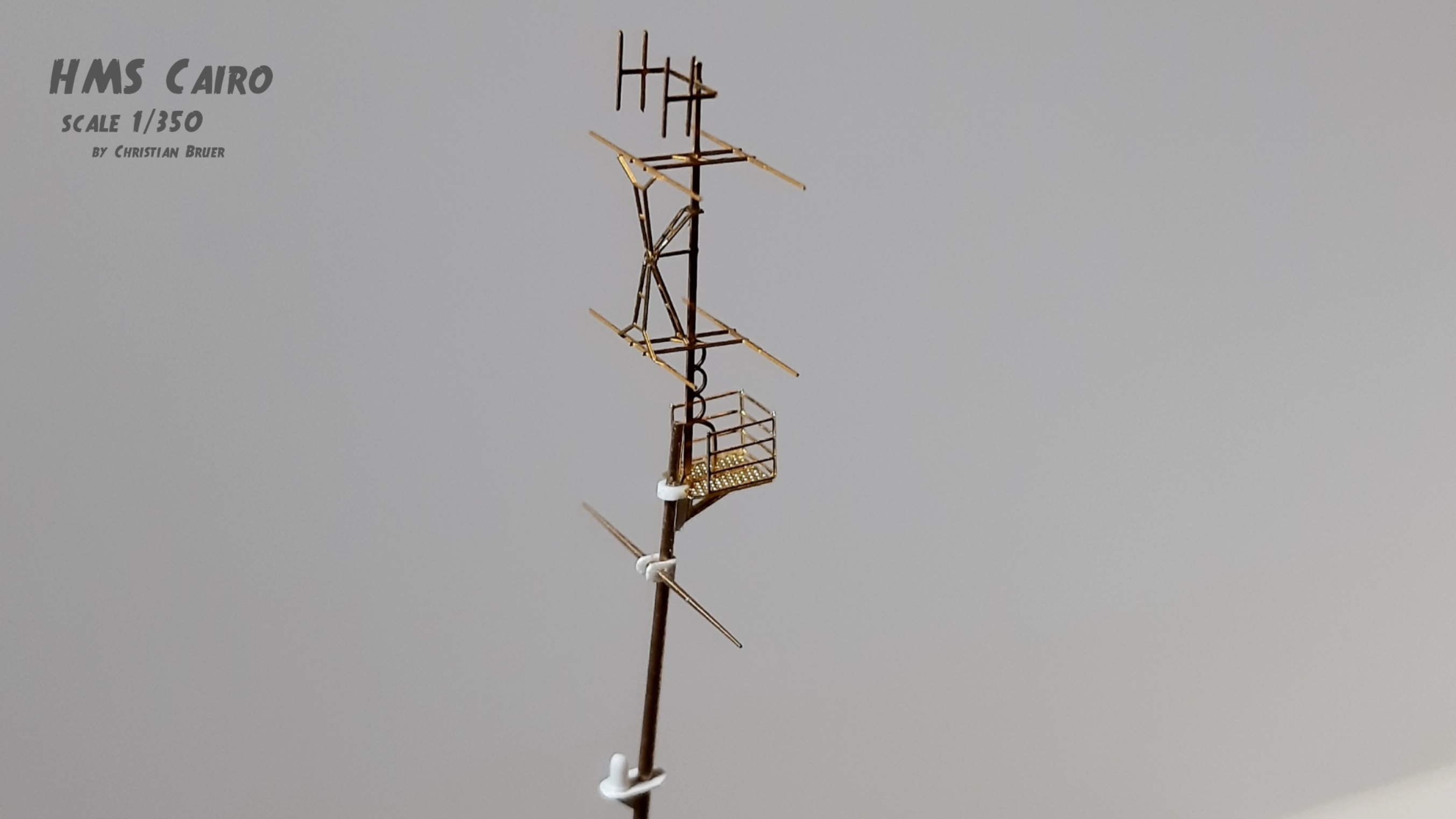

Meanwhile I got the Mk1 Design RN Radar Set what allowed me to complete the fore and main mast with the Type 279 radar. The fragile parts are nicely done and the fit of the parts was absolutely exact.
Now I am dealing with the Admiralty Disruptive Pattern she wore in late 1941. According to Raven it was 507A, 507C and MS3. But I am not sure about the dark tone?!
