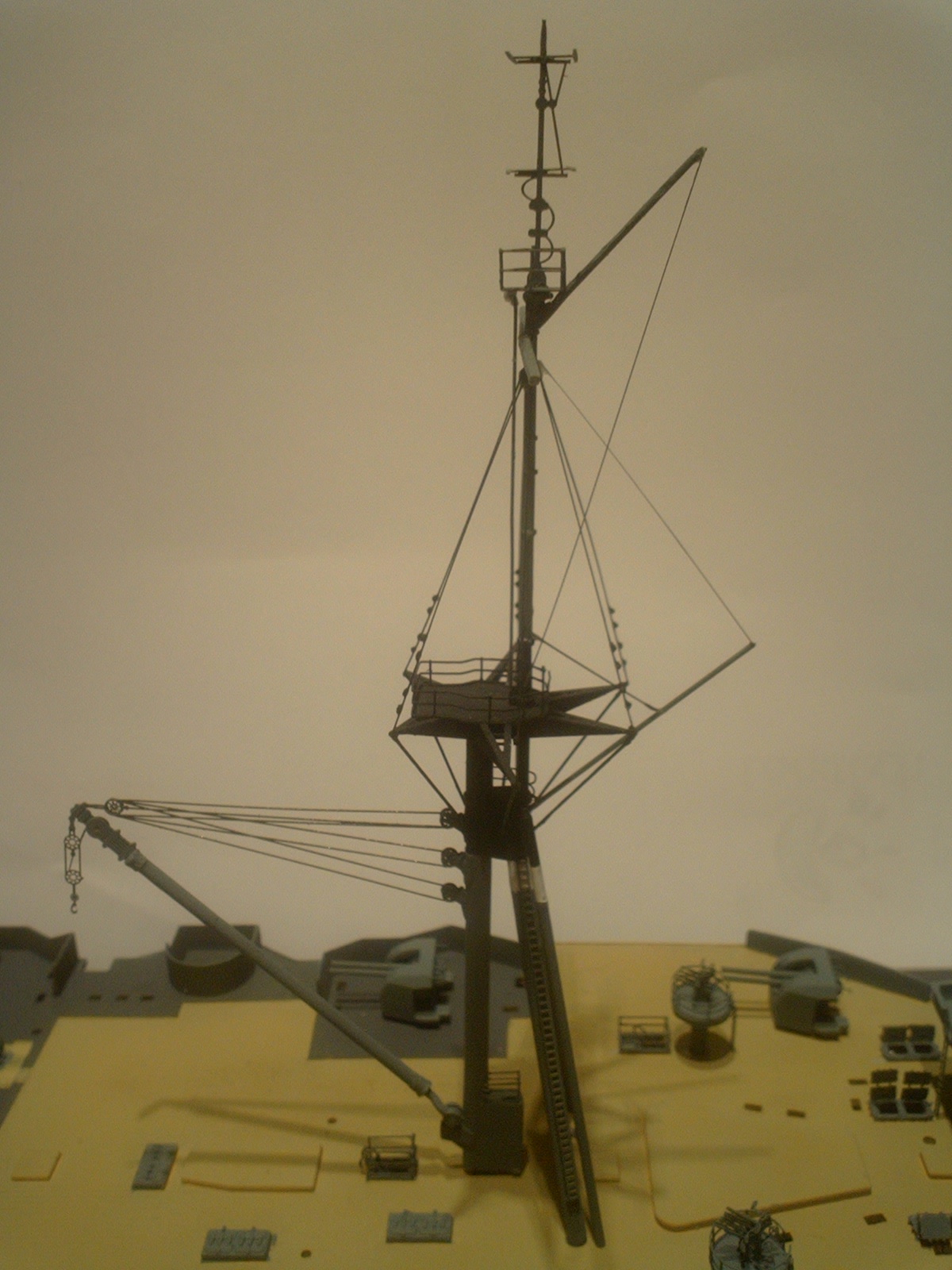

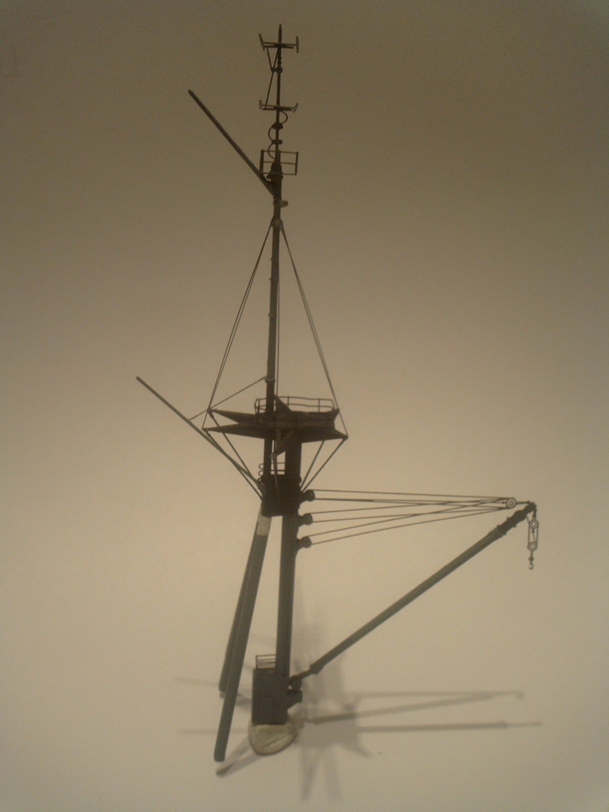

Postby MöLDERS » Wed Dec 26, 2007 5:35 pm
Hi Gentleman,
i just refit the Main Mast and add the missing Gaff. During the Work some Questions came up.
What do we know about the Gaff was fixed at the Mast? In my References i can see a Gaff Lift and the Ensign Halyard. Was there any more Affixing?
The second Issue i got up there is about the Starfish. The Starfish is fixed at the lower Side with some "Starfish Stays". Do we know if they where fitted as Rig or was they solid? My Opinion would be solid, but maybe we have some more detailed Information.
Further there is something not pretty clear with the white Stripes at the Mast. Was all the three Legs painted with a white Stripe or just the two aftwards?
My last Question would be about the Aft Superstructure.
The Searchlight Platform Bottoms was elaborated in Corticene or in Metal?
Many Questions, aye? :eyebrows:
Would be cool if someone could help me out a little.
Thanks in Advance!
:wave_1:

Postby MöLDERS » Tue Jan 01, 2008 10:11 pm
I fitted out the Mainmast as far as known.
Missing @foeth.... :scratch: :smallsmile:

Re: HMS Hood Trumpeter/Lion Roar 1:350Scale at Slipway
Postby Foeth » Wed Jan 02, 2008 5:47 am
I can't see the other side, but did you add the diesel exhaust pipe? I just started working on the main mast so not a lot of detail to show and the picture is as bad as well. It's work in progress... There are also ladders on each leg of the tripod. You can only see one of them now. Note it has a peculiar twist at the end. The other two run up straight, on the 'top' of each leg.
There are also a few more stays holding up the main mast. There are at two going to about 1/3 of the mast.
Postby MöLDERS » Wed Jan 02, 2008 3:59 pm
Thanks Nick & Avery! :wave_1:
The Refit is complete so far.
Many Thanks to Foeth for his immediate Feedback. The Diesel Exhaust Pipe is now fixed.
The Rig i a Conclusion of three Plans of Hood i have.
MöLDERS
Postby FW_Allen » Sun Jan 06, 2008 12:21 pm
The updated mainmast looks really good! Nice job indeed. Are you now done with it? If not here is one other detail to consider- the upper mast on Hood (the thin mast at the rear of the starfish) was white. Even the bit that went below the starfish was white.
Frank
Postby MöLDERS » Sun Jan 06, 2008 12:42 pm
Hi Gentleman,
thanks for the Compliments! :wave_1:
@FW_Allen
Thanks for this important Feedback! Once i thought its done but there are two more Updates to do as far as i know now.
First there must be a additional Gaff-Lift for the upper Gaff. I just forgot to add this one.
Second there is a Protection Sheet at the Dynamo Diesel Exhaust at Deck-Level just as shown on Foet`s Pics
Now there is a Third: :big_grin: :big_grin: Painting the lower Gaff white. :big_grin: :big_grin:
Do you mean this with "the thin mast at the rear of the starfish"?
I will change that instantly.
Thanks Allen! :thumbs_up_1: :thumbs_up_1:
PS: I´m not quite certain about the Length of the upper Gaff. May its a little shorter. It would not be too difficult to change. References tell different Stories and the Photos i got aint clear enough....

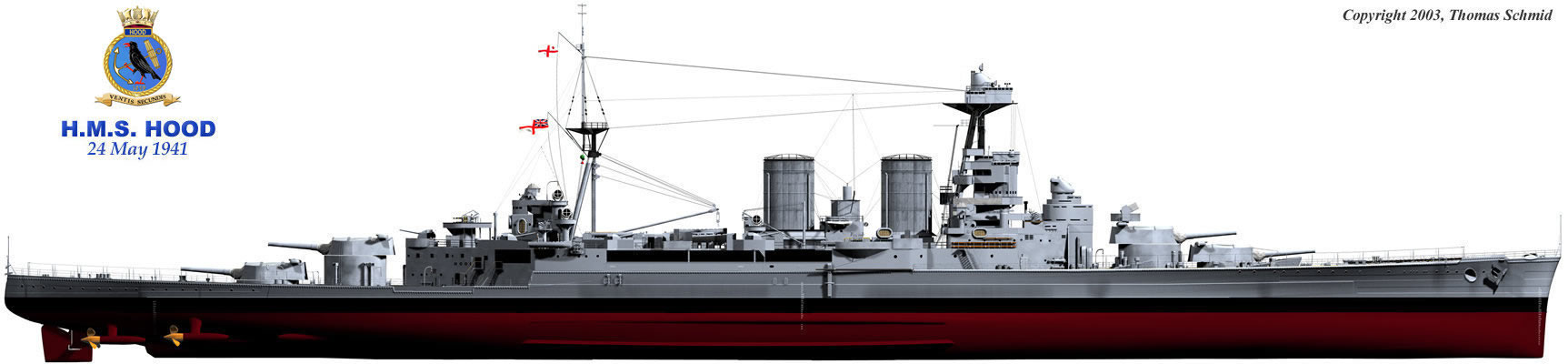

Postby Foeth » Sun Jan 06, 2008 3:26 pm
By the way, I haven't seen that upper gaff on any pic of HMS Hood, so I guess you have to take it off ;)
Foeth
Postby MöLDERS » Sun Jan 06, 2008 3:58 pm
argh.......... :wacko:
completely removable it´s not....
Thomas Schmidt is wrong again?
MöLDERS
Postby Foeth » Mon Jan 07, 2008 2:24 am
Well, I don't see the gaff on any photograh. Note that Thomas Schmidt's is a very good rendering but also based on secondary sources (AOTS Hood and Taylor's book, for example). It's a model, just as the 1:700 kits. Fortunately errors are removed when found, so it's going to be better and better,
Foeth
