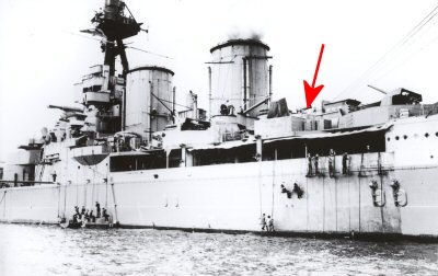

My question is would thease sheilds have any angled supports , and the up luncher sheilds did they have doors or steps to enter them as the moulds seem to be fully enclosed ??????
There are indeed many angled supports. Note that you have to take in account the position of the 4in ammo lockers when adding them.
The UP shield on top of B-turret has a ladder (and I guessed the supports overhere):
The other UP launcher shields have no doors. Part of the shield can hinge. Another brilliant observation of yours truly. Not visible on this particular picture, but look it up in your picture book and use some imagination.

Angled Supports- As Evert-Jan said, there were indeed angled supports on the inside of the various splinter shields. We do have some decent shots of these on the Hood site. Try http://hmshood.com/crew/memorial/b/bark ... rtbio2.htm as well as some of our photo collections. There should be enough there to get you started.
Speaking of "angles" also remember that some of the splinter shielding was actually "angled". For example, the forward splinter shielding around the forwardmost twin 4" mounts. If you look at photos, you'll see that the shield does not remain level with the deck, but angles upward at the front.

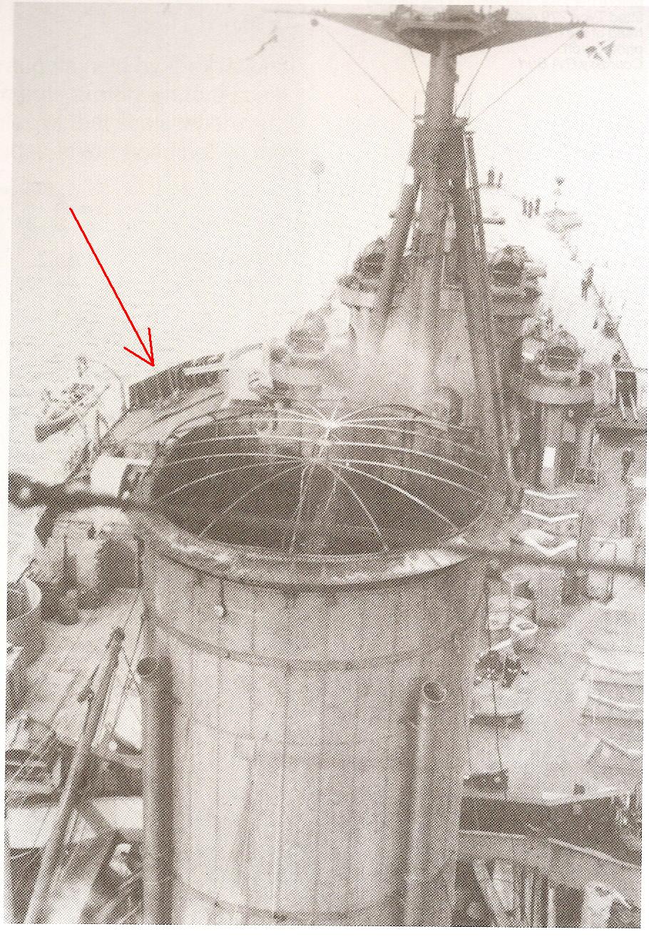

I found a Pic about angeled Supports on a different Spot. Maybe it´s useful for your Project evo6tme.

Postby Foeth » Wed Jan 09, 2008 8:55 am
Also note on that picture:
- supports for the deck cranes on the splintershields the forward searchlight walkway
- the splinter shield on the aft starboard 4" is higher on the transverse shields
- the diesel exhaust pipe configuration against the tripod leg and protection. I guess from the admirals barge when lifted by the main crane?
- a white square below the outer-most right searchlight. I believe this is a cushion where the admirals barge is restricted in rearward movement.
- to the right of the admirals barge boat cradles, you can see one of six ammo hatches with a hoisting frame spread around the shelterdeck
- No hatch to the rear of the UP launcher splinter shields
- the white band around the tripod doesn't go around the primary support leg
The quality of this particular version of the picture is poor, but it does show the frame on X-turret. Also, it shows that the main crane derrick pulleys, and that the top one is a double pulley. Slightly different from other RN and IJN versions, indicating that the rigging on most PE parts is wrong (plus that some PE parts do not have a cable to the hook itself, but have all wires handling the crane boom elevation. This makes no sense. There is a pully in the far end of the crane derrick which is now unused. The designer apparently didn't take the time to understand the working of that crane.)
Anyway, this is a wonderful picture, thanks for posting :wave_1:

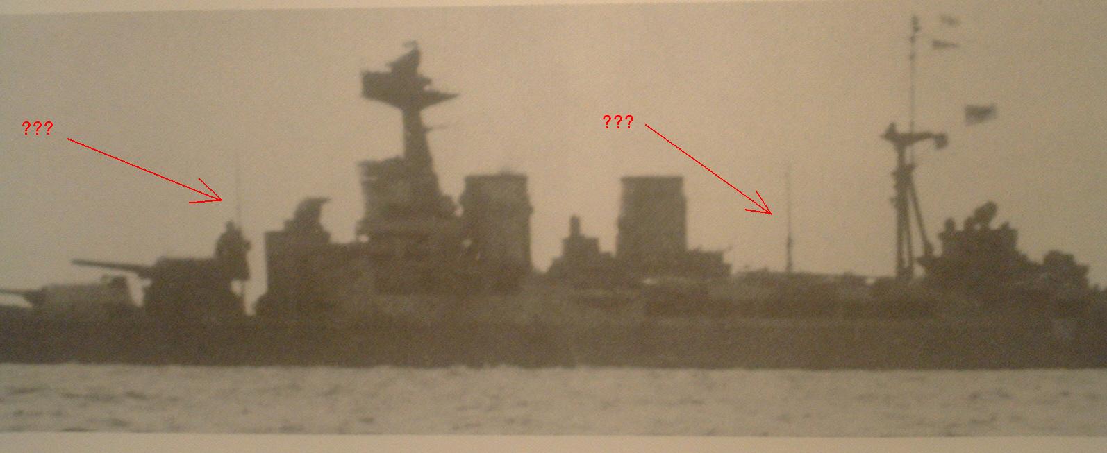

I checked a Picture inside the Anatomy and i found some strange vertical Rods. The Picture is described with "Hood in Scapa shortly before her loss" so it gotta be in 41 before her last Sortie.
Does anyone have a Clue what it could be, or what´s the Purpose?
Thanks in advance! :wave_1:
MöLDERS
Posts: 325
Joined: Tue Nov 20, 2007 4:02 am
Location: Augsburg Bavaria Germany Europe Earth
Re: HMS Hood Trumpeter/Lion Roar 1:350Scale at Slipway
Postby Foeth » Sat Feb 16, 2008 2:12 am
Nothing the see in addition to what is know know (I think?), except that A turret is once more lighter in color that the rest of the ship. I've seen several pics of this color difference.
But my guess is those are special "we fixed something next to HMS Hood rods", possibly on shore or a ship moored next to her. But not on HMS Hood.
