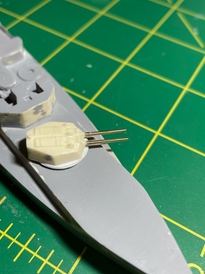

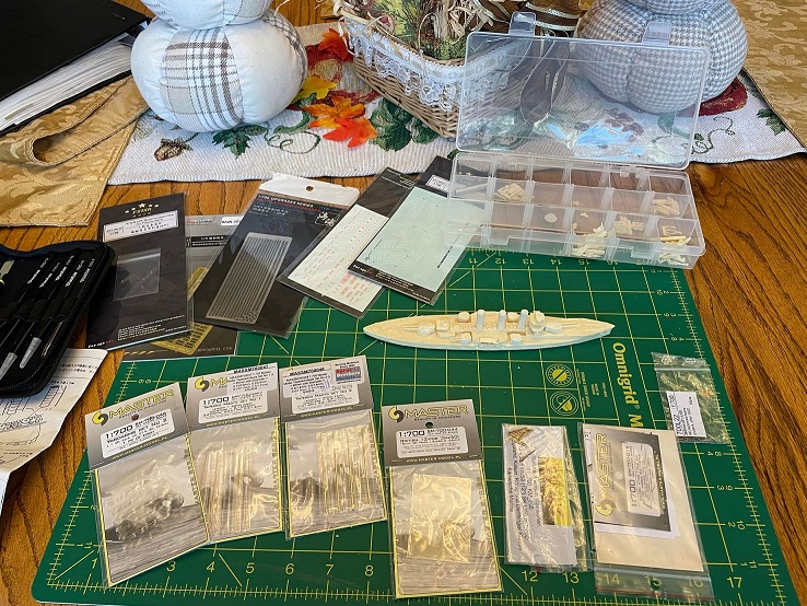

To begin, here's what I'm working with in this "kit." For those of you who have seen the old Kobo-Hiryu kits, you know what I'm dealing with. I've heard cries I'm better off scratching the hull, but I just don't have that skillset yet or the necessary documentation to make it more accurate than the sadist who cast this hull.
Kit contents and some of the PE/barrels I'm going to use. Note that I replaced the German offerings with British 12"/45's. I wanted the additonal length of the 50 calibur guns to make it easier to mount. That proved unnecessary.

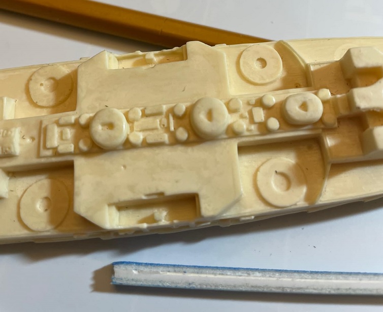

Here's a close up of the potato's loldetailslol. There is literally nothing redeemable about this kit other than the fact it exists:
At this point, I started shaving off the offending torpedo booms and shelf along with any casemate doors that spud possessed. Literally none of the details were worth keeping. In addition, I shaved down the midships superstructue along the port/starboard hull sides, given that the kit sags in the middle a bit. Like I said, GREAT casting here. The effect doesn't droop badly and masks a bit of the sag. I also shaved down the full bases to be flat and level.
Next step? I tossed the goose turds that masqueraded as "funnels" and used turned brass/aluminum. The forward funnel was more "oval," so I viced it until I got the desired shape. In addition, I removed and re-drilled portholes with mixed success. Frankly, part of my rebuild will be to utterly remove all portholes and find a more uniform, level way to drill them out. Any advice here is appreciated.
Note here that I also replaced all the barrels. This substantially improved the guns. Any PE you see in this picture is now gone and stored away. I'll reattach and/or replace PE once I'm satisfied with the hull's condition. I also scratched the citadel bridge level. The kit offering was a madness-inducing mess of crooked lines and insanity. I was tempted to just set it on fire and use the Warships 1992 plans to scratch it entirely. Note the citadel itself IS WRONGLY BLOODY SHAPED BECAUSE OF COURSE IT IS.... necessitating a total rebuild. Again. Like all this *#*#$($ kit.

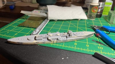

...now for the current state of this thing.
I've removed all the photo etch detail. I've re-sanded the hull. I've decided to cut down every deck detail (minus barbettes) to utterly rebuild embarrassingly poor casting. Now, here's where I need help from the gallery. This is my plan:
* Sand it all down. Burn it all down. Remove every bit of offending hoodoo that exists on the wooden deck(s).
* Use tracing paper to produce part of the paper templates. I'll transfer this to paper and then measure the remaining boundaries at the superstructure, etc.
* Match templates to the deck and trim as necessary.
* Make a few copies of the temples, because I'm an engineer and redundancy.
* Place the templates on generic Wood Hunter Deck
* Attach new deck to the ship and add scratch built mushroom vents, hatches, anchor bits, etc.
* Mask and begin working on the rest of the ship.
As stated earlier, I'm also overhauling all the portholes. I hate them. I can do better. I plan to use two strips of masking tape: one above and one below. I figure that'll give me a better chance at fully level portholes. Help and tips here would be appreciated.
Note: I'll be addressing the soft cylinder "vents" abreast of the funnels. Based on plans, these ventilators are some gooft "we ripped off the endcap of a diesel engine" design that'll be represented by new plastic cylinder stock and scratched caps. Gross.
Kit, as of today. I'm off tomorrow, so I'll likely sand this *expletive* down tonight and start puttying for a level surface. Note the extreme bow has a noticable depression. This was a substantial factor to doing the full near-scratch work. Apologies for the fuzzy imagine. Honestly, you're not missing much.
Oh. I also have a Settsu and Kawachi on the way. Both will require similar work and scratch built superstructures. If any of you have decent plans or drawings, I'd appreciate the assist. The same goes for Kurama, outside of what's present in the 1992 Warships book.
I've never done anything like this. Ever. Still, it's thoroughly enjoyable because I'm clinically insane.

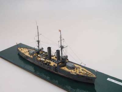

Hello my friends,
Chris,have fun building your Kurama. Kobo-Hyriu models are a heavy challenge
...if interested, this is a resin model from Kobo-Hiryu
Armored cruiser Tsukuba.
beste Gr��e Frank

Frank: Good LORD that's a beautiful build out of a potato. I love that they even got the trashcan ventilators correct. I'll build mine once the appropriate plastic stock gets here.

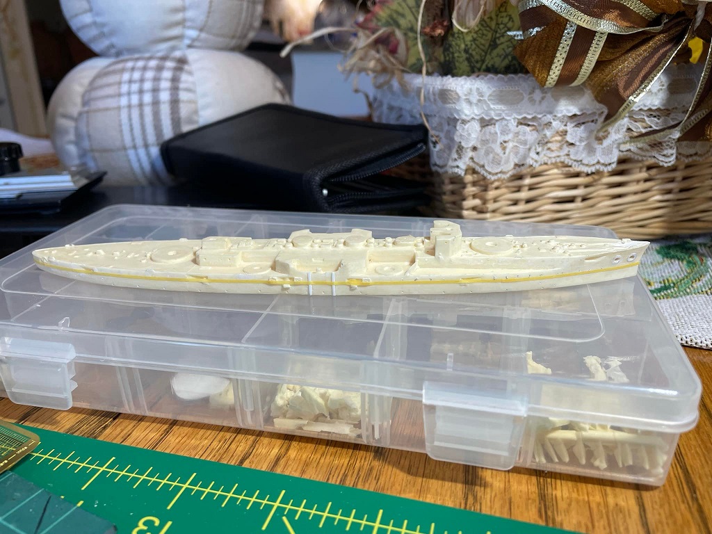

So, I've managed to get myself pretty sick to the point where excessive Red Bull isn't helping me kid-with-a-helmet through the day. Consequently, I've decided to stand down from planned modification(s) to my car and focused on sanding, sanding, sanding.
Achievement unlocked: Kurama is now a milk cow and far less potato. I'm debating another coat of primer today, but that requires me to crawl out to the garage, clear car bits off my workbench, and pull both cars out of the garage, because airborne primer and an obsession with keeping my cars immaculate.
Next step? I'm removing offending deck detail and sanding it smooth. I'll putty the problem areas, re-sand, re-prime, and maybe actually add some bloody details.... after I drill new portholes. Again. I may also take a break from this to get back to Saratoga. I just got Shelf Oddity's brilliant 40mm bofors and various rangefinders. I honestly cannot sing blancman's praise enough.

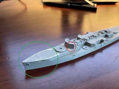

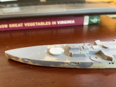

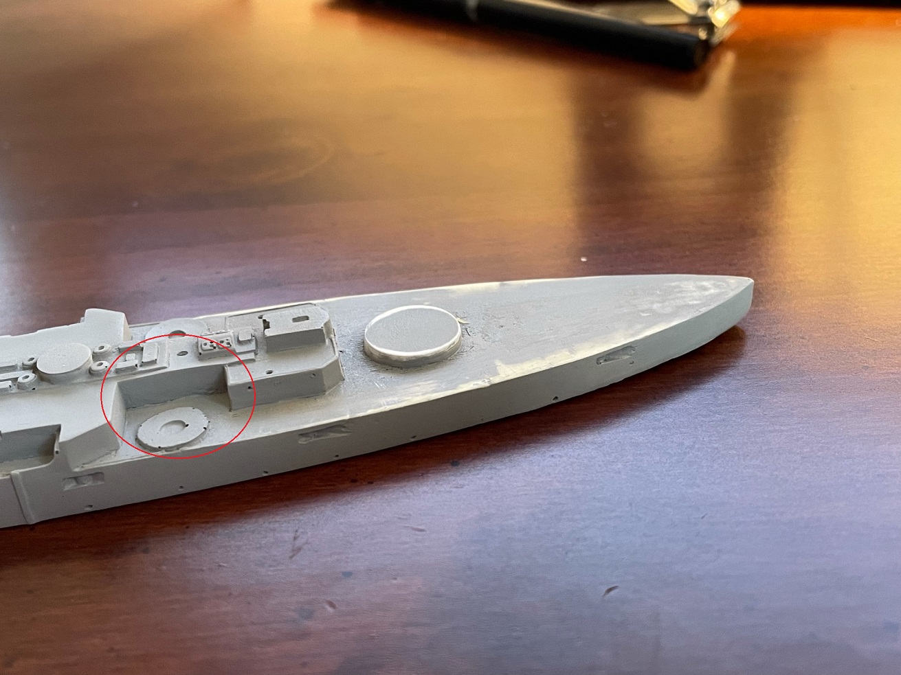

Small update. I'm in the "fill, sand, fill, re-prime, sand, drink, fill, sand, fill, fill, drink more, sand, re-prime, drink, give up and watch YouTube history videos" phase.
I've labeled each are with shapes.
We'll start with the bowtato.
Green Circle: This is where the horrible, sunken anchor chains were located. It's now been smoothed over with multiple laters of putty and Mr. Surfacer. I don't need the deck 100% smooth on account that it's going to be covered up with a paper deck, thanks to Jim Baumann. (And thank you, Jim!)
Red Circle: You can see that there's still a LOT of smoothing and sanding. You can also see the multitude of small air holes from the absolutely atrocious quality of the kit. Note that the larger holes on the lower hull are guide points for the torpedo net booms and shel. I also need to clean up around the hawse, if not replace it completely once the hull's actually decent.
Sterntato? Same issues. Again, I'm less concerned about how pretty the deck is, so long as it's level enough not to show under a paper deck.
Red Circle:Notice the glorious pitting on this barbette. I'm going to try to seal/sand with some Mr Surfacer 500 or some Perfect Plastic Putty. The two portholes on the aft superstrucutre are some of the few I left drilled. They're of the appropriate height and location. The biggest issue here? Look at how wonderfully cast that bulkhead is behind the barbette. Yes, it'll be mostly hidden. I'm still going to do some correction. I swear this kit was scupled with a wet finger and excessive whiskey.
....and now for the fun part. Midships looks like Kurama engaged with some 3" and 4" pop guns or suffered severe rusting issues. Ugh. See circles.
Blue Circle: Better angle on the wonderful barbette. FML
Green Circle: Note that a lot of these deck blobs suck at being anything but a pain. I'm likely going to ragesand these, and almost all other such details, off the ship. They suck. I can do better. The only thing that could make this worse is some good resin outfit deciding to troll me and announce a decent Kurama. I think I'd literally set this thing on fire with my hatred alone.
Red Circle: These were once solid cylinders that are supposed to be vents. The posted finished ship above has them done right. I'm going to fix them. With science. Or madness. Or whiskey. I don't know yet.

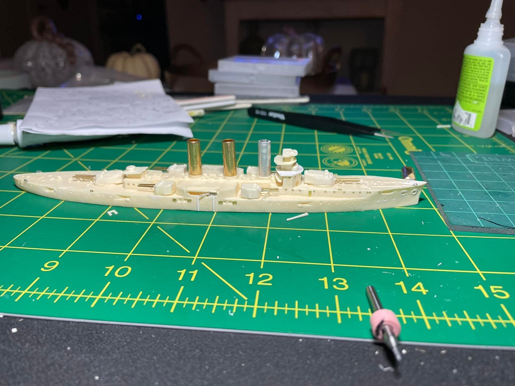

Thank you. It's been a frustrating prep, let alone build. I barely feel like I've "built" anything. First, note that I took a photo of Kurama with her near-sister IJN Spudkaku.

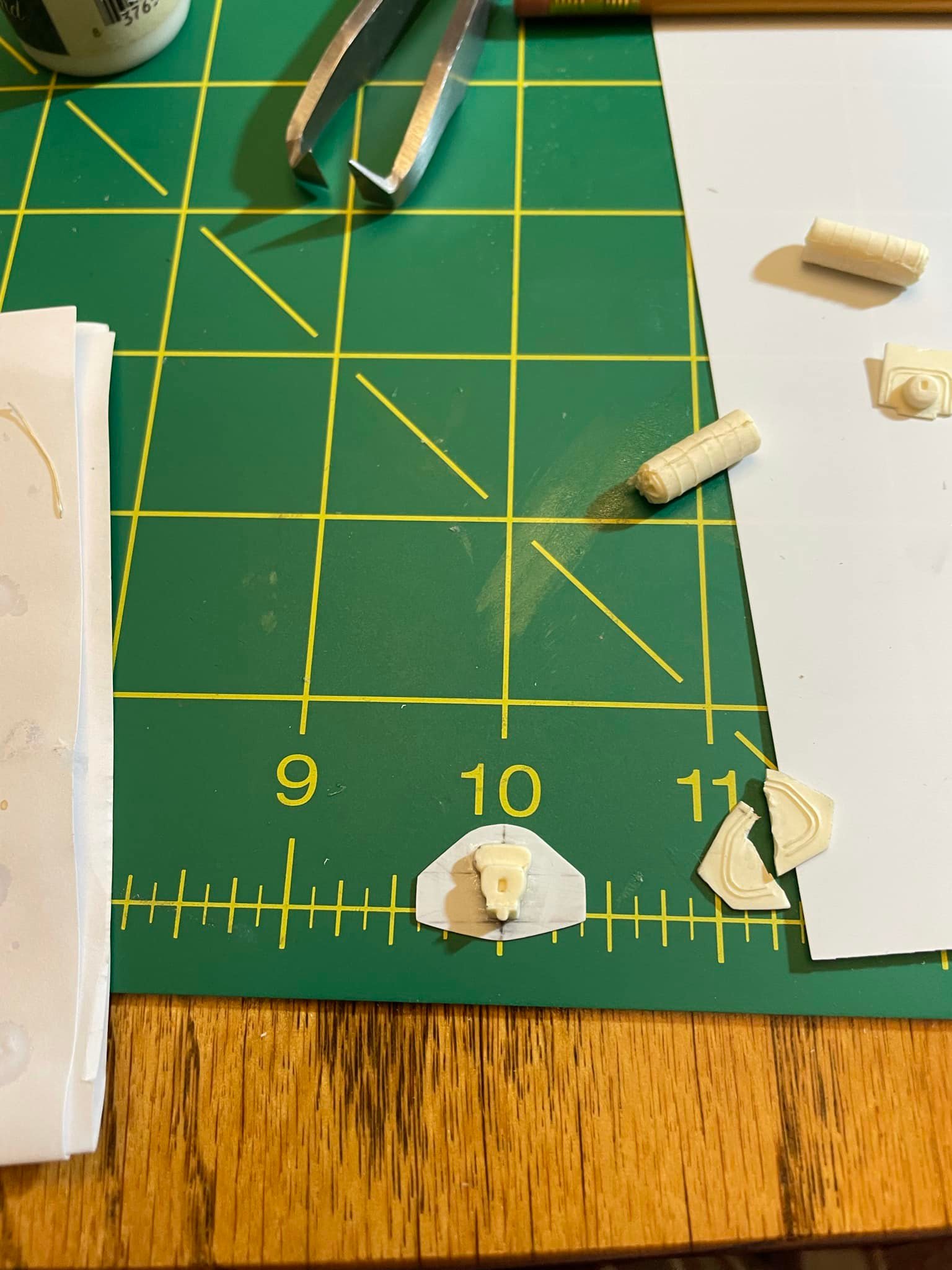

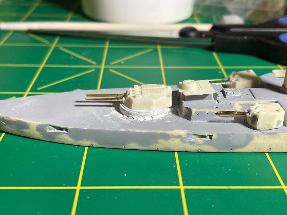

"Small" update. I've been priming/sanding/filling for days. Thankfully, I'm at a stage where most work is wet sanding, so... close to starting portholes and actual work? Who knows. I'll know more after I prime again this evening. I've dispensed with the terrible vents/other structures around the funnels. I've cut some replacements, re: vents, but I still need to bore them out before placing on the deck. This isn't really where the bulk of my work has been...
Kurama's barbettes are undersized. I've found a myraid of photos showing a turret (with ring) that sits atop a wider barbette. Since I've seen it, I gotta fix it. I first measured the turret and barbette to determine which one was poorly sized. The barbette was off by about one millimeter (and yes, this matters) and the turret by about .25 mm, which whatever. I decided it was best to fix the barbette and, erm, fudge it a little bit.
1) Cut out disks for both barbettes and the base of the turrets. I tested fit. Understand this is before refining the general shape of either barbette or turret ring.
2) Used Perfect Plastic Putty and Mr. Surfacer 500 to fill and later refine the barbettes. Mind you, I'm still working to make this perfect. I had planned to use Magic Sculpt, but Amazon was a [deleted] and delayed my order.
All for now. I plan to refine these a bit more and then add the ventilators once I've refined them to my liking.
