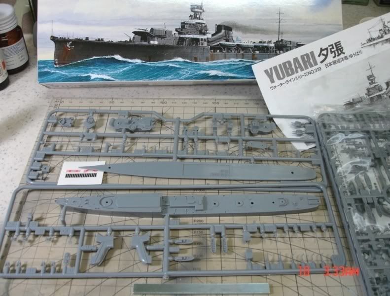

Hello,

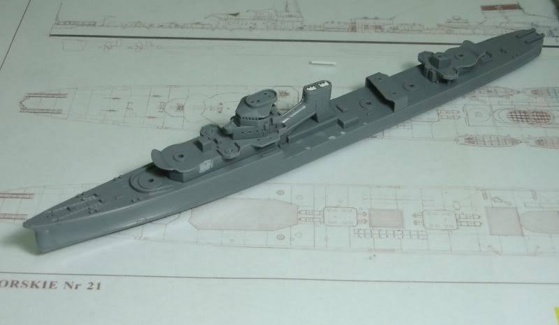

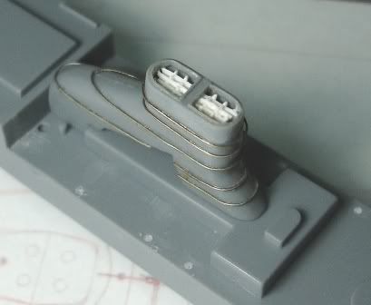

I want to share my recent project 1/700 IJN Yubari. I want to detail up model as far as I can spot from documents I have and can stand on :smallsmile:
Very cool and attractive box art we have,
Parts,

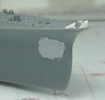

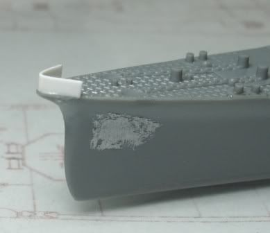

Started with basic construction. Sink marks spotted on bow, nearby both anchor areas. Also found some more shortcomings about kit but thanks to docs and info on net I will try to fix em.

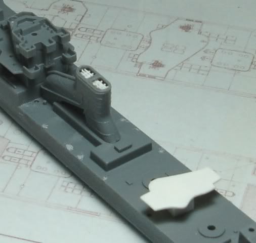

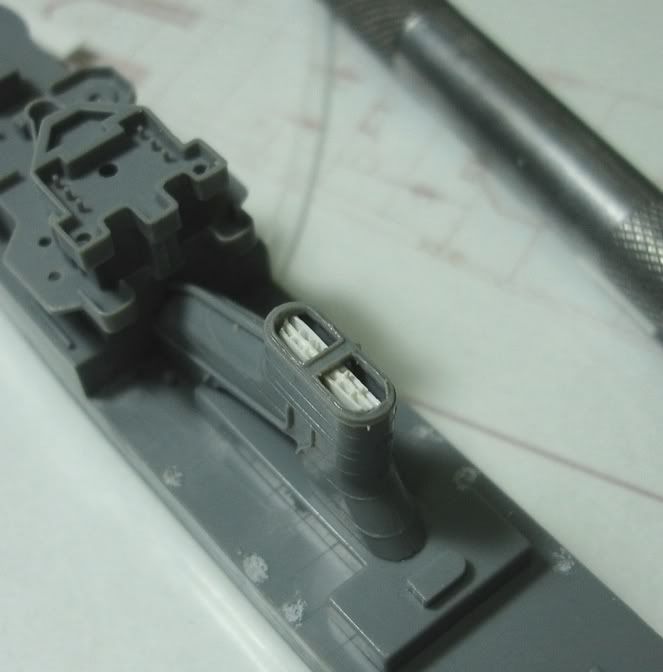

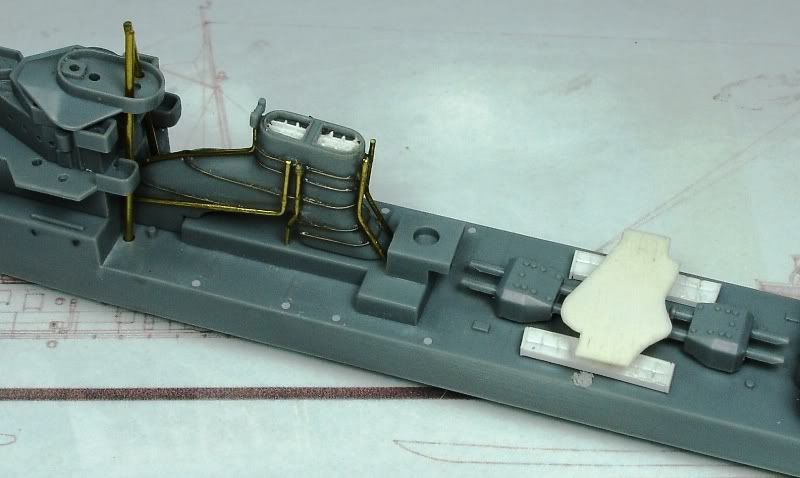

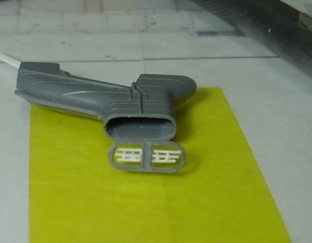

Since LionRoaR frets are on the way, wanted to play with funnel a bit,
Widened funnel walls inside with a new No11 blade and drilled out funnel cap. Started to make some grid details inside with 0,25mm sheets. It is very hard to follow original structure here in 3,6 mm wide so I did not :big_grin:

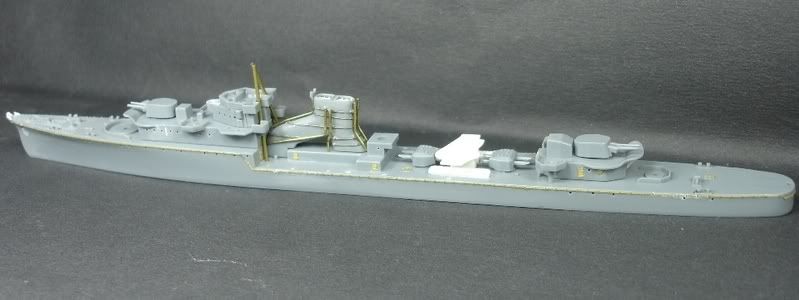

Hi,
Thank you all for kind words gentlemens.

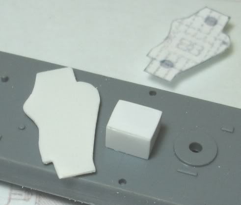

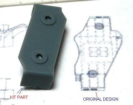

Here some pics for today, started to new AA platform and small housing under the AA platform. Also added some more stripes in funnel outlet.
Now its time to a vital question :thinking:
Is floor of AA platform covered with antiskid plate or not? Logically should be, but errrmh...

I believe it was covered with an anti-skid plate. Anyone else agree/disagree?

After checking the Vanguard site, his Yubari's raised 25mm gun platform was smooth, and not anti-skid as I mistakenly agreed to. If anything, this modeler knows his stuff.

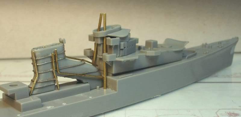

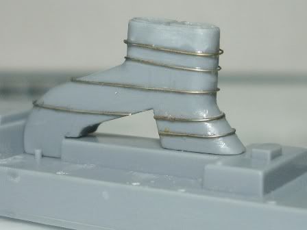

Here small update for funnel. Details removed and restarted. Took 4 hours with small nerval attacks :tongue:

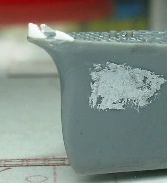

Hi,
Thanks Jose,
Here small update, etches arrived, I forgot to order windows :doh_1:
Kits forward fairleads removed and built from styren.
Carved and reformed with fresh no11 blade.
