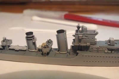

Posts: 81
I've added flotilla markings on the aft funnel and glued on some more of the photoetched parts. A very straight forward build so far: no missing parts and everything fits. I might even add some signal flags if I can wrap up this kit in the next couple of days.

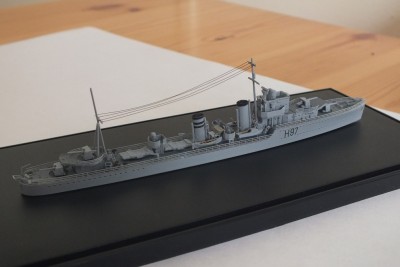

Posts: 81
That's HMS Hyperion almost done. Just got to glue on the jack staff, ensign staff and some signal flags. Like the 1/700 I-class destroyer I built recently the hull bowed (you can see daylight under the bow) after I fixed the deck and superstructure on to the model. Unfortunately, I didn't have any steel bars small enough to fit on the inside of the hull bottom to stop this warping. Sometimes, planting the hull in a polystyrene ocean with a nice big bow wave is the only way to hide this. Otherwise, a nice little kit built and painted in about a dozen hours.
