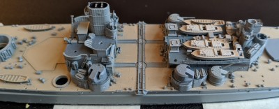

I know there are quite a few of these on the boards now but I decided to add mine... mainly to give me a place to vent all the frustrations I have in my love/hate relationship with building ships. Background - I haven't built any real models in about 20 years but decided to get this ship during the pandemic lockdown. I soon put it aside to build the Flyhawk Agincourt, thinking it would be an easier build to start with (I'm not sure I was correct about that...). I then returned to this.
I'm not very experienced so compared to most of the builds here this will be very basic. Deluxe kit, using much but not all of the PE. No weathering, no fancy deck, no rigging. I chose the Denmark Strait fit, mainly to avoid the complicated paint scheme of the December edition. One other dirty little secret... I bought a second kit as a 'parts ship' for when I inevitably screw up. Though the parts ship had to be the December model due to lack of availability of the Denmark Strait version. If you have the cash I highly recommend it for piece of mind.
Anyway this was the state of the ship when I started documenting:

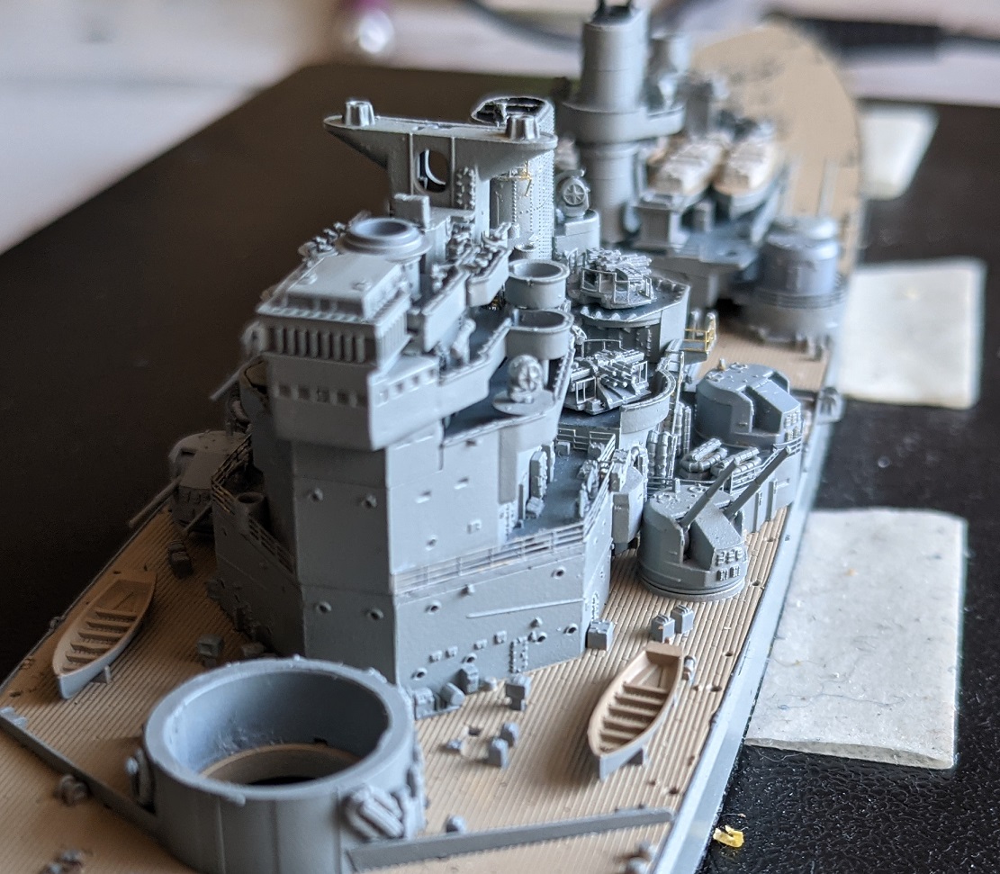

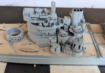

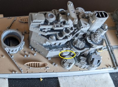

An issue that I ran into is that the superstructure is too wide to fit between the forward 5.25" turrets - as far as I can tell I assembled everything correctly, but unfortunately I didn't catch it until the superstructure was nearly finished. Has anyone else had this problem? I guess I should have test fitted the parts earlier. In any event, I had to sand that part of the superstructure way back to fit - so much so that I was in danger of sanding away the openings in the side. The port side was worse than starboard. The ports look a little messy now, I am open to suggestions for the best way to clean them up...

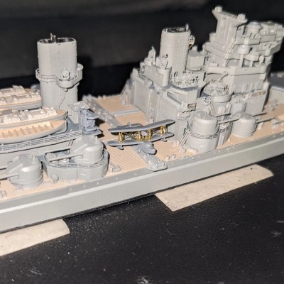

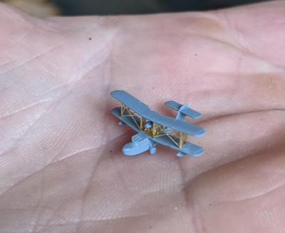

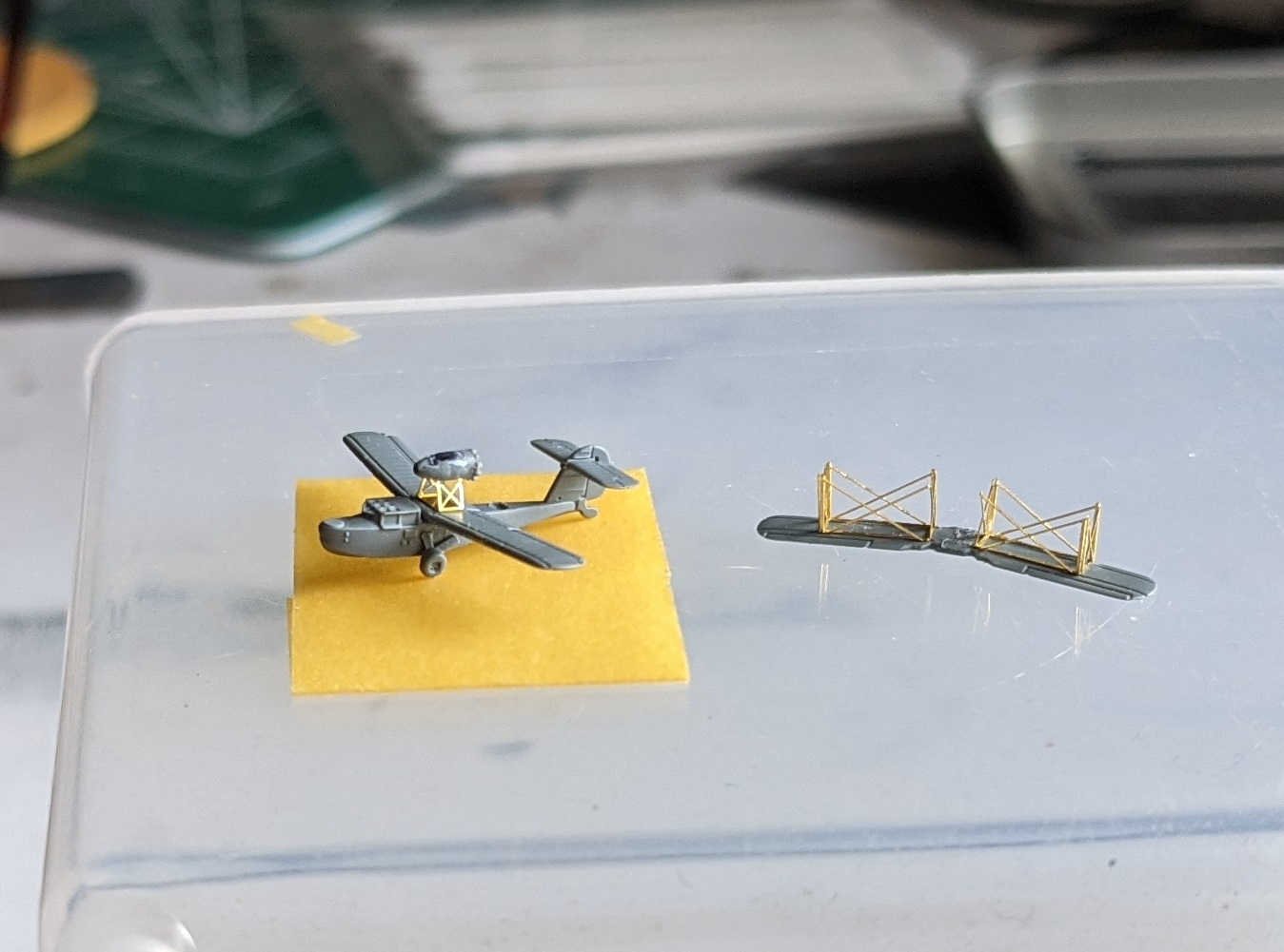

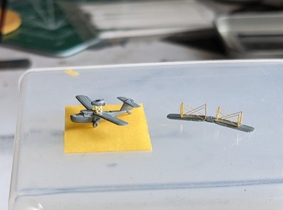

Well, I tackled the aircraft. They are very nice of course but there are a couple of strange issues. First, even though the Flyhawk kit has two aircraft, photo etch is only provided for one. Since I bought a second kit I could do a second... but after building the first one I think that one will be "in the hanger". Second, Flyhawk doesn't provide the 'trolley' which the aircraft should be sitting on - a bizarre omission. I haven't been able to find any source for one in any medium (if anyone knows of one, let me know...) so my options are to scratch build it, ignore it, or have the aircraft hanging in the air on the crane. I haven't made up my mind yet, if anyone wants to step up to the plate!
I added as much PE as I could tolerate but omitted some of it. In particular the upper braces for the engine pod - maybe if I get a second wind I will add them.

The Walrus looks good. Perhaps you're not quite as rusty as you think.

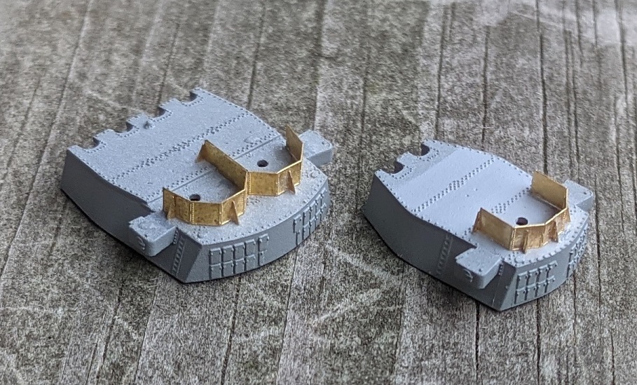

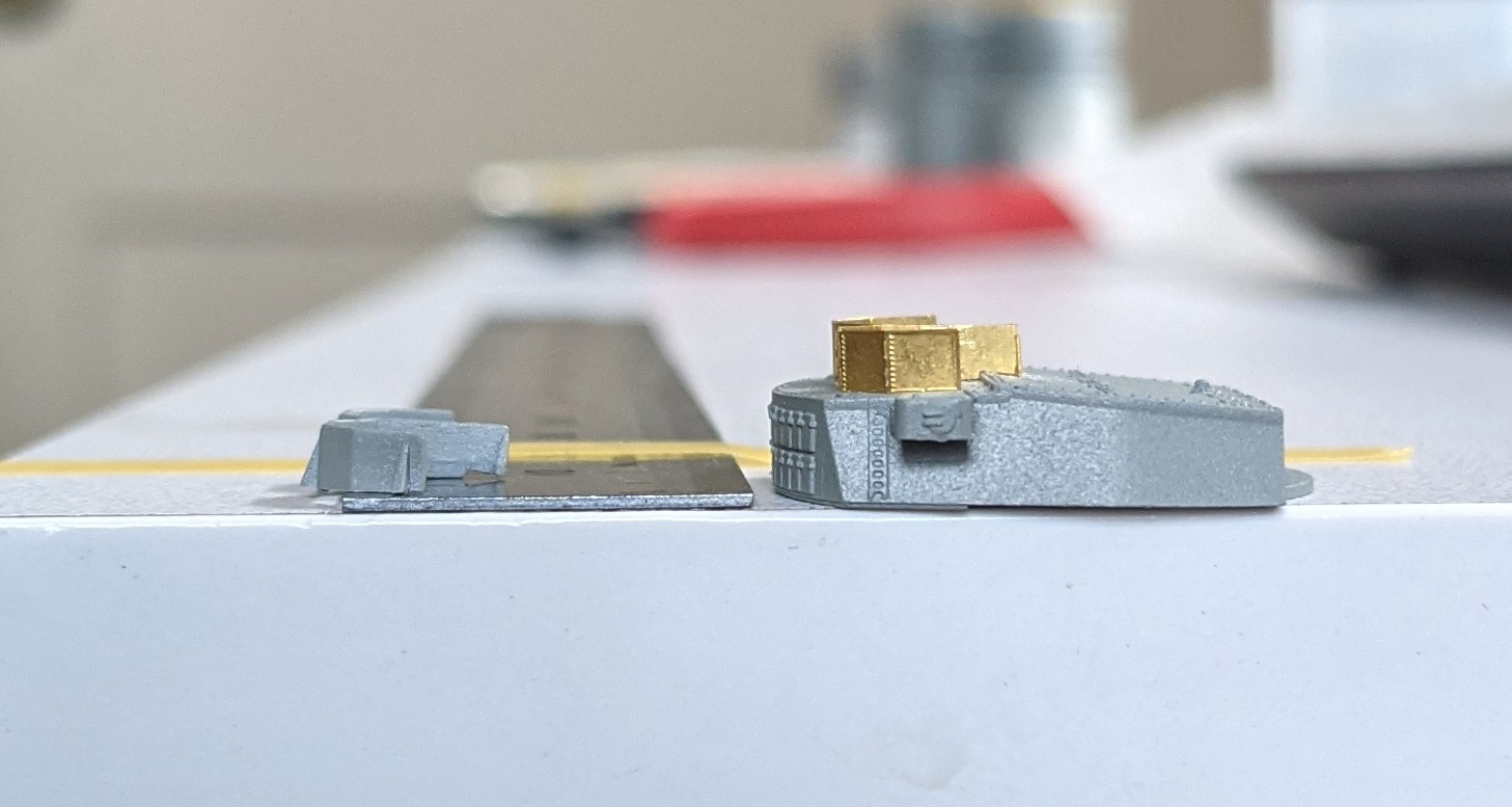

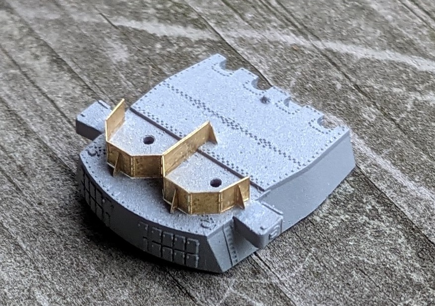

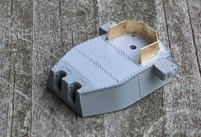

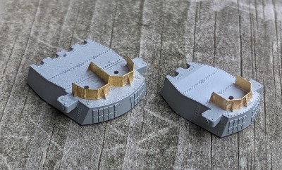

I started work on the gun turrets - I love the look of the King George V guns, especially the huge quad turrets so I really wanted to nail it. I opted NOT to use the brass barrels, because I thought there was no way I was going to be able to get them to be uniform and straight (I wish Flyhawk made this part a little easier... in hindsight I wonder about 3D printing new trunnions). This is much more important to me than any small fidelity gained with the brass. The plastic guns are quite good, although they needed more cleanup than it seemed initially.
For the blast shields for the UP launchers, I was initially planning to use the plastic pieces rather than fiddle with the PE parts. On first glance they look good. Flyhawk has tapered the bulkhead thickness so that they appear very thin while keeping enough thickness at the base to maintain shape and strength. But the gussets are also tapered, which looks a bit odd. And at some point I realized the shape of the aft plastic piece is wrong. The turret roof in this area is not parallel with the deck, but actually slopes down towards the back of the turret. The plastic piece is tapered to offset this (so the top of the bulkhead is parallel with the deck). This is wrong, at least according to the official KGV as-fitted drawing. The shield should be parallel with the turret roof, not the deck. The PE part gets it right. So in the end I suffered through more teeny brass.

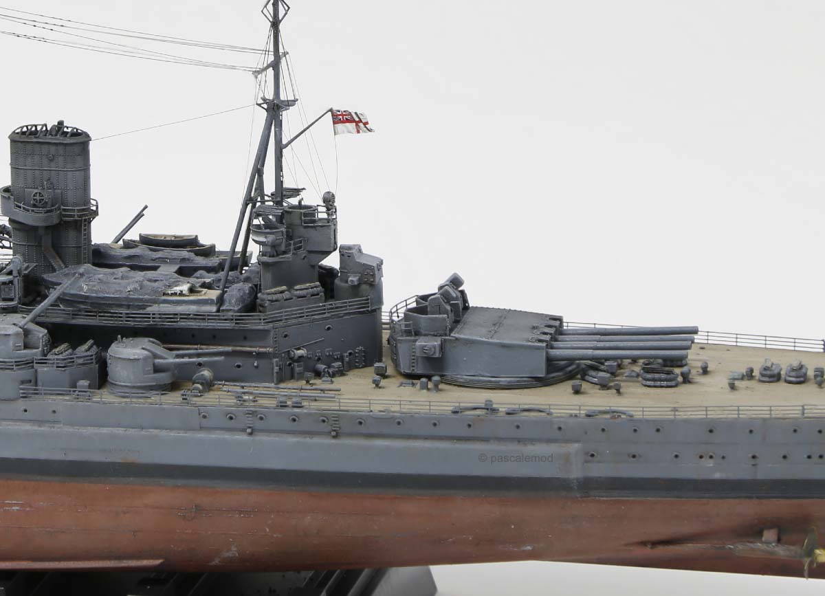

Wanna draw your attention to the way boot topping is painted. I think boot topping could be a tad higher, extending on the belt. You might end up with the cruiser proportions on the model almost, with very tall freeboard optically. Just a thought. :)
For comparison look at armoured belt and where boot topping is on mine. It is your ship of course so ultimately your call!

So, I think that the freeboard was pretty accurate overall. I compared it to photos and then squinted looking at my model. I tried to compare the relative height of armor belt between the boot topping and top of armor belt, to the thickness of the boot topping overall. It was not exact science. So if you go back browse my model, feel free to use it as reference as I did sadly spent too much time on it. You can also see where hull plates are, where scuttles are - and draw the line somewhere.
She sat low, I think for the 1941 May sortie against Bismarck.

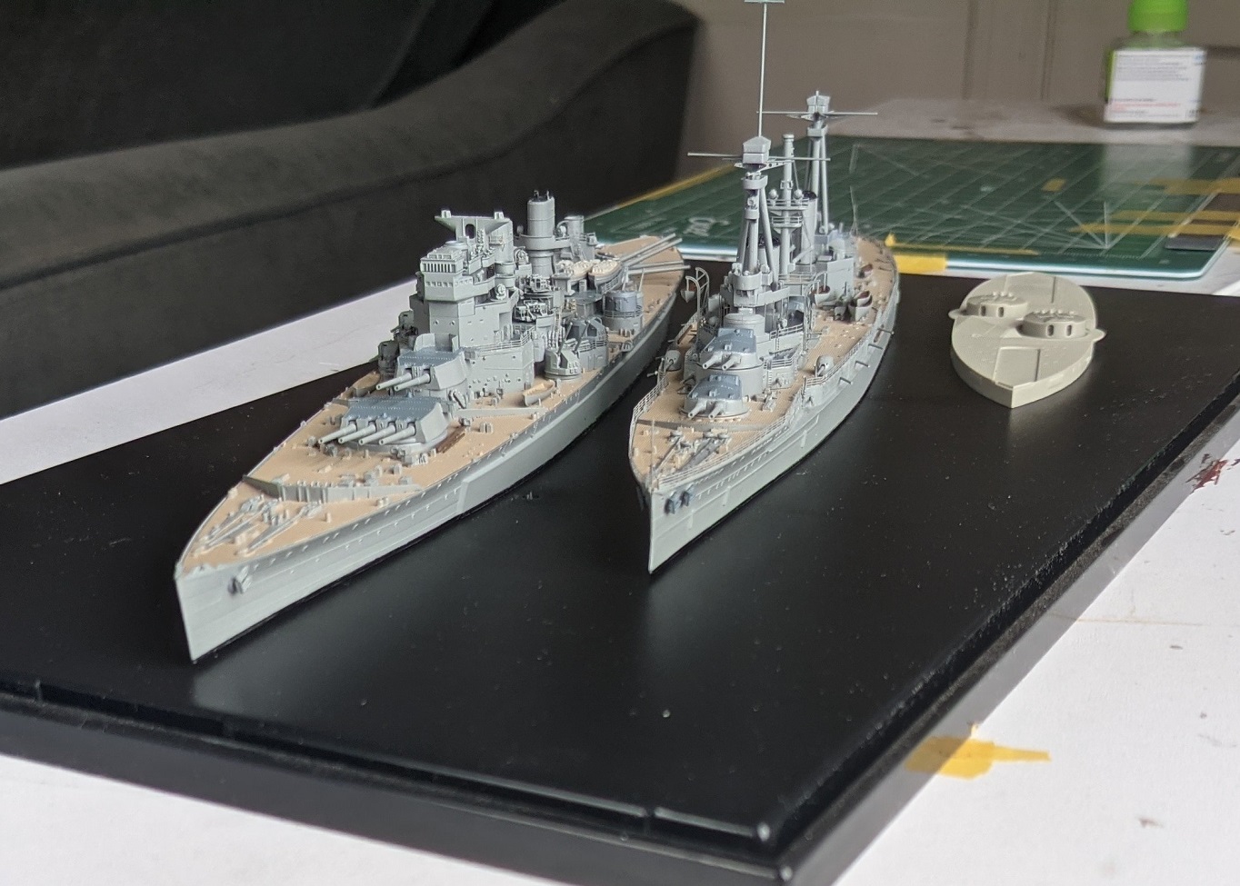

I'm afraid that would not be accurate, I am depicting the famous meeting in harbor between Prince of Wales and Agincourt - so freeboard at 0 knots is most accurate :big_grin:
ETA: Hypothetically, if truly trying to show the ship at speed, the stern should be deeper as the back of the ship 'squats' yes?

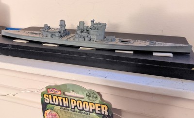

Well, I did my best at cleaning up the waterline. The rear ship wasn't perfect either right? Anyway position of the waterline seems more accurate. The ship does look a little high in the water but I will deal with that for now... maybe some day it will end up in a sea base
