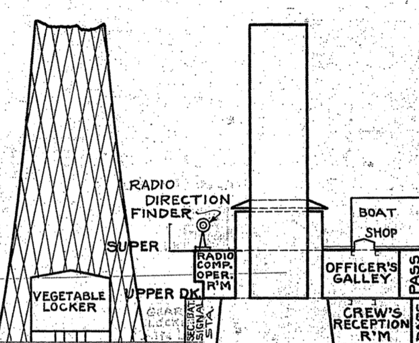

Trying to figure out what exactly was aft of the rear funnel. The plans show a Radio Direction Finder there.

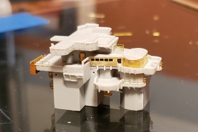

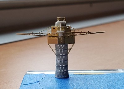

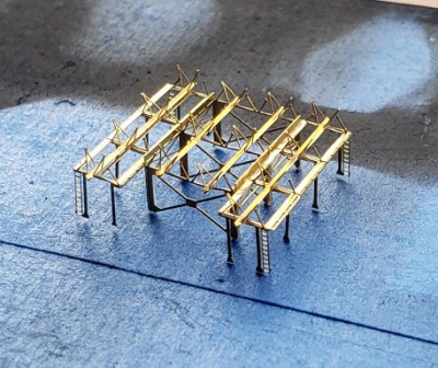

The FS set for WeeVee has been out for a few years. I used it on my WeeVee.
Mostly good, but be forewarned that the instructions suck, there are extra and unidentified parts, and the PE railings are soft and easy to bend. The superstructure parts really make the bridge shine. The boat rack is also difficult to assemble but, it can make a world of difference. Catapults are great, but need a piston. Love the spotting tops.
And whatever you do, find some 3D printed Kingfishers. The kit versions will take a year off your life. Not Orange Hobby ones, though. Almost as bad.
My two cents

I don't see one there in the attack photos.
I agree, there's nothing there except the lockers.
