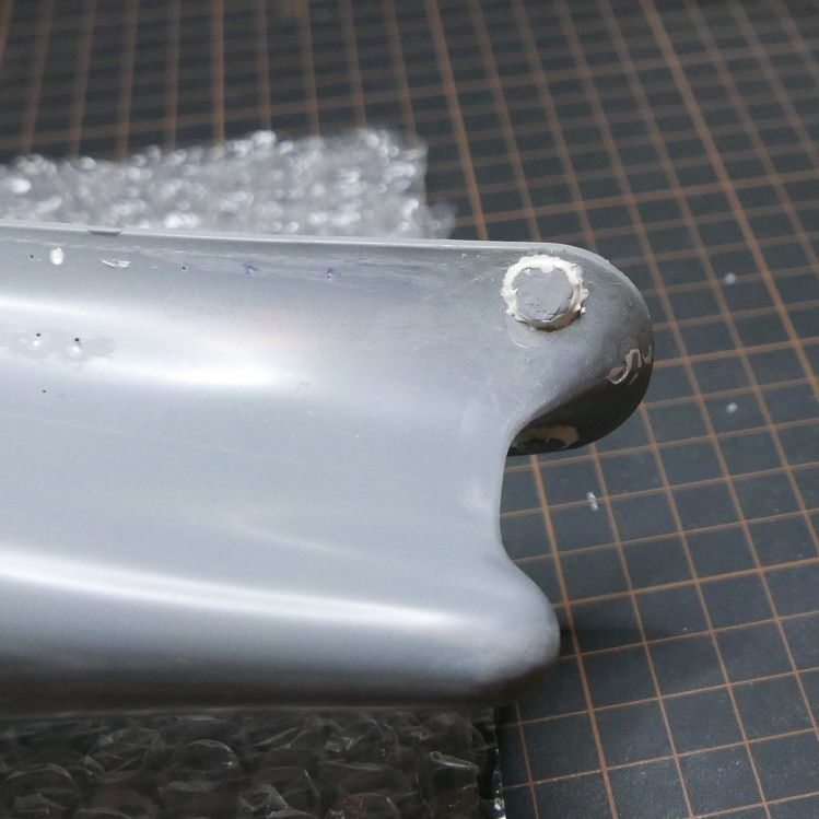

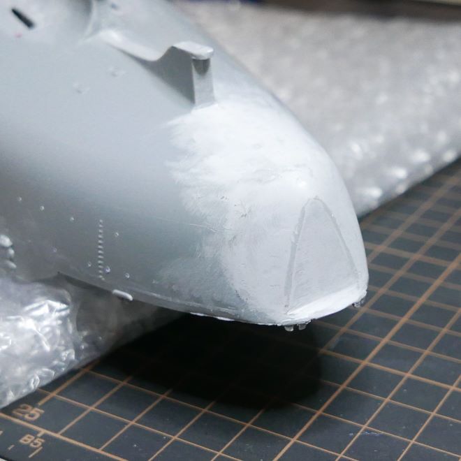

File comment: Tried to reshape the transom

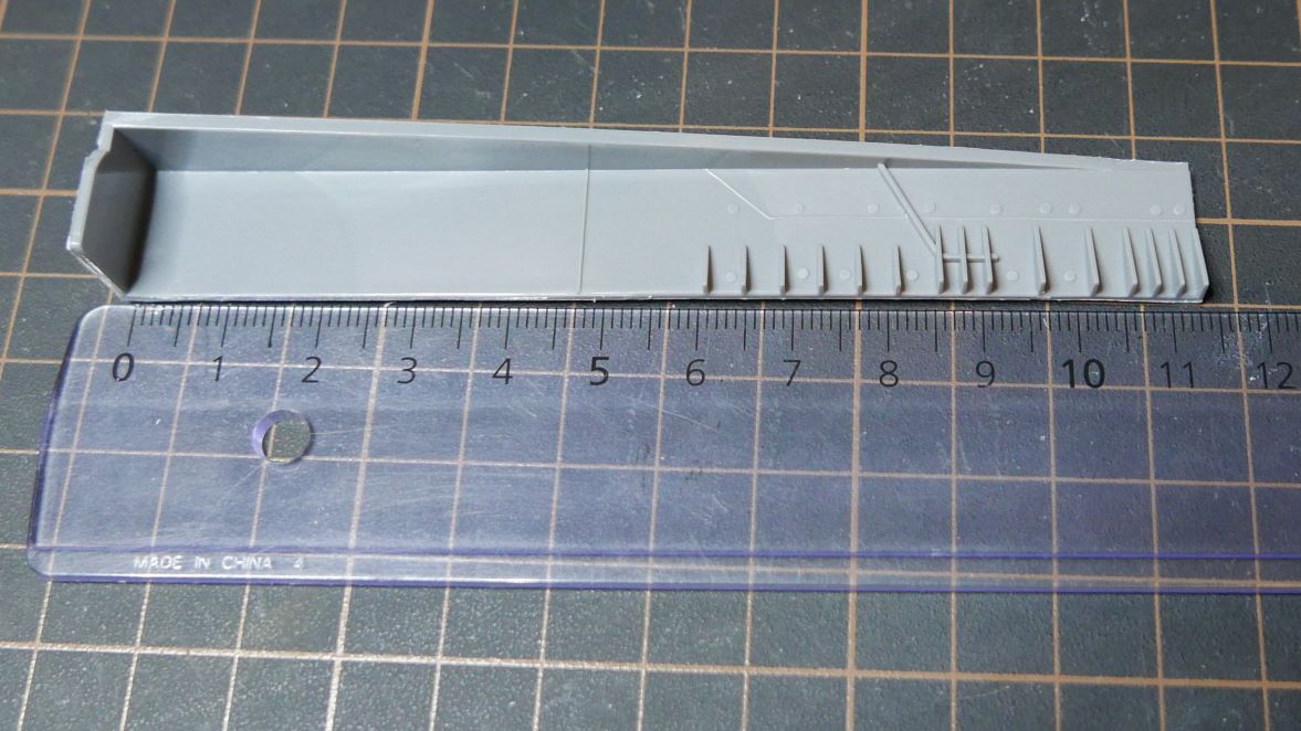

File comment: Corrected the shape of the fwd end of the armour belt

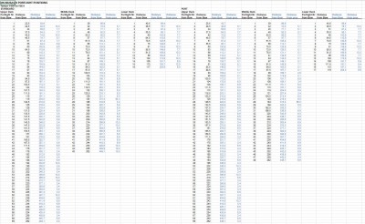

File comment: Based on the Skulski book, made an Excel-sheet of the port holes positions

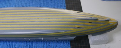

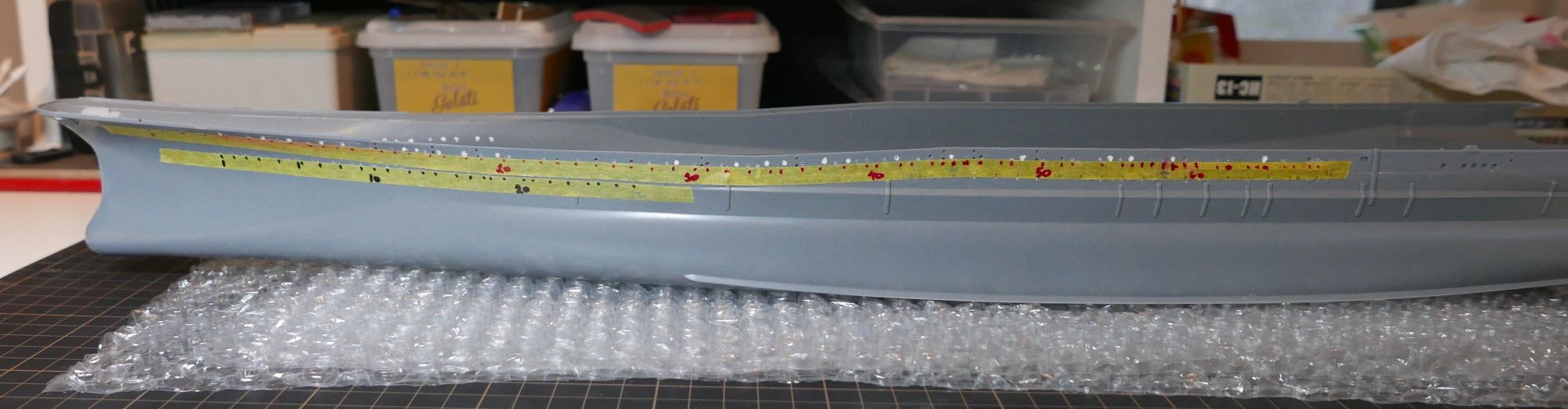

Hull continues (final corrections and initial paint work):

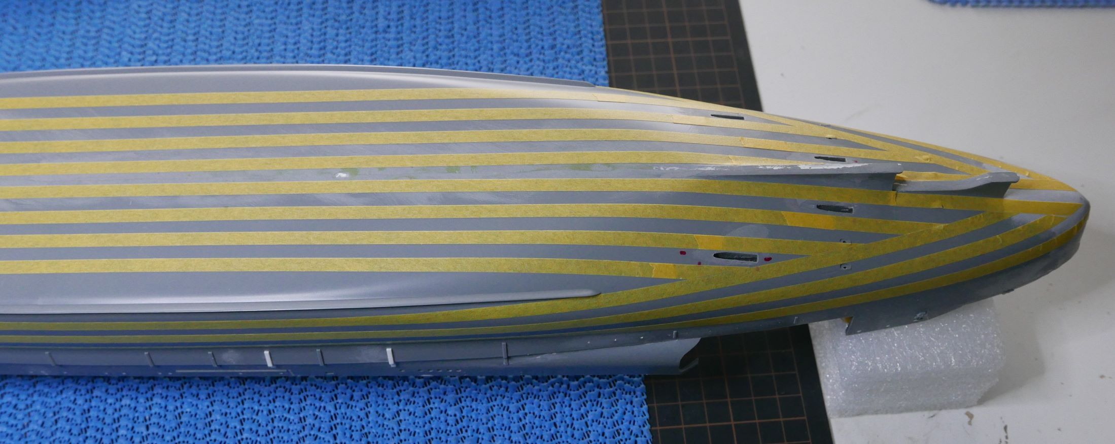

File comment: Tried to imitate the hull plating with masking tape

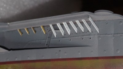

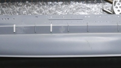

File comment: Removed the terrible flight deck support beams
File comment: Made new beams from scratch (stryrene & etch) because there were none in the Eduard set

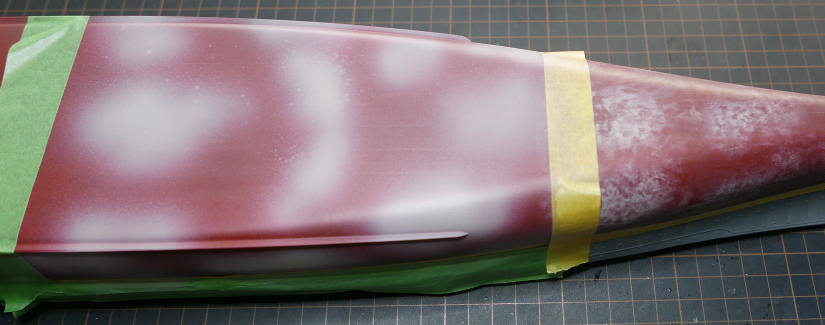

File comment: Created preshading of the frames and longitudinals, of course none in the armour plate area!

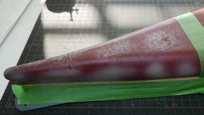

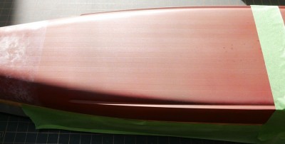

File comment: Painted the lower body with Tamiya XF-9 Hull Red
File comment: Plating showing nicely under the paint

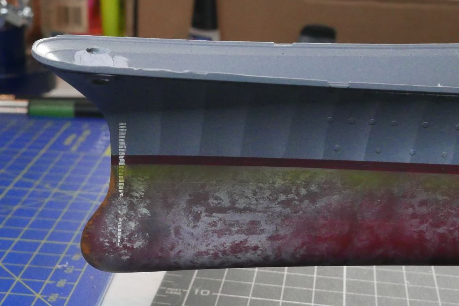

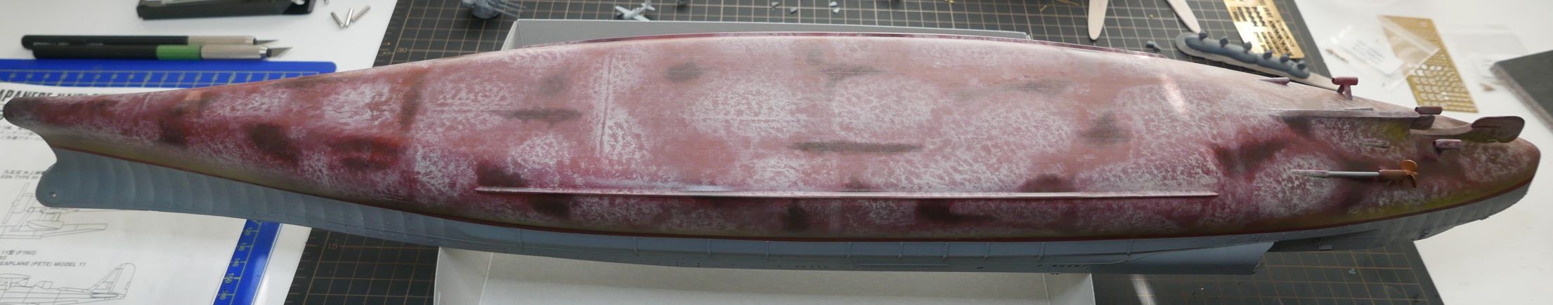

Finished the hull with weathering method described by Koppalakki which gives the model a nice wornout look (but requires quite a bit of work and patience :heh: !). Used mostly products from AMMO Mig (MIG-1208 Rainmark Effects & MIG-2010 Scratches Effects) plus AK Interactive (AK027 Slimy Grime Light, AK304 Brown Streaking Grime for Red Hulls & AK306 Salt Streaks for Ships). Final touches with AMMO Mig DryBrush paint MIG-0612 Rust.
File comment: Divided the hull in 4 sections just to make work easier to handle
File comment: After finishing the bow section, attacked the middle ship area
File comment: The whole underbody treated
File comment: Details of the stern part
File comment: Finished bow area with shading with white paint for the vertical frames
File comment: Added some salt streaks for the upper hull
File comment: Final touches with some dirt marks

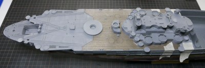

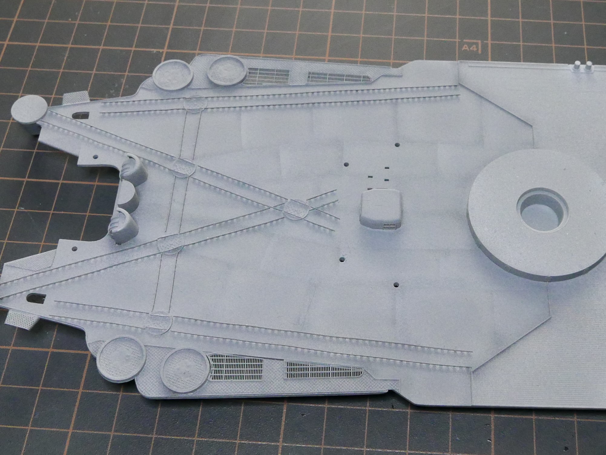

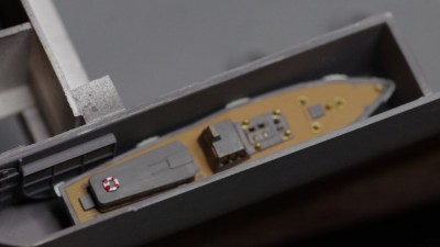

DECK & SUPERSTRUCTURE
As with the hull, the deck & superstructure contained a lot of mistakes of which I tried to correct a few, but did not really bother to attack all the details, because it would have taken far too much time. And it was already clear, that to make this old Tamiya kit historically correct was not going to be a realistic target (at least with my skills).
File comment: First thing to do was to clean away those plastic parts that were to be replaced with PE like AA gun shields and flight deck tracks. Unfortunately, the Eduard PE set did not include all the necessary parts.

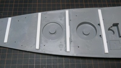

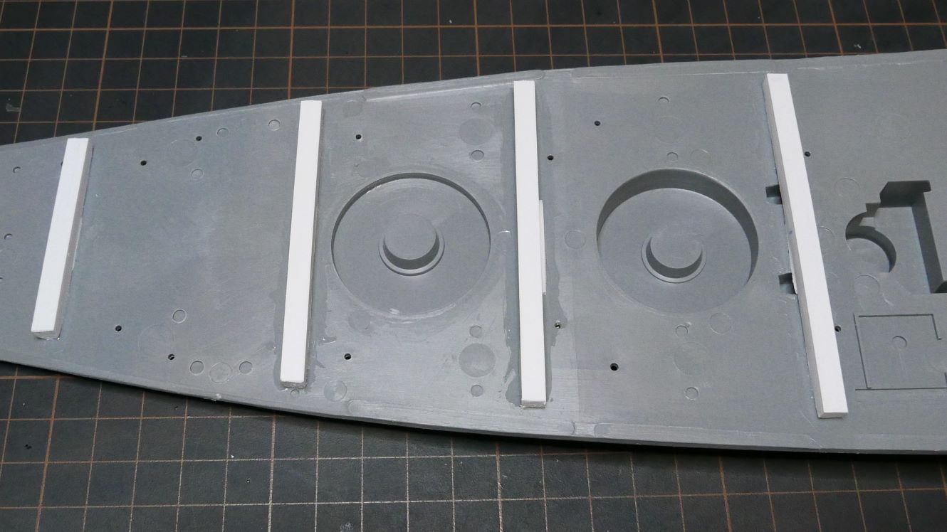

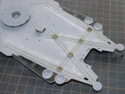

File comment: As Chuck proposed in his list, the deck needed some support beams to create some kind of camber and to reduce flexing

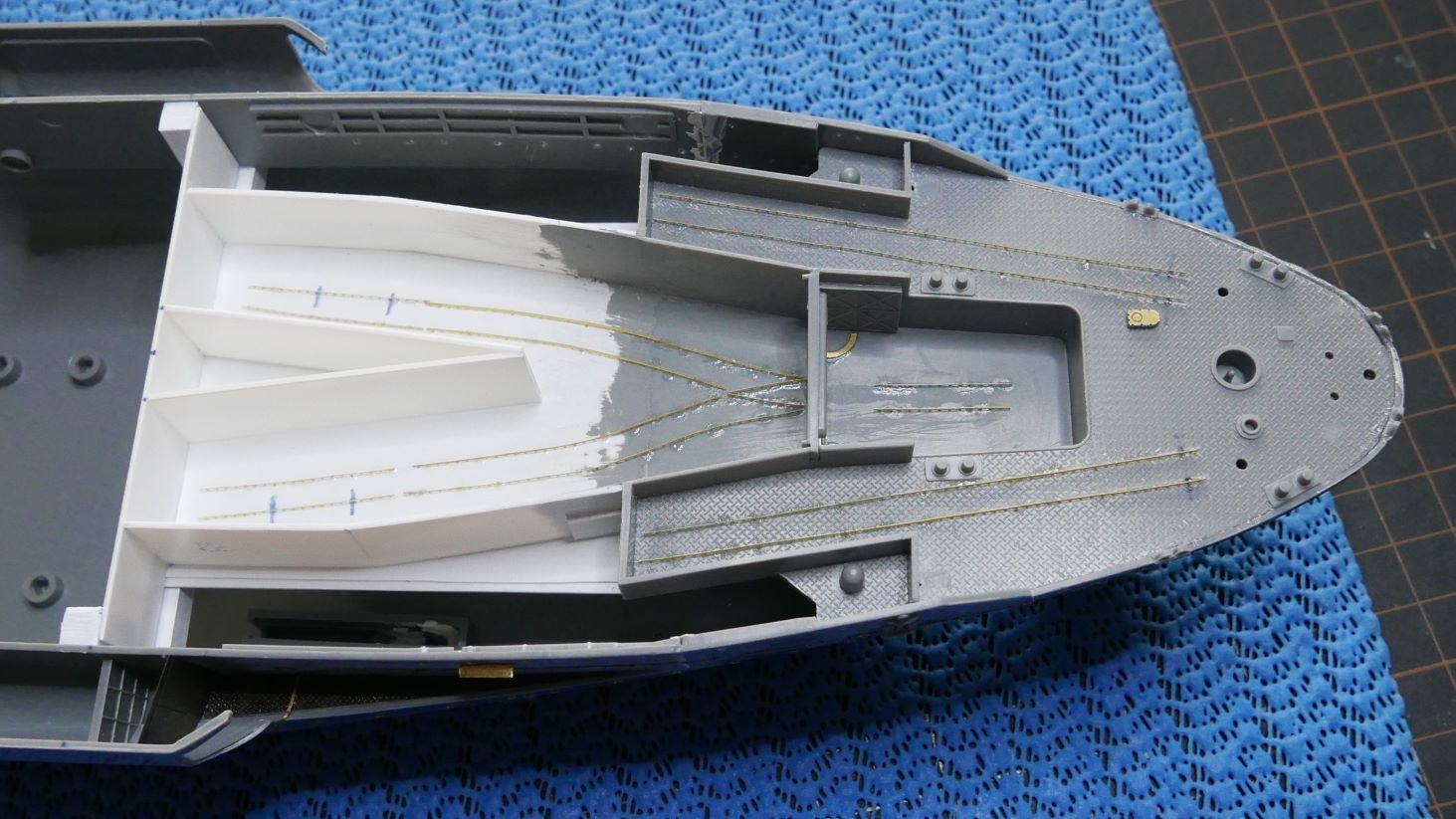

File comment: Started to add PE on fwd deck. In some cases it was difficult to decide whether to do this before or after mounting the wooden deck.
File comment: Same thing with the aft deck.

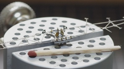

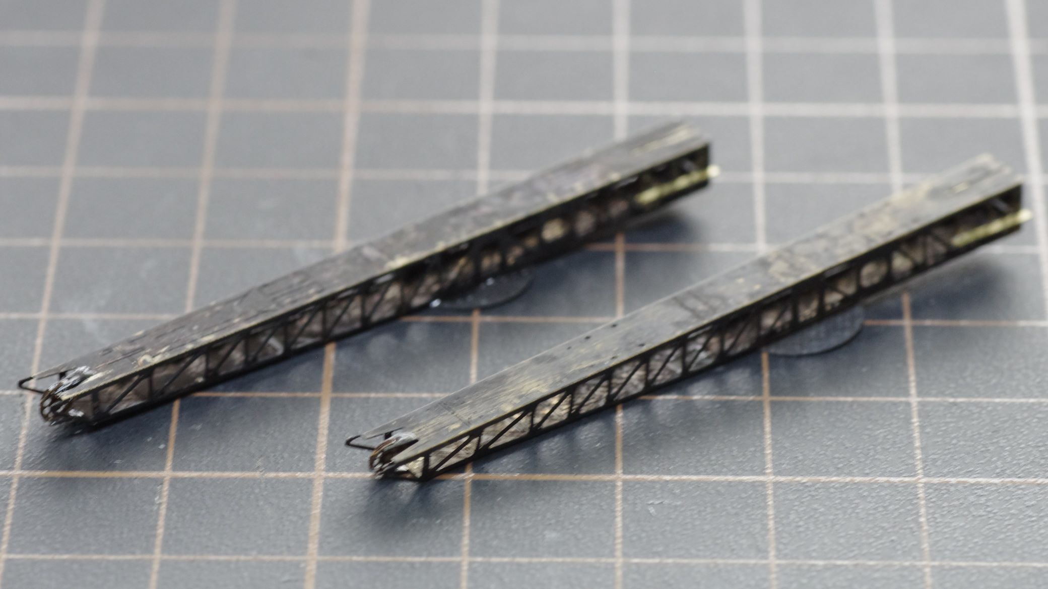

File comment: Flight deck rails & turntables were from FStar PE set (not included in Eduard set).

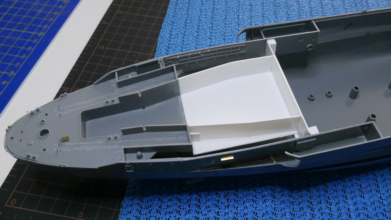

File comment: Wanted to improve my scratch building skills, so I exteded the hangar forward.

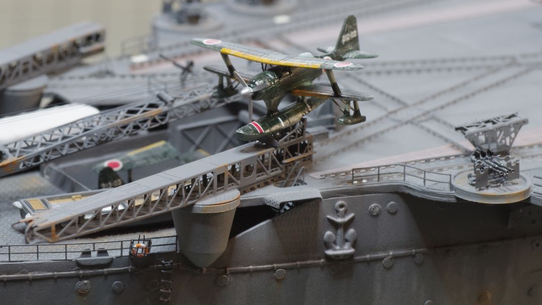

File comment: Added plane & boat tracks.
File comment: Added some extra PE detail, although these won't be visible when the deck is on.

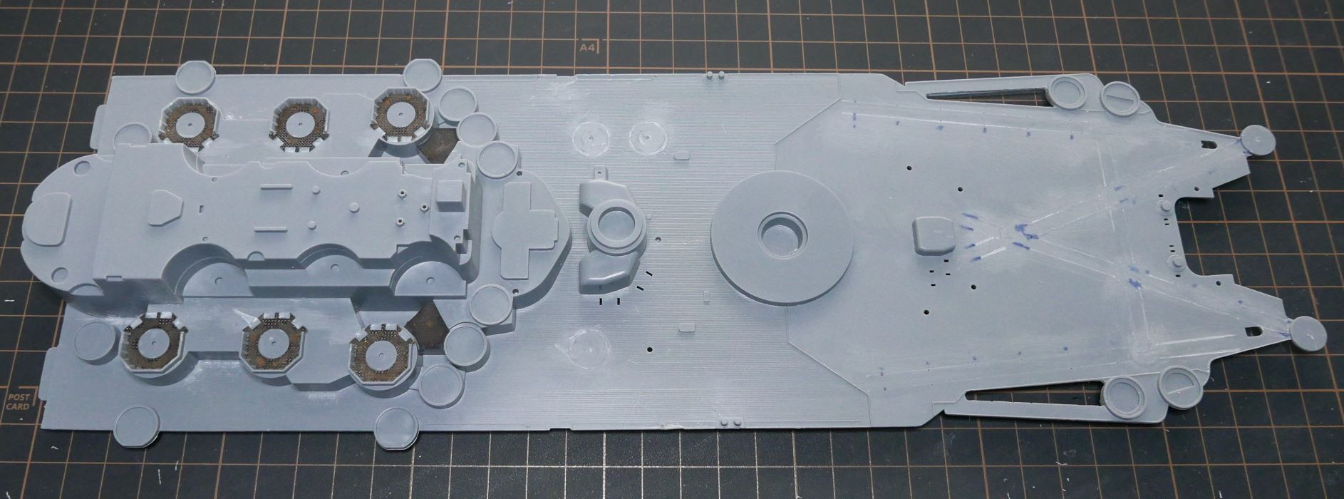

PostPosted: Tue Feb 18, 2025 10:28 am
Joined: Sat Jul 16, 2022 1:25 am
Posts: 72

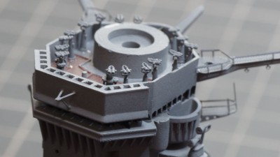

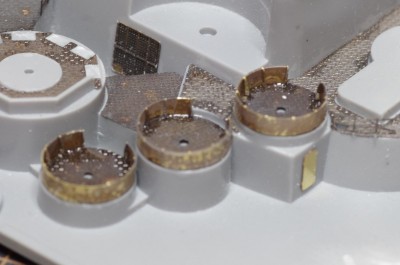

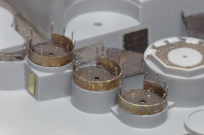

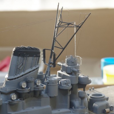

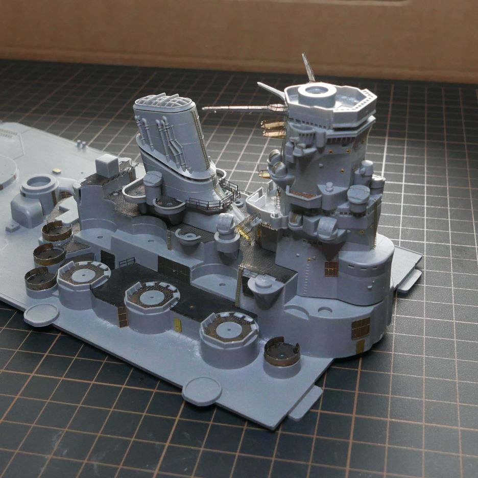

Deck & superstructure continues with the command tower & initial painting.
File comment: According to Skulski book (page 158) the signal deck has several errors of which I only corrected the flag stowage area.

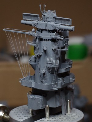

File comment: The command tower is a project in itself with all those tiny PE parts.
File comment: Starting to look like it should be.
File comment: All PE parts really make the difference in a ship model!
File comment: Unfortunately, the Eduard set had several stupid errors like this mast base area: the holes for the mast were the wrong way around!
File comment: Once in a while, one needs to motivate oneself with some dryfitting.

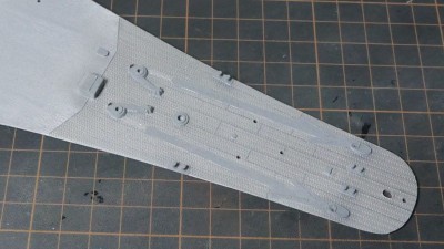

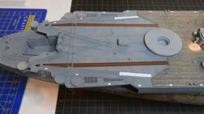

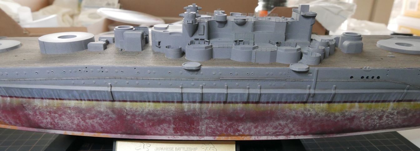

File comment: Started initial paint work with the forecastle deck. I painted the antislip area with steel colour to imitate the galvanized plates.
File comment: After the initial paint, I added some shading on the flight deck to create a bit of variety.
File comment: Finally, several thin layers of diluted Kure Gray plus final shadows with white.
File comment: First primer for the lower superstructure.

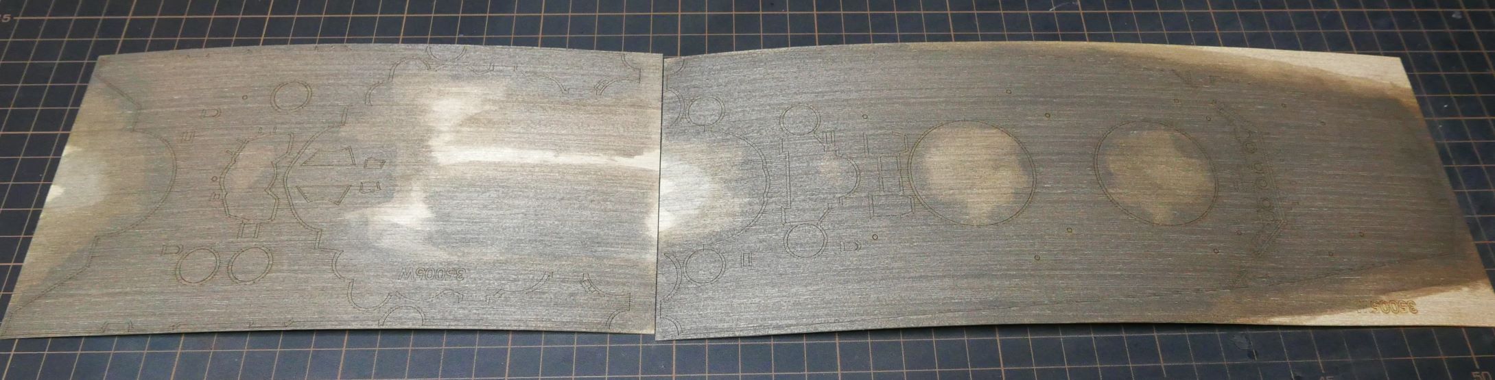

Deck & superstructure continues with the Pontos wooden deck.
This was my first ever wooden deck assembly and it was a bit tricky because the old Tamiya tooling has included a big part of the superstucture in the deck mould. This meant that every hole, bend and corner had to be adjusted painstakingly before the actual glueing. It took me several hours to get everything ok (and not to damage the fragile material). It also meant that most of the paint work for the superstructure had to be made before mounting the wooden deck. For the same reason, I also stained the deck before the mounting. I tried to copy the colour of an aged & weathered cypress wood. So, although it looks a bit towards grey, it was not my idea to copy the black stained deck during the breakthrough in the San Bernardino Strait (which seem to have lead to some "heated" discussions in the net).
File comment: The difference between a new and weathered cypress wood.
ONLY FOR REFERENCE!

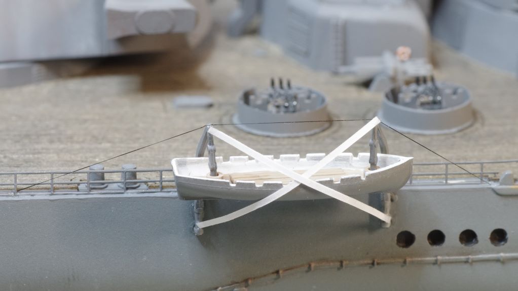

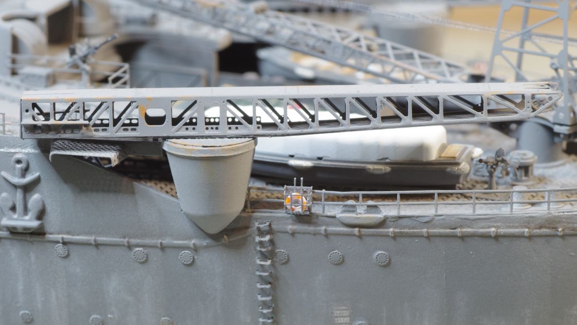

File comment: Added anchor chains (also from Pontos) and some weathering on the forecastle deck.

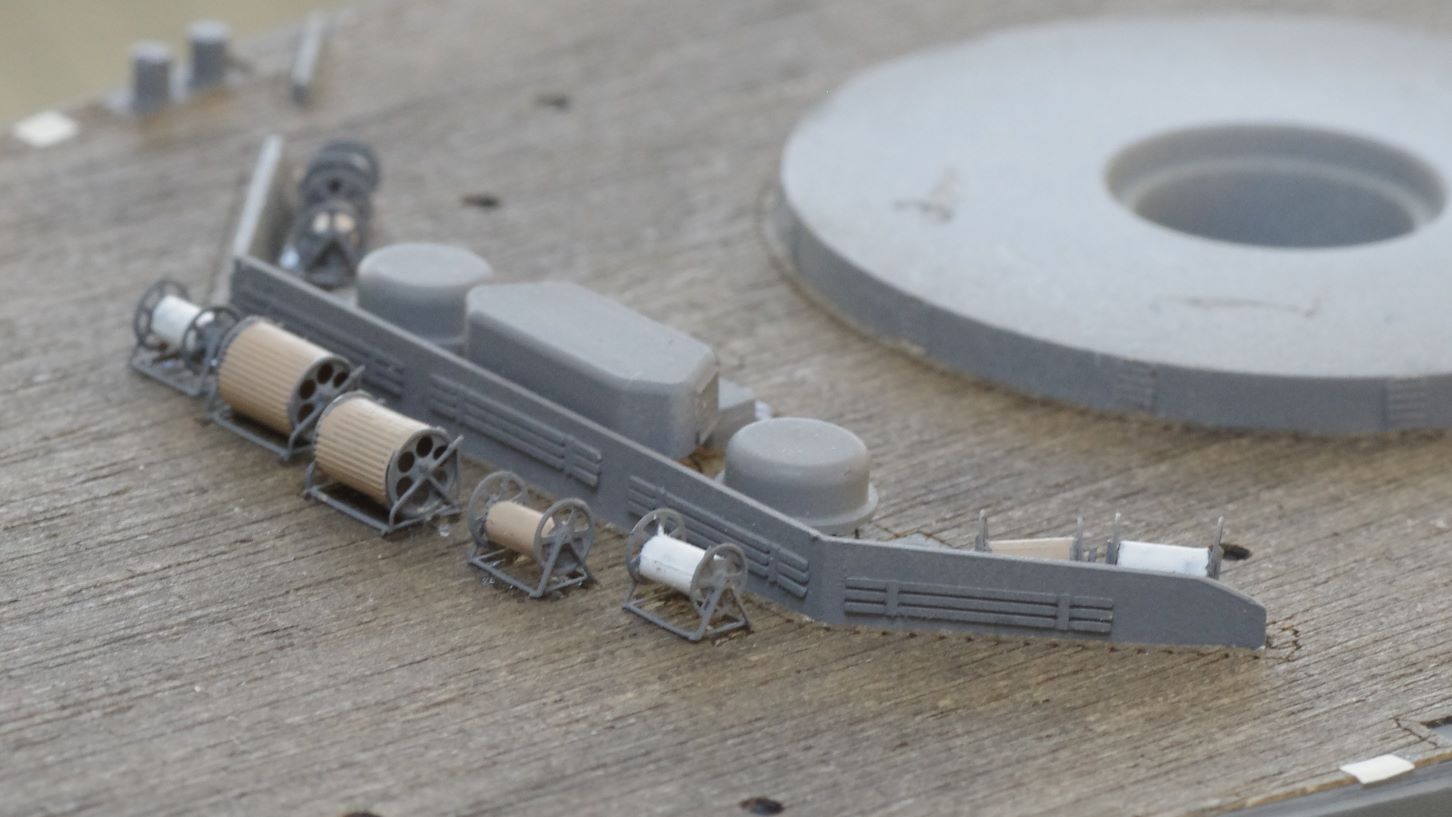

File comment: Mounted all the rope & cable coils on deck.

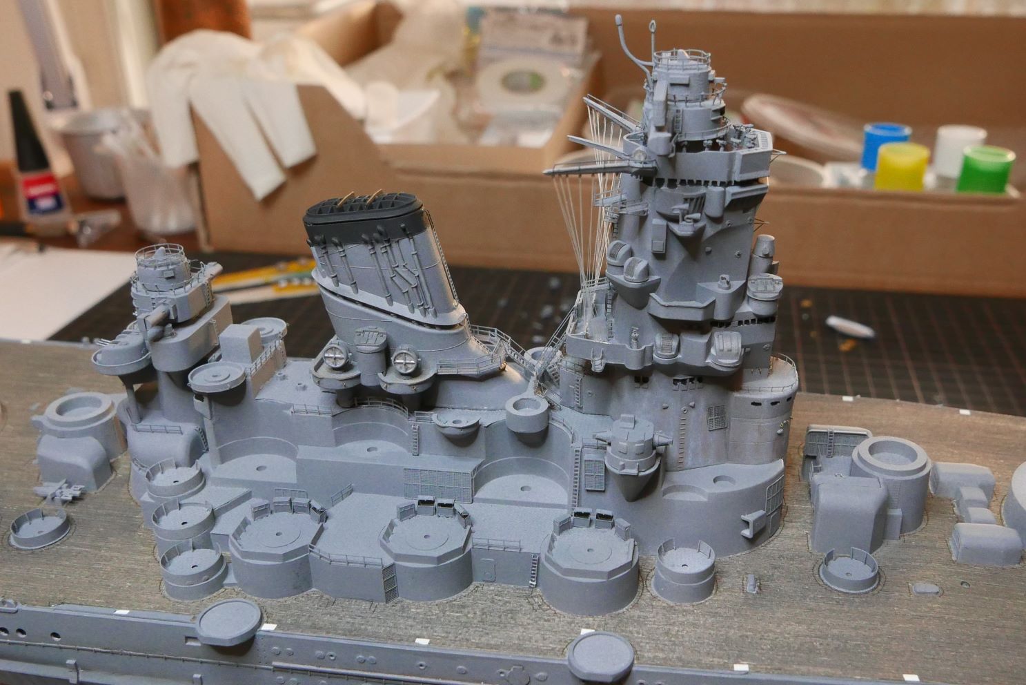

File comment: Finally, assembled the main parts of the superstructure.

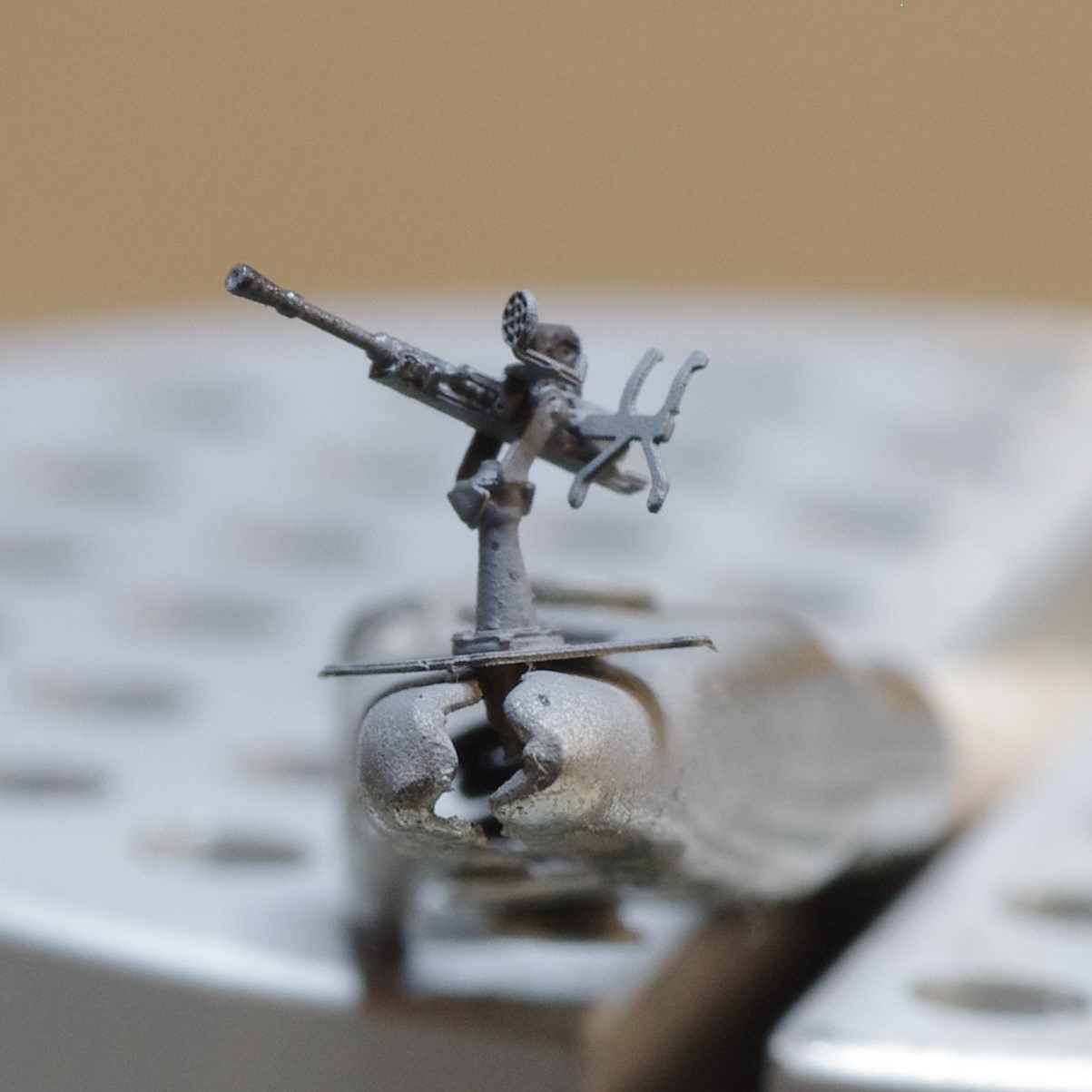

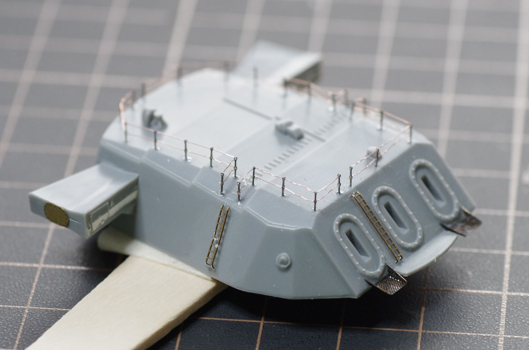

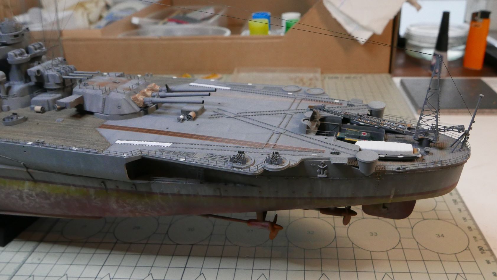

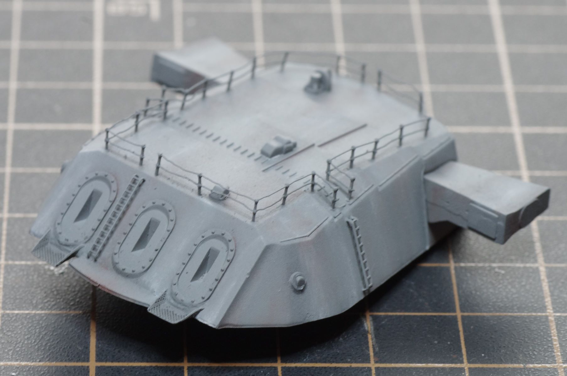

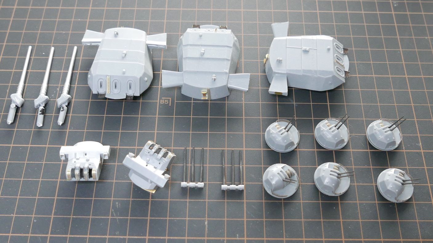

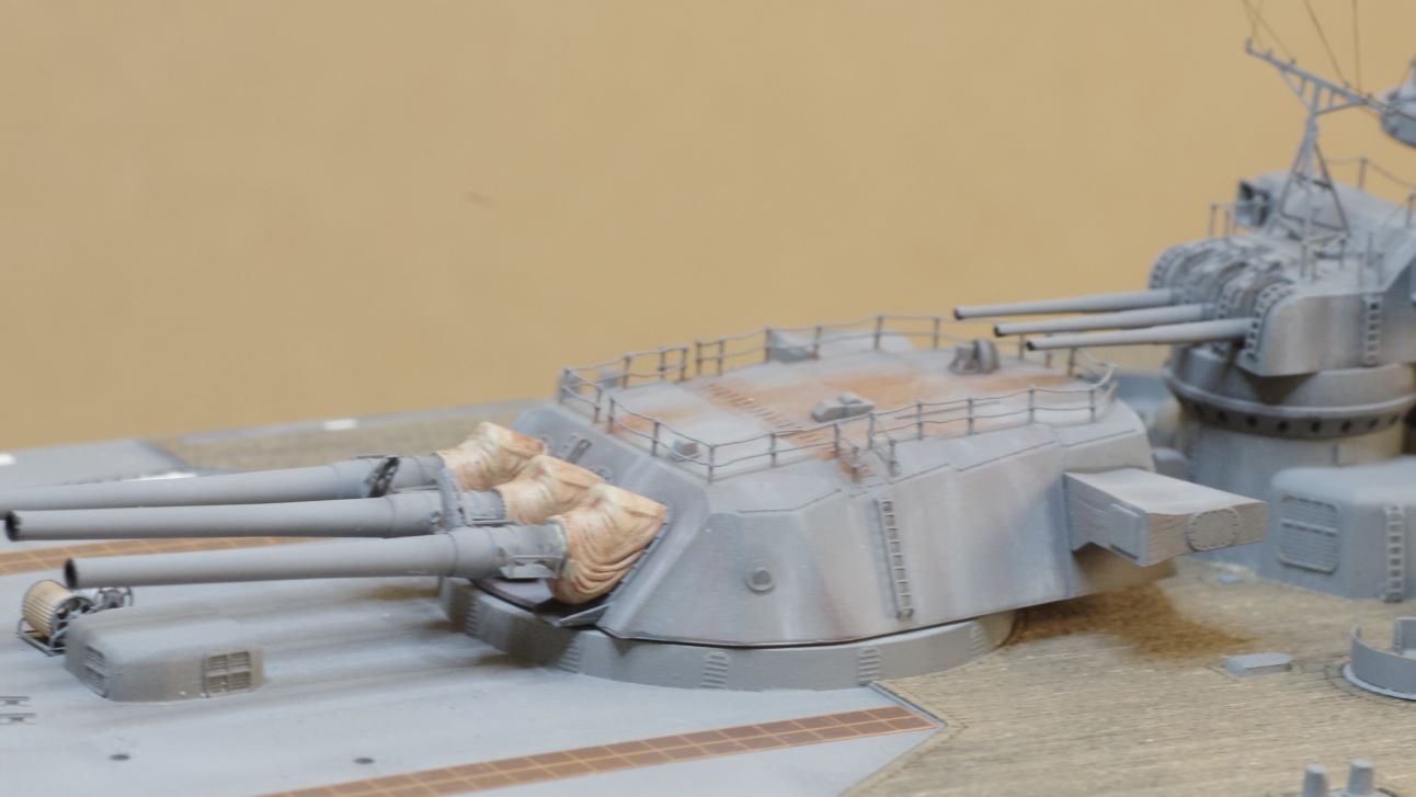

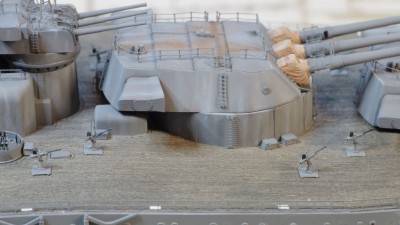

ARMAMENT
Main armament consisting 9 pcs of 460 mm cannons in 3 turrets and 6 pcs of 155 mm cannons in two turrets was fairly straightforward to build. I had purchased metallic barrels for both of them and also for the 105 mm AA guns. Eduard set did not have the railings for those guns, so I used generic PE sets instead.

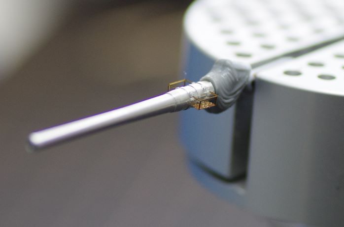

File comment: Glued the Aber aluminium barrels to original blastbags and added some detail PE stuff from Eduard.

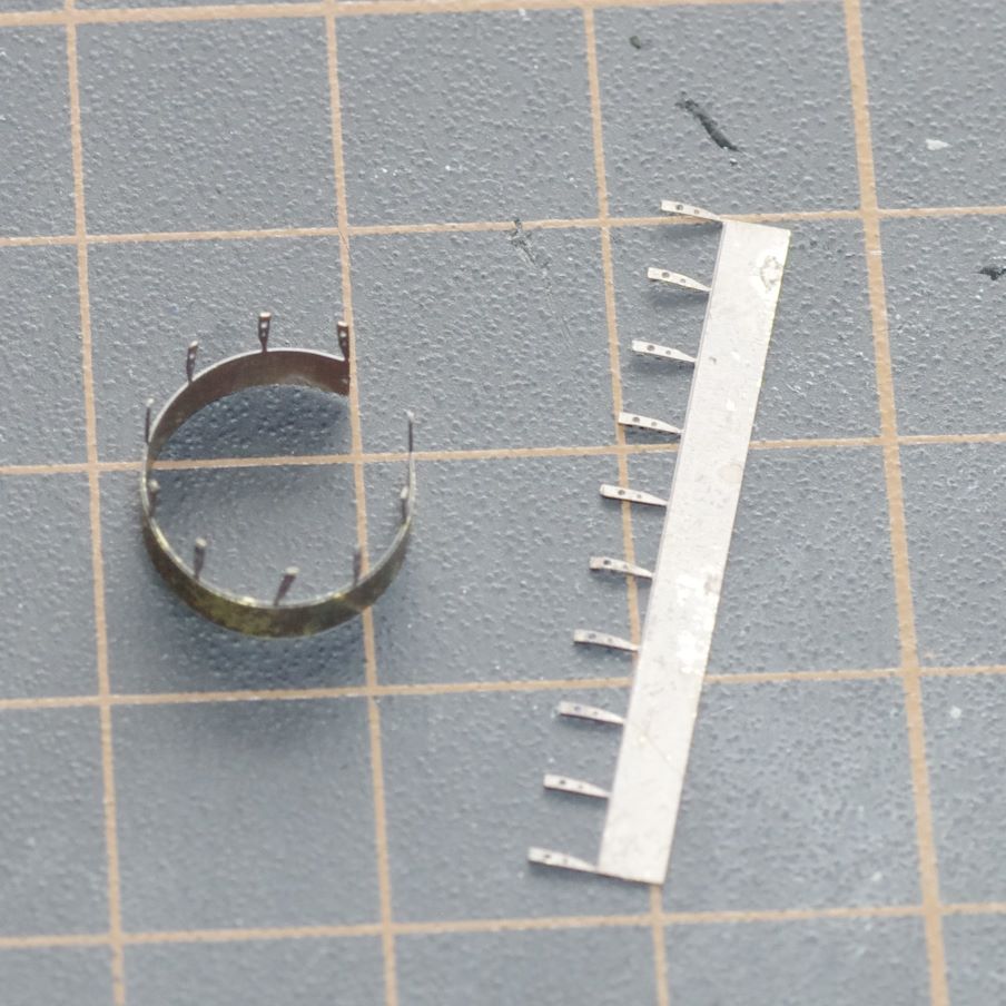

File comment: Since Eduard PE sets did not have railings for the main guns, I used Tamiya's generic set with individual stanchions and 0,1 mm copper wire. A lot of funn with this!
File comment: Same procedure with 155 mm guns.
File comment: After primer and base colour, I added some shading.

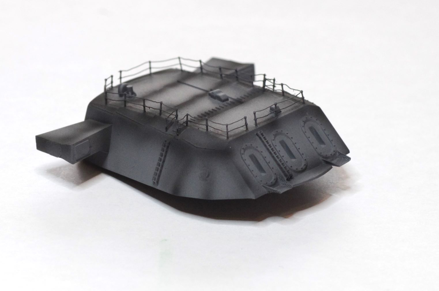

File comment: Same with 155 mm.

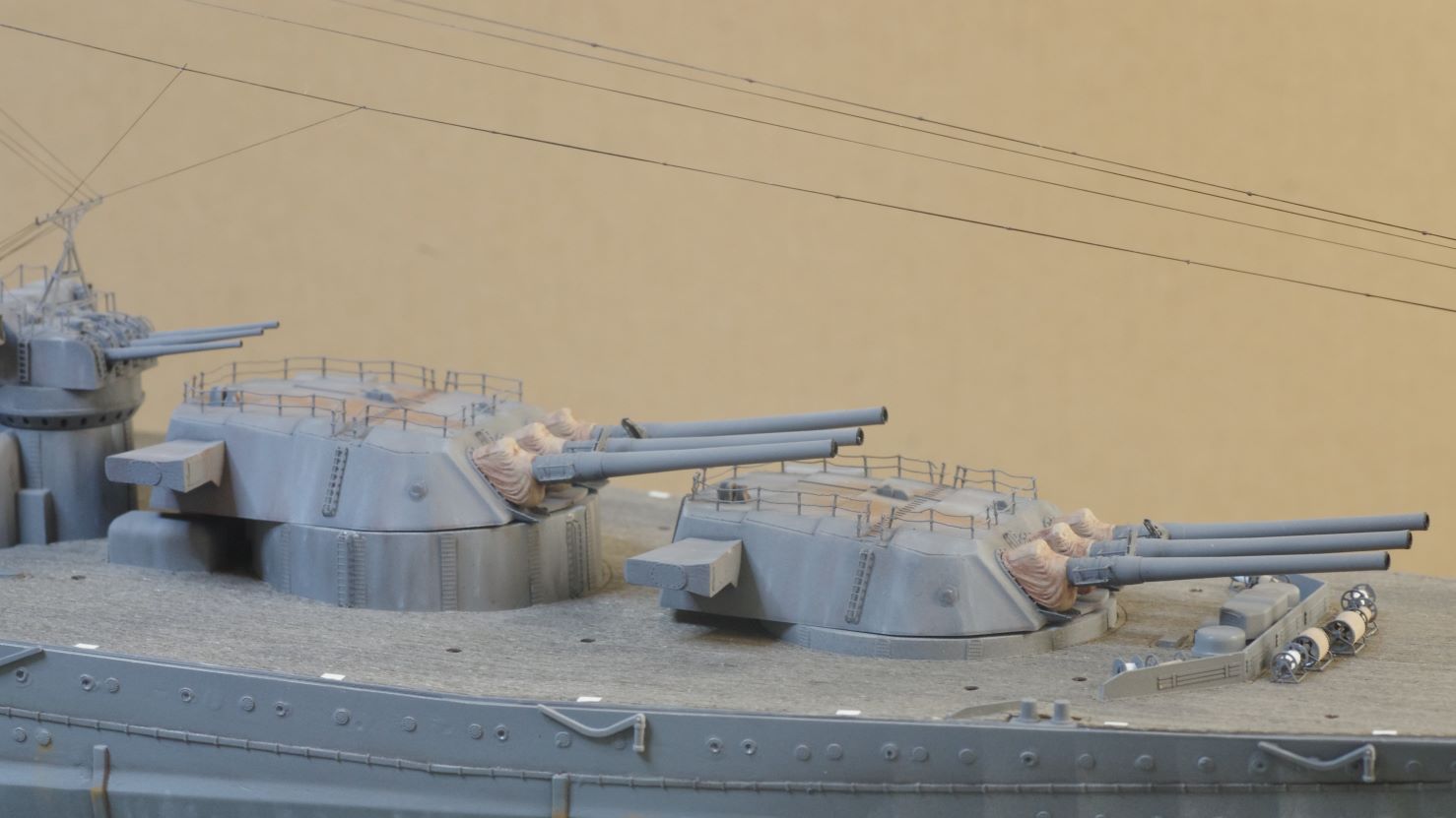

File comment: After several layers of thin base colour, I added some weathering with salt lines (AK Int AK306), dirt (AK Int AK304) and some pigments.
File comment: Finished product with barrels in place.

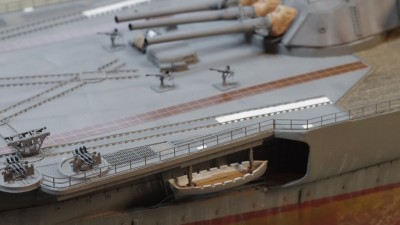

File comment: Forward main armament in place.
File comment: Same with aft armament.

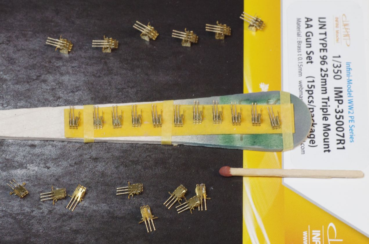

ARMAMENT continues with AA guns.
Once again, Eduard set did not have PE parts for the actual AA guns (only the shields were included), so I purchased some nice sets from Infini which are definetely high quality products. However, they are also very tiresome to build due to excessive number of parts. Eg. the triple 25 mm AA guns consists of 20 individual parts and since there are 27 of those, it means 540 parts for those guns (a tough project within a project :Mad_6: ). But the end result is impressive.
File comment: A nice set of Infini's PE parts for the AA guns and ammunition boxes.
File comment: I started the shields by bending them roughly into the right diameter.
File comment: Then I glued the base plates on the superstructure and after that glued the shields in place to get the right diameter.
File comment: Finally, bended down the supporting brackets and glued them in place.
File comment: Instruction show clearly, how complicated the assembly is.
Infini IJN Type 96 Triple Mount 25mm AA Gun Set .jpg [ 72.81 KiB | Viewed 827 times ]
File comment: Work in progress.
File comment: This was a real challenge for my poor eyes and shaky hands!
File comment: All 27 ready for the paint.
File comment: Final product with three different colours.
File comment: Started to glue them in place.

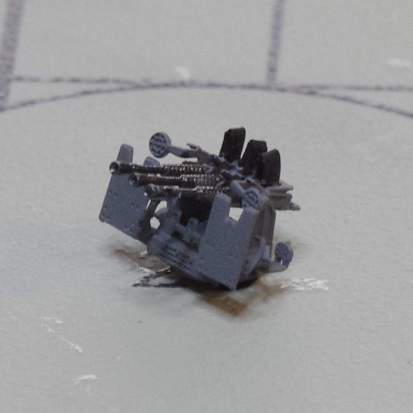

PostPosted: Thu Feb 20, 2025 11:46 am
Posts: 72
ARMAMENT continues with single 25 mm AA guns and twin 12 mm machine guns plus the ammunition boxes.
File comment: Single 25 mm guns were small but relatively easy to build with "only" 13 parts each.
File comment: Ready painted.
File comment: Finally, the smallest of them all: twin 12 mm machine gun with 12 parts each.
File comment: Luckily, only two were needed!

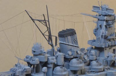

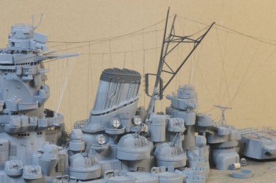

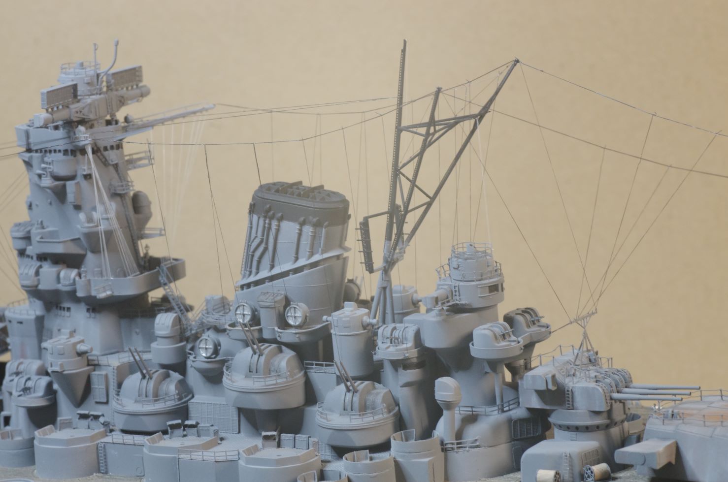

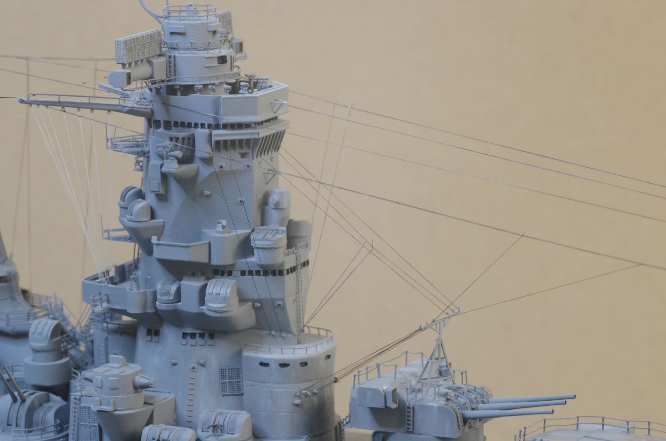

RIG
After seeing Katana's comprehensive study of the Yamato rigging, I was a bit afraid to start the job. In the end I decided to do a rather simple version since the target of this build was never to reach any award winning level. If I remember correctly, I used three different kind of thread: AK Interactive's Thin for the longitudinal wires & Ultra thin for the verticals plus Infini's Super Fine white for the halyards. I also added some white cylinderical insulators & brown ball insulators (some white glue + paint). Despite having a few disasters, the end results was quite ok.
File comment: I added the white halyards for the command tower already before glueing the tower into the deck. I think it was easier this way.
File comment: Command tower in place.
File comment: Unfortunately, Eduard set did not include brass bars for the main mast and also the radars were a bit wrong.
File comment: Mast in place and rigging in progress.
File comment: Wiring in front of the command tower done.
File comment: Midship wiring finished.
File comment: Longitudinal wires connected with the crane.
File comment: Everything ready with insulators.

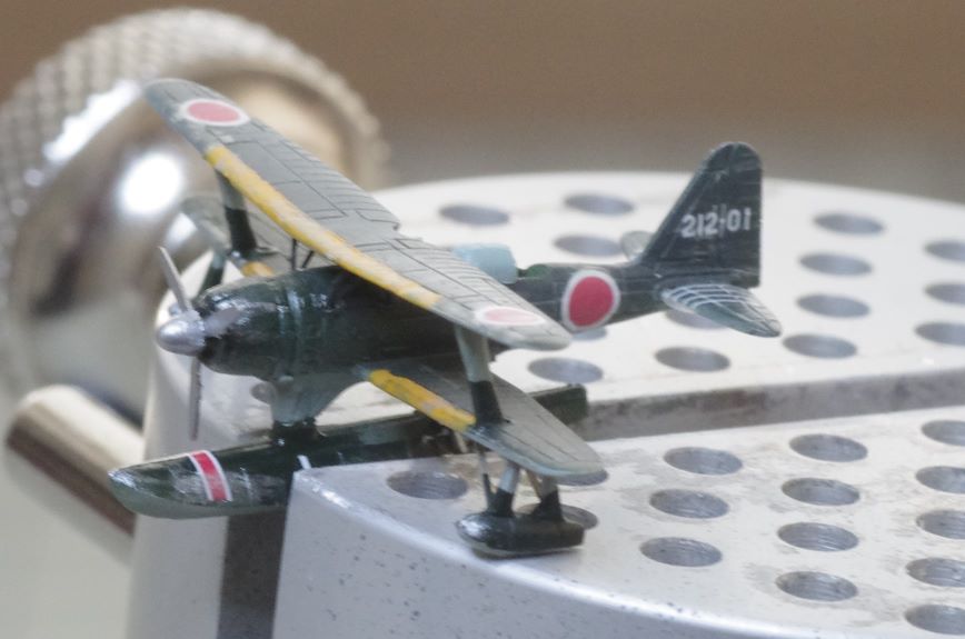

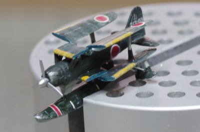

AUXILIARIES
The Tamiya kit contained poor quality planes and boats, so I replaced both of them. I used Hasegawa's Japanese Navy Ship-borne Seaplane Set A for visible planes (the ones in the hangar were kit planes) and Tamiya's own WWII Japanese Navy Utility Boat Set for boats. Luckily, the otherwise poor Eduard PE set had parts for catapults, crane and Type 21 radar above the Hoiban range finder.
File comment: The Hoiban range finder with Type 21 radar became more impressive with the PE parts. I also used Tamiya's individual stanchions + 0,1 mm copper wire for the railings instead of Eduard's simpler ones.
File comment: Kit did not have any binoculars (only simple molded studs), so I replaced them with binoculars from Bunker Studio.
File comment: I wanted to have the planes also with retracted wings, but I could not find any WWII photos, so had to use this CAD image.
File comment: Changing the Hasegawa plane was a rather fiddly process.
File comment: Pete in normal configuration was much easier.
File comment: Original kit planes in the hangar will not be visible, but I still wanted to add them.
File comment: Placed one plane into the well aft of the hangar.
File comment: Although not as detailed as the Pontos equivalent, the catapults were a nice detail.
File comment: Catapult glued in place. Notice also the nice lifebuoy from FStar.
File comment: Plane ready to take off!

File comment: 15 m motor boat
File comment: Boat placed inside the starboard boat stowage space (left the door in open position).
File comment: 9 m cutter underneath the starboard flight deck.
File comment: 9 m cutter hanging from the starboard aft davits.
File comment: 17 m motor pinnace to be placed beside the gangway.

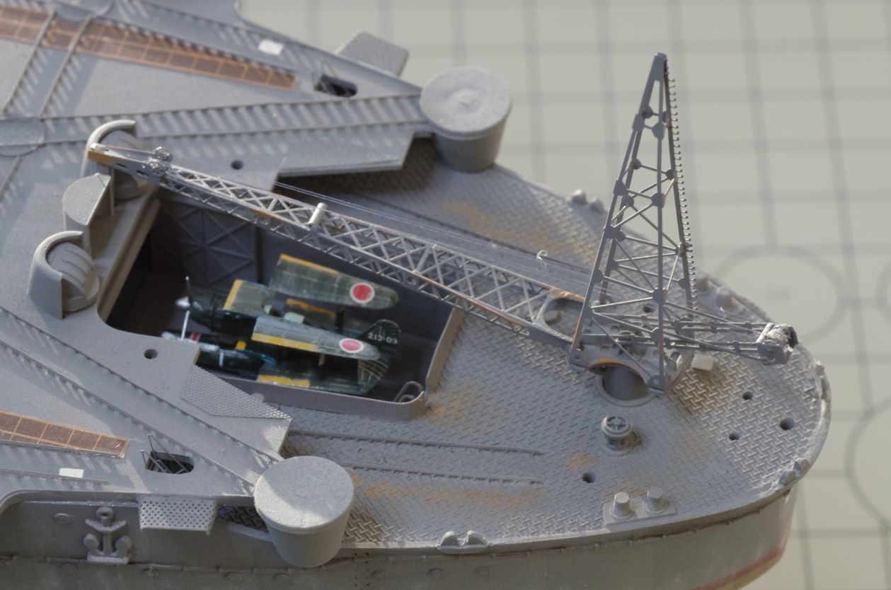

File comment: Fiddly crane in construction.
File comment: Crane ready for the wires and paint. It was twisting in all possible directions.
File comment: Crane finished and glued in place.
File comment: Stern area is pretty crowded with the crane, boats, catapults and AA guns.

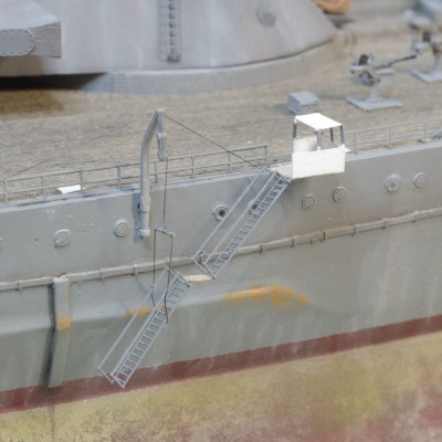

File comment: The gangway was a delicate structure, which I managed to break into pieces a couple of times.
