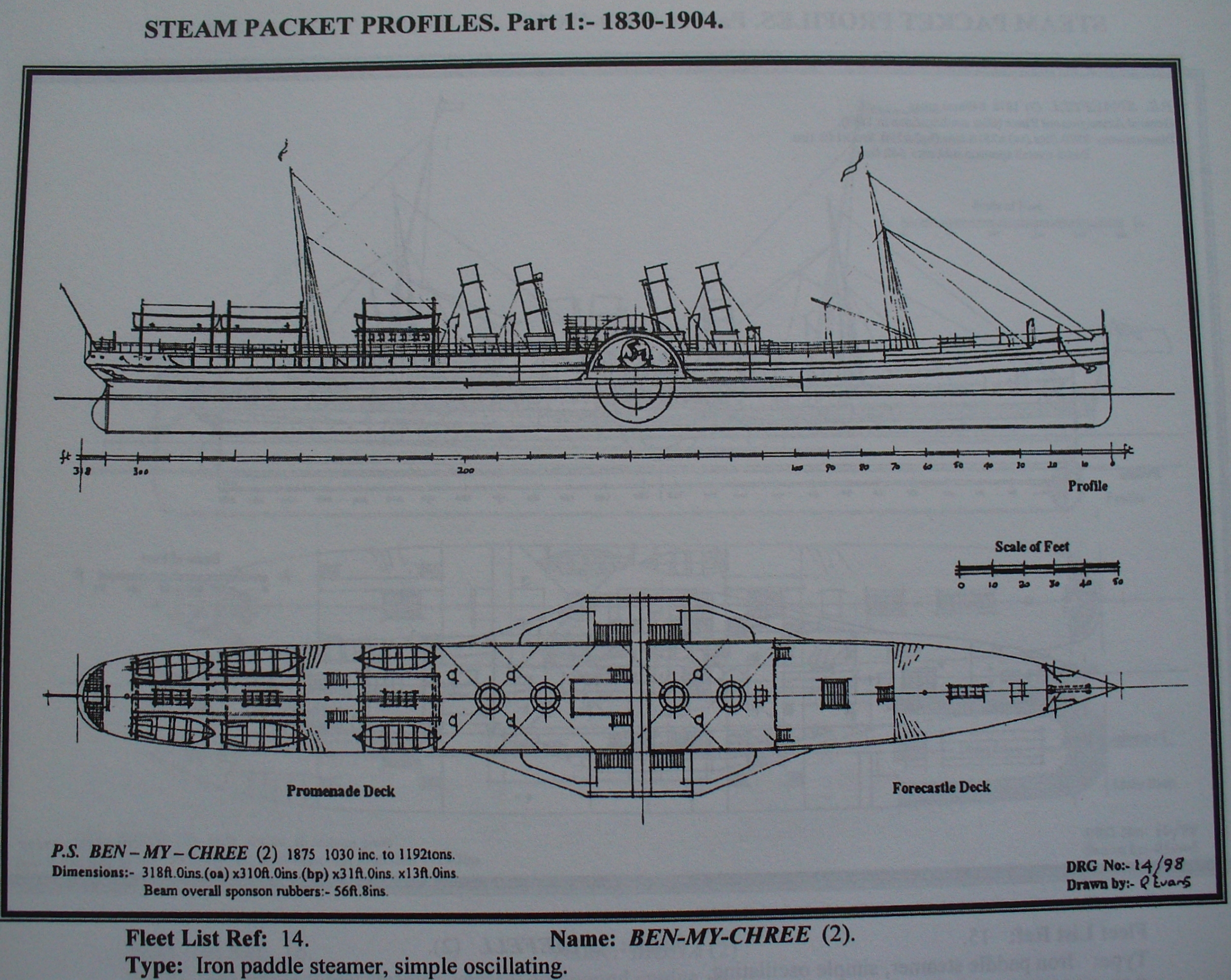

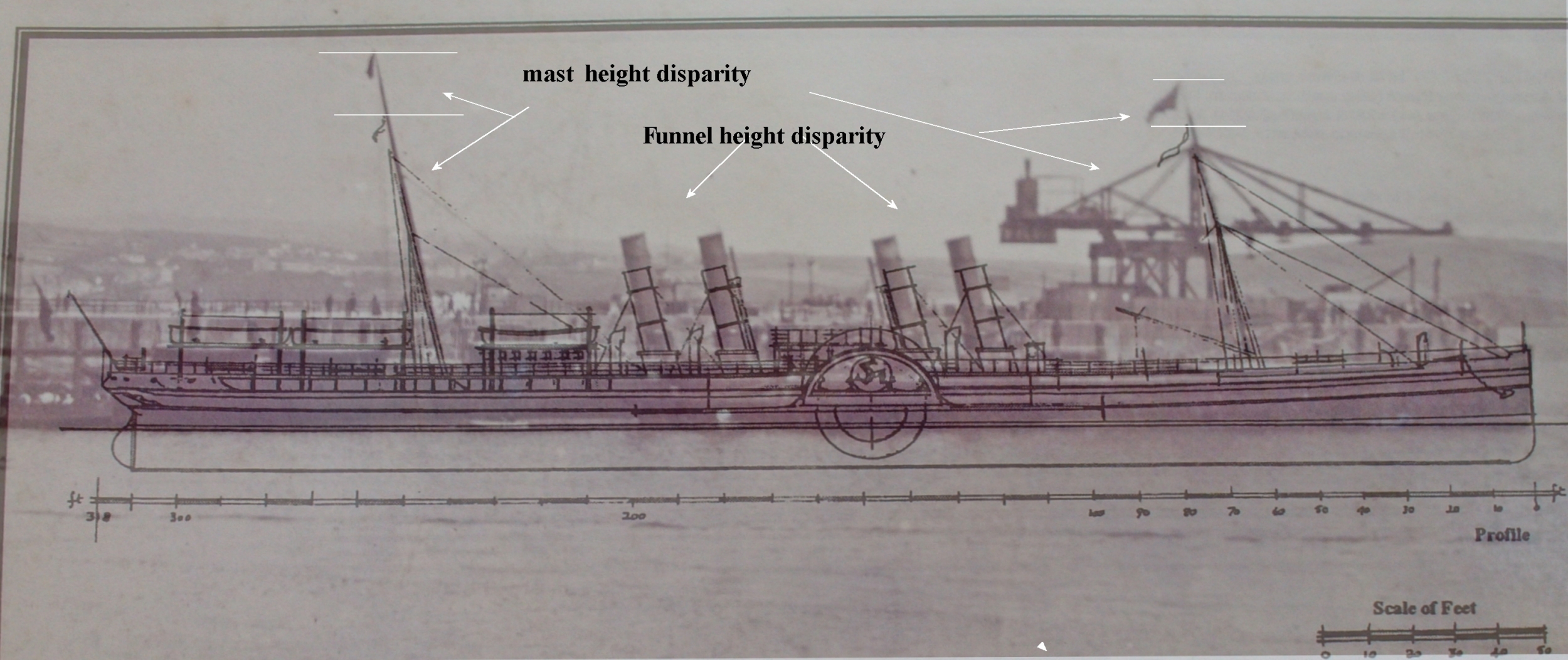

There is a GA drawing from 1998....
as below;

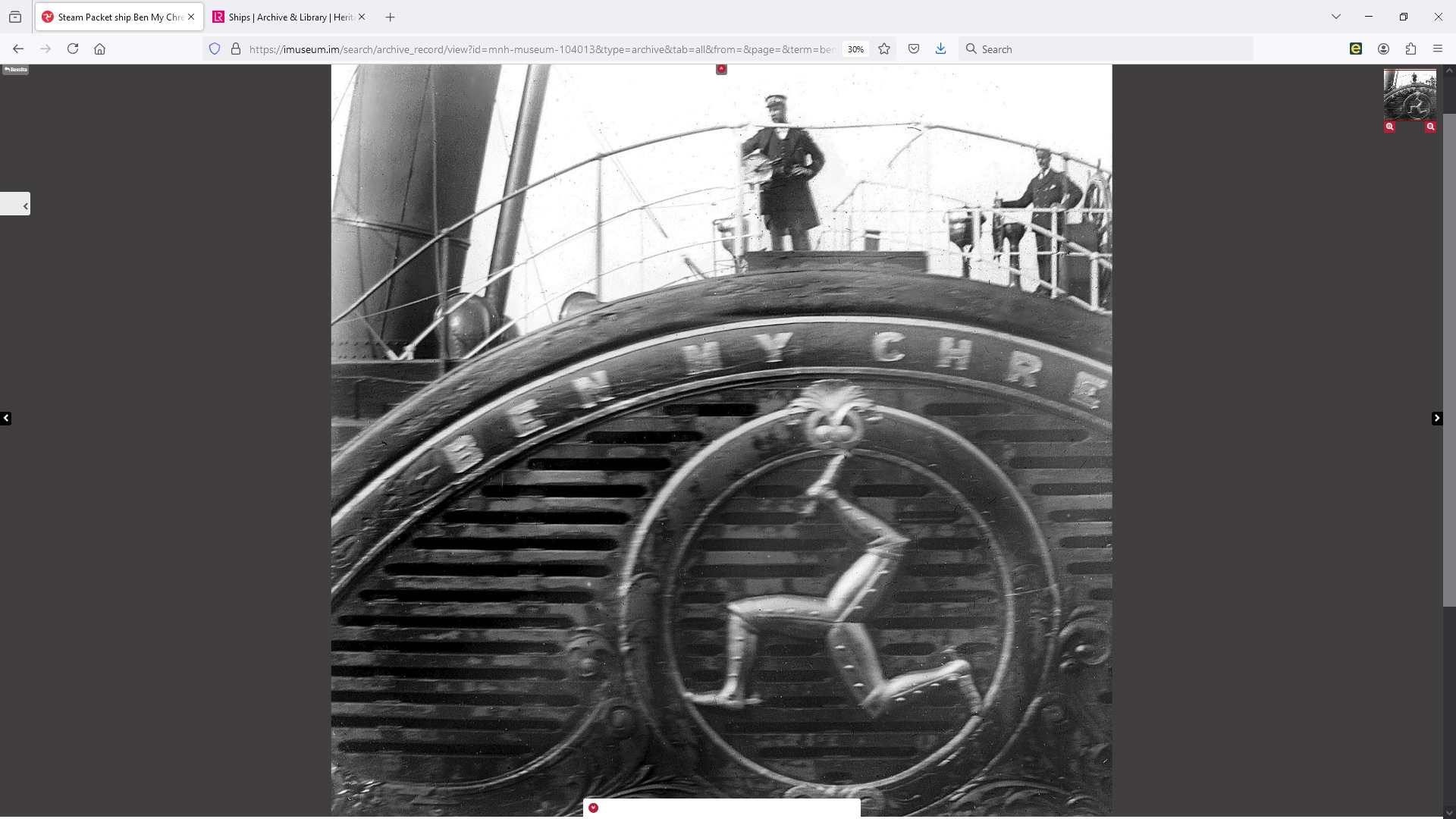

...the paddle box midships could not be clearer ! :wave_1: :thumbs_up_1:

as well as in the above drawing ....

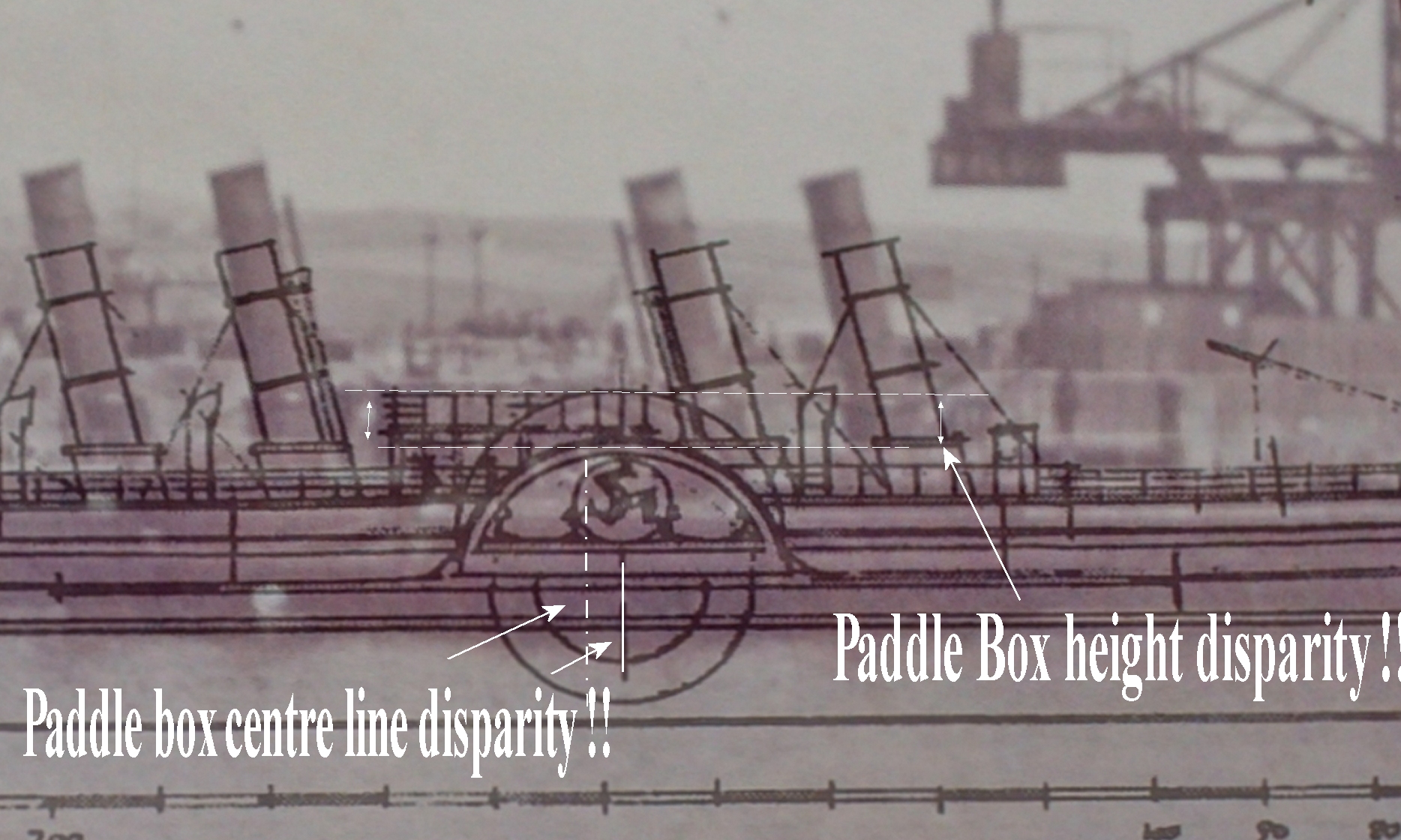

ah... that Drawing ...
all is not as it seems alas... :scratch:
I overlaid a side-on-photo and the plan together--and a number of misleading problems came to the fore;
as below...
Ha!
....it seems like I have my work cut out for the foreseeable future....

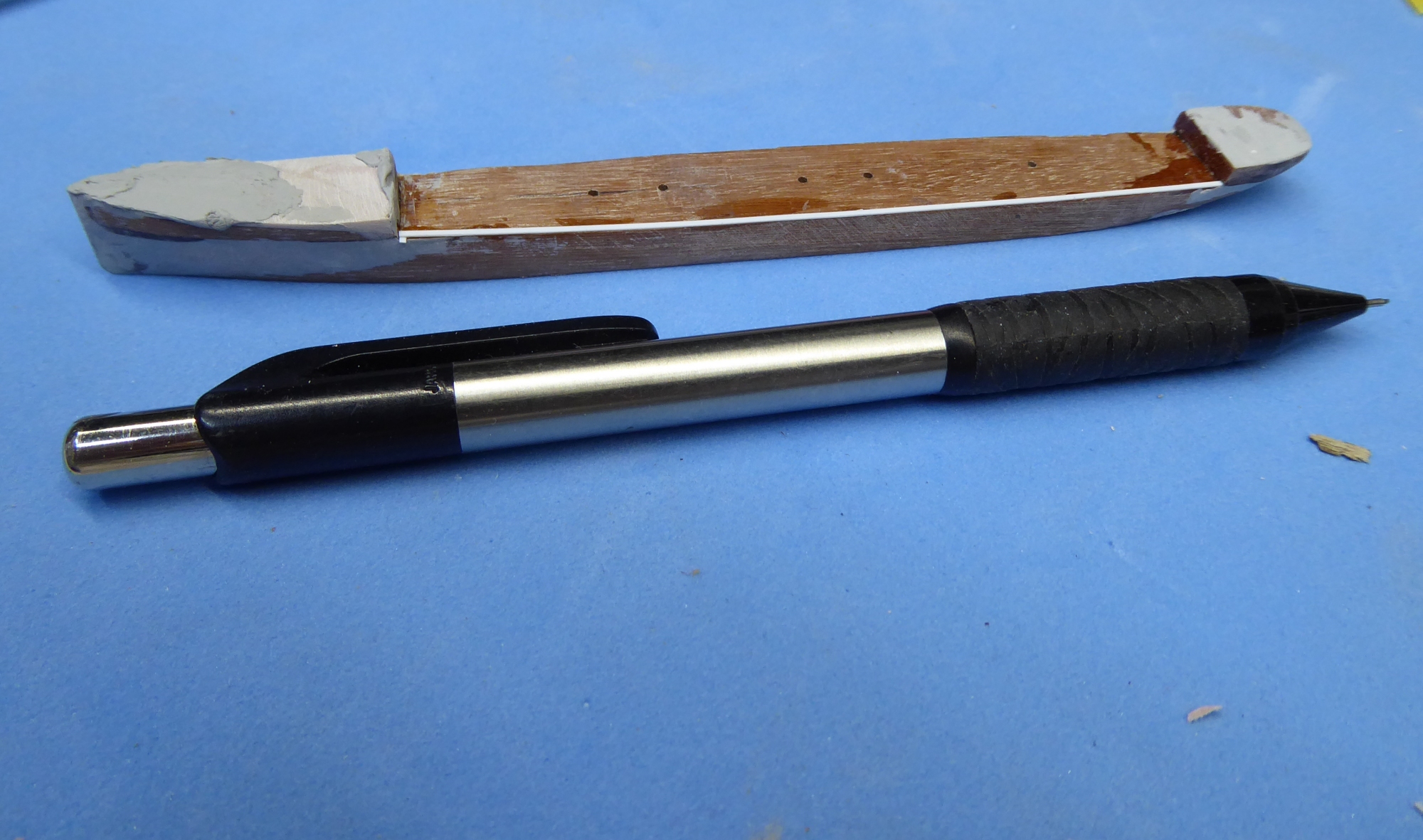

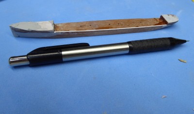

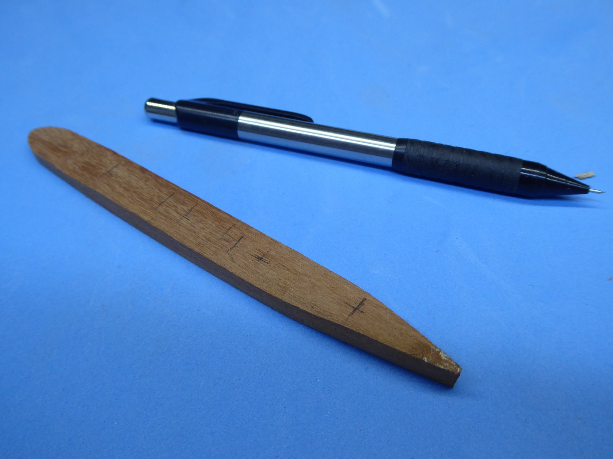

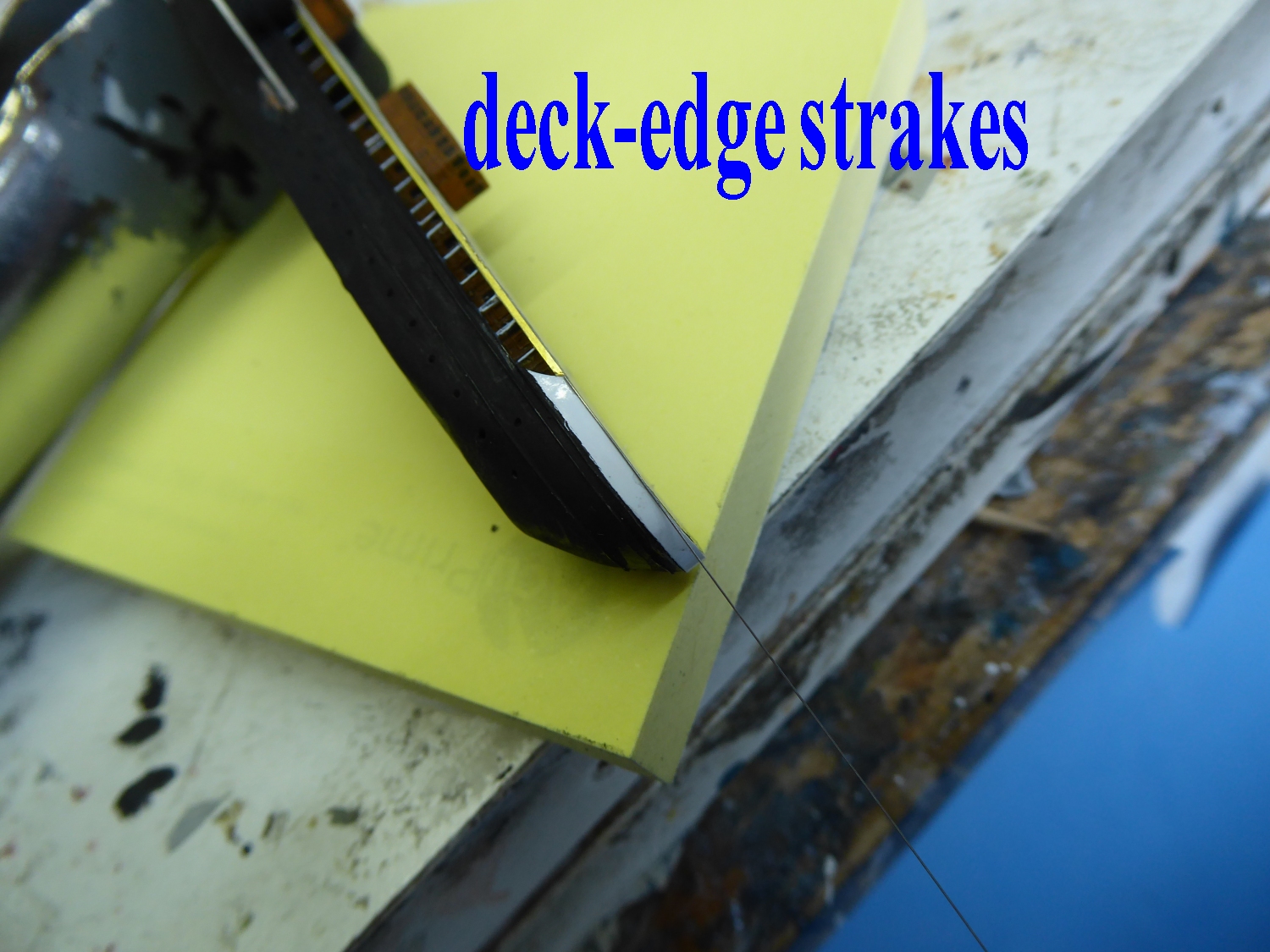

I cut the hull and did rough shaping on my trusty bench belt-sander;
which very effectively removed the material from the very hard Jarrah wood
( very stable and very close grained )
( salvaged from the floor of a Victorian army barracks !) ergo the wood is 140 or so years old

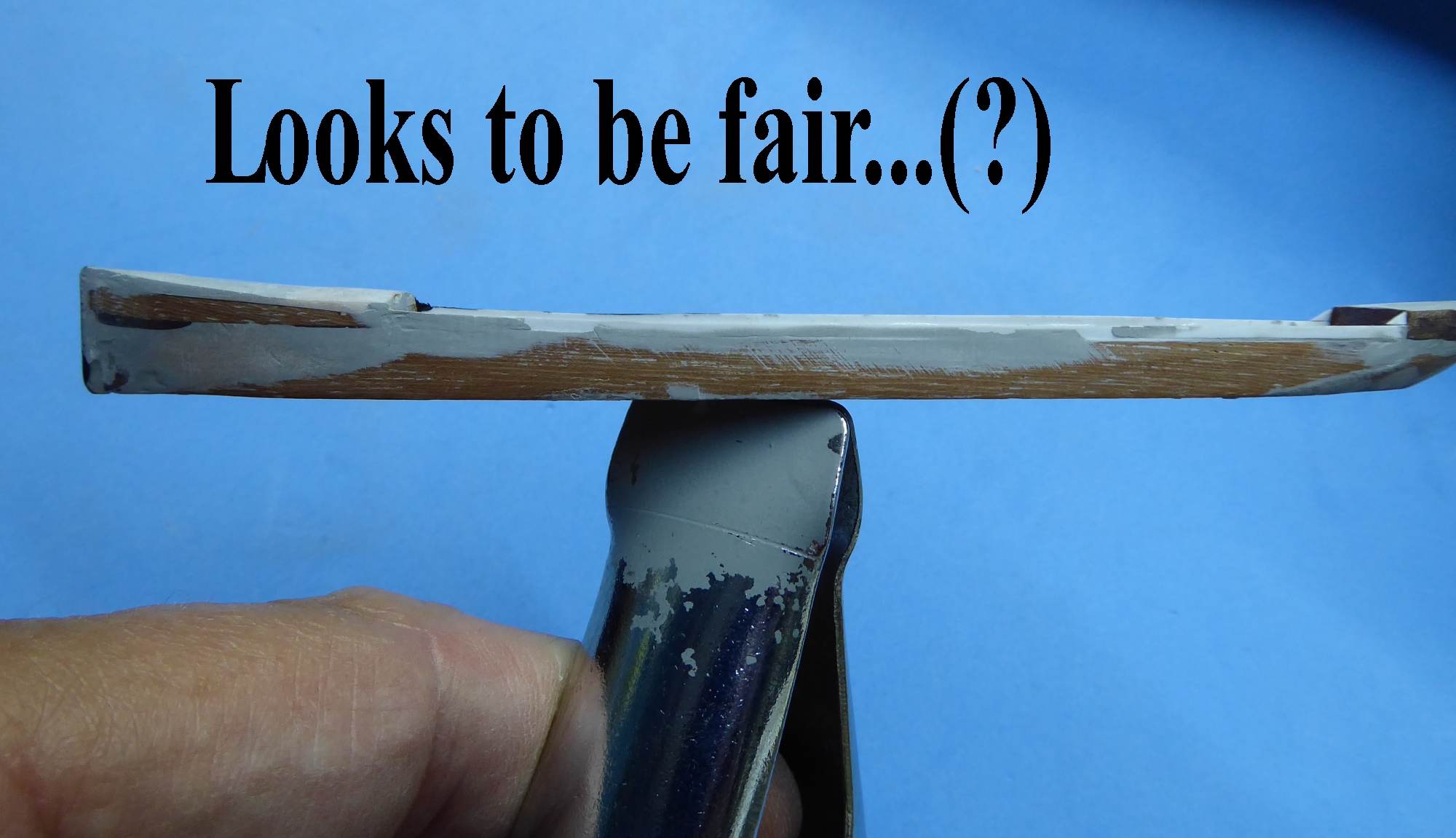

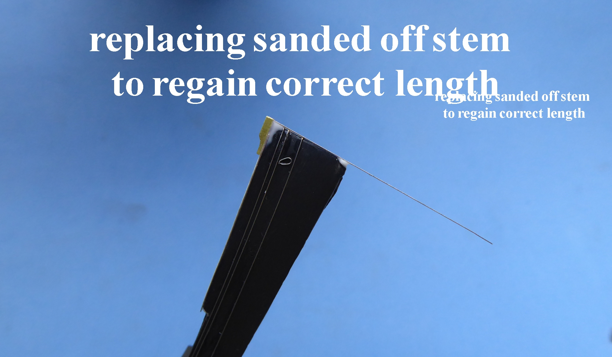

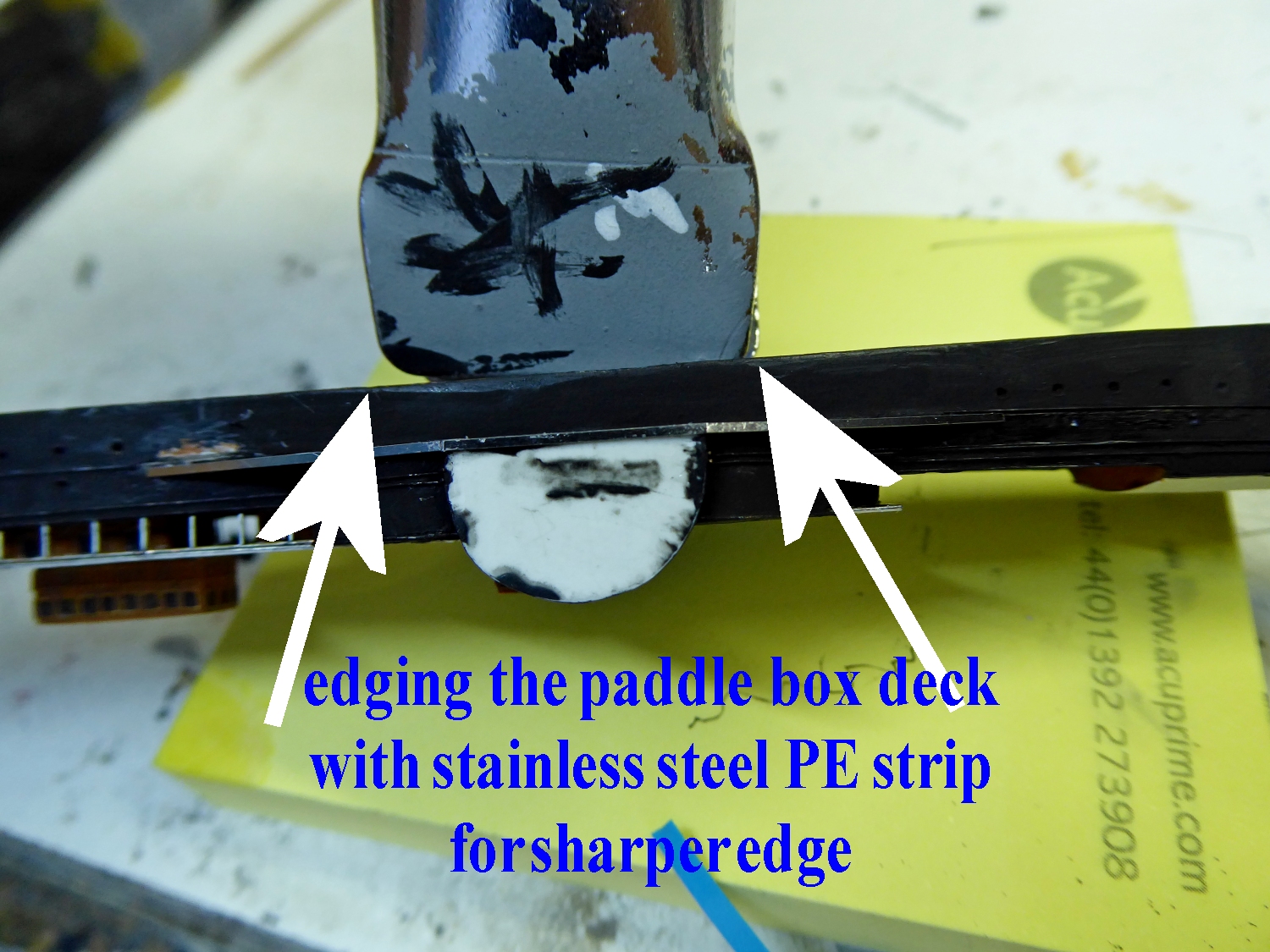

So as to allow the stem-head ( bow) to create an razors sharp stem ,
--I inserted a piece of stainless steel into a grove cut into the wood at the bow
( thereby it is cantilevered against sanding loads!)
then the filling and fairing began....

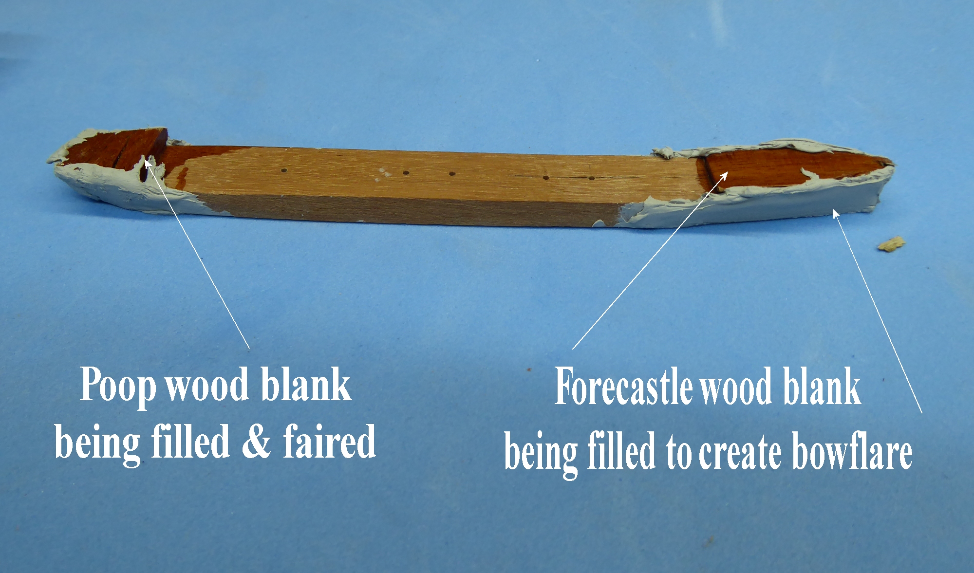

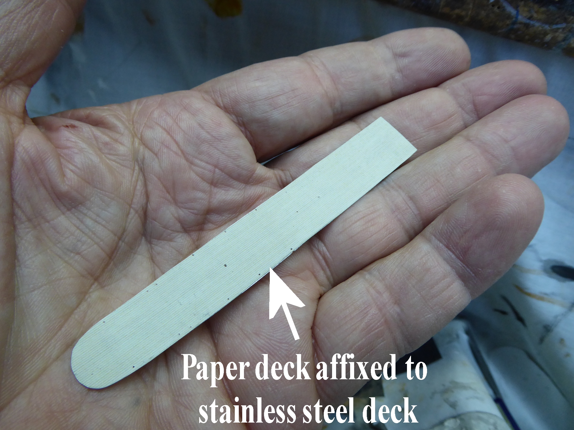

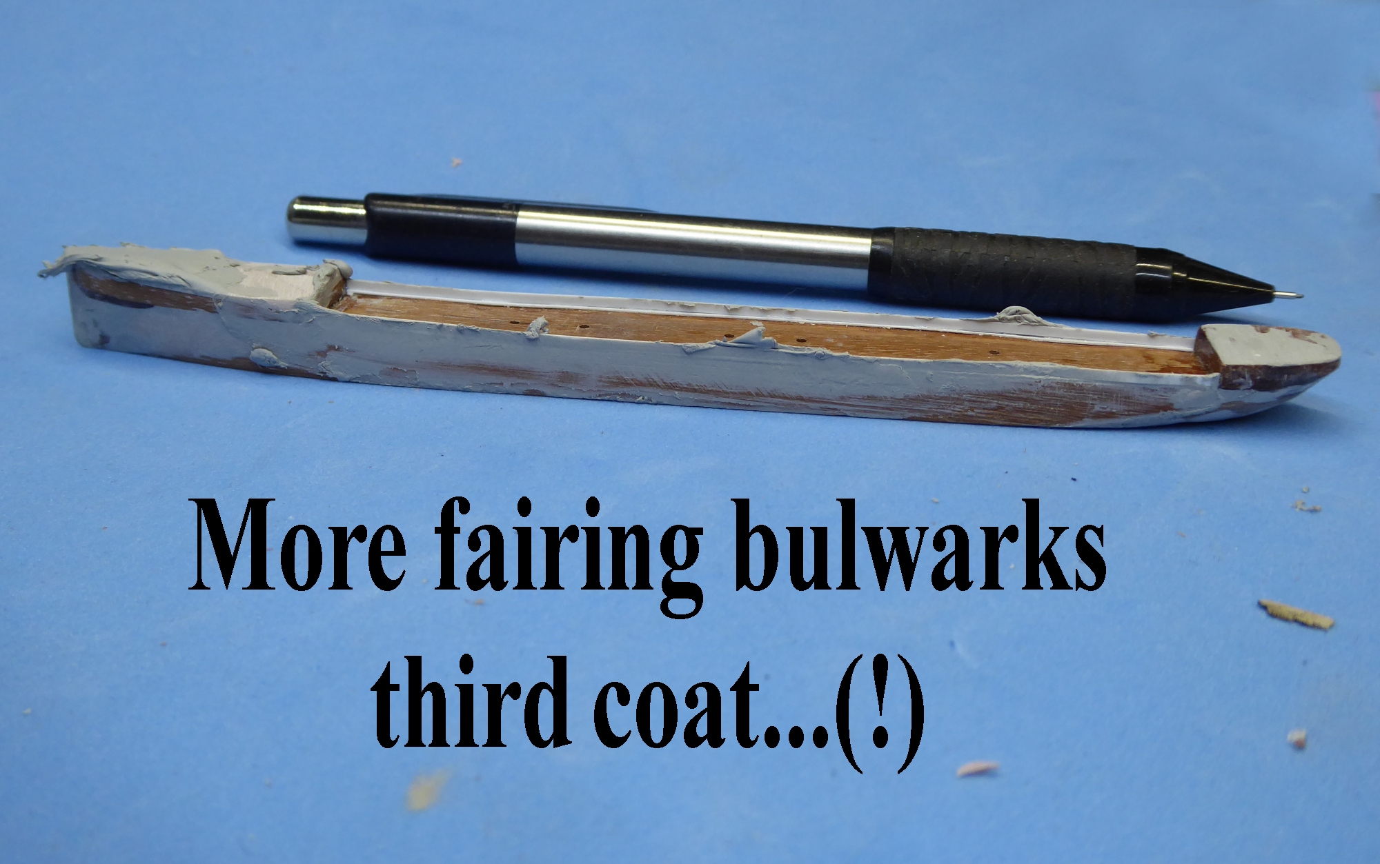

first I added F'oclse and poop decks to deck plan and filled the undercuts with
high grade automotive filler
the bulwarks were added using styrene strip material ( bends in 3-D !)

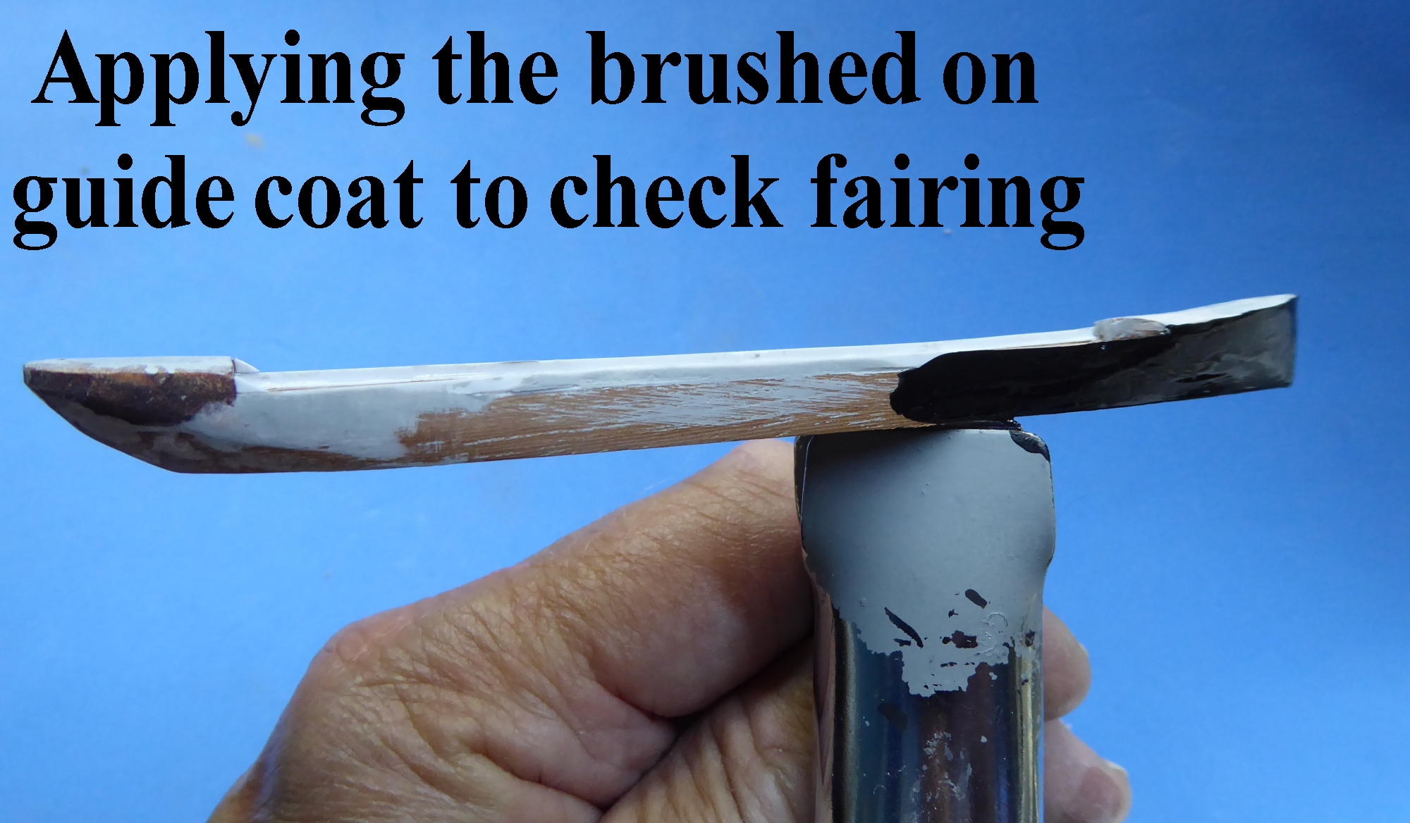

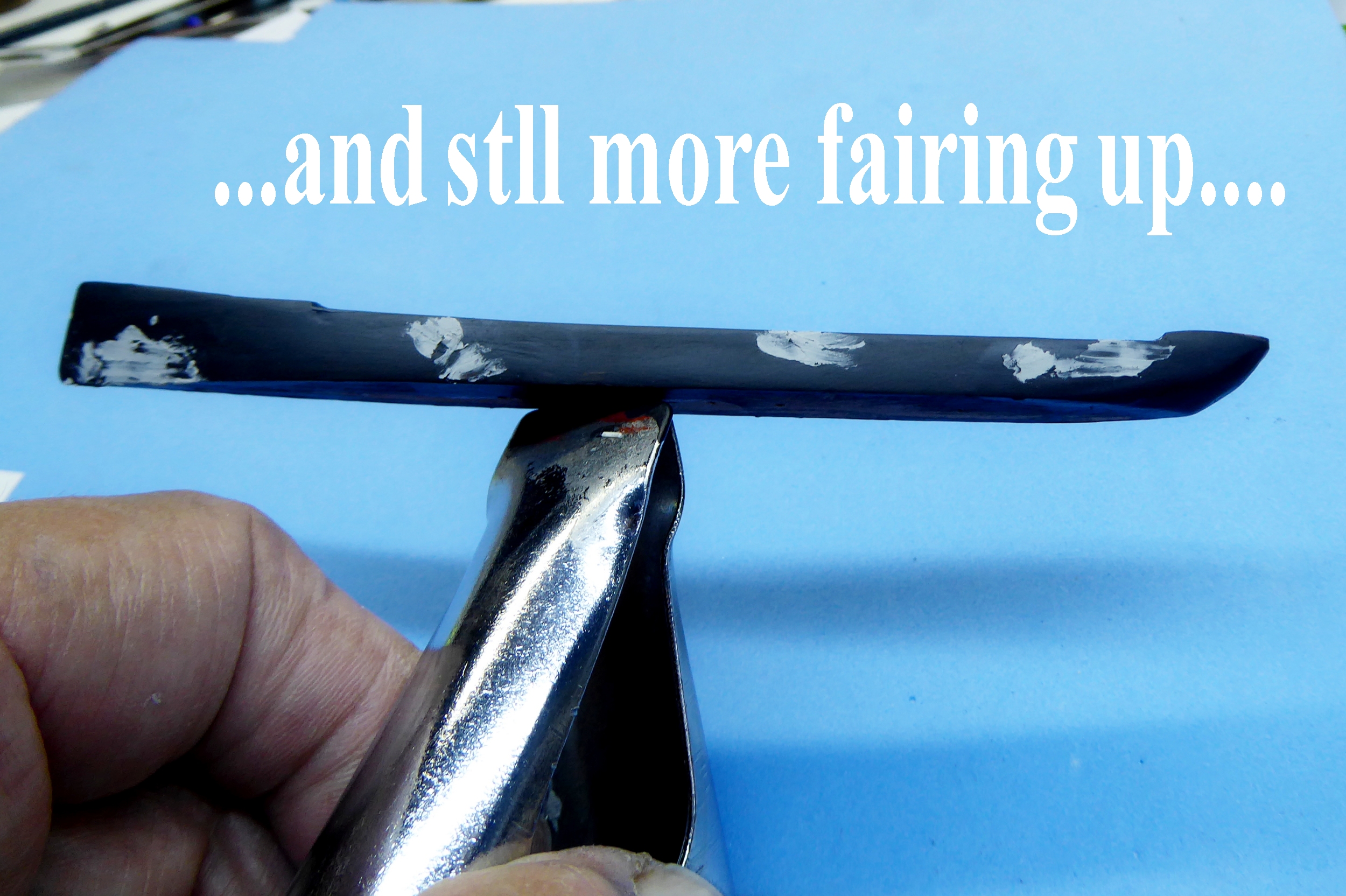

and thereafter I painted it in thick enamel --so as to act as a guide coat and fine 'filler '
when the paint has hardened it will show up any areas that need further attention.
very very mild imperfections will mostly disappear when the paint is sanded

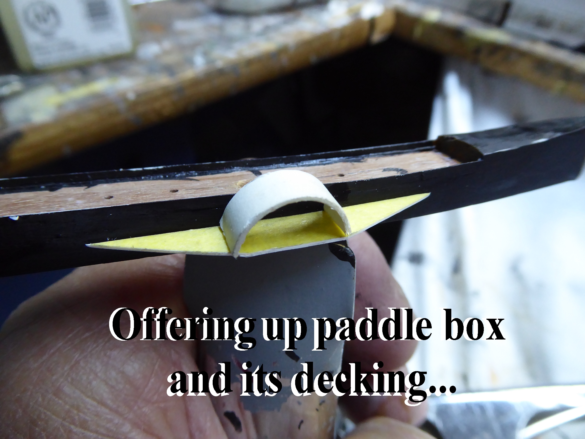

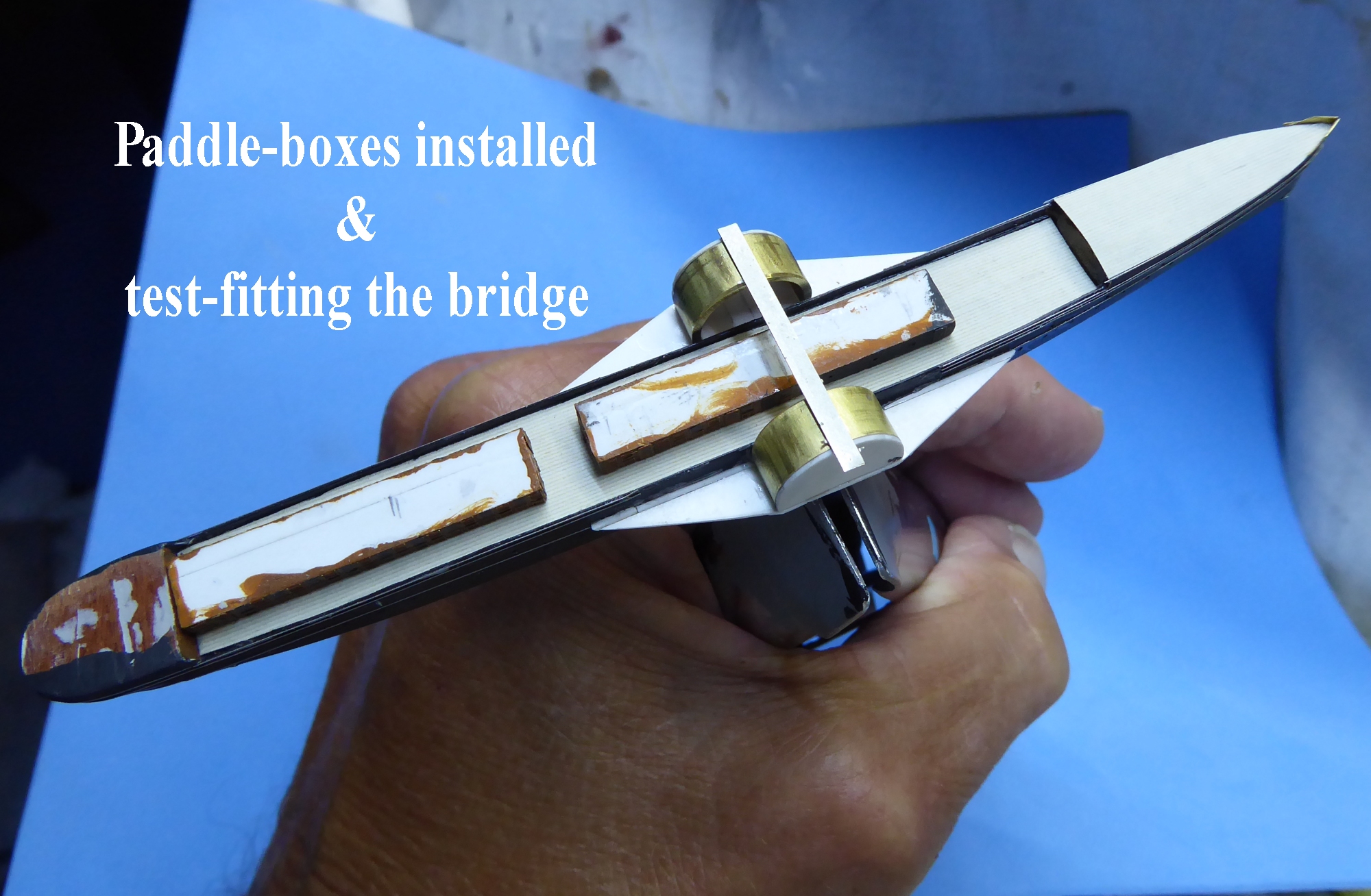

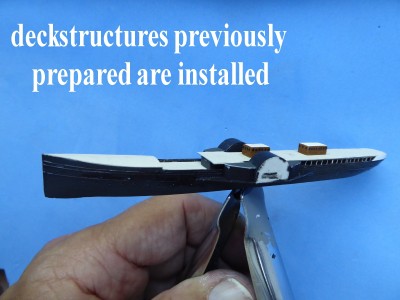

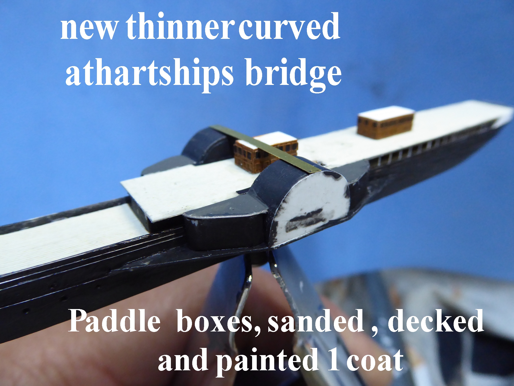

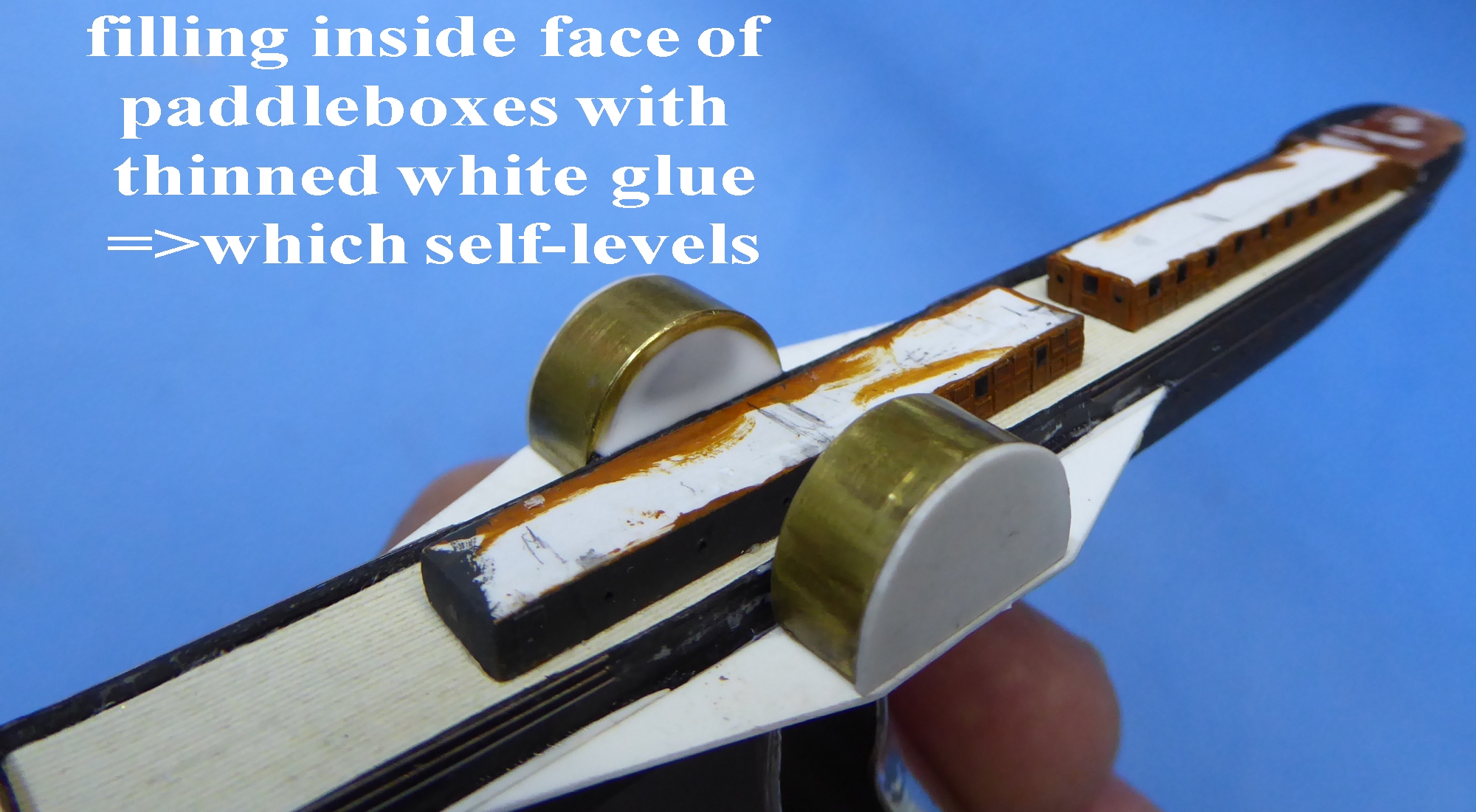

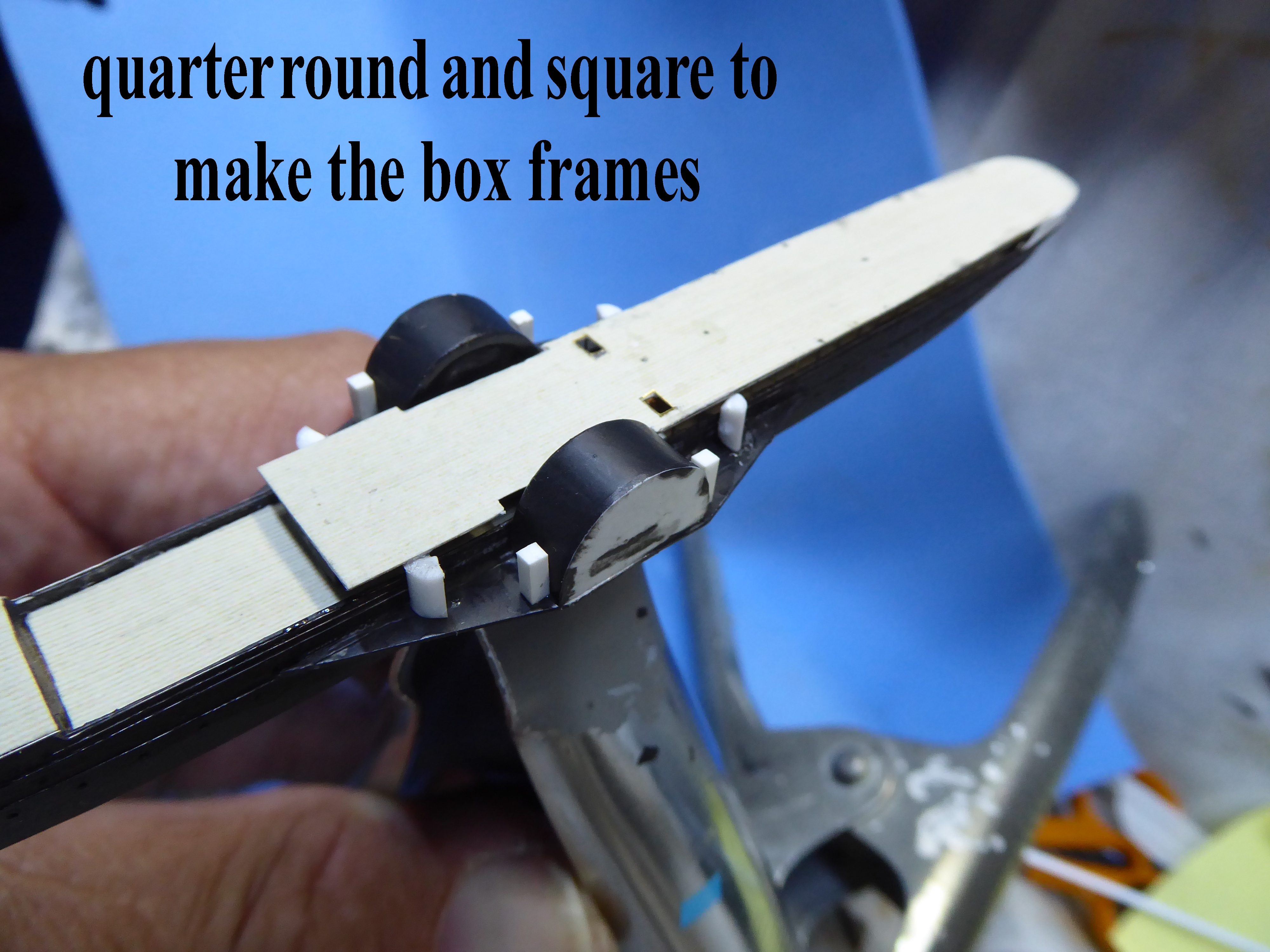

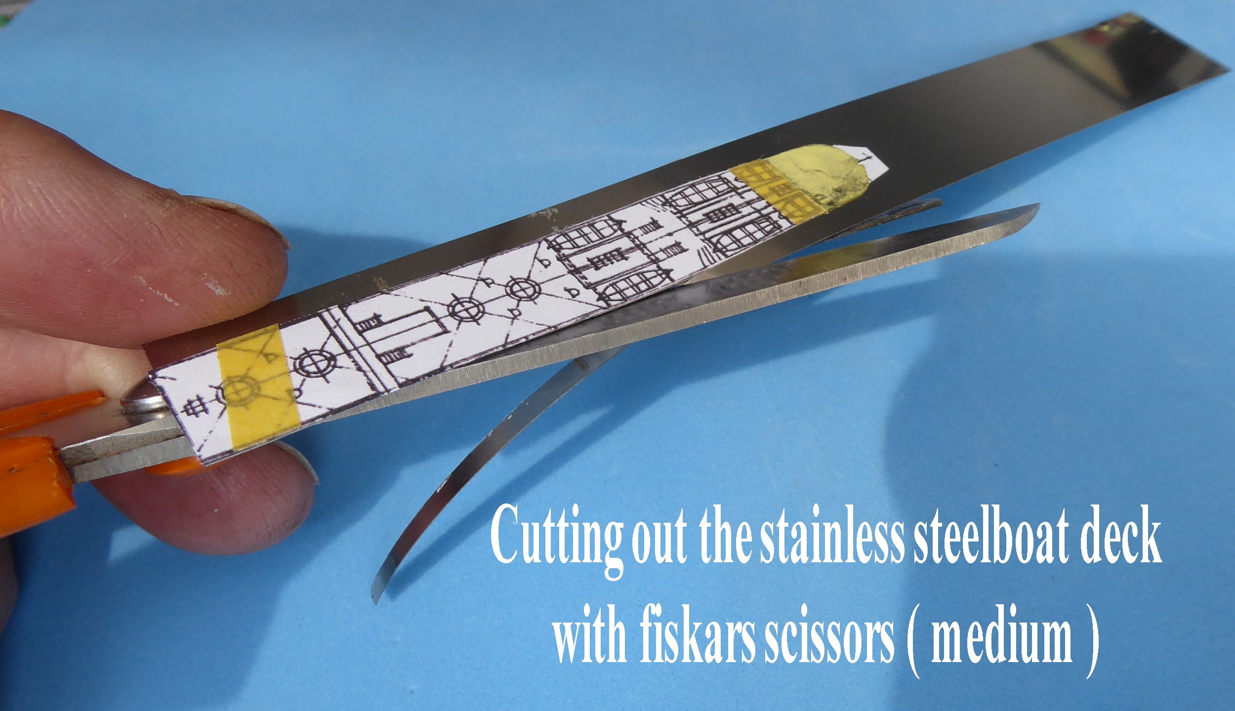

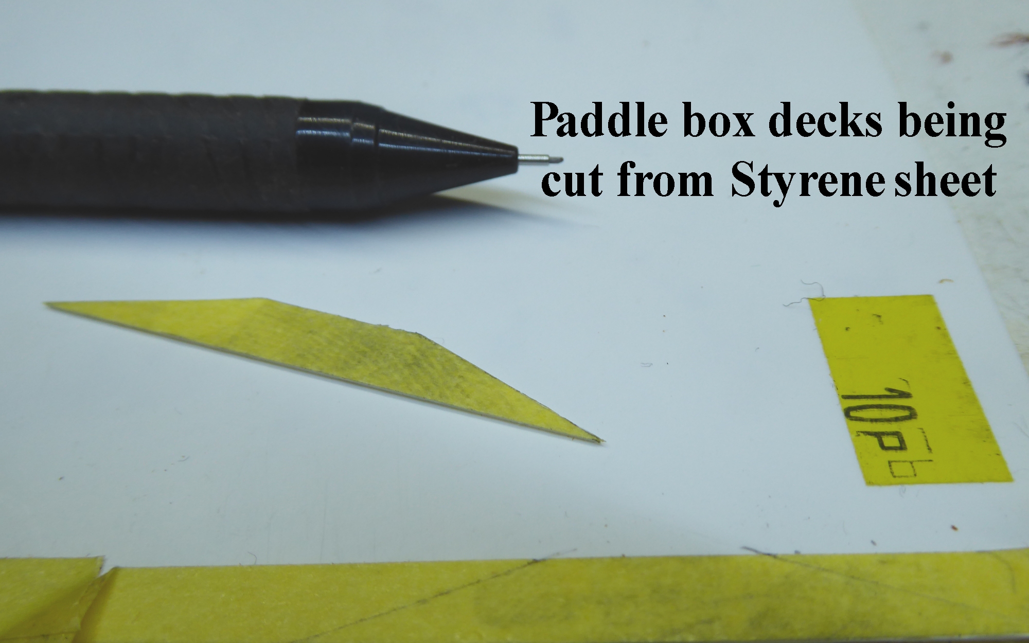

meanwhile I cut the paddlebox decks

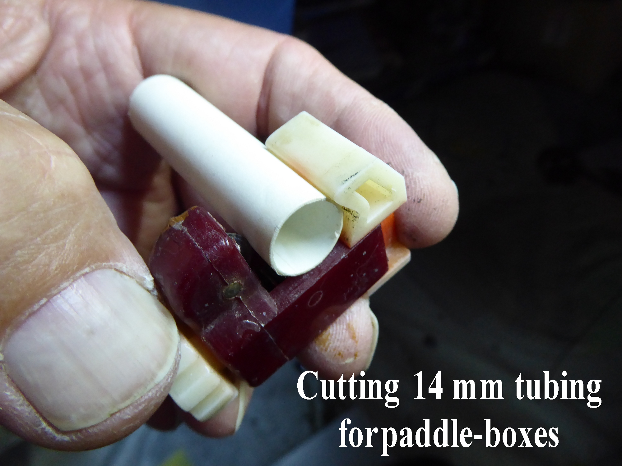

and some 14mm tubing ( in my ancient K & S metals tube cutter )

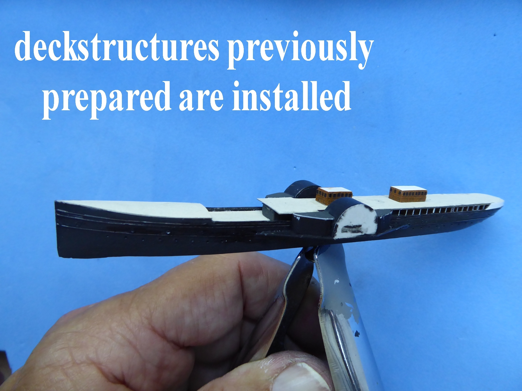

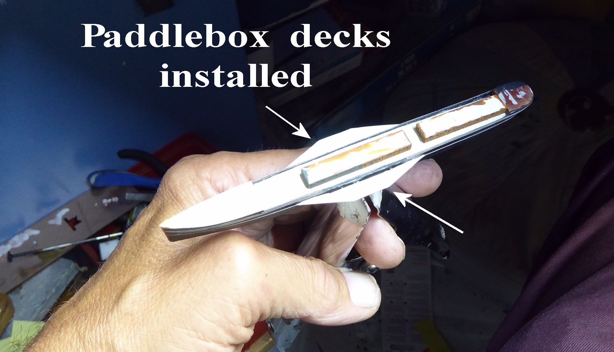

and then offered and balanced the decks and paddle box ( using no adhesive other than will-power :big_grin: !)
to the hull to gauge the proportions
all seems well!

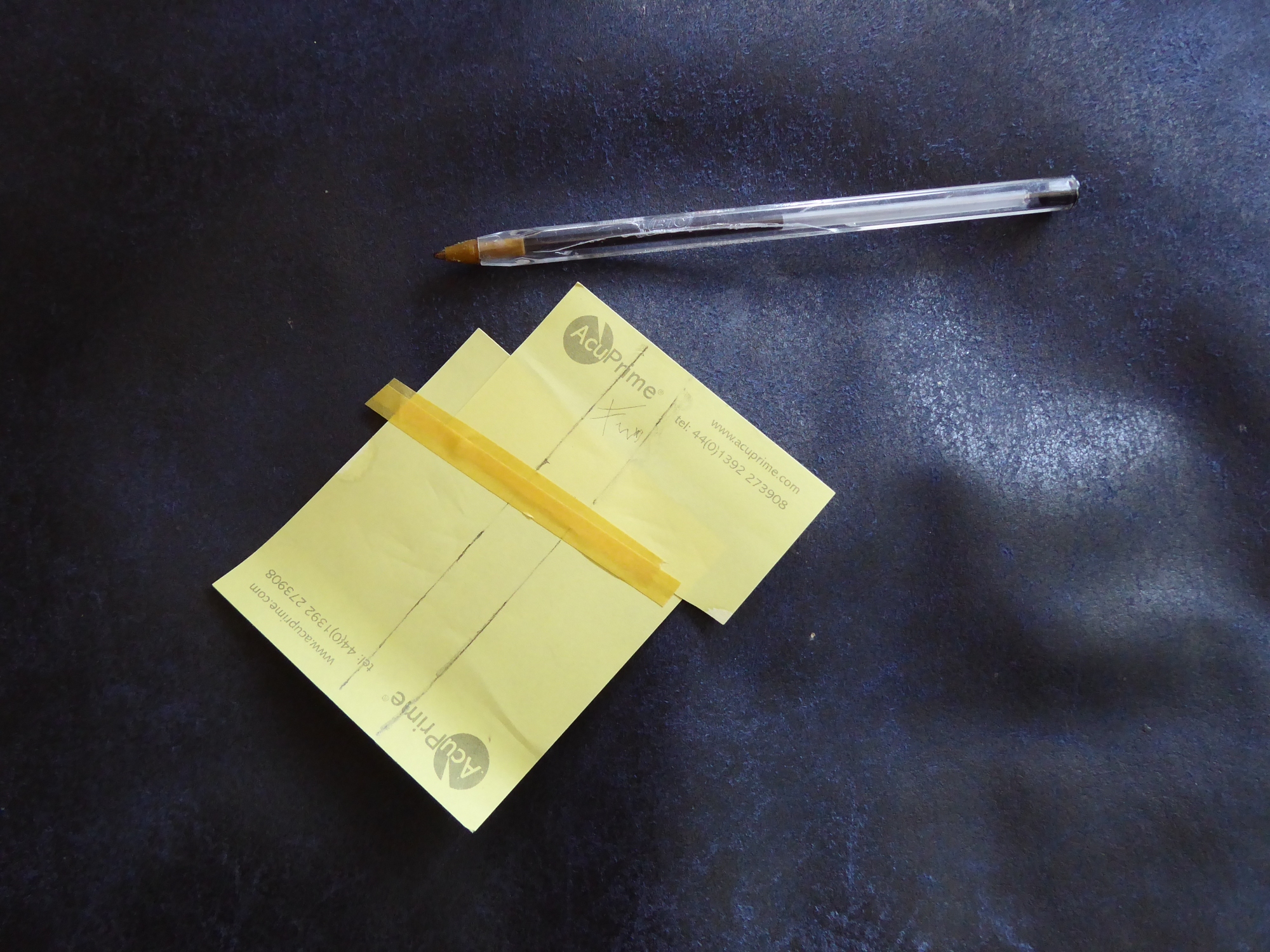

Making the main deck template to enable me to cut accurately my printed paper decking

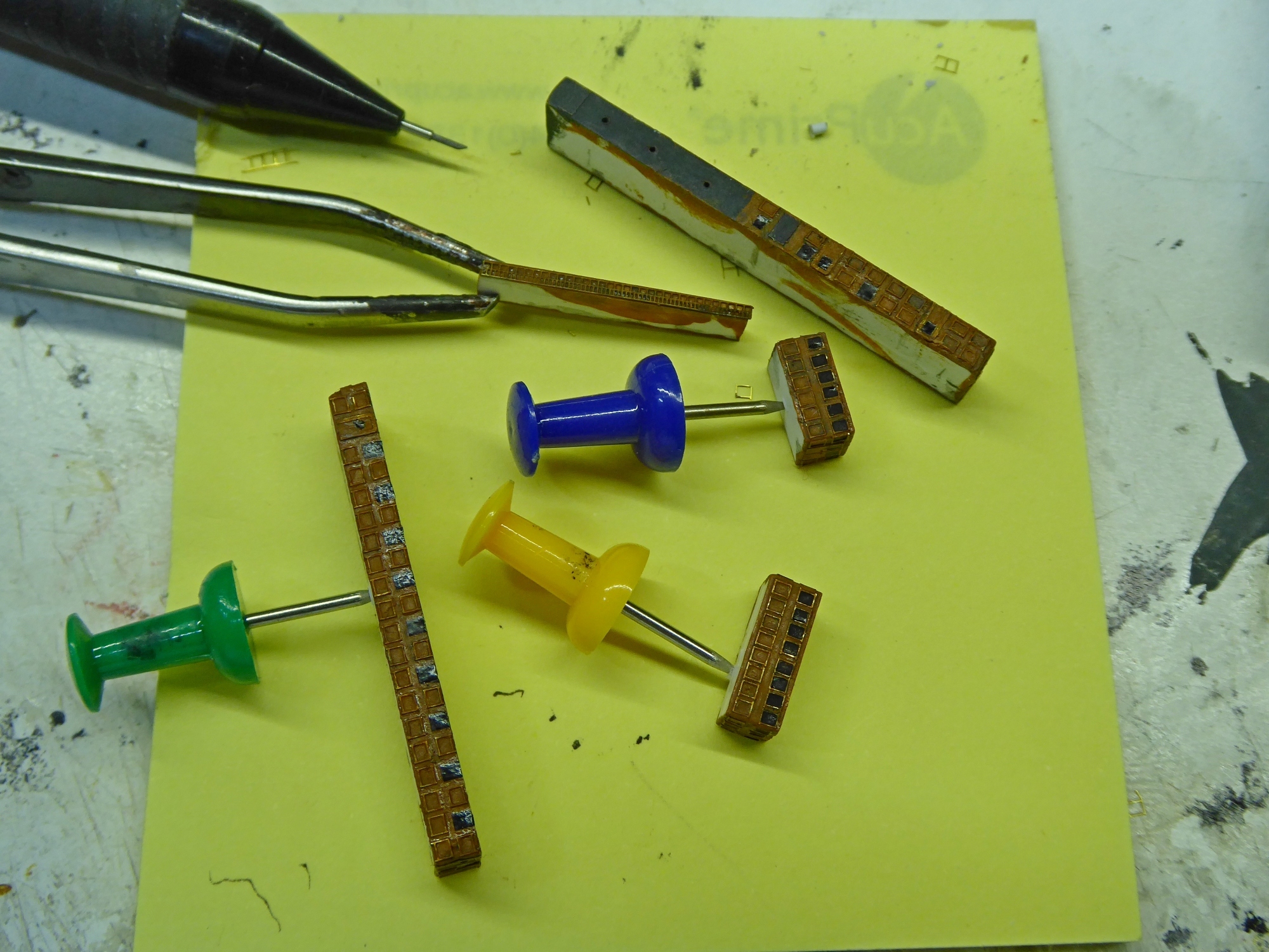

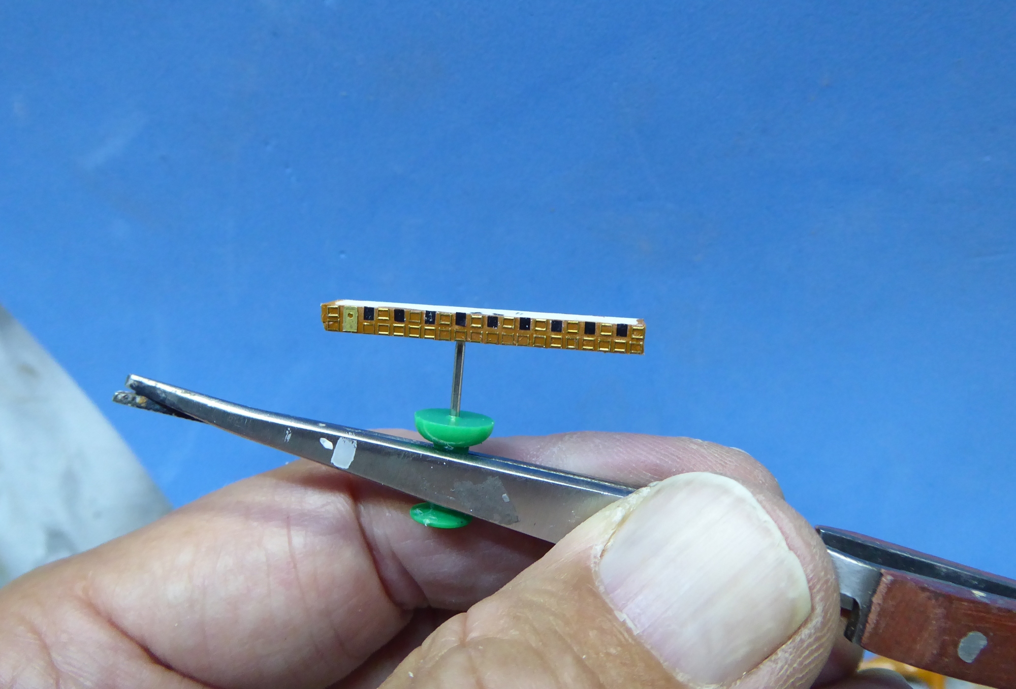

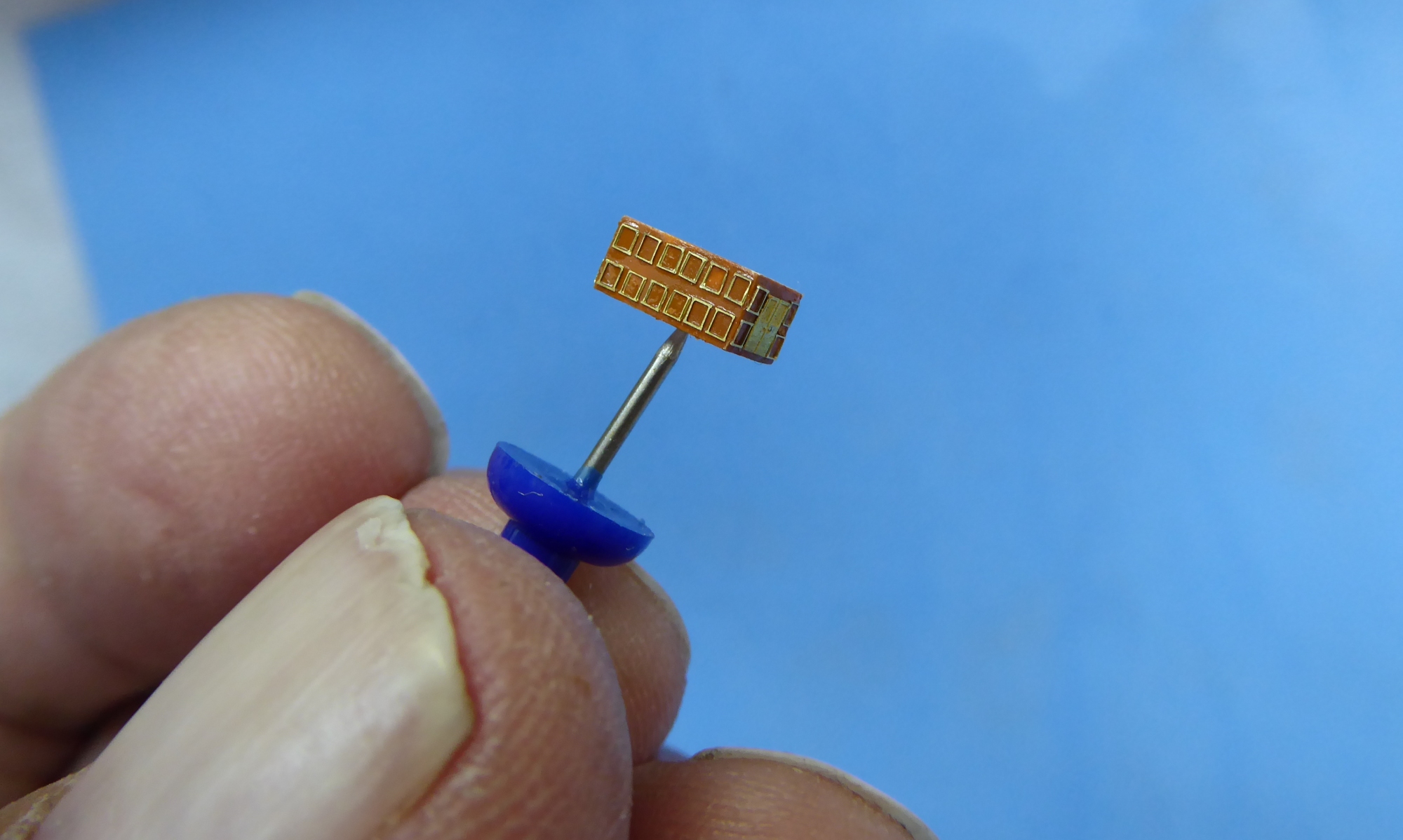

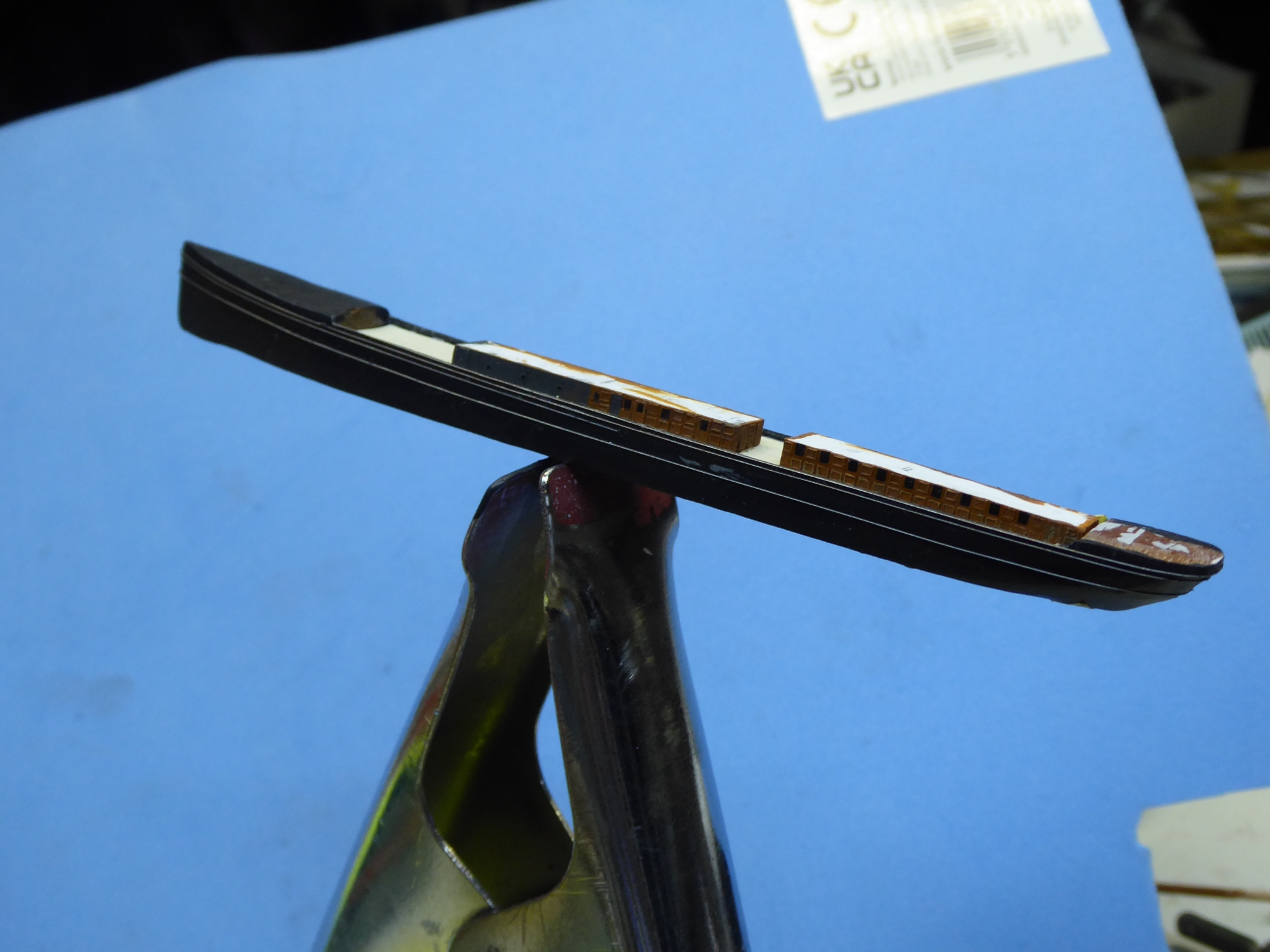

The superstructure blocks of this ship were almost entirely wood panelled-
-aside from the " dirty " engineering block
containing engineers doors for boiler room access
I tried to emulate this wood panelling.
One " could " of course have created relief etched PE --or indeed 3-D printed this entire structure
especially if producing a kit --- or more than one mode of this ship l....

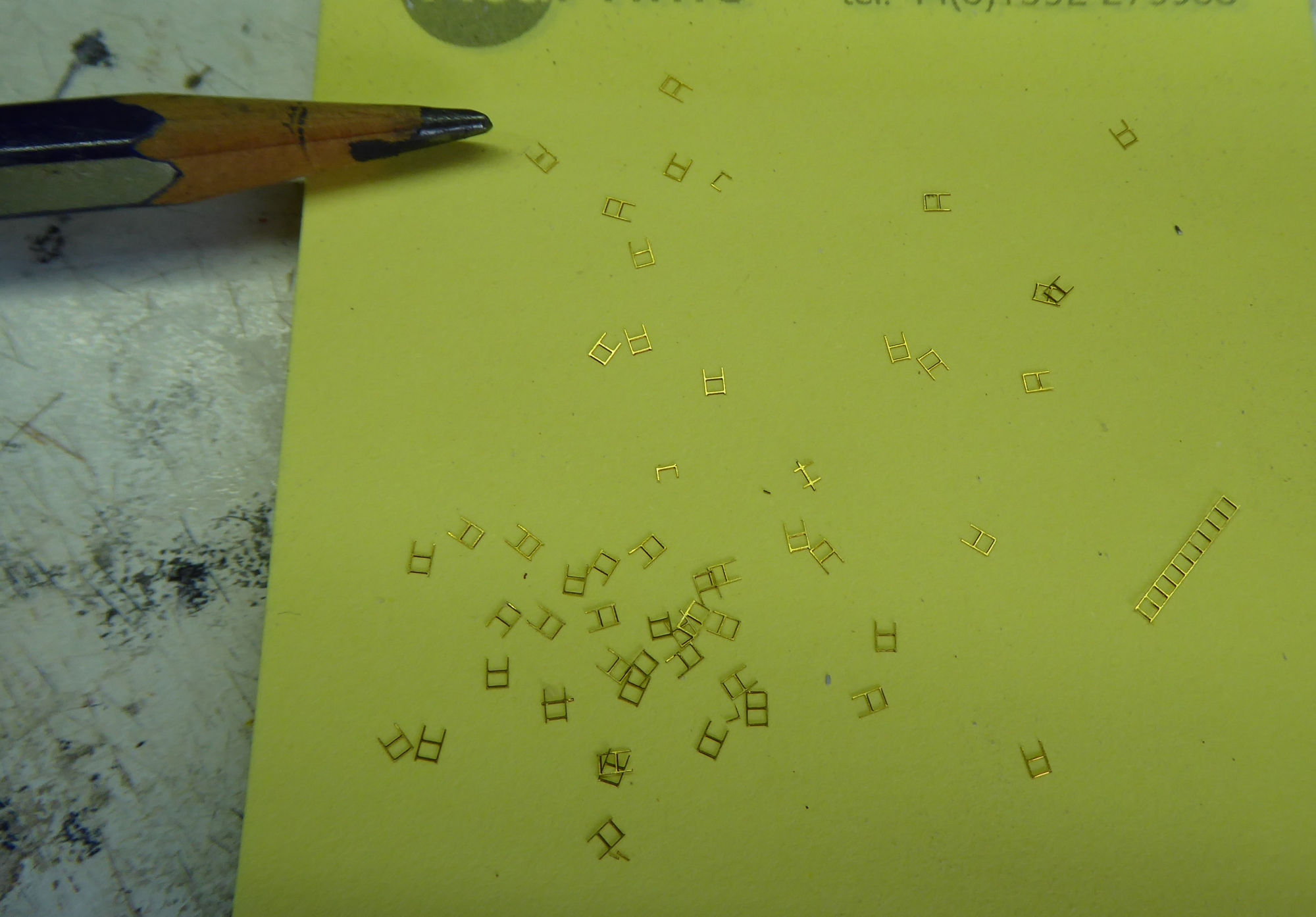

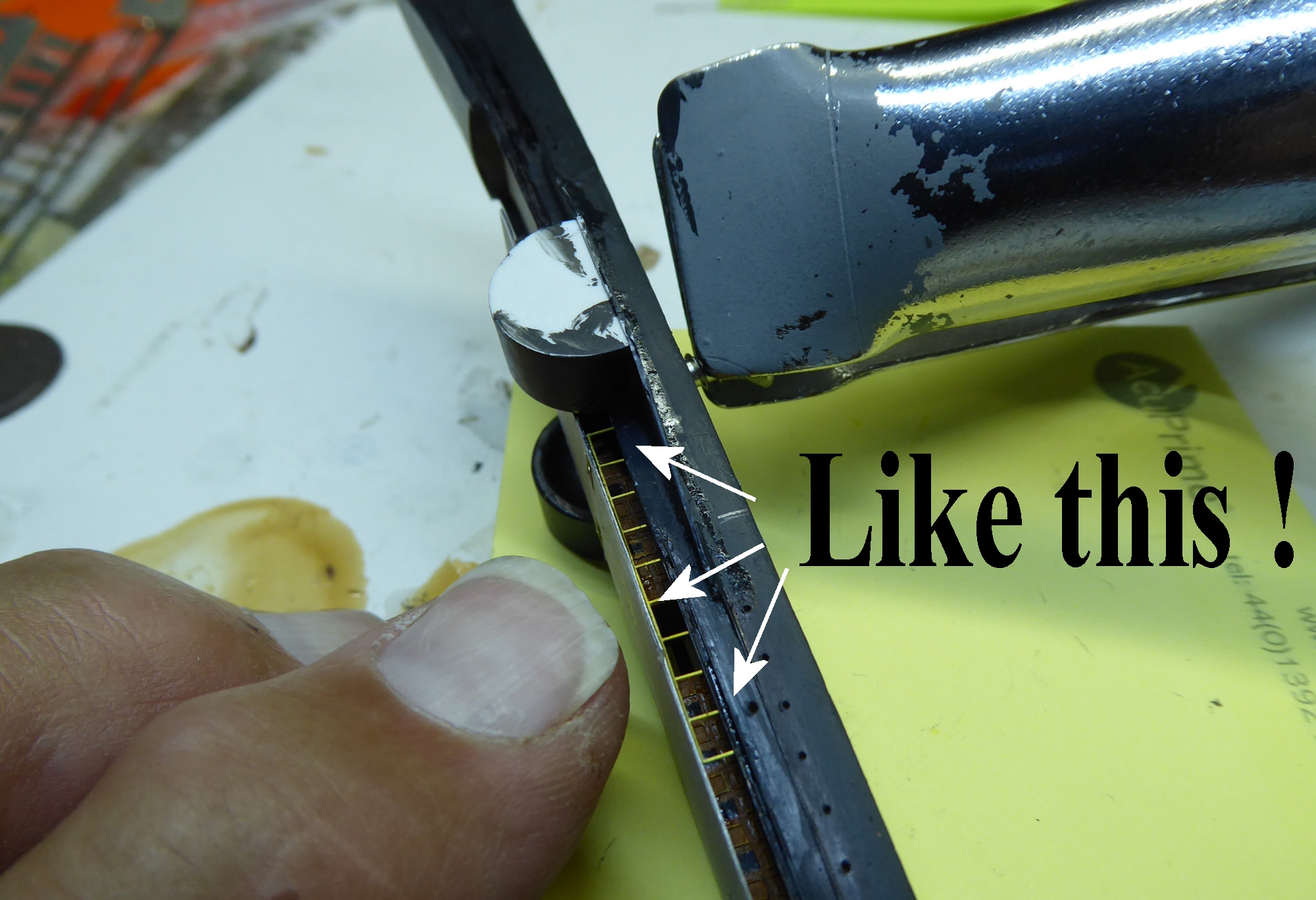

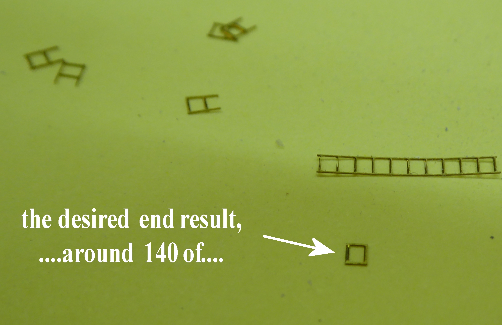

I started by cutting suitable ladder-stock into short lengths to make squares--
- a tedious procedure to get good edges and square corners

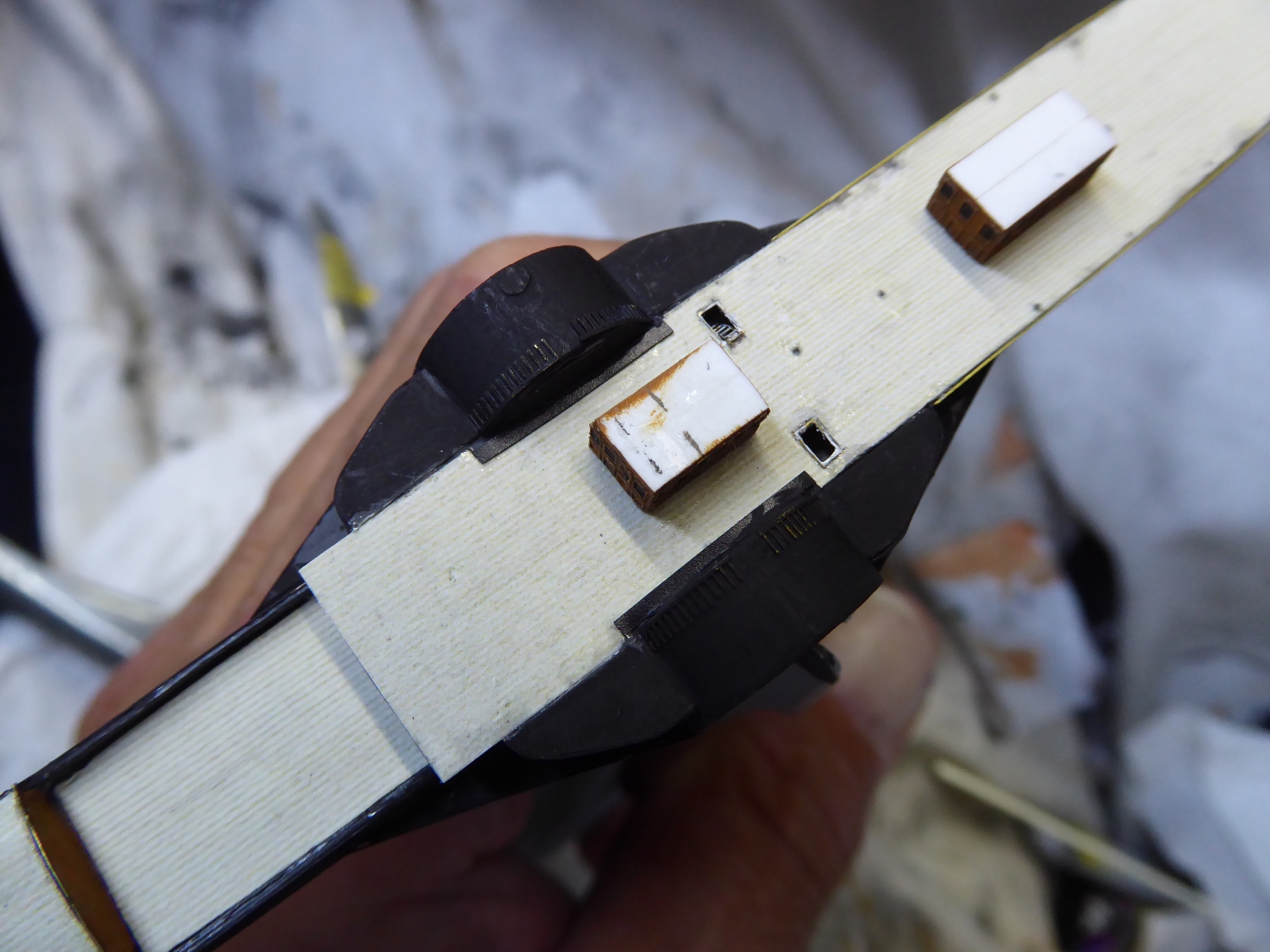

These were attached onto the previously cut and shaped superstructure blocks and deck houses
to give the impression of panelling
here are some in progress
it was really quite difficult !!!
==> floating them onto thinned wet matt varnish,
and trying to keep keeping them all level and all evenly spaced
..........and there was rather a lot of it !

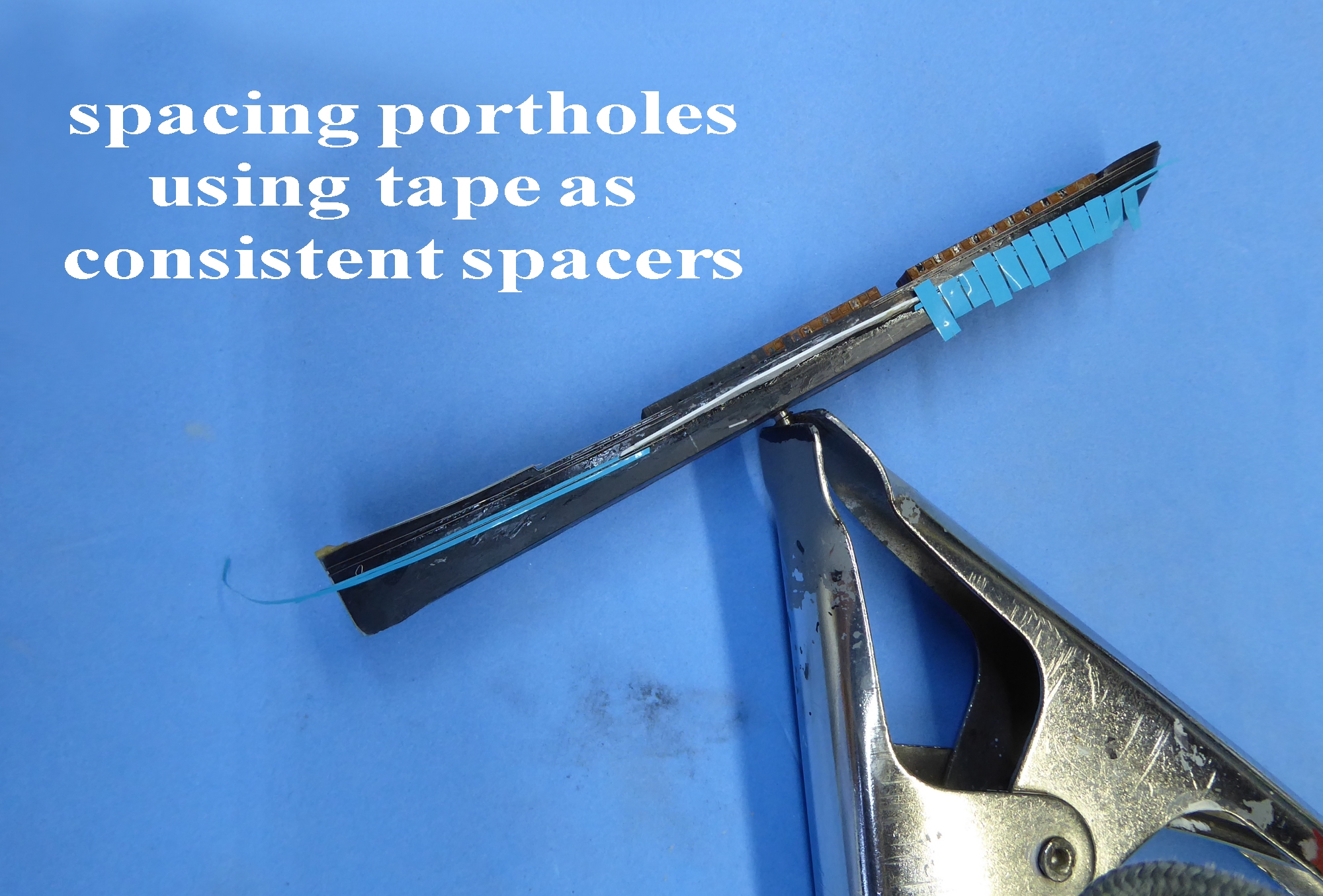

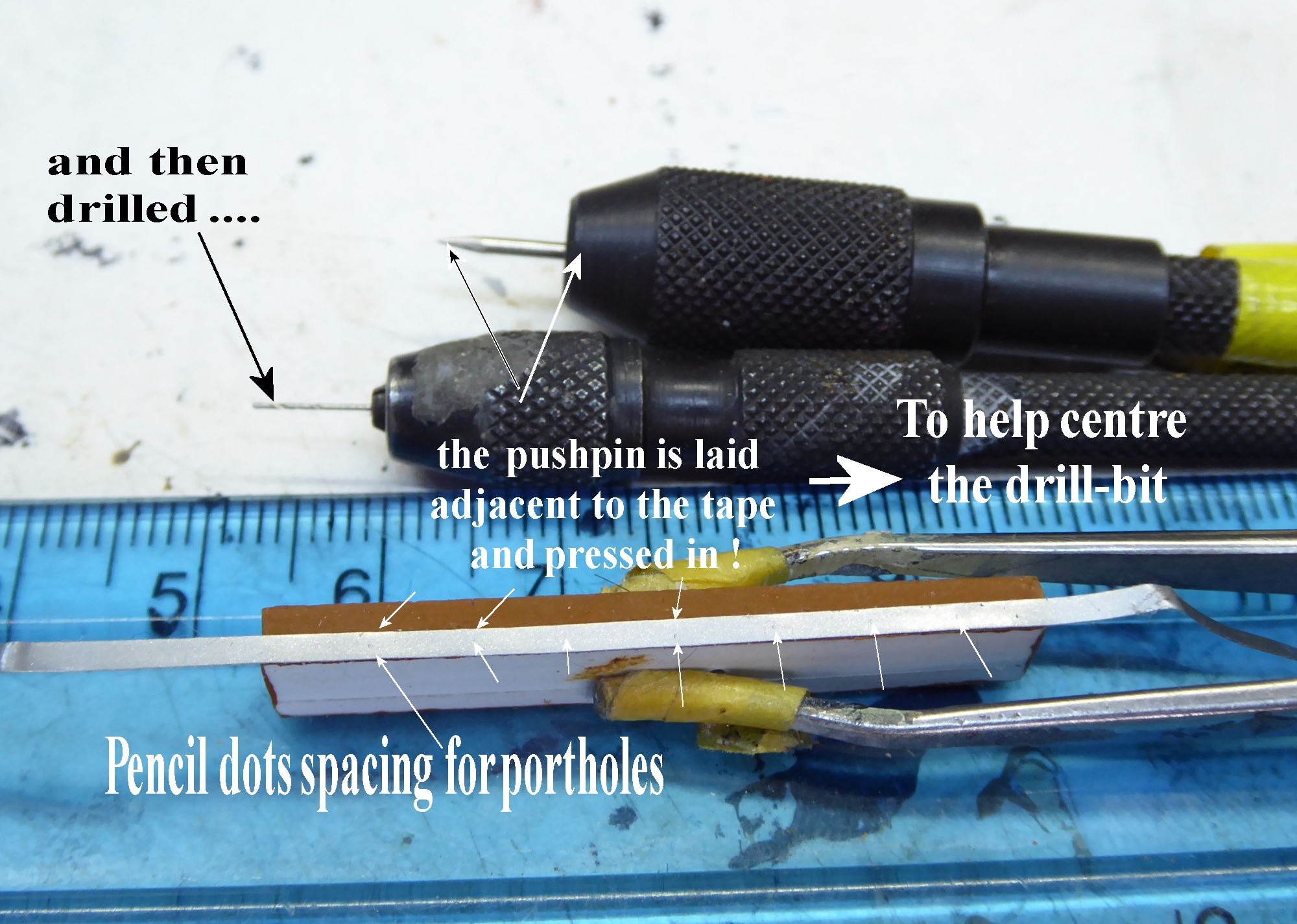

some of the pieces needed portholes as well

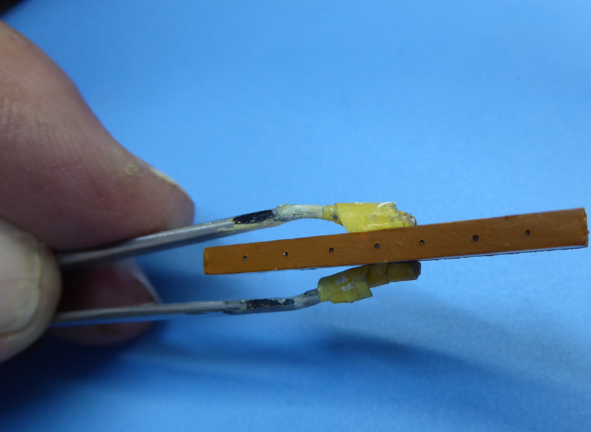

after a first coat of paint--
