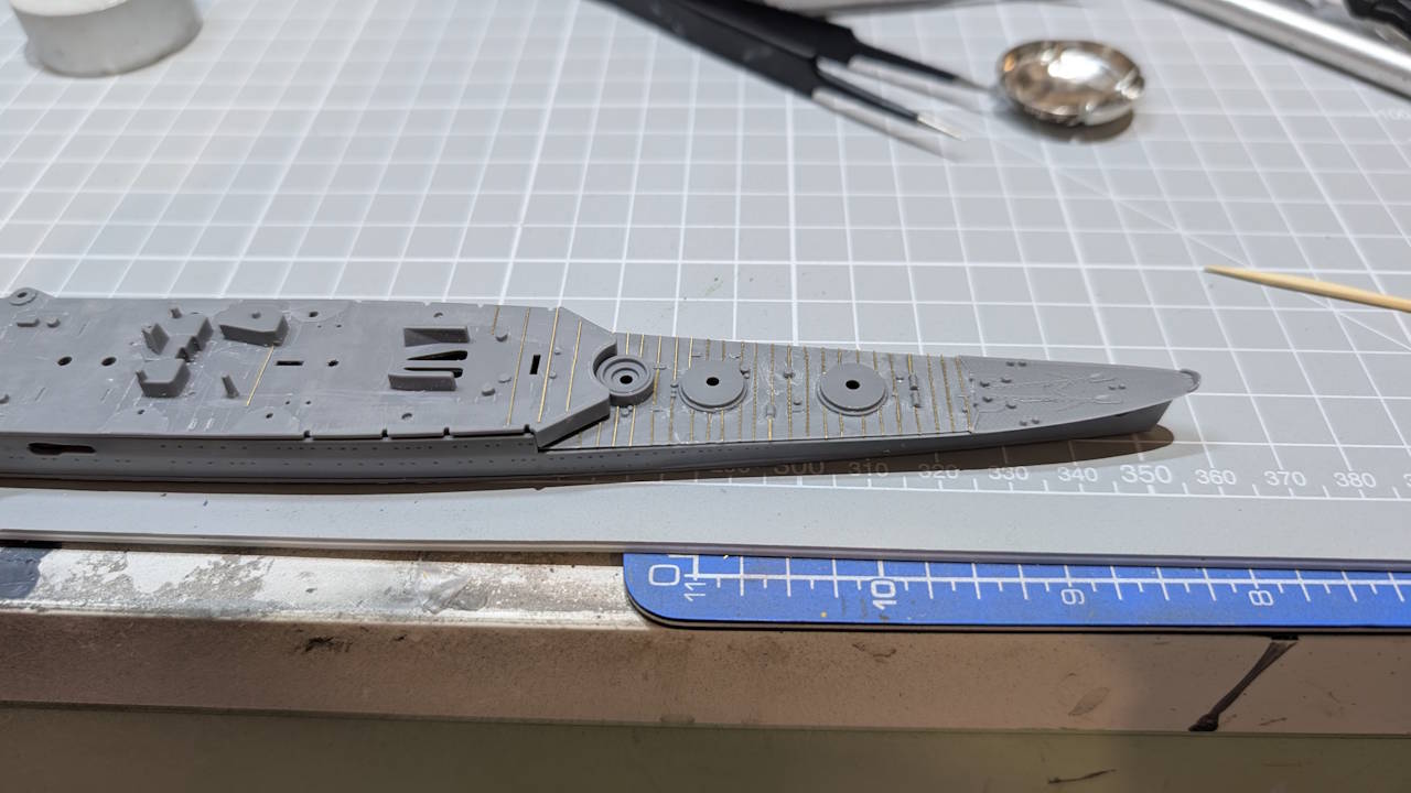

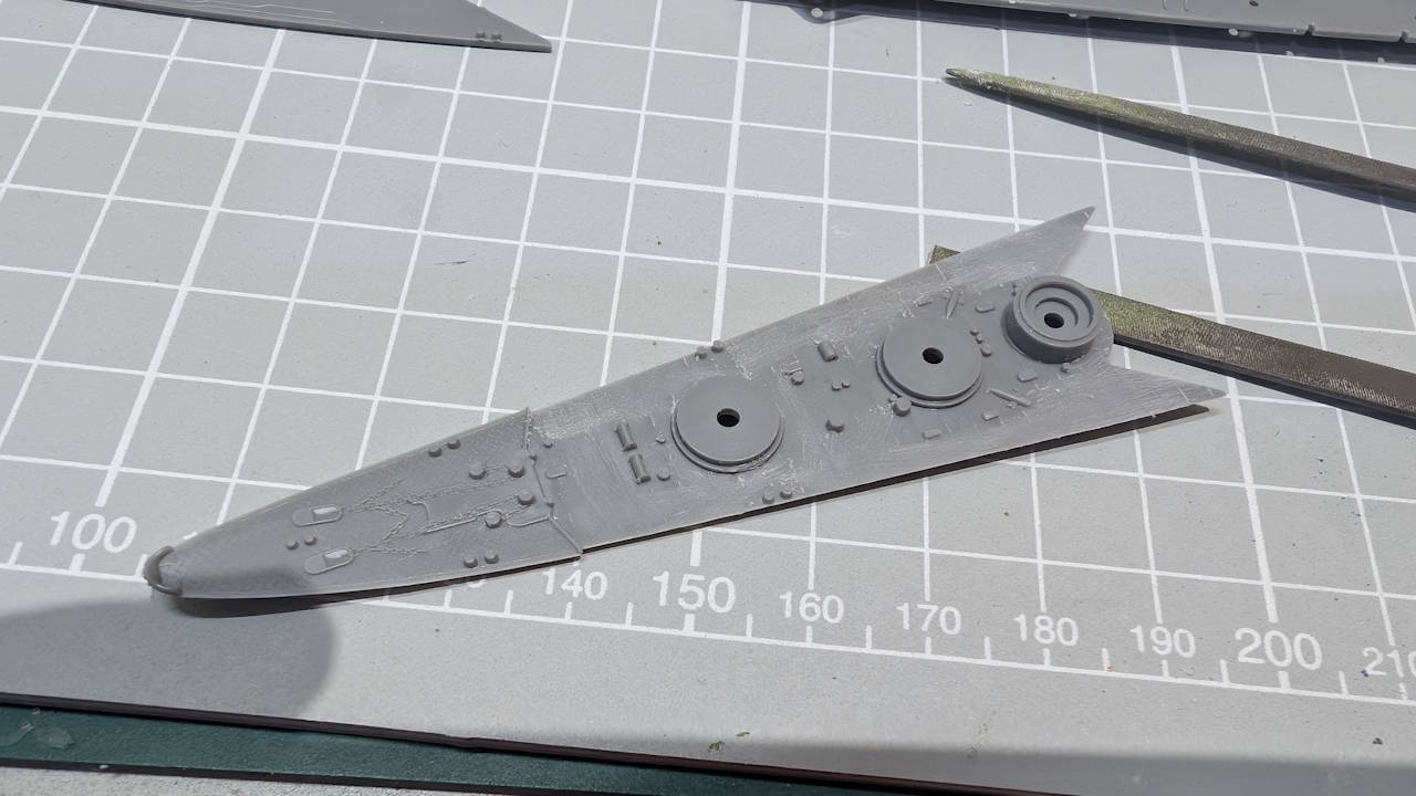

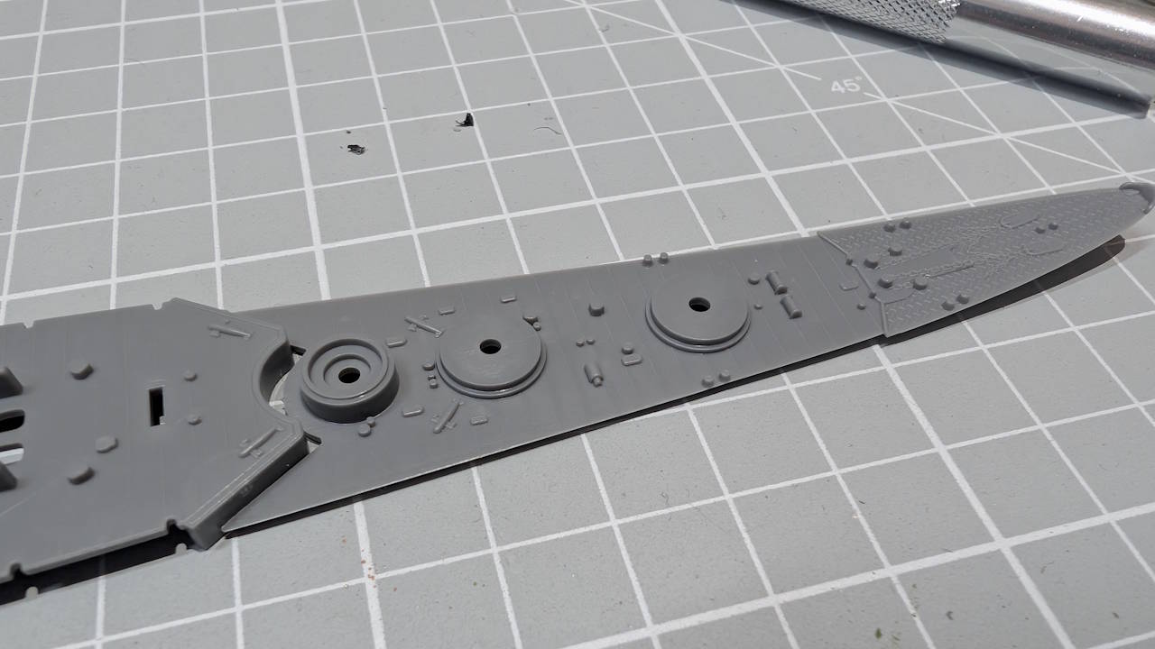

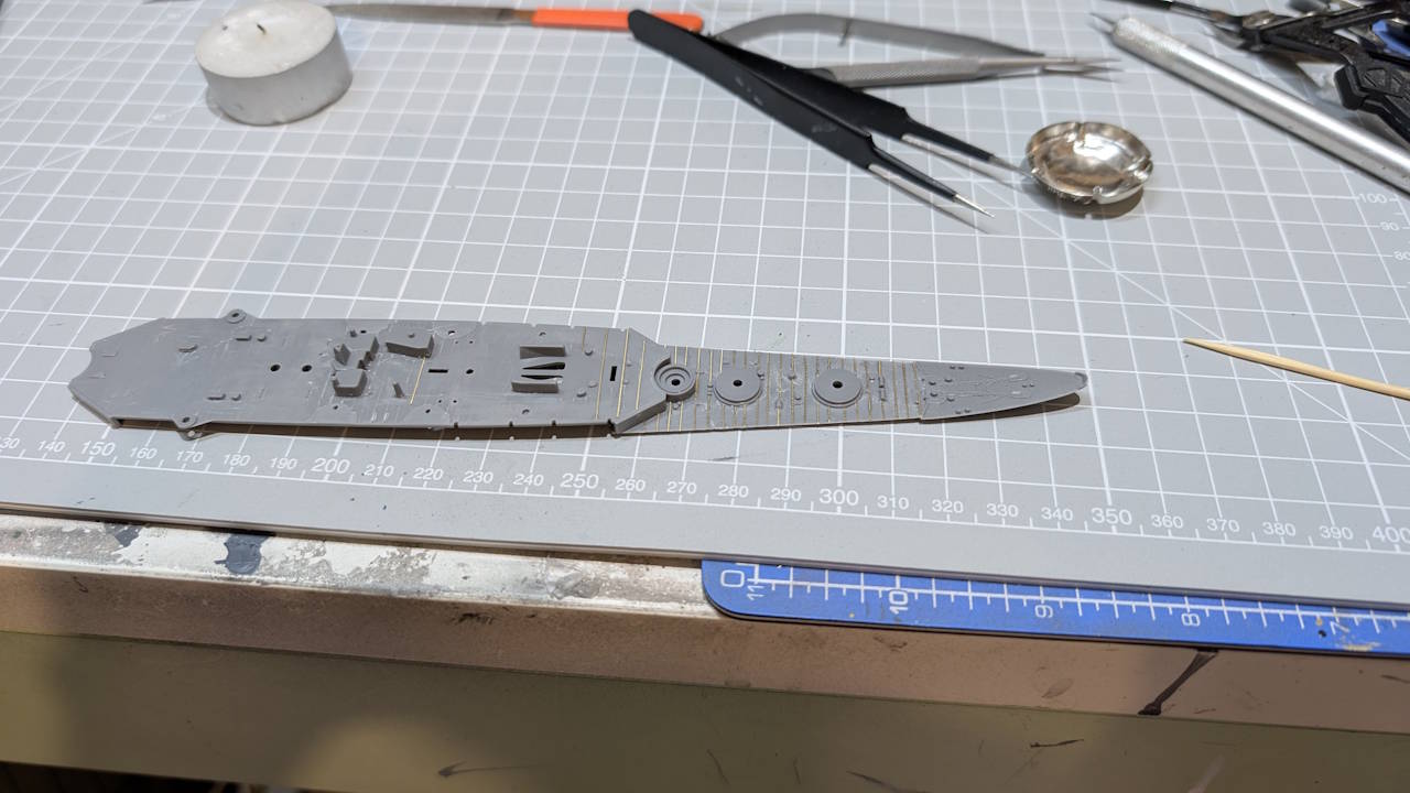

Here's the deck, very pleasant engraving, but we're going to get rid of all that
The paravans have been removed too, replaced by 3d versions.
And the shadoks sanded and sanded... and when they weren't sanding, they slept dreaming that they were sanding...

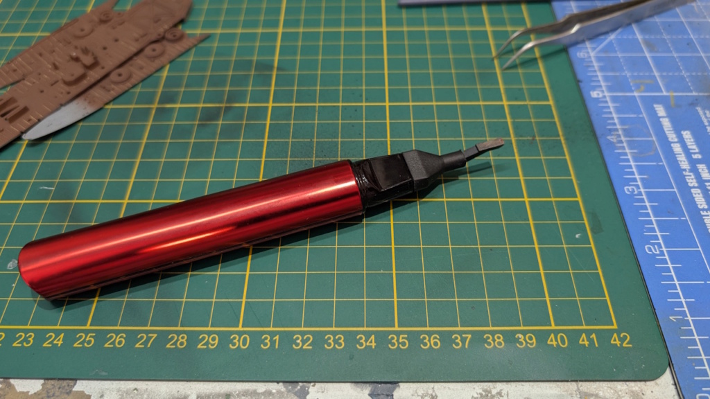

To go faster, in addition to the "classic" files, you can use this remarkably practical little tool !

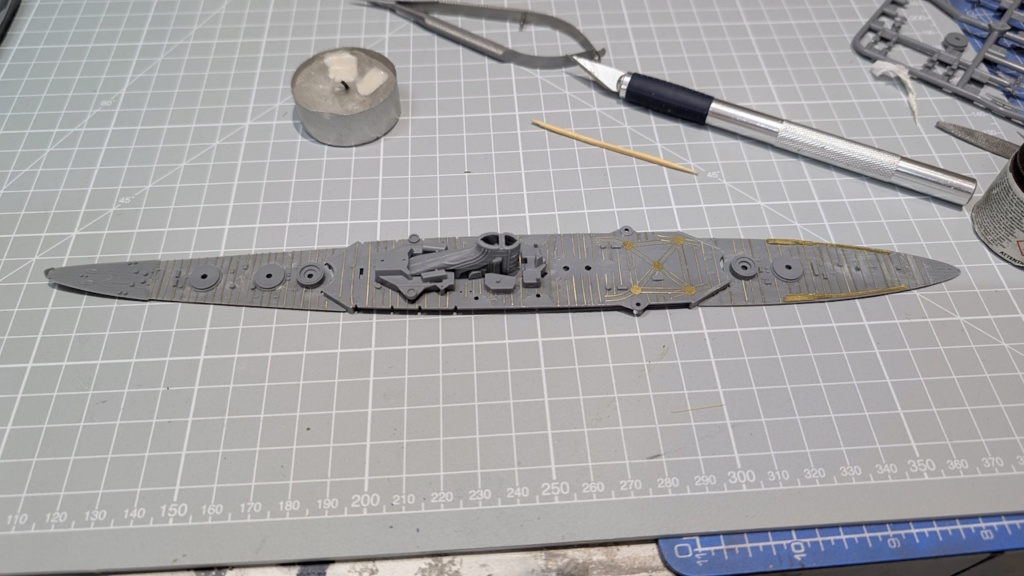

It's long and tedious and progress is slow...
We're still making slow progress, but we're making progress... We're also adding some parts from the Artist Hobby detailing set
I don't think I've ever spent so much time on a deck...

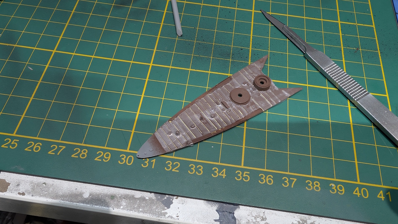

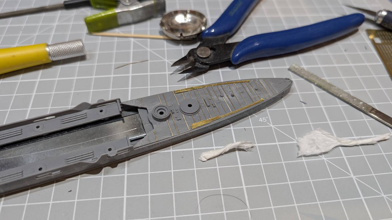

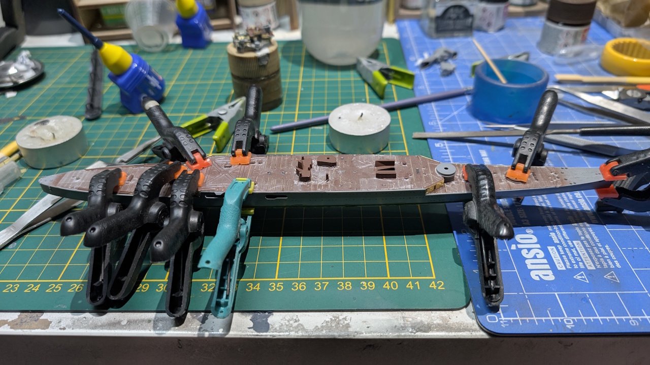

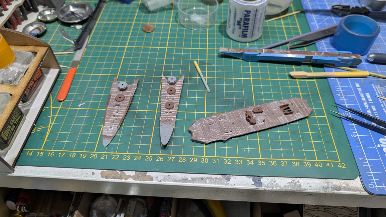

The small plates are fitted...
Now we paint in Tamiya lino brown with my new gaahleri aero, very pleasant paint, the trigger is very soft and pleasant, and easy to clean.
We'll wait for it to dry completely and then start sanding shortly...
gentle scratching
with my electric sander, using the finest tip:
In this case, I didn't use the automatic option, in order to sand as softly as possible.
parafilm masking : Check
Next step : we attack the PE !!!!
For those who are still hesitating, it took me between 15 and 20 minutes to do the 3 bridges... how long will it take on the masking tape?

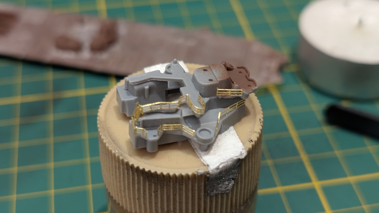

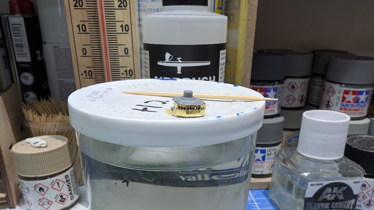

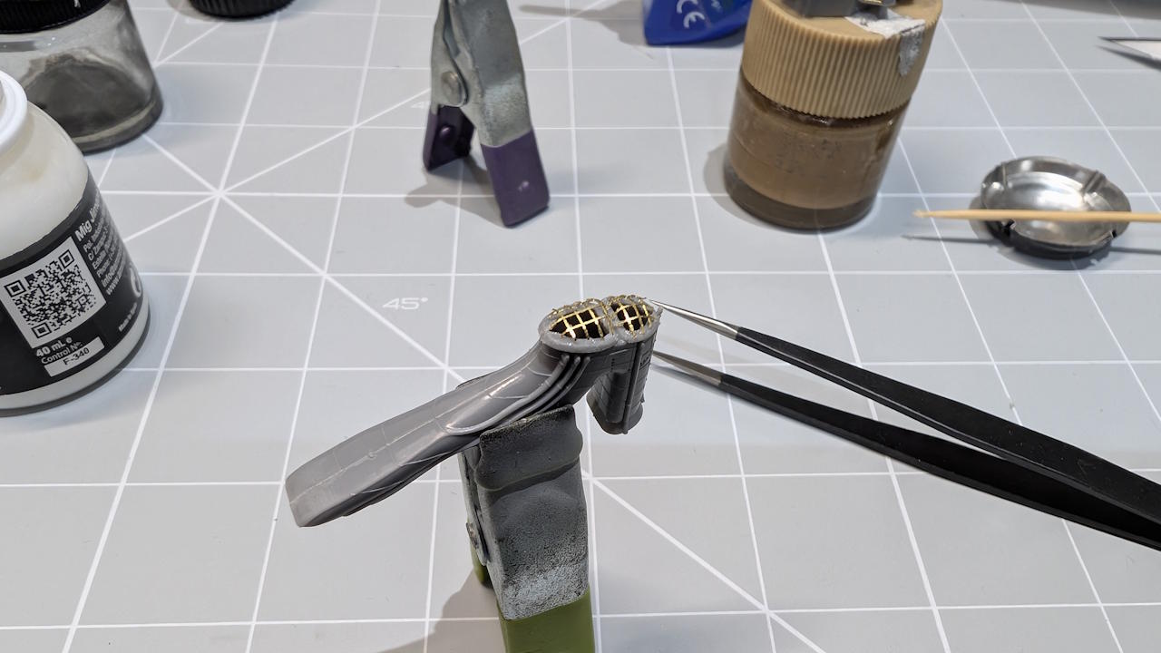

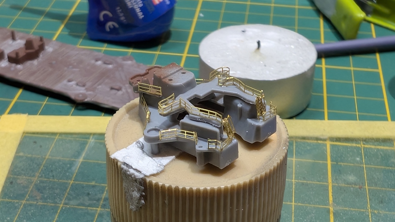

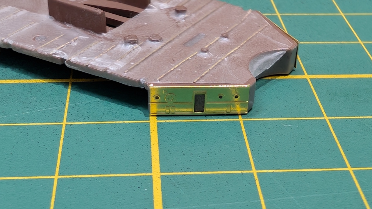

Before work this morning, we're sticking on something to improve tamiya's hopelessly flat fronts
all this fits on a tamtam pot with a radius of about 1.5m, of course.
in total: 18 pieces of PE for 2 pieces of plastic

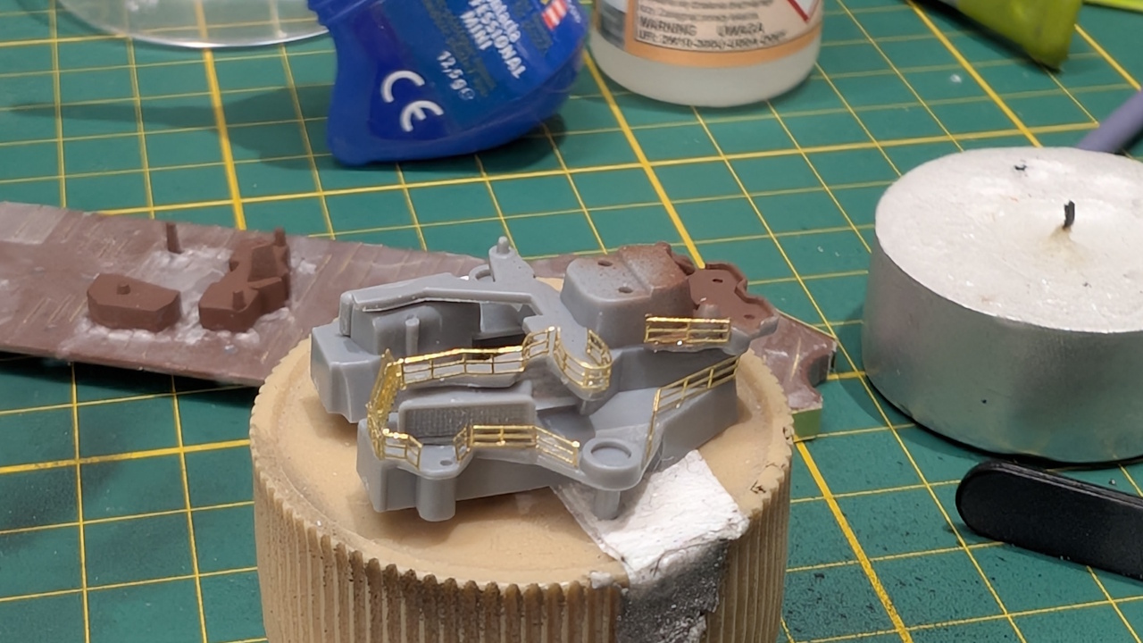

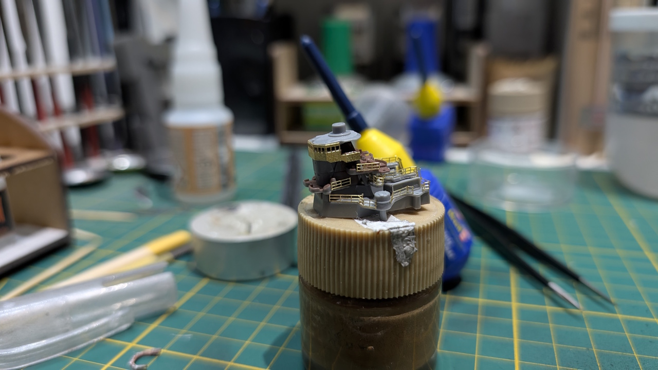

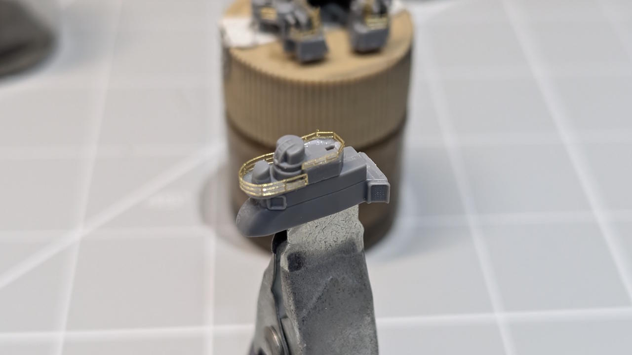

Let's move on to the top floor with the bridge
Before :

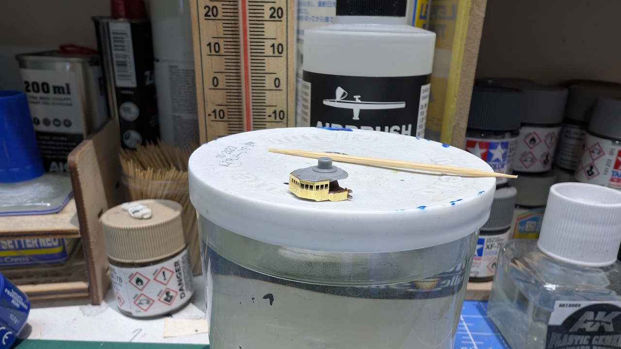

remove the glass, sand it down and HOP! install the PE
After:
Blank laid on the tower, it will only be glued afterwards, to make it easier to paint.

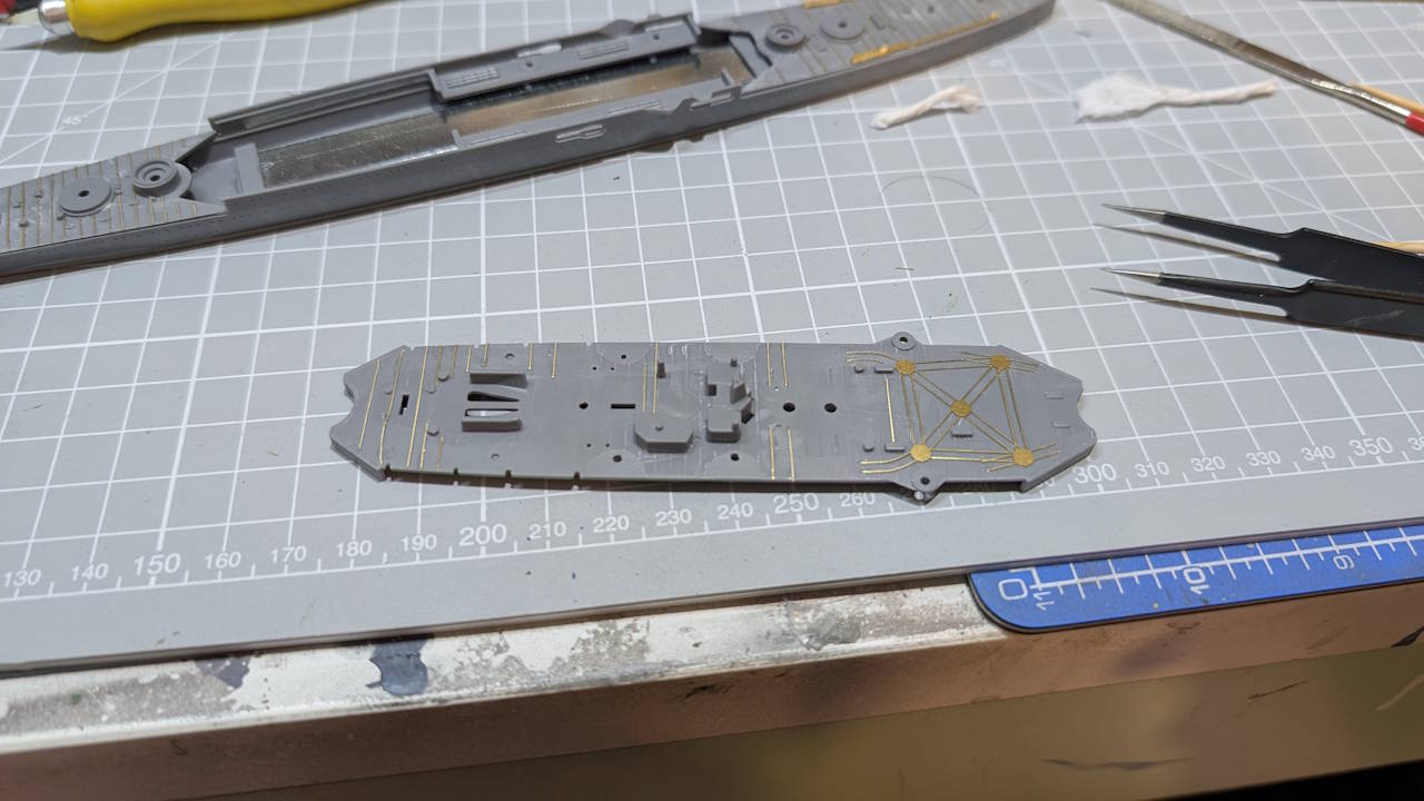

The next stage of the assembly is a very small one, but still, gluing the deck.
Not so easy, as the hull is very tight and the deck has to be held firmly during the gluing process to prevent it from popping out of its space...
mini overhang with gluing of 2 small railings and chimney grilles
