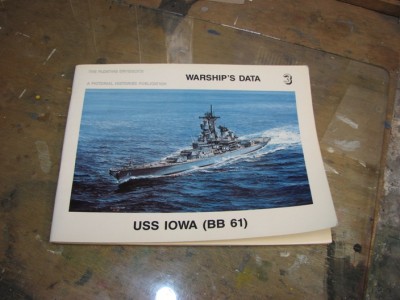

The Floating Drydock's "Warship's Data 3 USS Iowa BB 61 A Pictorial History Publication

The time period of this build is between June 10, 1944 and June 13, 1944. There are two pictures in the Warship's Data book with these dates. The center fold out page has a small color picture and on page 39 there is a B&W picture with the dates. I believe they are in the process of painting the ship. The stern colors are darker than the bow and that's how I'm going to model my Iowa.

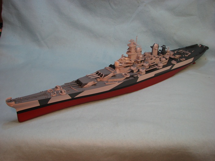

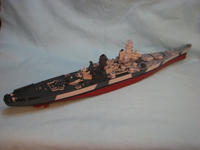

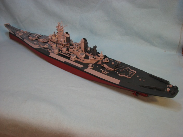

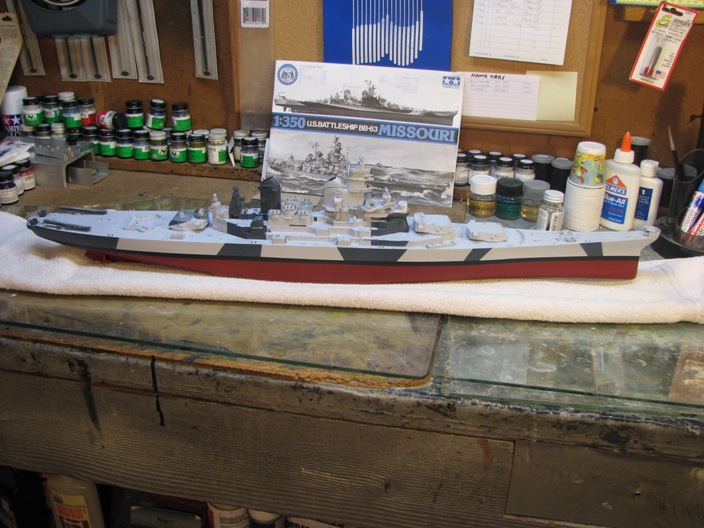

Heres 's how she looks tonight. The decks and guns are painted. The resin parts are causing me some pain. They were primed four years ago with Tamiya's Spray Primer and it is now flacking off the parts. I've never had that problem before with Tamiya's primer. You can see where I've tried to remove it from some of the pieces.
I think the forward decks are to dark. I used Ocean Gray to lighten the Deck Blue. I think now it maybe should have been a lightened Ocean Gray.
Gordon

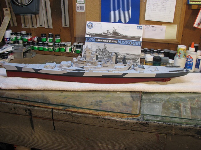

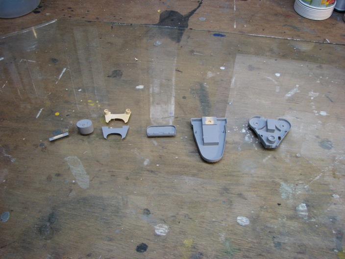

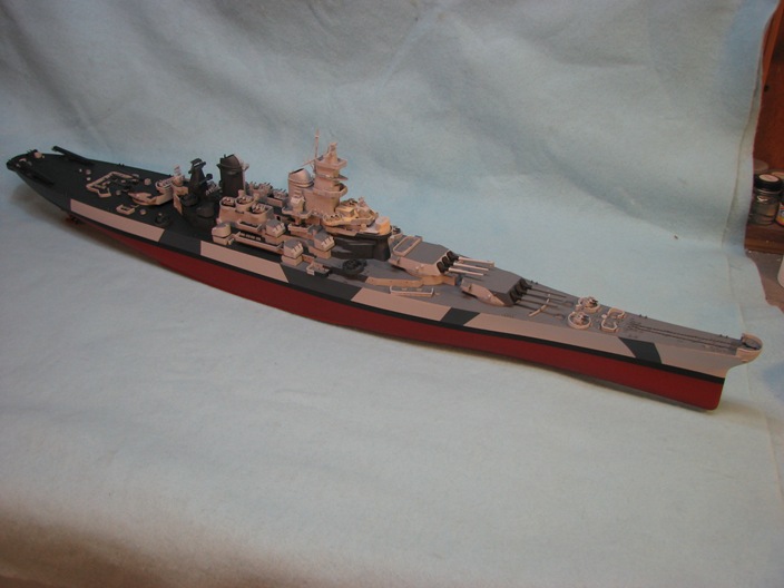

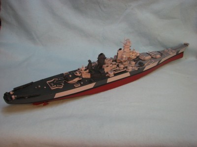

I stared working on the Iowa again after a 6 month stint of doing nothing on the "to do later" pile. I had problems with the primer and the paint cracking and flaking off of the resin parts. I sanded off all the paint and let the parts soak overnite in in Castrol Super Clean and then washed them in Dawn dishsoap. This morning I put a coat of Tamiya spray primer on the parts. Hopefully they won't crack again.
Progress resumes.
Progress resumes.
Gordon
