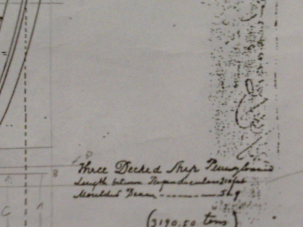

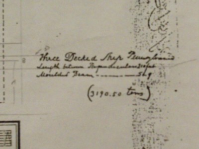

Here are some photos of the plan I mentioned. I did the best I could given the camera I have to work with. I think you can see that the lettering looks nothing like the Chapelle plans, much to "curly". Along one side it looks like this plan is the opposite side of another page of something. You can see where ink lettering shows up backwards along he right hand edge. The deck heights are laid out clearly, as are the main beams. I show the lower deck layout and labels the rooms. This discussion is lots of fun. I learn alot, and get to see different view points with regard to speculative facts and items. Always assume I know noting when you answer my questions, this way nothing is left out. Thanks!

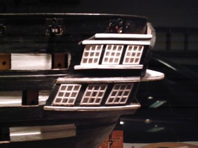

Hope everyone's holidays are going well. I finished my gun carriages, need to paint and add the tackle hardware. The cap rail is on, have half of the quarter gallery windows framed up. If I don't have to make any more gun tackle blocks, I should have the entire spar deck done in a week or so. Things have slowed down some as I have to carefully consider what I need for the next steps. The channels are probably next, then the chain plates and gun port doors ( I will be installing them closed for the most part). I found some construction tips on this forum for making the gun port hinges. It does not look like it will be as tedious as I thought. The hinges are what has held me up on making the gun port doors. I am a little daunted with the thought of cutting a 175 + strips of brass 3/32X 13/32 of an inch and shaping the hinge pin on each one. I am not looking forward to making the gun port wriggles. Any thoughts on those? I am not sure if I want to cut them from brass, as they would not be "thick" enough? Anyway, thanks for all the comments so far. They have been a big help.

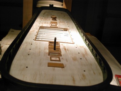

I have been working on the spar deck as you can see. Nothing is glued down yet, need to make some adjustments on the grate, ladder, and galley pipe framing. Still need to build the wheel, some deck lanterns, a small grate, the fore, and main bitts, a sky light, the mizzen mast collar, solder brass framing for over the ladders, and finish the gun carriages (they are about 2/3rds done). I have the fore, main, and mizzen pin rails done, as well as the bulwarks pin rails. Everything will be installed and glued in after the cannon are all rigged.

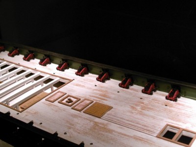

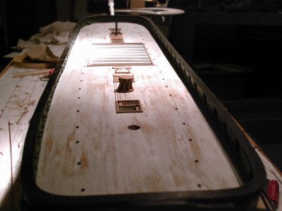

Finally finished the 18's :big_grin: ! I need to make a few more blocks and I will begin rigging the gun tackles. When the cannons are rigged and the remaining deck furniture is built and installed, I am going to make the hinges per Bob's suggestion (out of card stock), build and install the gun ports, and then the chain plates. I will finally finish up the windows and then work on the stern carving.

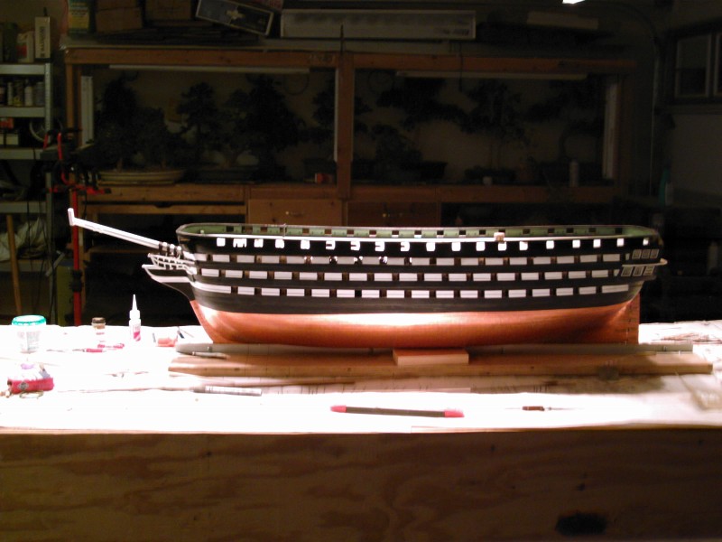

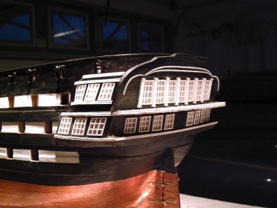

Been a while, have had some family issue out of state the past couple of months. Here are some photos to show I am still plugging away at it. Any suggestions on how to "coil" the tackle rope and glue it to the deck? Super glue is too shinny and discolors the tan thread. I know it will involve wrapping around a dowel or piece of rod, but keeping it "together", in other words coiled, eludes me. I know what I want to do for the hinges, it is going to take along time. Photos of the Constitution show that the space between the gun port wriggles (spelling?) and the top of the gun port are covered in what looks like treated canvas? I am assuming the canvas "cover" is further rain water run off protection? This would effectively hide all but the very bottom of the hinges. I will see if I will add the extra "protection" to the hinges after I have done a few complete gun port covers. If I am not happy with the hinge appearance, I will use the cover.

I meant to reply earlier..
Mr Carr gives you a very good method- albeit labour intensive... :big_grin:
when I built wooden sailing vessels I have always made them on a pencil or similar dowel. wrapped around , coated with white glue( Elmers in the USA ) and rolled off the dowel before the glue set; that way I could form the coil to desired shape.
I attached to deck using slightly tacky matt varnish.
I enclose a link to the two wooden vessels of mine here at MW.com
and couple of pics ( poor scanned 35 mm images ) of some coils of mine.
I hope to shoot s better pic tomorrow by way of illustration of the above.
kind regards
Jim Baumann :wave_1:
