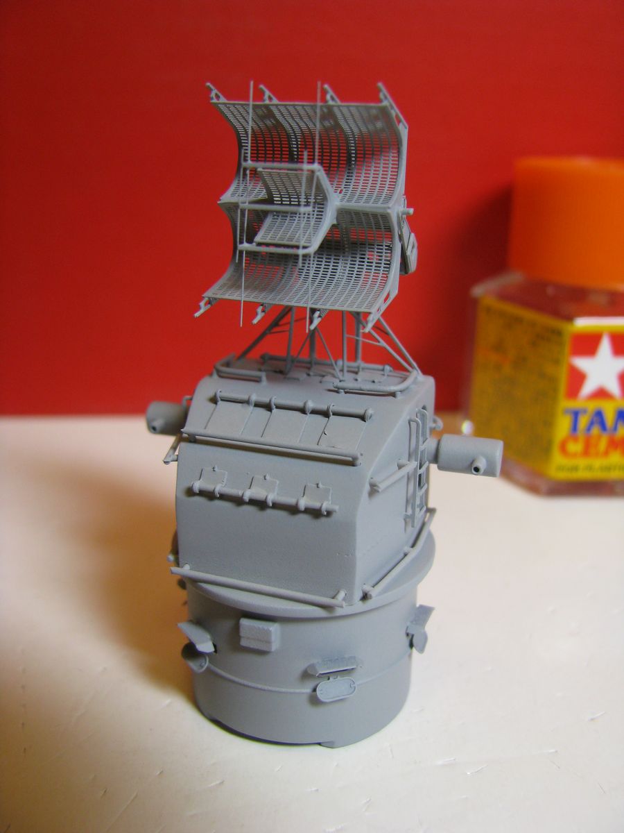

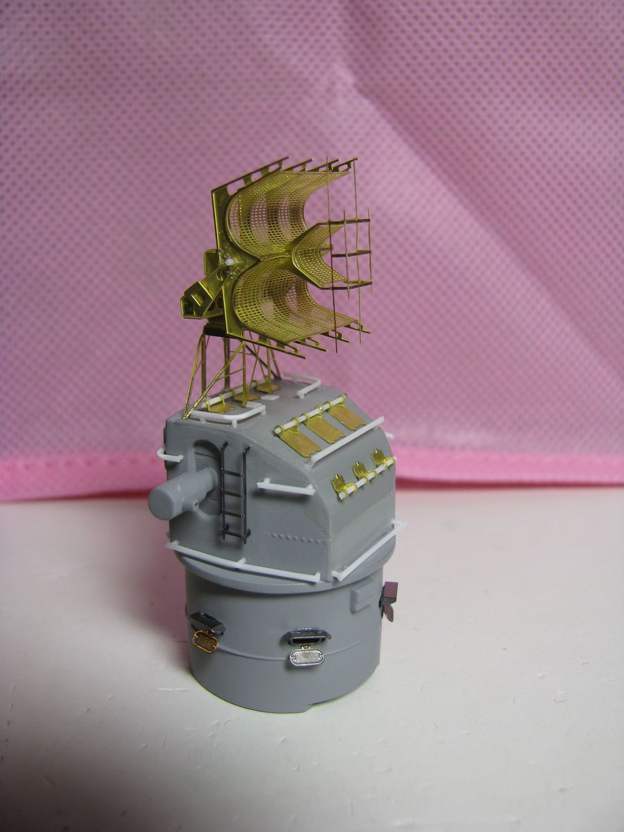

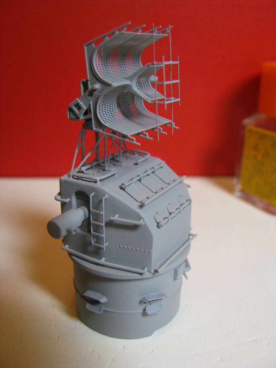

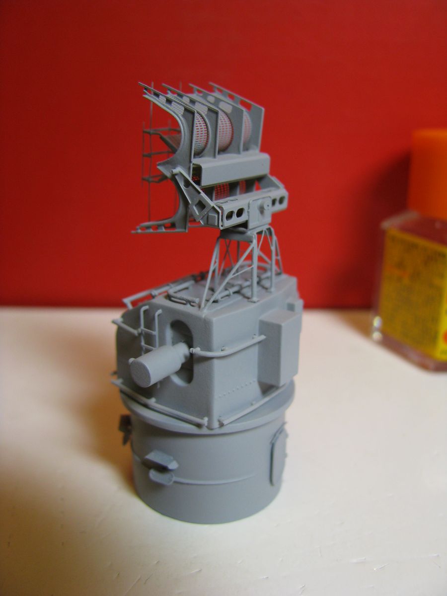

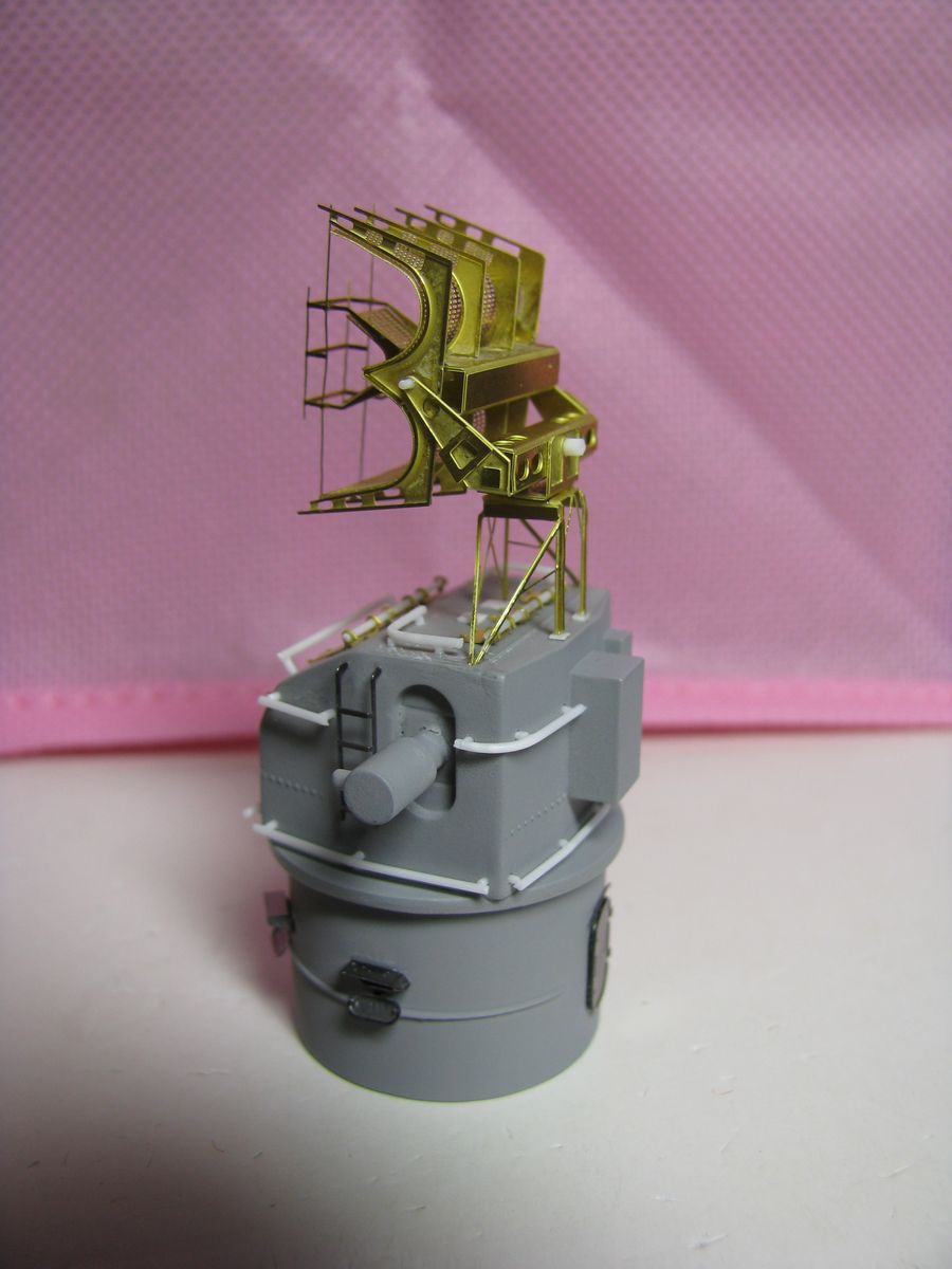

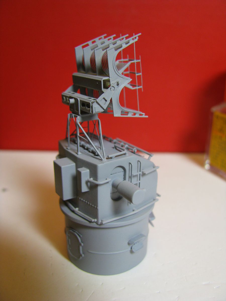

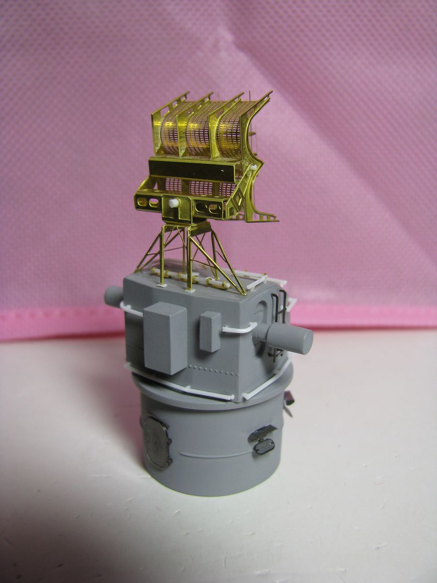

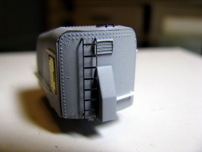

Hi guys,
I am building the Revell kit with Eduard and Nautilus sets. Nautilus set is more accurate in most aspects, though the photo etched parts are a bit stiff to work with. Here is the gun director I completed so far. Please do comment.
Douglas
Douglas

Great looking director, Douglas. Keep the pictures coming.
Gordon

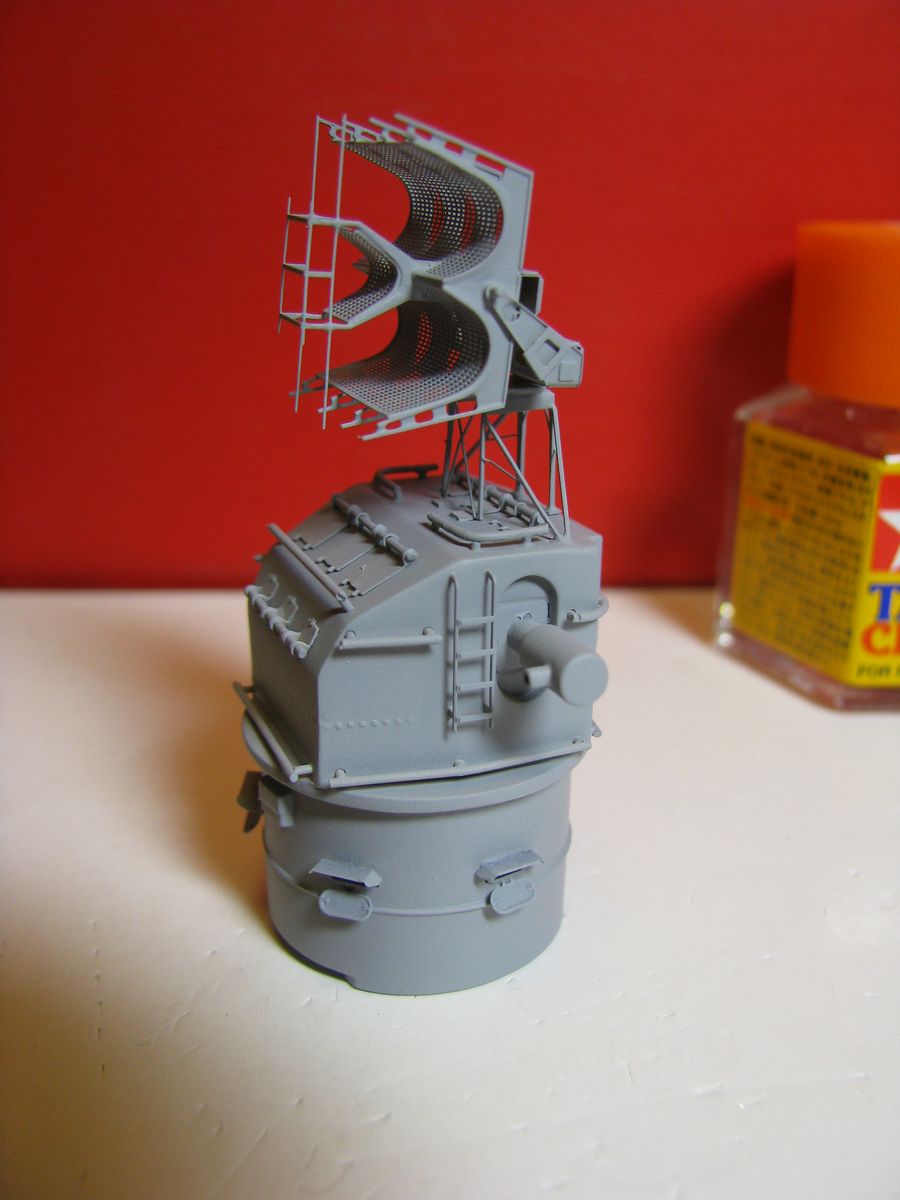

Re: 1/144 DD-451 USS Chevalier
Douglas,
I hate to do this since you have done a SUPERB job on your Mk 37 director, but I have to point out that the radar you have used is not the Mk 4 as used on the early FLETCHERS. The array you have in the center of the array wasn't used on the early Mk 4 and I believe was only used on the Mk 12 radar. The Mk 12 radar started to be installed in late 1943 on some FLETCHERS and a few months later the Mk 22 "orange peel" radar was added to the Mk 12 radar on the Mk 37 director. I only recently found out that the Mk 12 was installed without the Mk 22 (on BELL (DD-587) and a couple of others). You have a remarkable array here and I don't know what to tell you to do.
The model kit manufacturers have messed this up as well, DML has supplied arrays better suited for the Mk 12 radar for their BENSON-GLEAVES kits, however NO BENSON-GLEAVES unit ever had the Mk 12 installed. The BENSON-GLEAVES Mk 37 directors were the early tapered back type and there was no room for the Mk 12 radar.
FLETCHER (DD-445) on 15 July 1942 with her newly installed Mk 4 radar.
JENKINS (DD-447) on 2 September 1943 showing her Mk 4 radar about a year after she was completed.
La VALLETTE (DD-448) in October 1942 as completed with her Mk 4 radar.
HAZELWOOD (DD-531) on 24 June 1943 with her Mk 4 radar pointing up.
HOWORTH (DD-592) on 2 July 1945 showing the late war Mk 12/22 combo on the Mk 37 director.
TINGEY (DD-539) on 30 August 1945 showing the front of the Mk12/22 combo on her Mk 37 director.

Catching my breath here............
OK Rick, as I'm building an early Fletcher as well...........indeed, THE Fletcher in 144.........you said more than a mouthfull there.
Let me see if my mind can "fidder" this out.
1. I'm using the Nautilus PE also.
2. From your photos, If I (we) left out that center array, It might be "close enough for government work"? The 4 frames surrounding the main array PE is a tadd different from that in the photos.
3. Douglas did such a good job on his...........if it were mine........I'd leave it as it really looks great.
Regards
Steve
Regards
Steve
- Posts: 3882
Actually Doug's Mk 37 would look great on a late war Round bridge FLETCHER or if the director is removeable from the base, look good on a GEARING (with some mods) ... with the addition of a Mk 22.
The point is that the array designs were different and not much attention has been paid to it by manufacturers.
I forgot to mention that the extensions on the back of the Mk 37 director were associated with the Mk 12/22 radar.
Any modeler can do anything he likes. I certainly wouldn't scrap this beauty. It just depends on how accurate he desires to represent CHEVALIER.

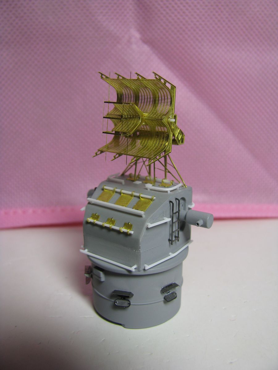

Thank you for the compliments from you all !! I am honoured, it is only I built a Mk 37 director instead of a Mk 4 one !!
But now..... shxx..................what should I do..................I might leave it as what Steve said............... or to go for a late war round bridge Fletcher........... or doing more to build a square bridge late model...............ah ya...........why didn't they manufacture it good so we could relax and enjoy the build !!!
Douglas
Douglas

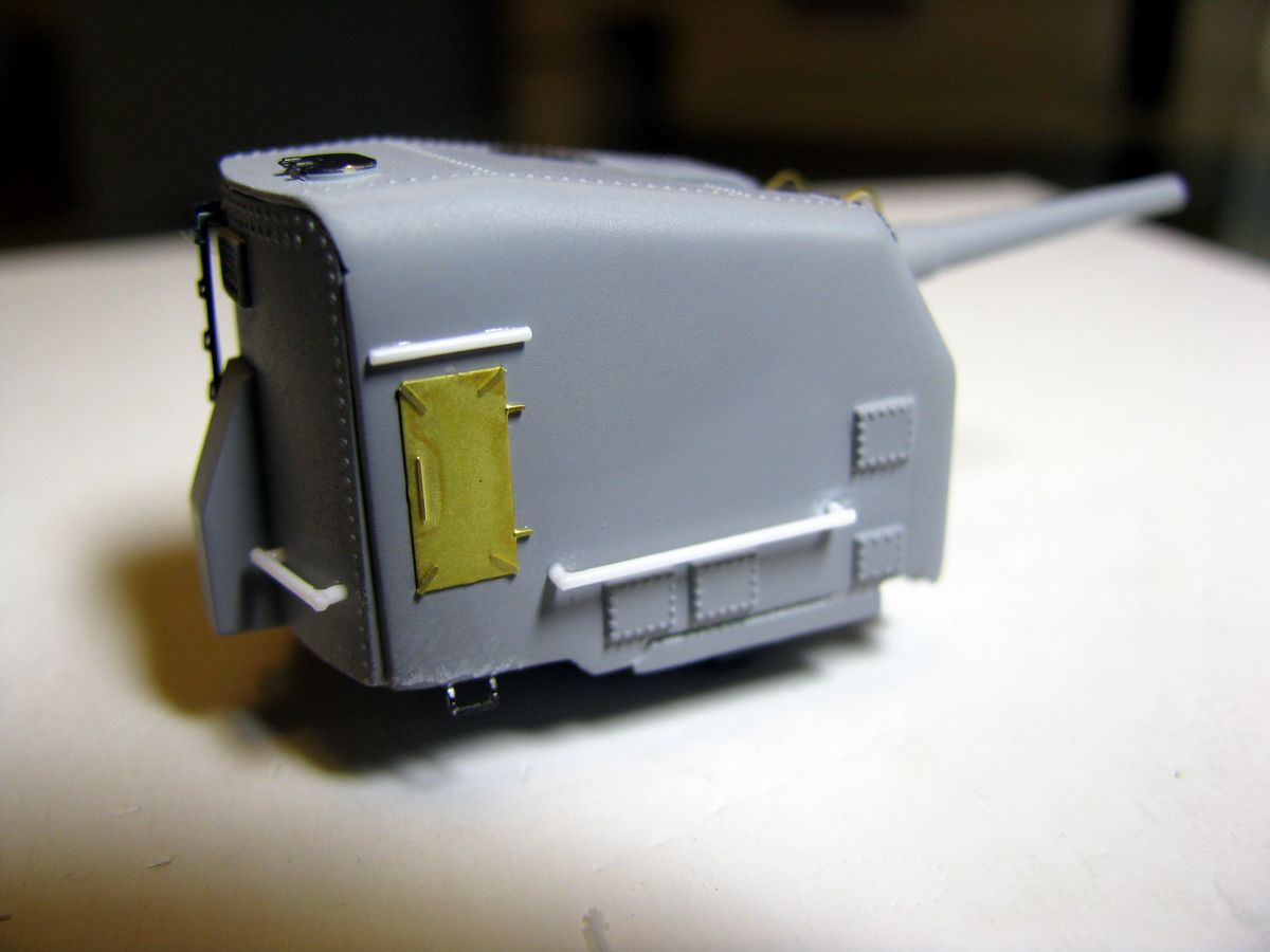

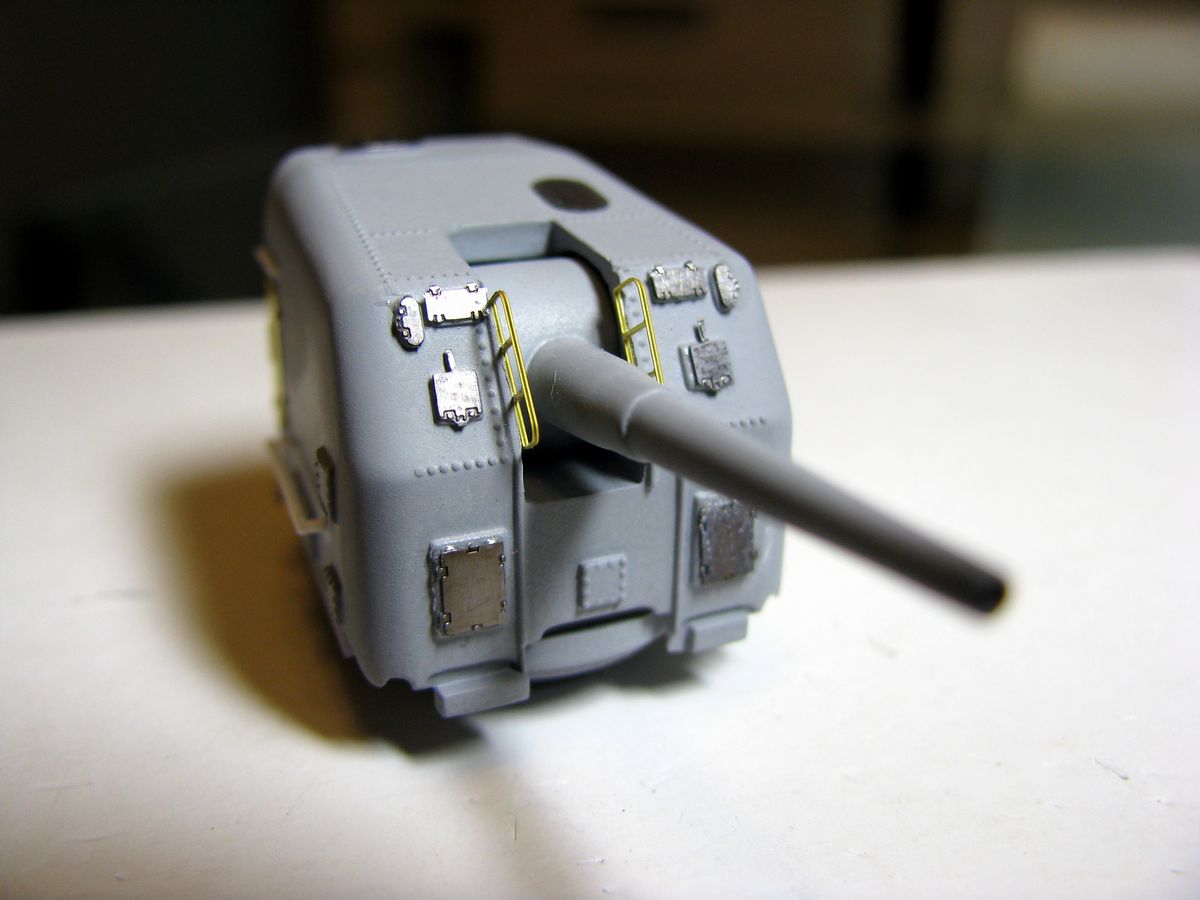

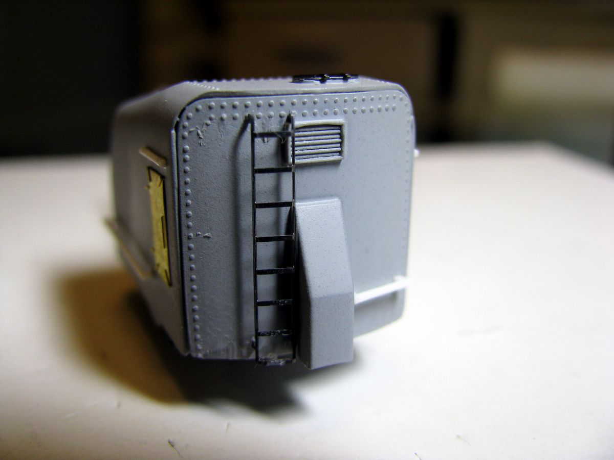

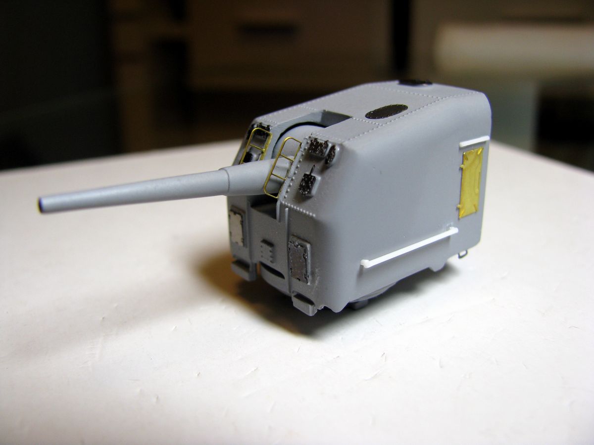

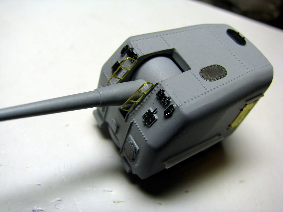

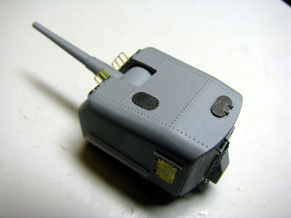

The 5 inch gun here.

Douglas,
Even the super enlarged photos do the gun justice. Good clean work.
Regards
Steve

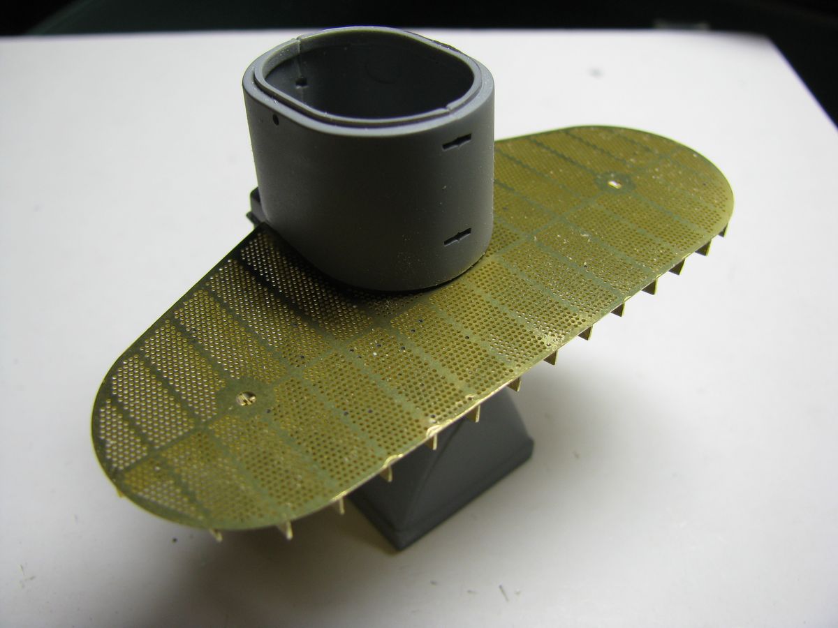

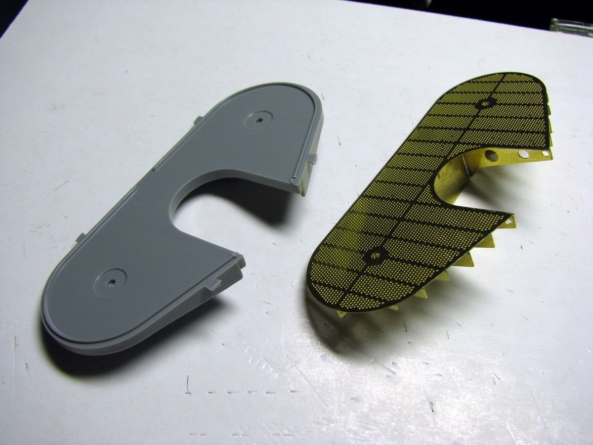

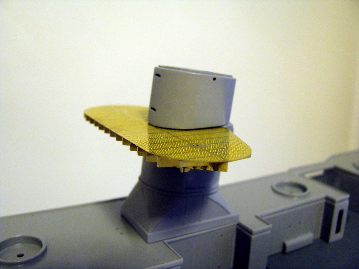

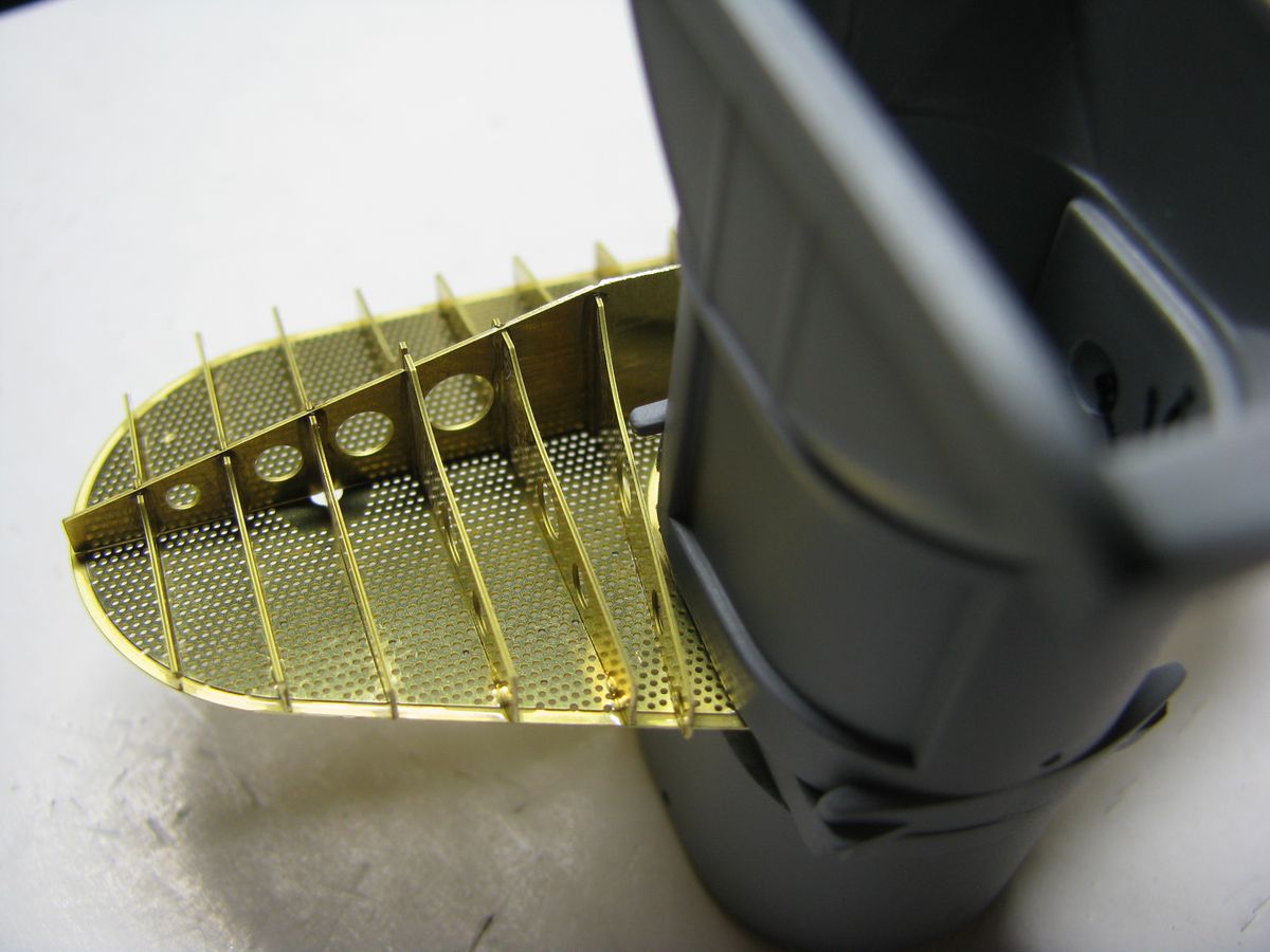

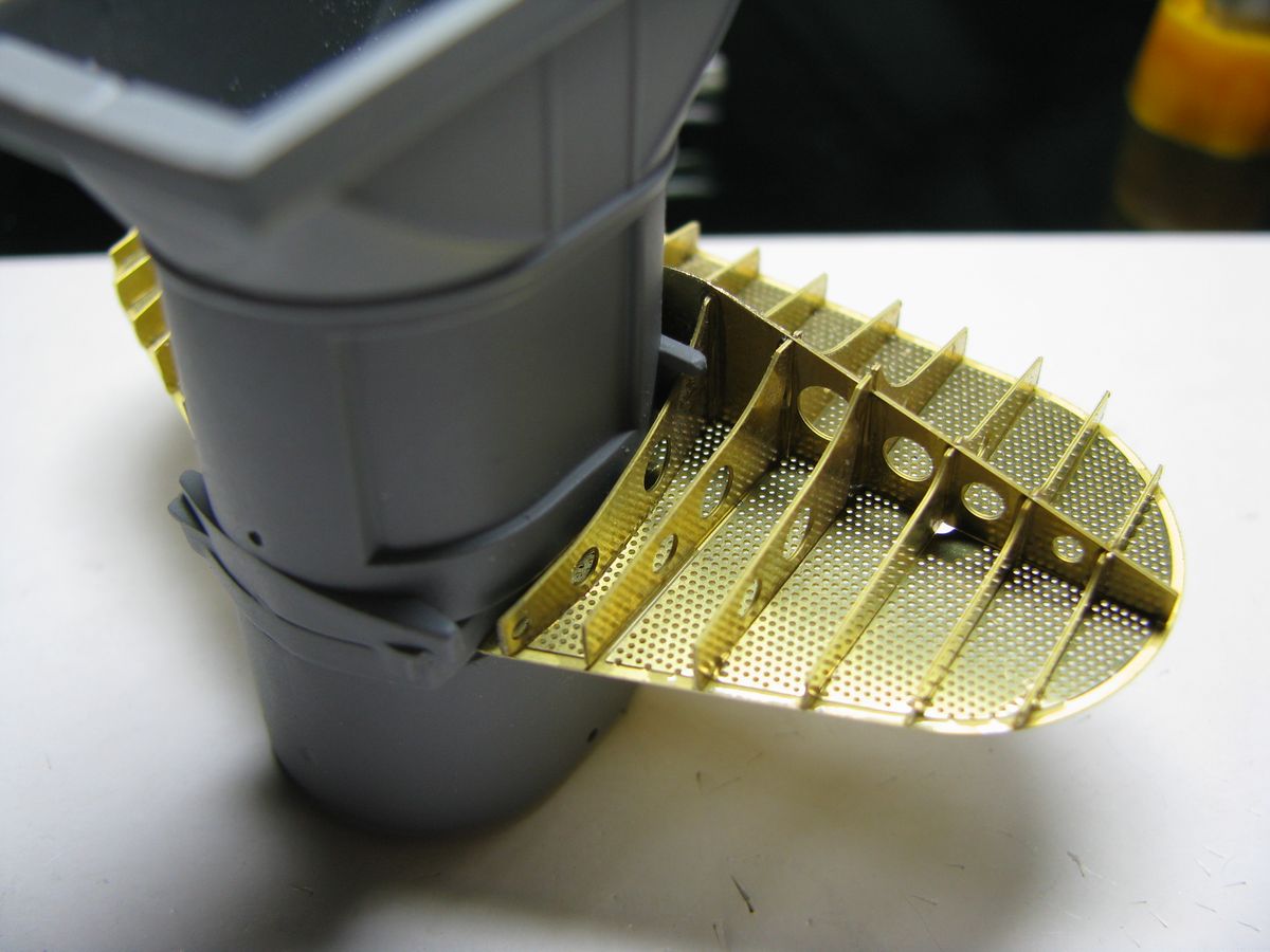

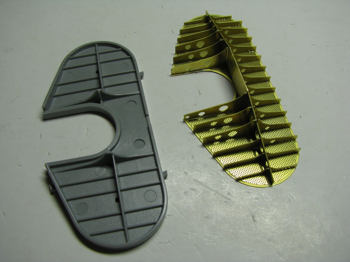

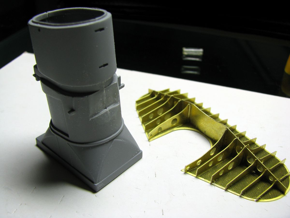

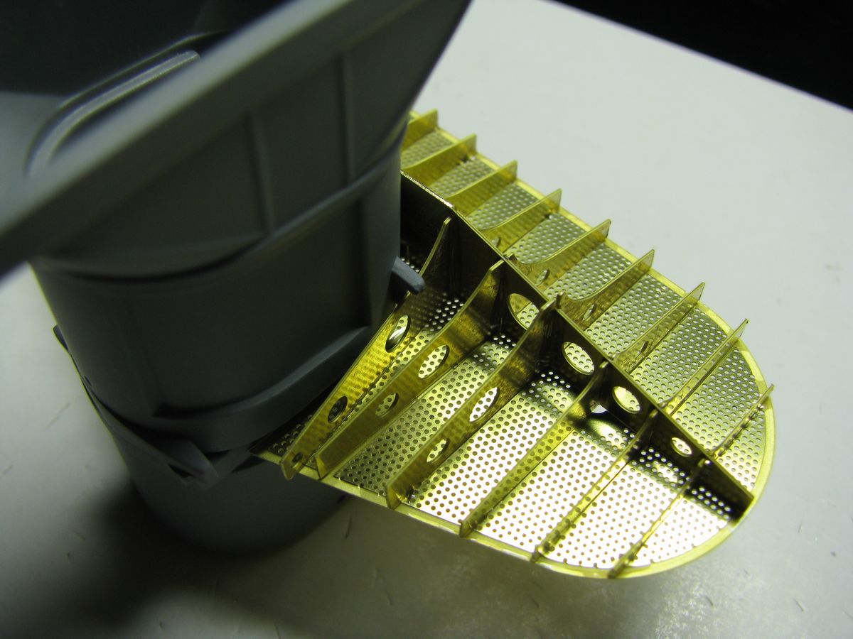

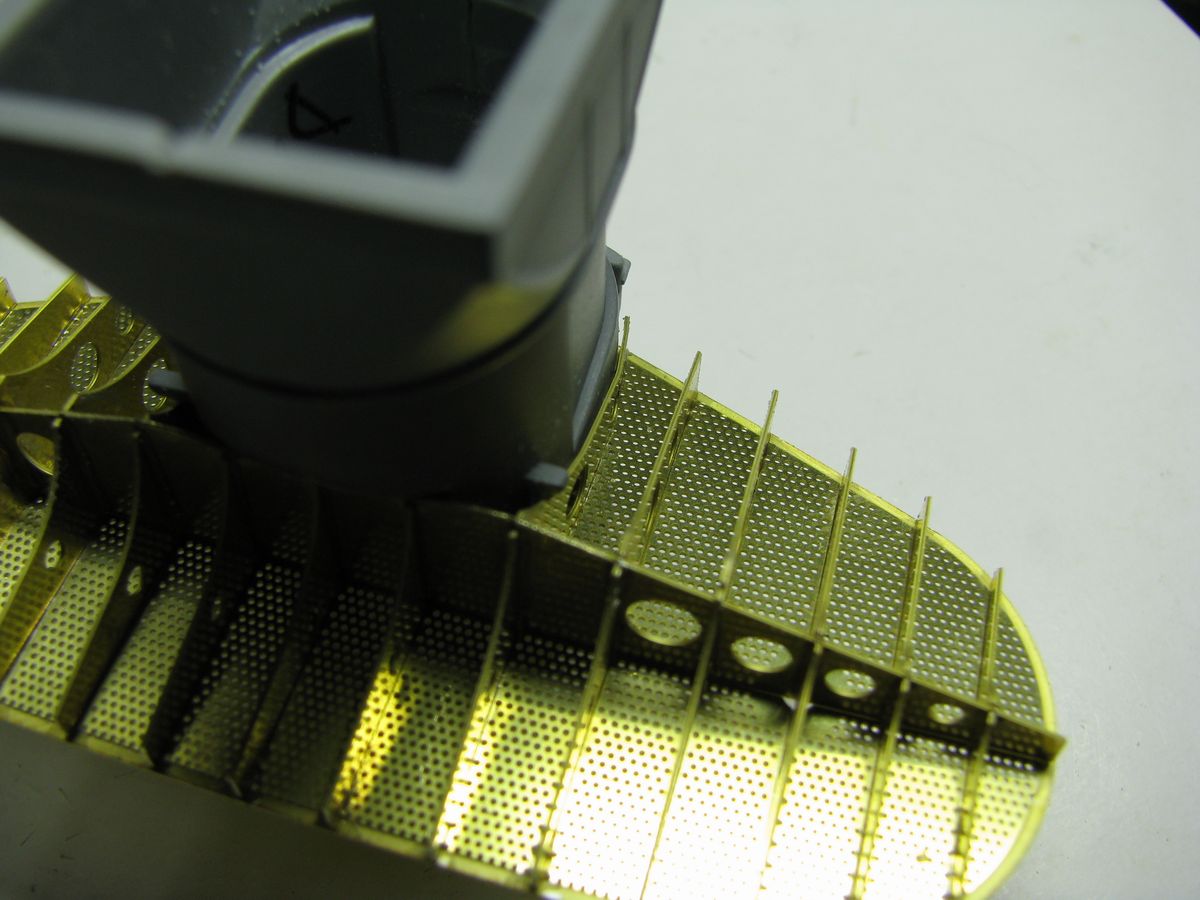

I did the search light platform but I found that the Nautilus parts do not assembled a direct replacement of the plastic part. I need to cut down the rear funnel in order to slide the photo etched platform assembly into the slot on the rear funnel. Also, I need to bend the inner most braces. I am starting to doubt if the Nautilus set has been thoroughly tested to fit the Revell kit.
Douglas

I don't think the Nautilus searchlight platform is correct. Looking at pictures, most of the braces appear to be I-beams. The Revell part is more correct. I ended up using my set as a template and built the braces out of styrene.
