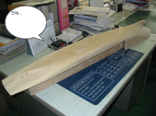

prepare wood for hull
marking lines on the bottom
cross cut
cross cut
take off the wood piece by chizel and  hammer

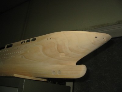

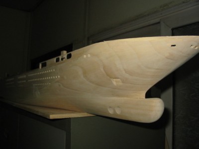

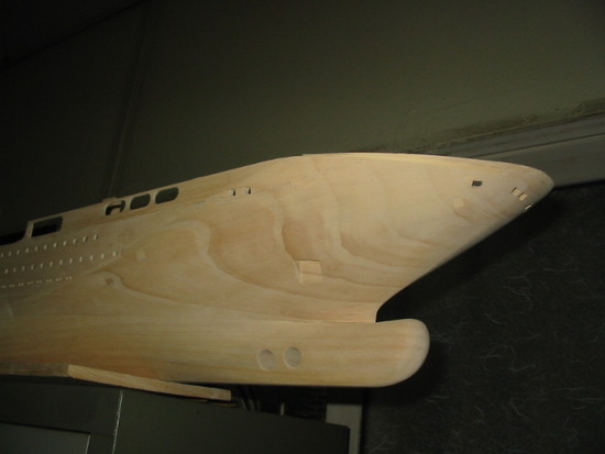

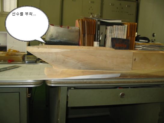

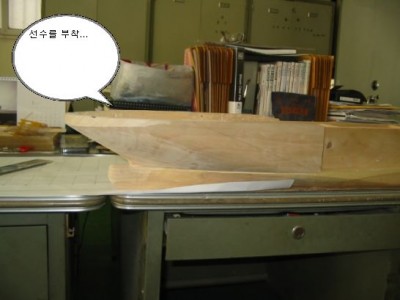

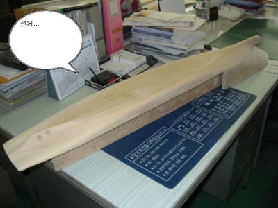

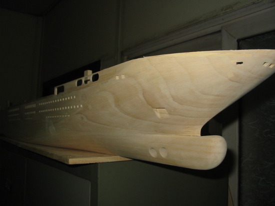

It's more progress pictures of hull
stern
stern
stem
stem
support structure
support structure

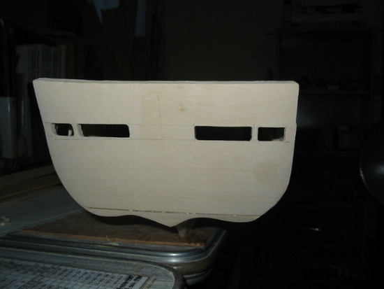

Song Jung Gun
Posts: 1631
Re: 1/200 Sun Princess
Post by Song Jung Gun »
make stem...

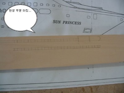

I still can't take in or understand how you're actually gauging the parts of the wood you're reducing into the hull shape, I can clearly see what you are doing, and can only guess you are using craft-man skill to curve this out. Could you tell me at what point does your eye take over from the details on the plan you're working from, assuming you are working from a scale drawing. :thumbs_up_1:

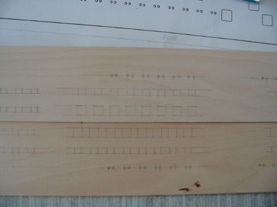

The point is prepare working plan. If you wan't to 1/200 scale modeland prepare 1/200 working drawings. And then gauging the parts just 1/1 of working drawings.

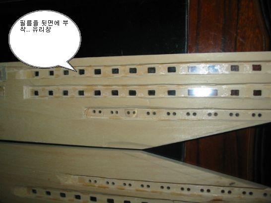

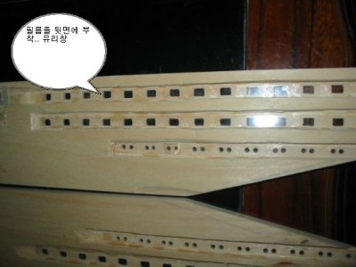

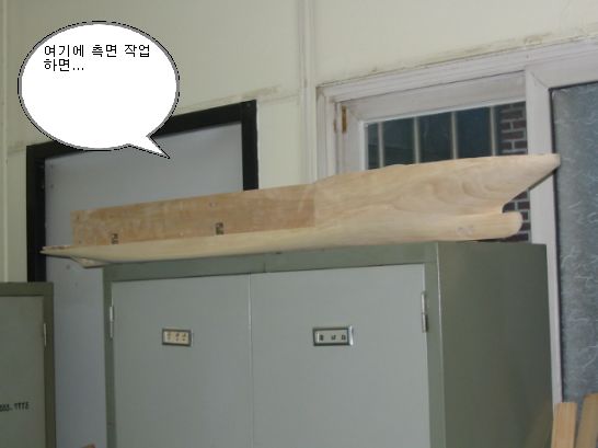

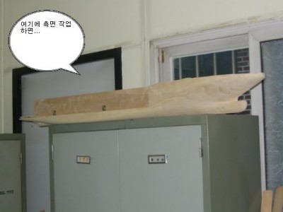

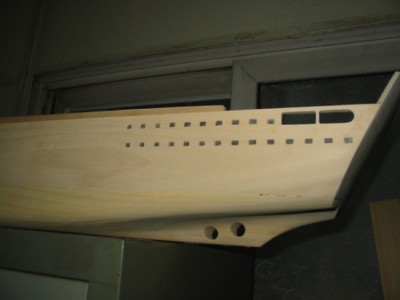

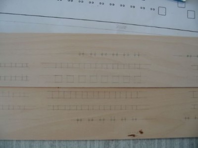

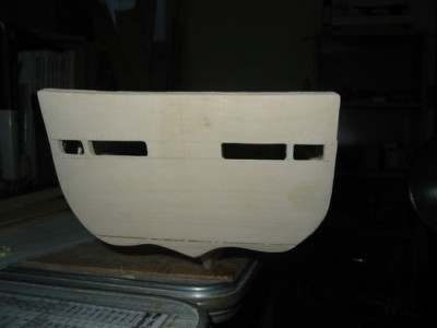

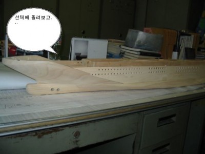

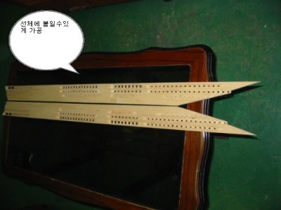

The next progress is making ships both sides and attaching carved stem.
The chipboard is used in both sides because IT HAS A LOT OF WINDOWS.

mabmanu
Posts: 347
Joined: Sun Dec 27, 2009 4:39 am
Location: loctudy finist�re France
Post by mabmanu »
Hello .
Excuse me for my bad english , I'm French .
Good idea for the boat , and very good work .
a+
patrice

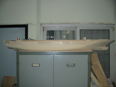

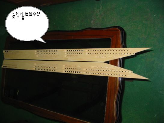

The next step... making side board and attach the hull

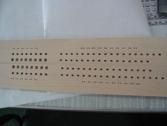

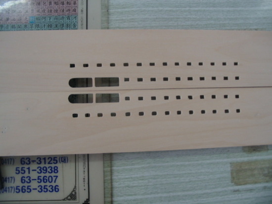

great wood working skills you have!!!

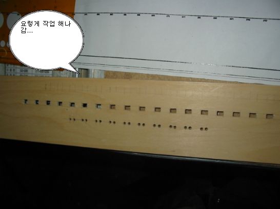

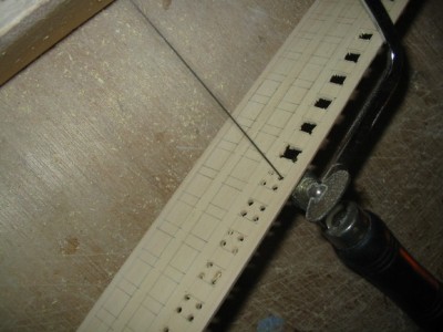

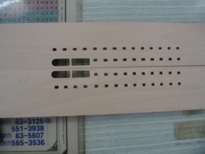

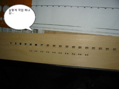

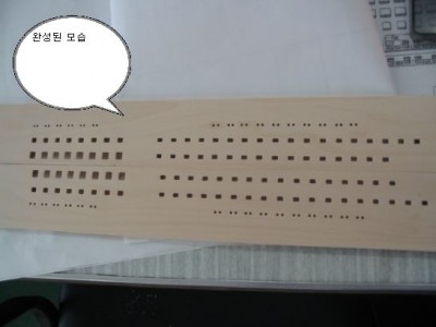

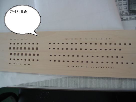

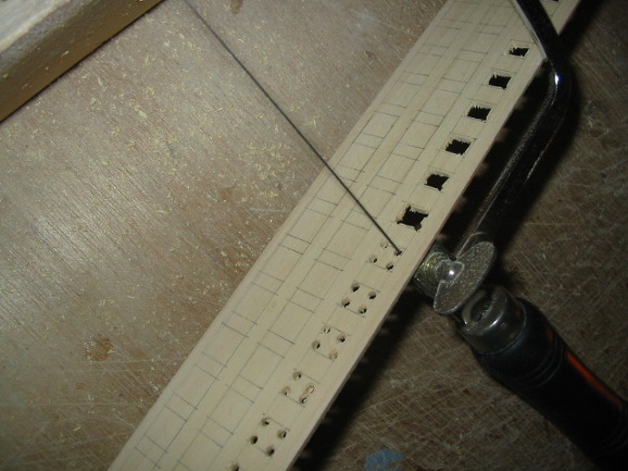

How did you make the windows in the chipboard? Punched them out with a chisel? Or did you use a scroll saw?
Great progress so far, smooth curved and smooth surface on your stem and stern!
The merchant shipyard
Song Jung Gun
Posts: 1631
Neptune wrote:great wood working skills you have!!!

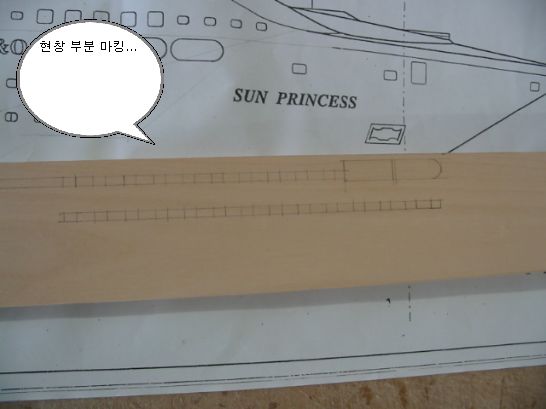

I made windows: 1.Mark on the chipboard by pencil. 2.Drill the hole on the corner by pinvise.
3.Sawing by copingsaw. 4.Grind the shape by small file...
Almost work done by hand.

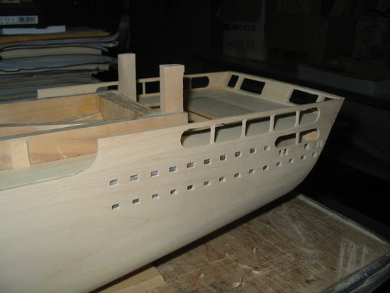

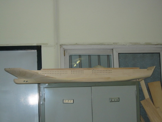

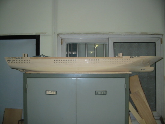

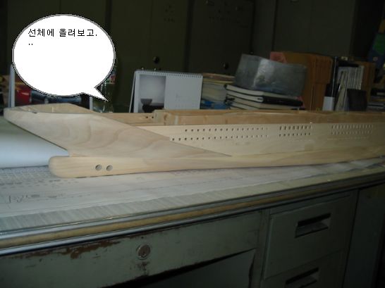

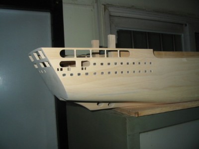

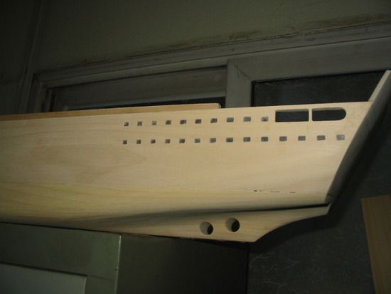

Song Jung Gun
Posts: 1631

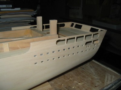

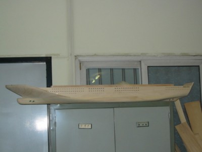

next step... attach side chipboard on the hull and stern. It appear almost ship's shape..

Looking great, pleased to see you're including the stem/stern directional prop's.

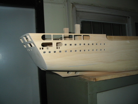

Song Jung Gun
Posts: 1631
Next is 7th(?)deck...
