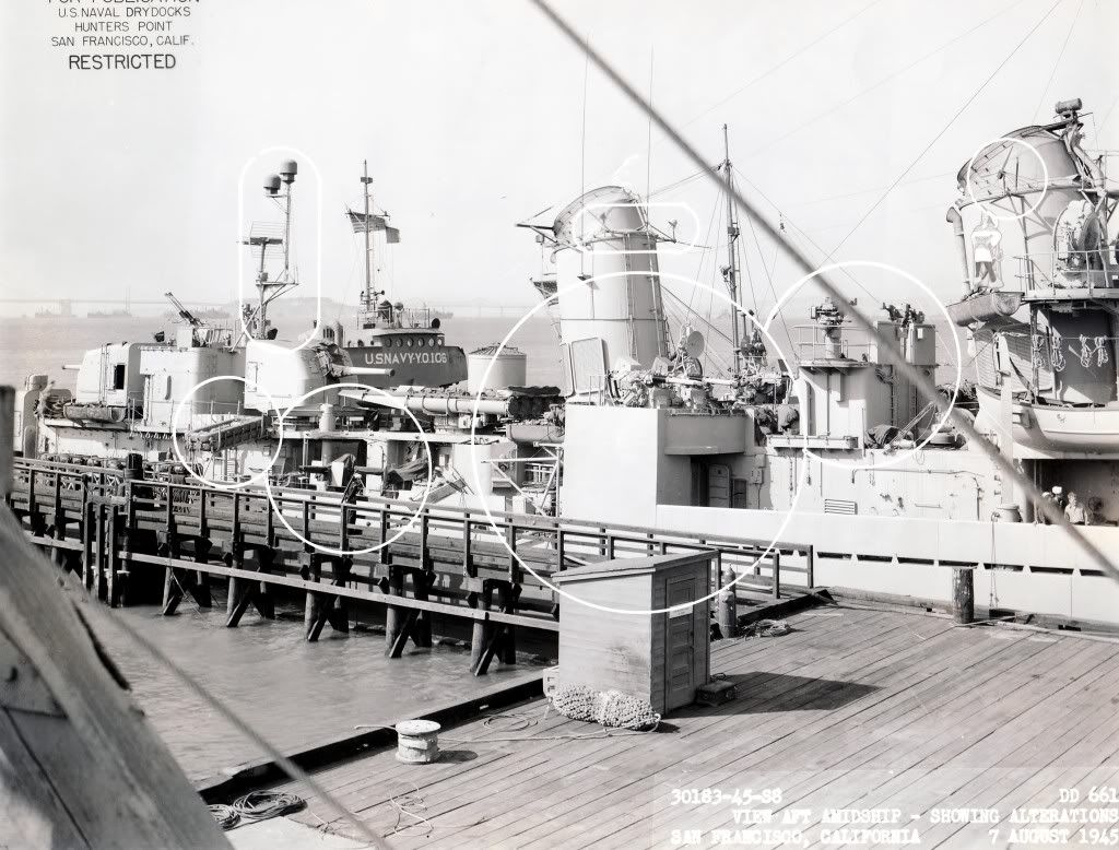

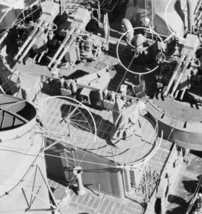

You are off to a good start, but I have noticed something you may want to consider changing at this scale. The bulwarks for the quad mounts had a different type of storage for the ammo clips. Initially they had bays with three "bins", which were then increased to four bins. KIDD had four bins per quad mount. The bays were formed by extending the bulwarks outward following the same arc as the bulwark to accept the the bins. I suspect that these "bins" were made as standard and common standalone units and were installed on the ship
I discussed these earlier and included images on these pages on the "Calling all FLETCHER Class Fans".
KIDD (DD-661)
viewtopic.php?f=49&t=8105&start=260
A three bin unit is shown here
viewtopic.php?f=49&t=8105&start=320
The images referenced.
KIDD (DD-661)
HOWORTH (DD-592)

Hey Rick thanks for the advice on the quad tubs. I reworked them according to the photo you supplied. I was able to get three bins in but four did work out right. It will be a little off on accuracy but I do think it looks more like the photo. I'll try and remember to get some photos up when I do my next update.
Thanks again for the help.

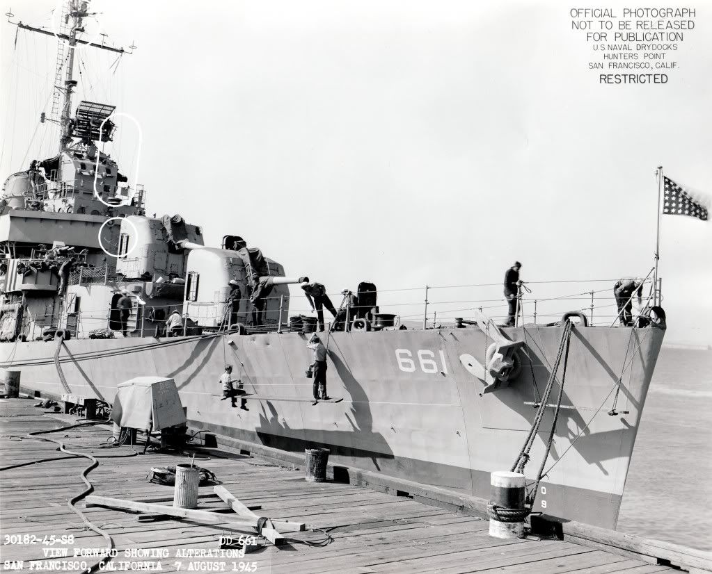

Good work. But, you need to use the lower Mk 37 director for the Square-bridge. The conversion set should come with it.
KIDD's sister WADLEIGH (DD-689) prior to the Anti-Kamikaze MODs, but the bridge area back to the first stack was pretty much the same.
THE SULLIVANS (DD-537)

I would like to make an observation, in addition to Rick's; the waist 40mm mounts had clipping rooms under them. In the one picture of that area it doesn't look like the main deck bulkheads extend far enough toward the centerline. Look real close at that area in the top picture Rick attached.
Good modeling,
Bruce

Rick E Davis wrote:
Neil,
Hey thanks a lot for pointing that out Rick, I'm not sure how I missed that when putting it together.

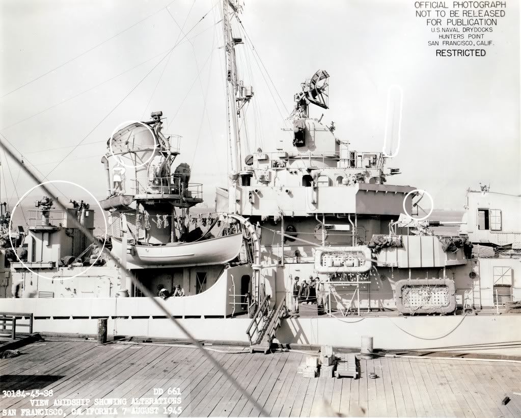

Neil,
Here are images of the real KIDD in August 1945.
PostPosted: Thu Sep 09, 2010 6:41 pm
Joined: Mon Jan 10, 2005 3:05 pm
Posts: 38
Hey Rick, thanks a lot for those photos. I had not come across these before. I managed to get the gun director redone without any problems at all. Just had to be a little patient working the glue loose but it came off fine. Funny thing is I kept looking at it and something seemed off I just didn't figure it out. :P
Thanks again,
Neil
