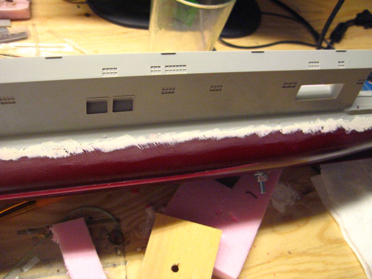

I have take a commission to convert the 1/350 Trumpeter Nimitz into the USS Harry S Truman in the 2003-2004 timeframe.
This time I am using the WEM brass sets for the ship as well as the airwing. There are a ton of details in these sets which are needed to update the kit.

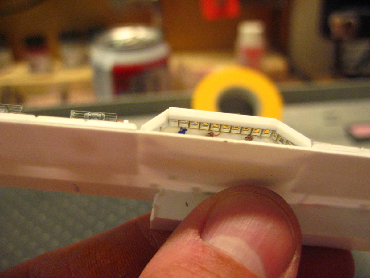

The hangar will be lit like it was on the recent Nimitz build I did, and I have been asked to try to light the island nimbers with fiber optics like Kelly Quirk did on his build of the Truman. I have never tried to use fiber optics, so this isthe only area of the build I am a little nervous about, but it seems pretty straight forward, and I think with some patience and trial and error I should be able to get the lighting to work.

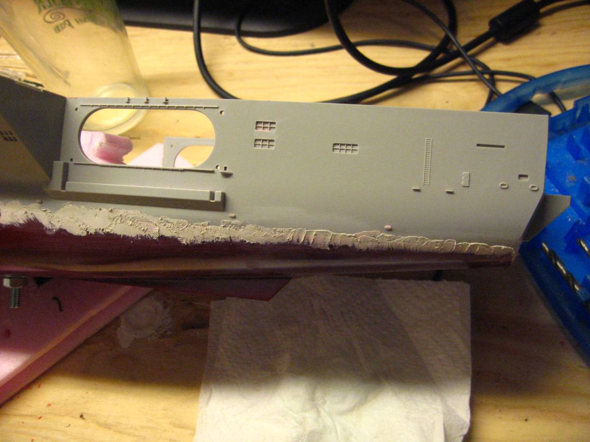

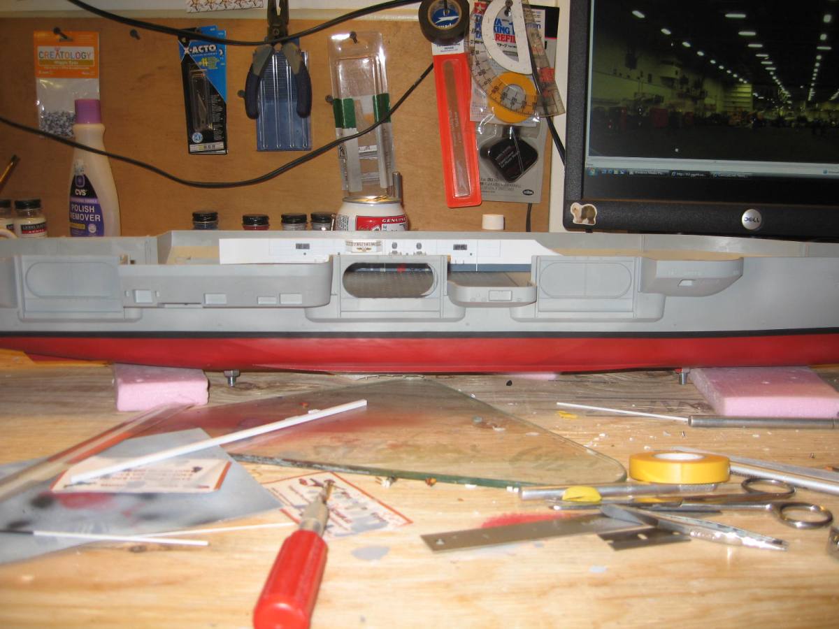

So far I have just removed all of the molded on catwalks to be replaced with the PE ones again, adn begun the basic work on the hull.

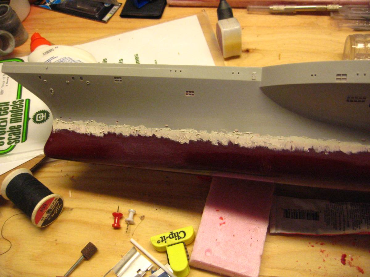

This is the 3rd Nimitz kit I have built, and for some reason the fit of the upper and lower hull pieces on this particular one is even worse than the other 2! It is just terrible. I actually had to go the my dremel tool to sand and grind the 2 halves to get them close to fitting correctly.
LOTS of filler had to be applied to the seam last night, and I am hoping once I sand that down tonight it will be the end of dealing with that seam finally!
lots and lots of filler putty!

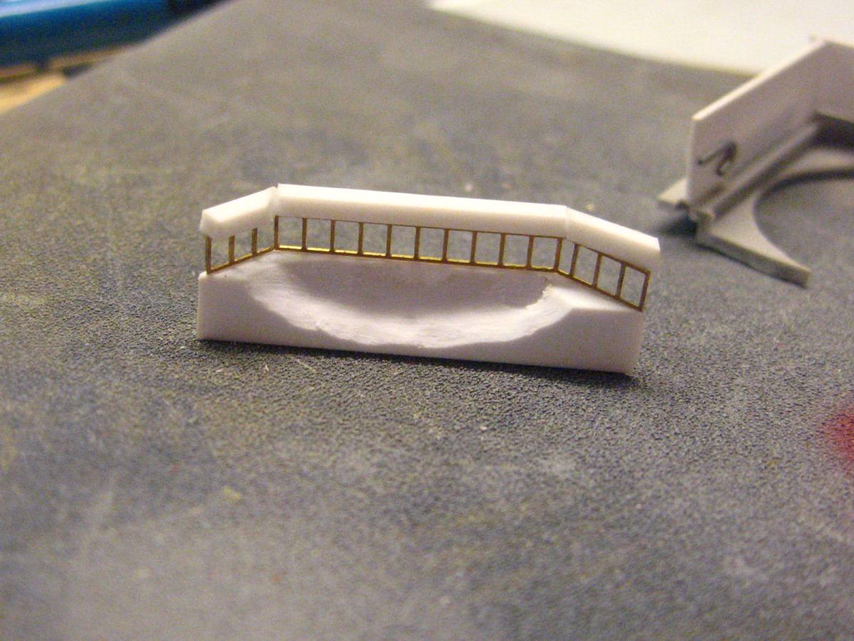

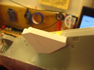

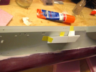

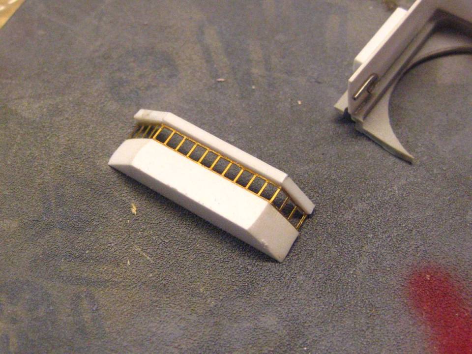

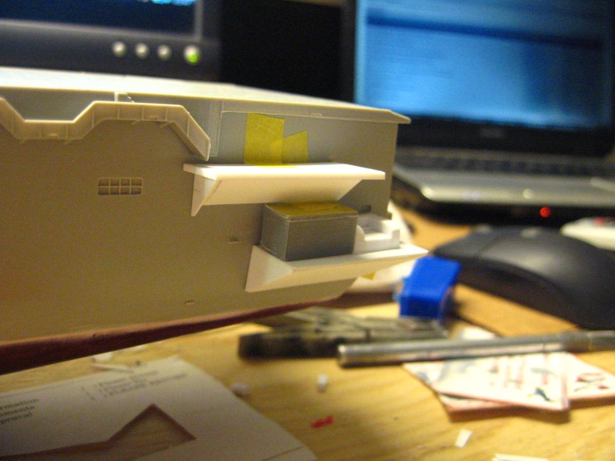

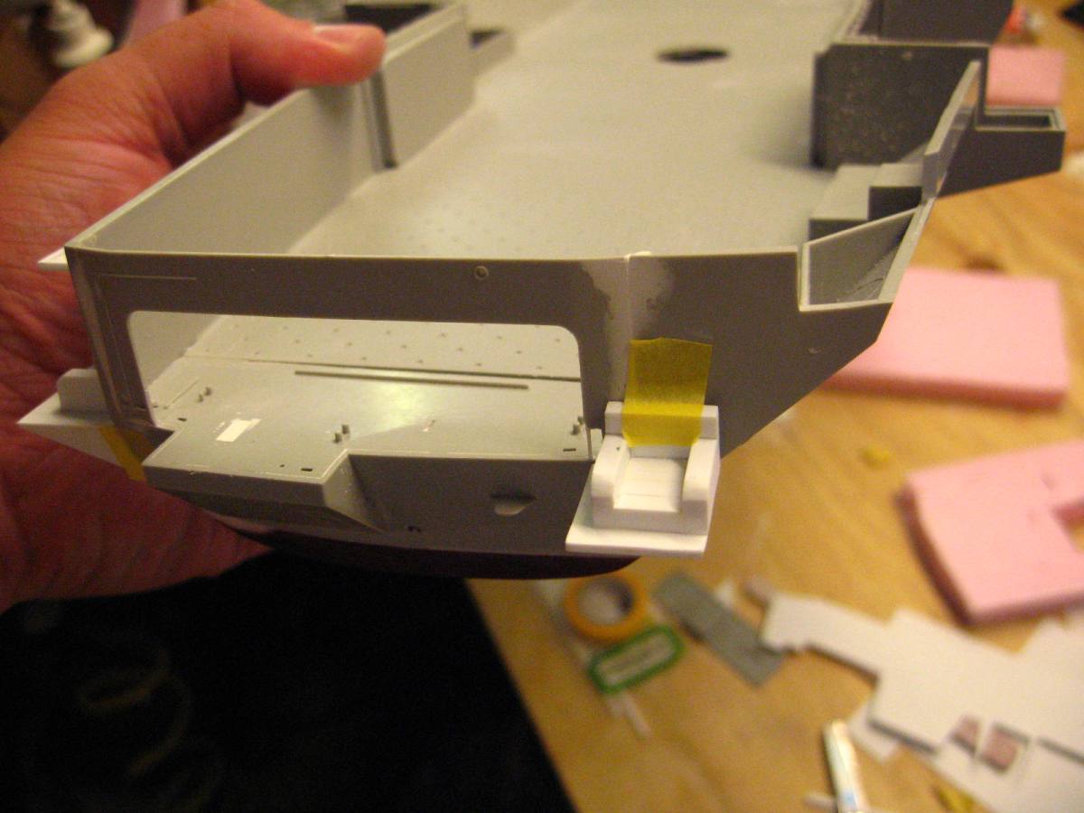

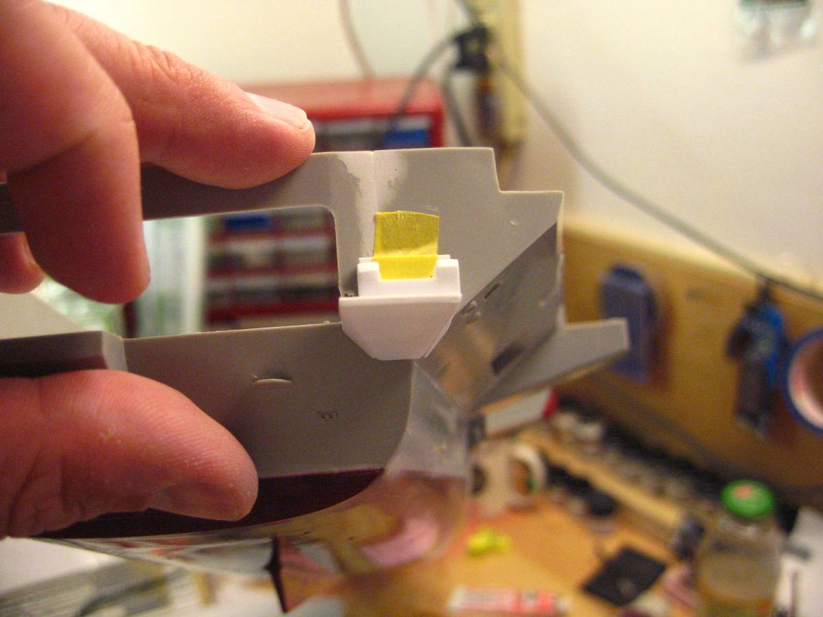

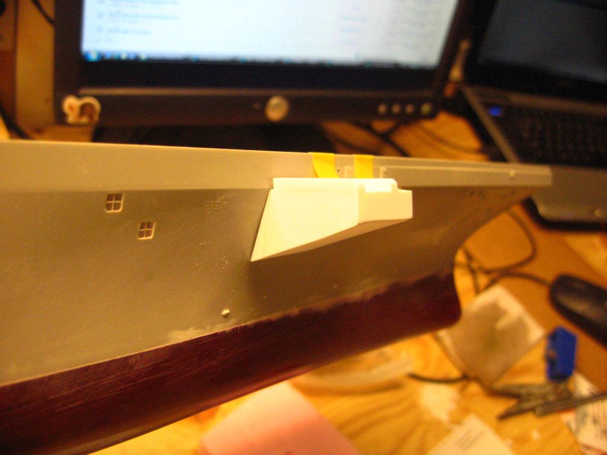

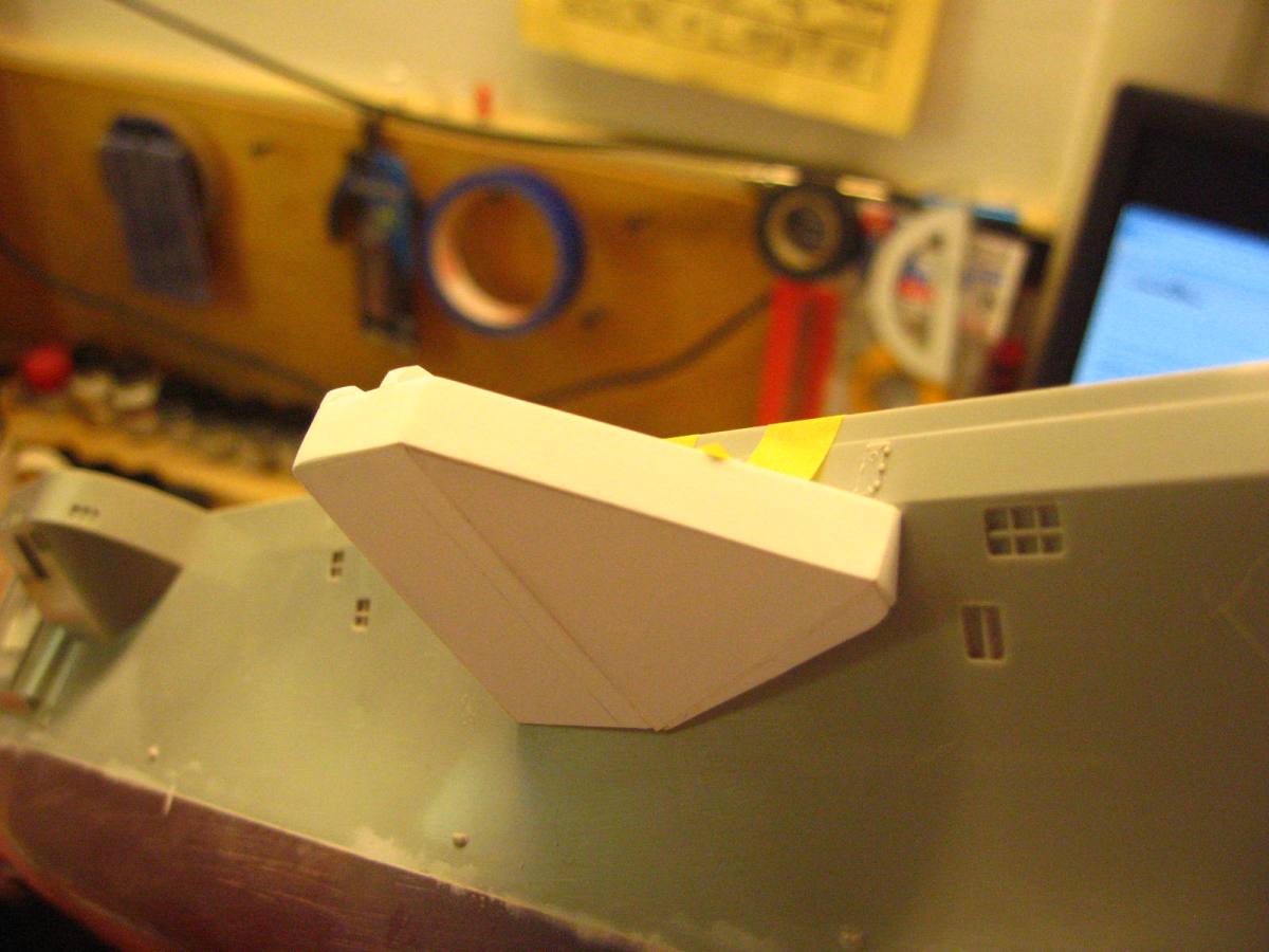

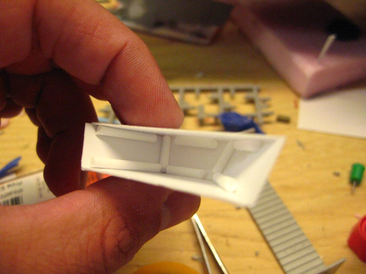

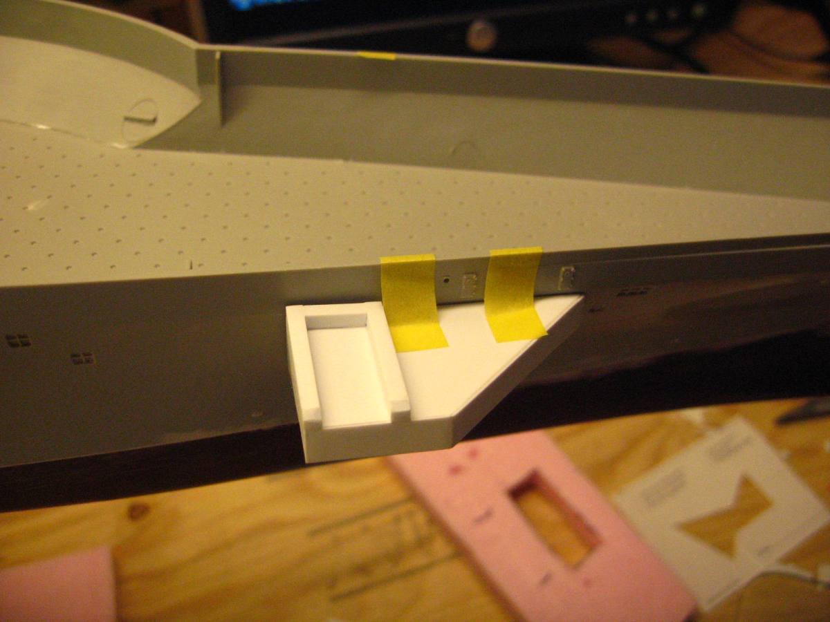

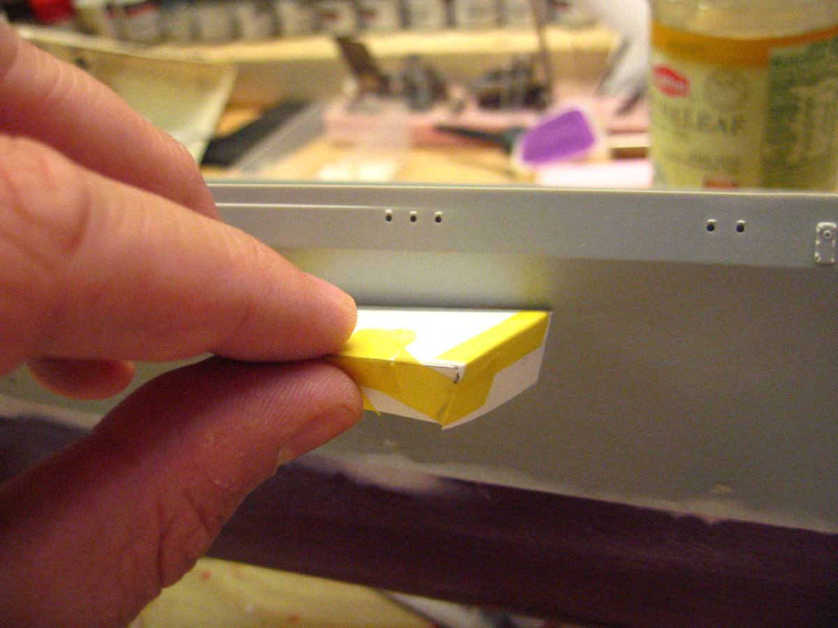

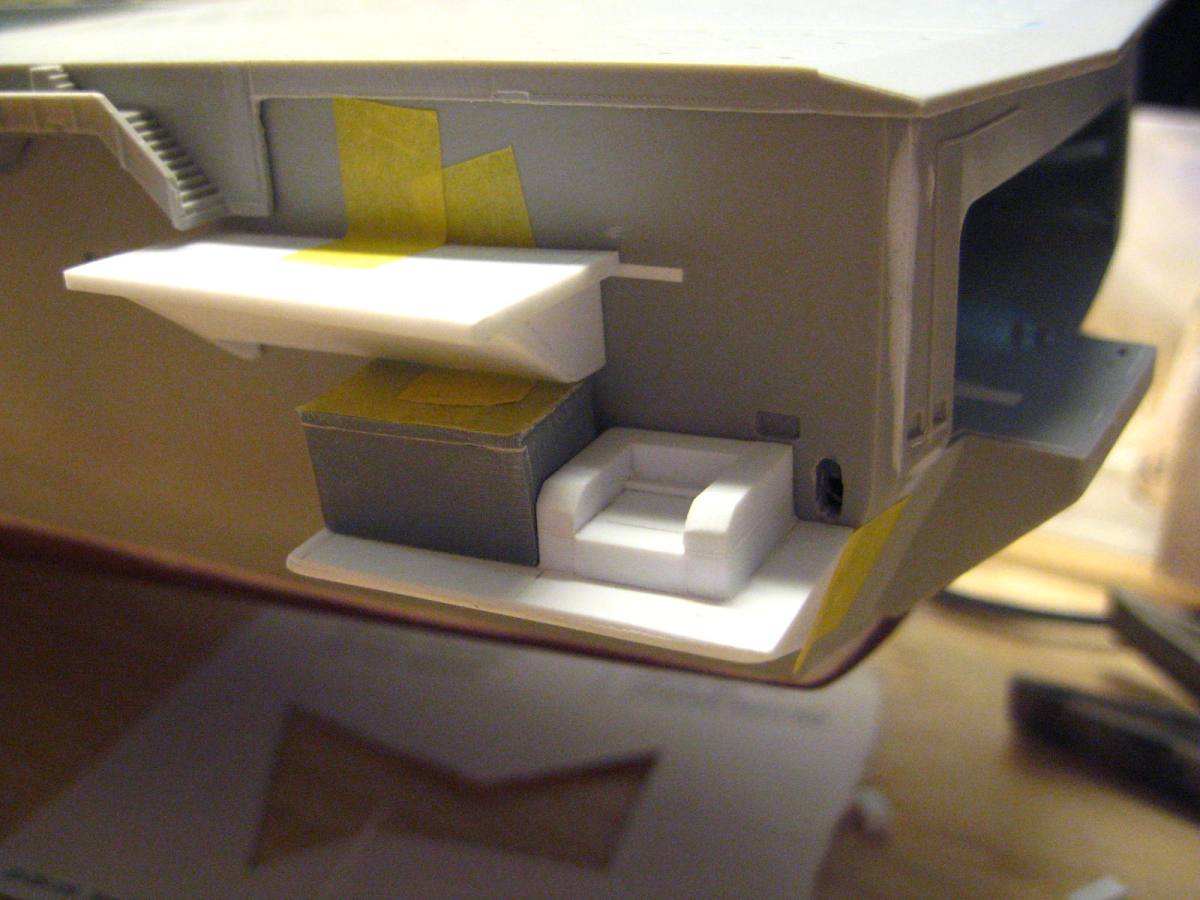

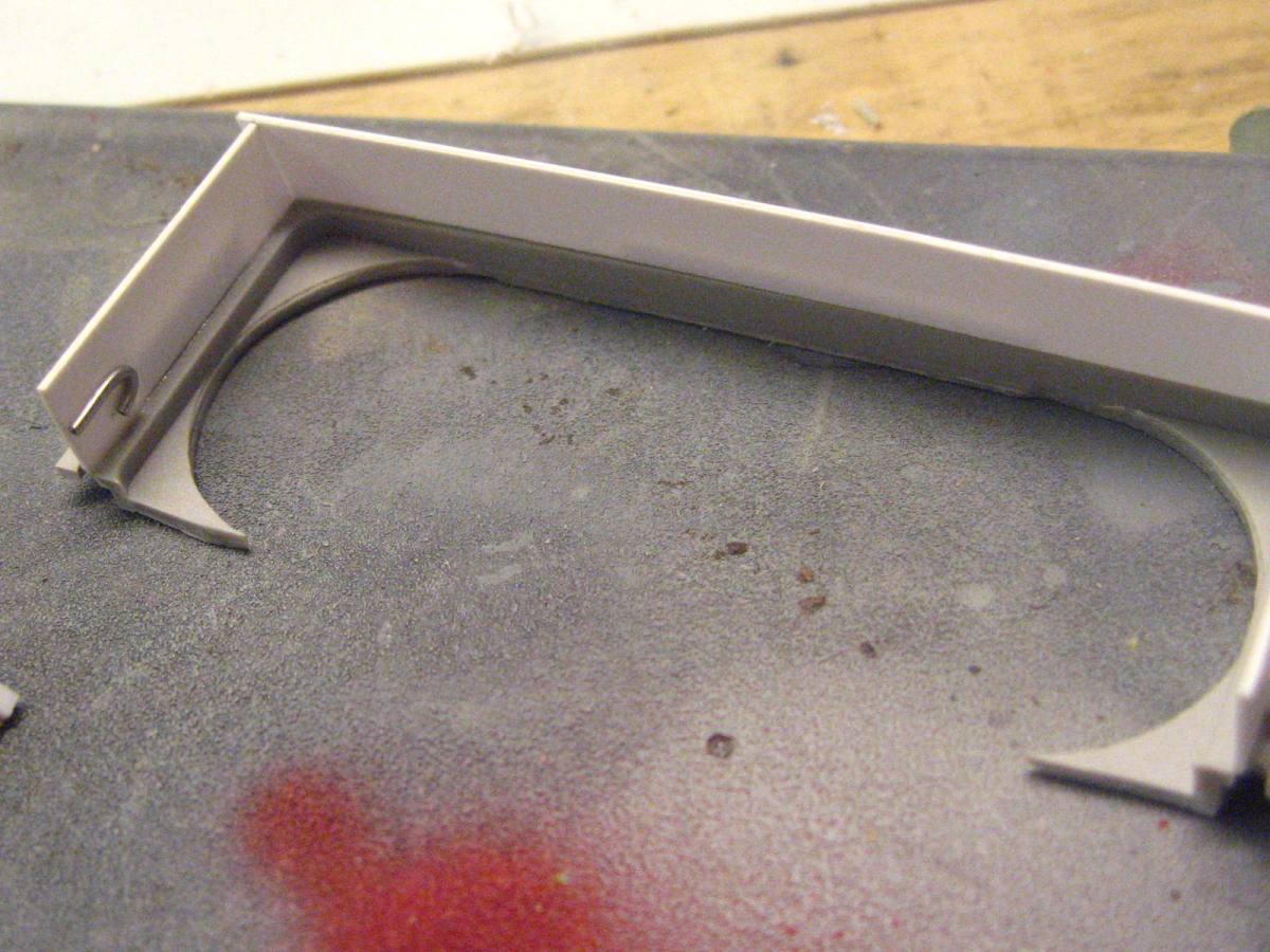

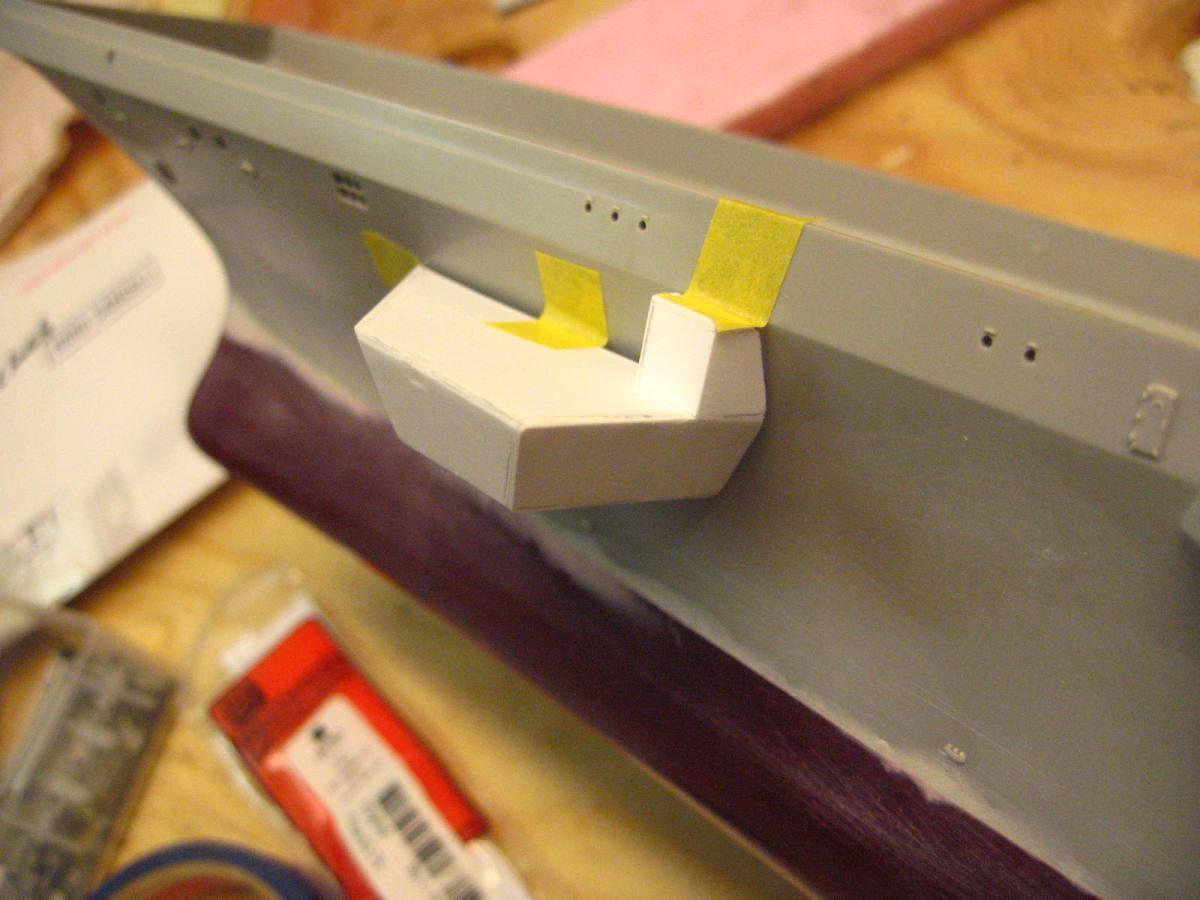

This weekend the modeling gods were on my side, I started to scratchbuild all of the modern weapons sponsons, and I was anticipating a lot of frustration. To my pleasant surprise, this went very smoothly, it still took me about 10 hours of work, but I had very few major fitting problems, and with patience, the majority of the sponsons went together and fit great on the first try!
I made masters of all the difficult pieces which I cut out and labeled on card stock, so if I end up building another modernized ship of the class, I can just use these instead of measuring and fitting everything all over again.
I really must thank Kelly Quirk for all of the pics he posted of his build process, those have been a valuable resource along with lots and lots of pictures from the internet.
I reinforced all the difficult angles with round styrene rod to strengthen joints.
taped and test fitted before any joints are glued.

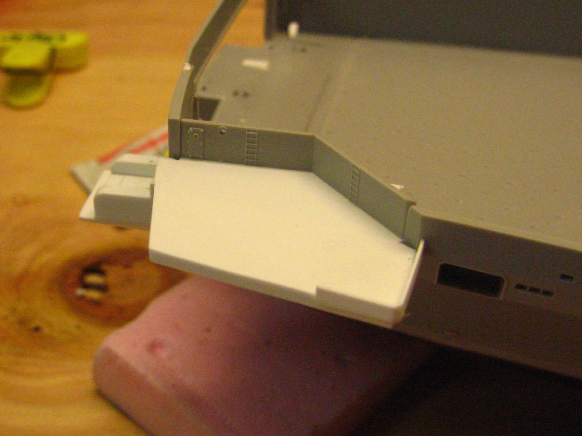

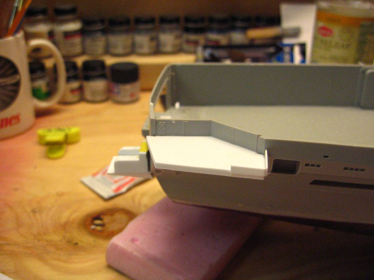

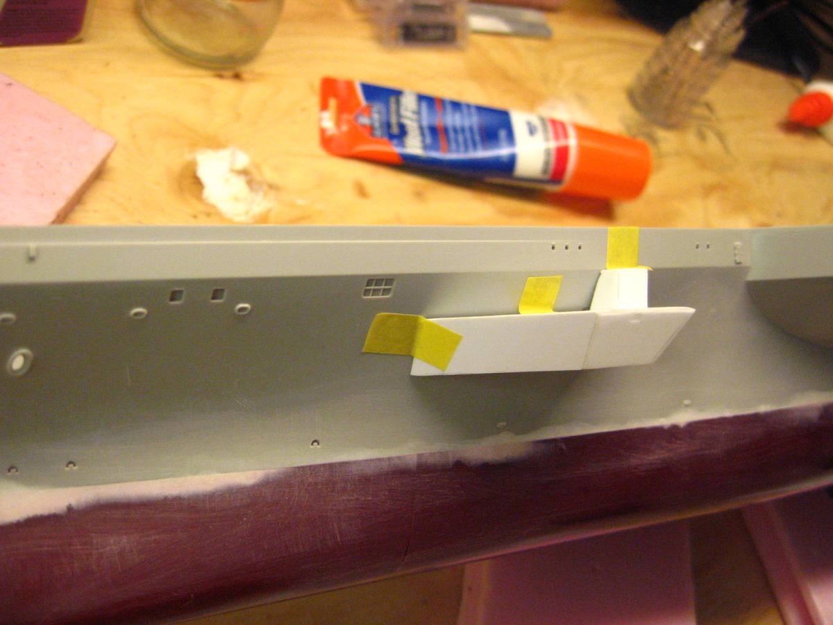

And some shots of the foreward starboard sponson

The fiber optics arrived the other day, so I will be starting on that some time this week, and I will be sure to take lots of pics and detail how I accomplish this (hopefully I will actually accomplish that part anyways!).

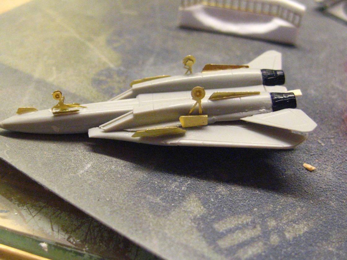

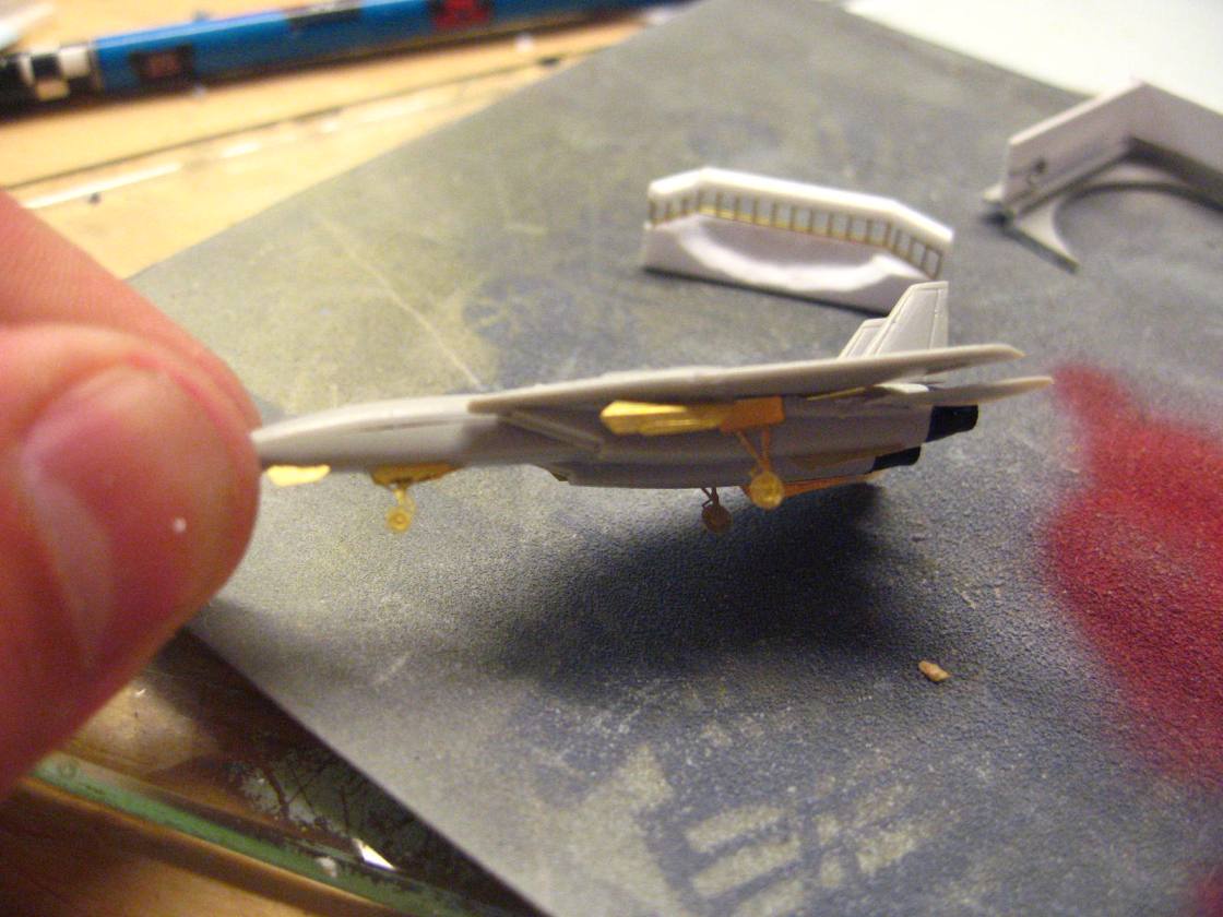

This is the first airwing I have done that is getting the full Photo etch treatment, the others have always been more on the minimal PE side. Holy cow, did this turn each aircraft into a project of it's own! I mean there are a ton of parts to each plane now, luckily this airwing is going to be on the smaller side numbers wise, with only 20 -25 planes total. THe PE is form WEM and it is really good looking stuff, bringing a lot more detail into each plane. I have also begun attempting to make my own canopies whaich are much thinner and clearer, once I perfect that technique I will post pics and explain what I did.

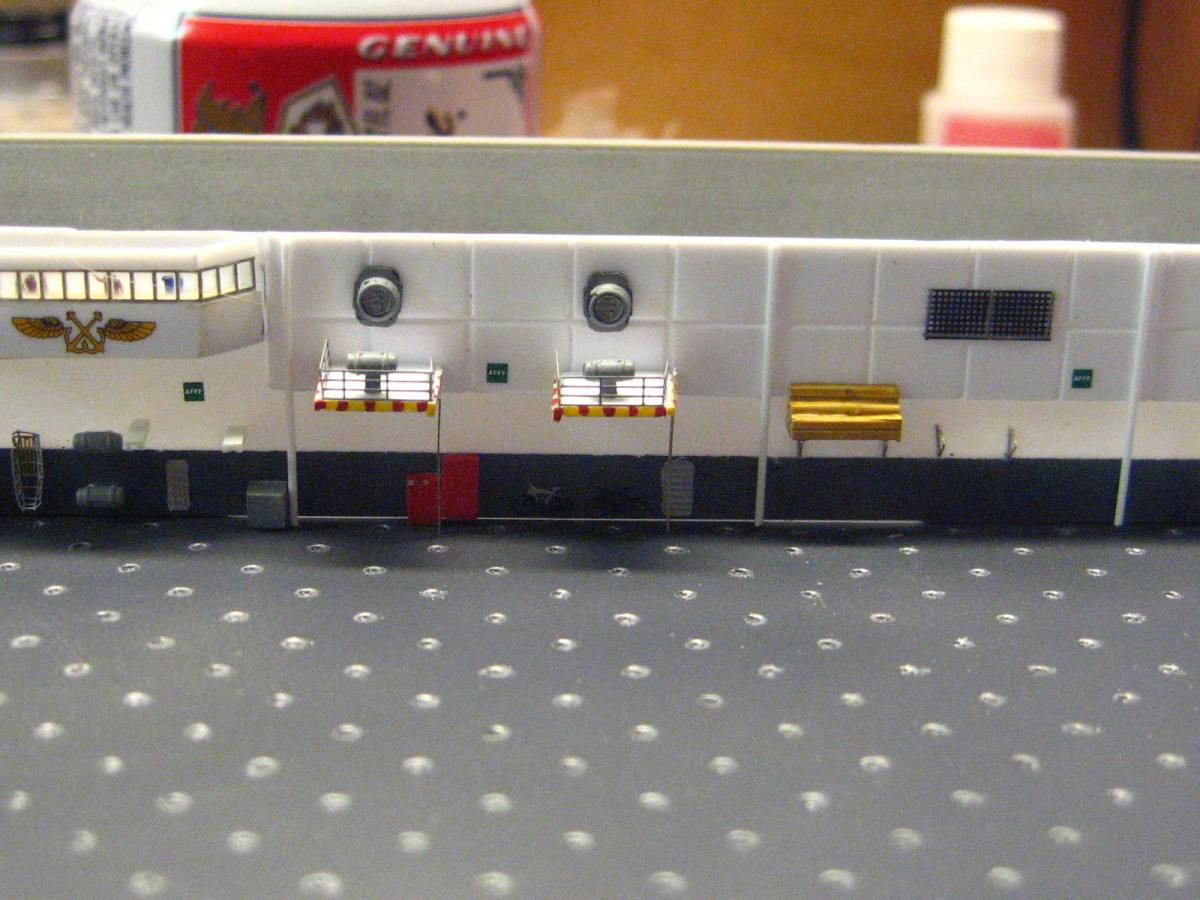

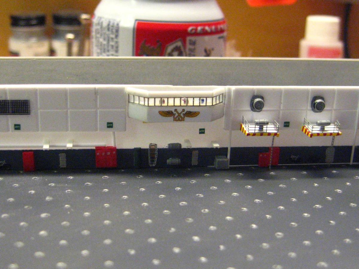

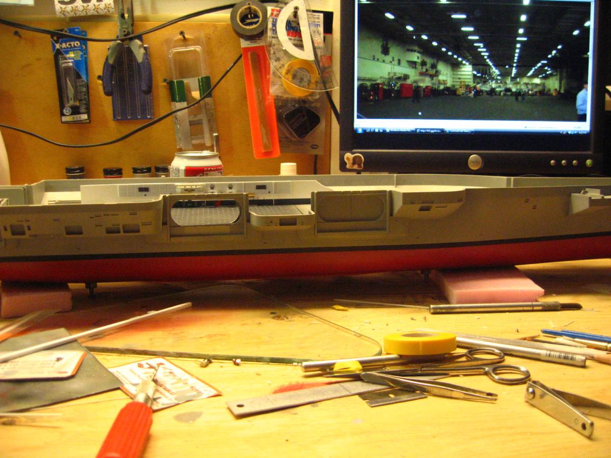

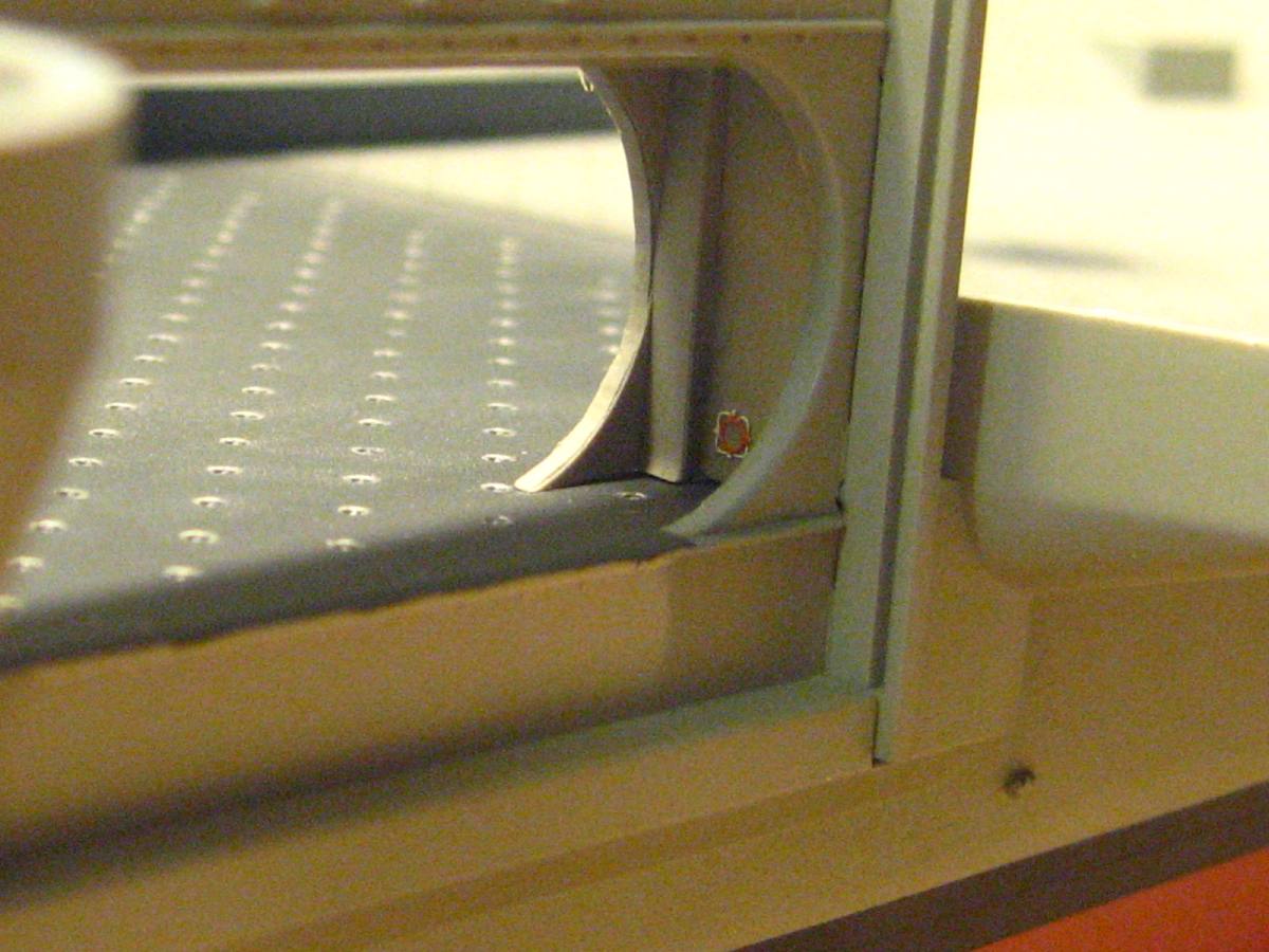

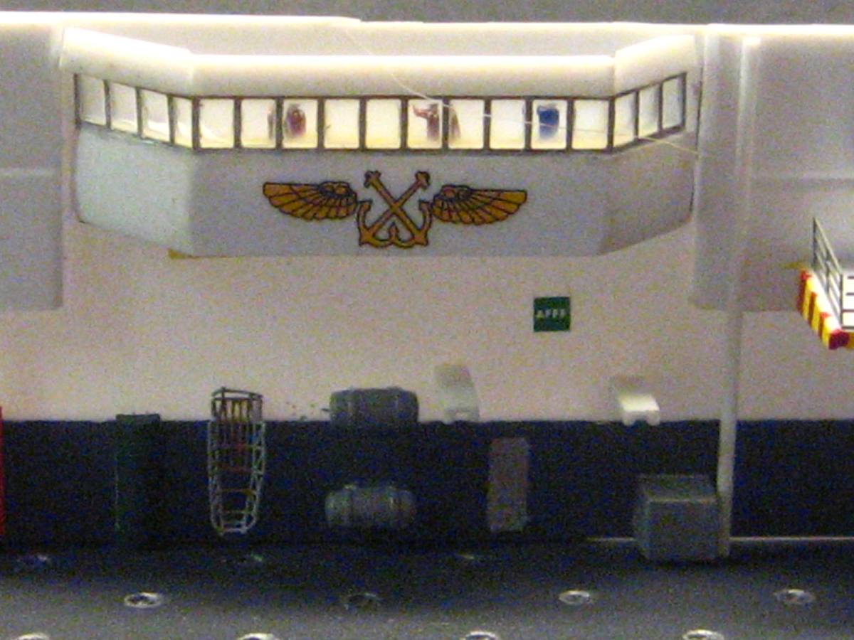

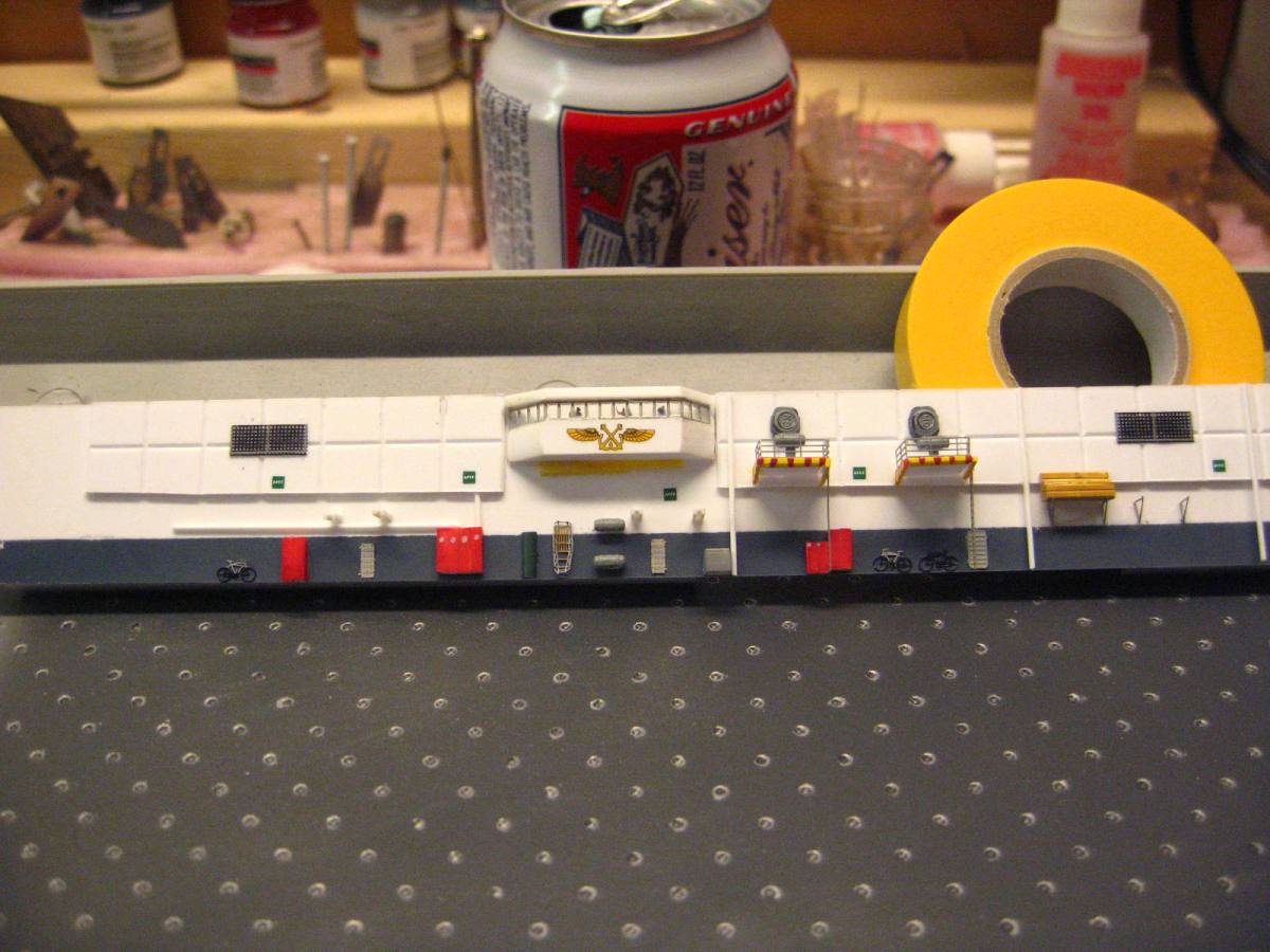

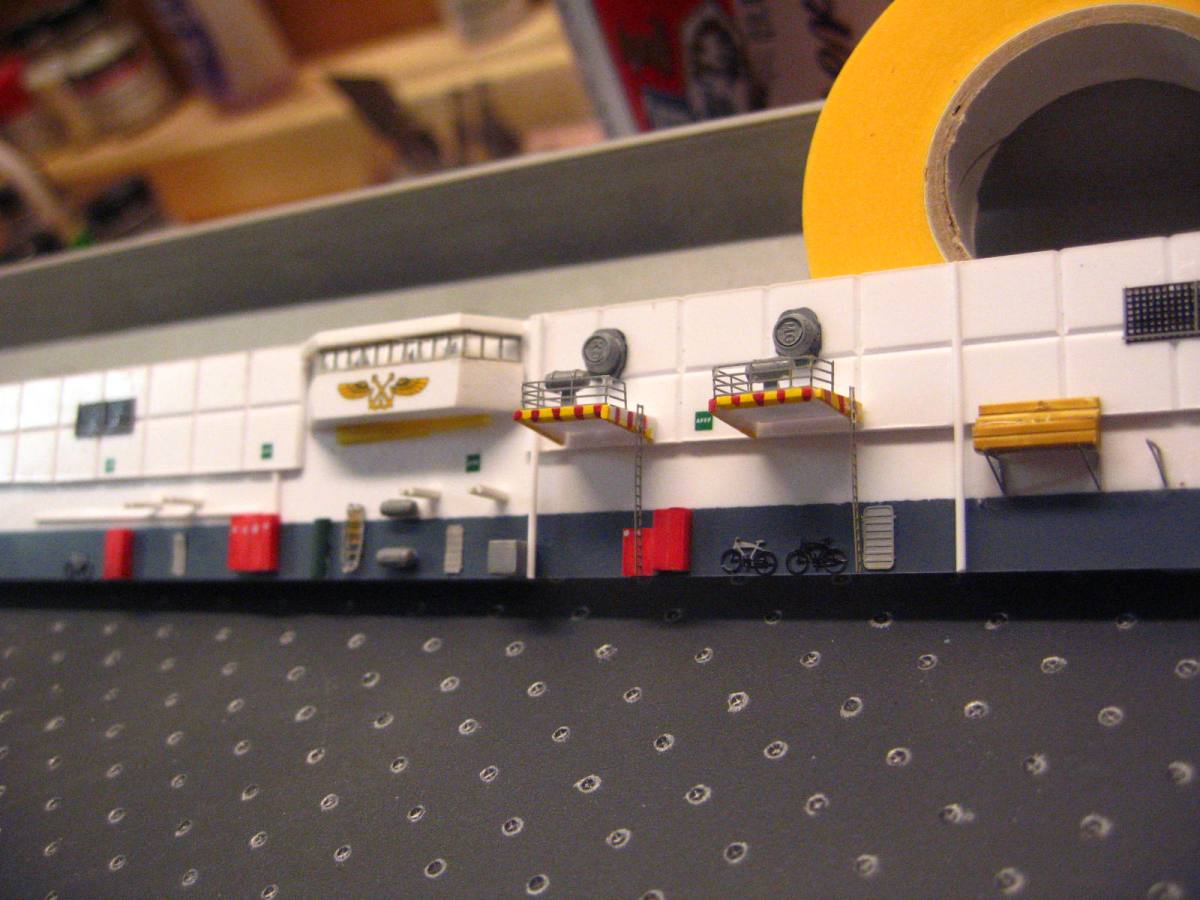

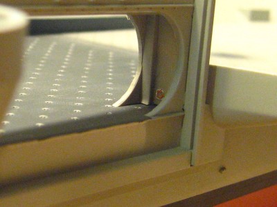

I have begun some of the hangar details, I decided to make the control area hollow, with 1/200 ladders as window frames, I plan to put a few crew members in there and light that up as well, I think it should look pretty cool!

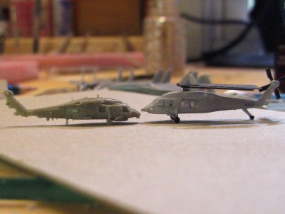

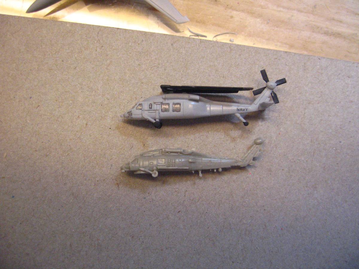

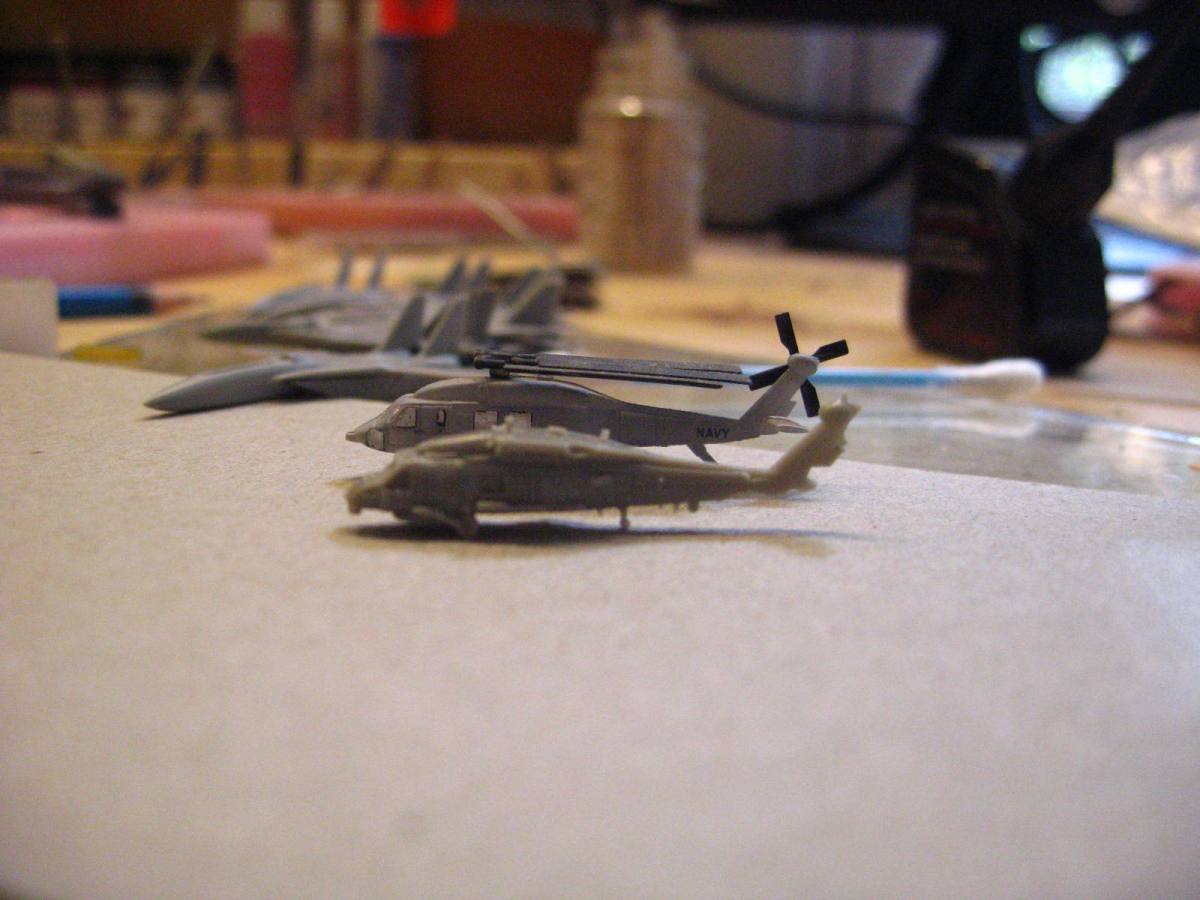

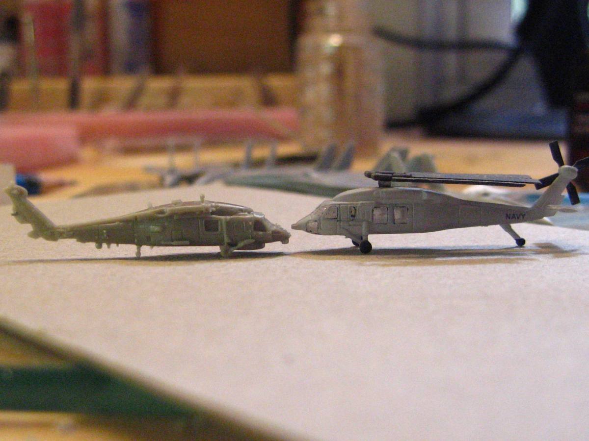

Also below are a couple shots of the Veterans Models seahawk next to a trumpeter one just for comparison. I had never seen tthe two side by side, but the veteran one is way better than the trumpy one now that I can compare. Just figured others may find the comparison helpful!
trumpy vs. veteran= no contest
Hangar control area (i have no clue what it is actually called!)
I am going to add crew and lighting in here and glaze the windows.
inner elevator door frame from scratch and hollowed and trinned kit leftover closed door.
WEM photo etch adds lots of details
tons of PE parts make the aircraft projects themselves!

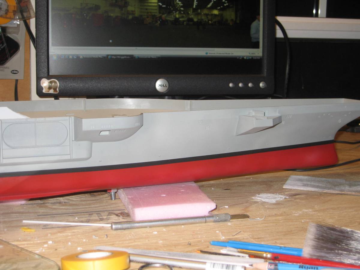

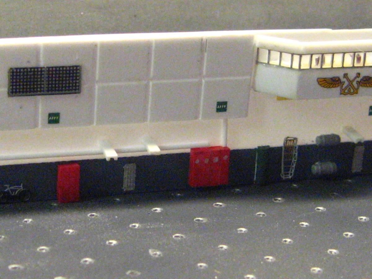

I got the hull painted, have a few areas that need a little touch up, namely the stern, for some reason, I had terrible paint adhesion on the stern, a lot of the paint and primer lifted off for some reason after masking, even though I prepped it the exact same way I did for the rest of the hull.
I got a lot of work done on some hangar details, I found a pretty decent pic of the stennis hanger on google, so I used that for a reference for details. All the hangar details are scratch besides the hatches and windows for the control room. I tore apart an old cell phone for a few of the details, and the rest is styrene or bits from the spares box.
The control room will be lit, and the figures are visible.  Windows are clearer now, the glaze was still a little wet for the pic.
cell phone bits and spares and styrene.
This is a little overscale I think, but I wanted details to be seen.
inner door details
inner door details
There are 67 different pieces to this section of bulkhead!
I don't see the need to go insane by adding an interior that won't be seen!

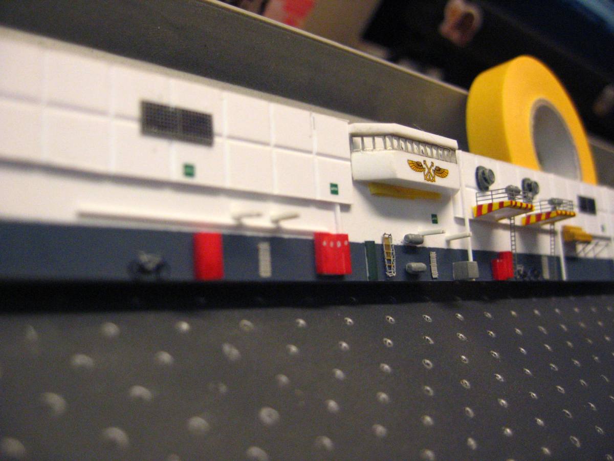

overall with the hull painted, plating detail will be added soon.

A couple more of the paint job, and I forgot to mention my most trusted tool in the background, my modeling partner if you will, an ice cold budweiser!

Good work, fun to watch this build. Remember to remove the flat dome between the landing gear on the SH/HH-60s. The carrier versions do not have this. The clear plast HH/SH-60s that Trumpeter makes sets of, the landing gear stand the aircraft way to tall. If you put an SH/HH-60 up on a stick hovering above the deck or next to the carrier, then the landing gear is much more realistic in height. My Trumpeter SH/HH-60s have a different tail landing gear than the ones you pictured there, which set are they from?
http://www.f-16.net
http://www.c-130.net
Building:
1/48 Lancaster (HK)
1/350 Akagi
1/350 IJN Kongo
sgtryan13
Posts: 2649
Location: Connecticut, USA
Re: 1/350 USS Truman Conversion
Post by sgtryan13 »
Jon, thanks for the tip about the round dome on the chopper, I honestly had no idea!
I am almost certain that my seahawk from trumpeter is the "Knighthawk" varient that they sell. I really was not too concerned which variant I had when I bought them, I just wanted any seahawk version, and the Knighthawk was the cheapest deal I found on ebay.
