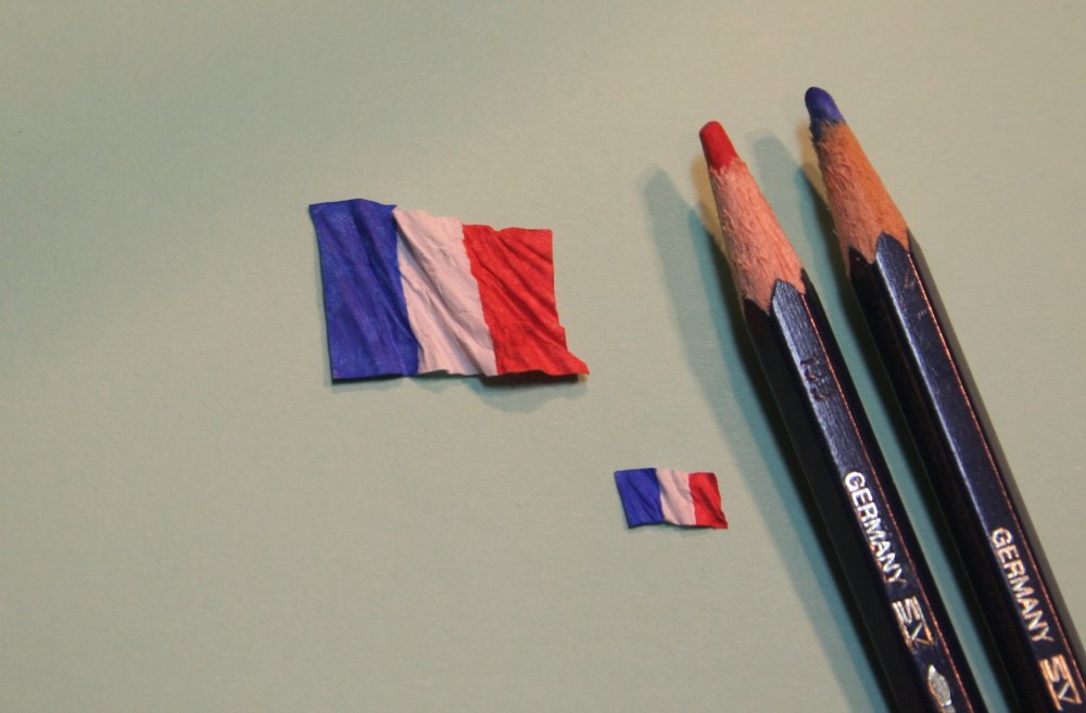

 Post subject: Re: Airfix rescue launch
PostPosted: Thu Nov 25, 2010 4:38 pm
Posts: 5567
Well now, time for Artist fraser....
here is what I would do in that huge 1/72 scale of yours ...
I love paper for making flags...( good medium for painting on..!)
1) get 2 x small union jack decals ( 1/700 should do it- maybe 350...? )
2) get 2 RAF roundels decals in appropriate sizes ( ship decal sheet--left overs from your aircraft building)
3) apply decals to paper flag, seal with matt varnish and using watercolour paint the light blue--should give a pleasing translucence....
4) when dry, insert flag twixt tissue paper and crinkle using tweezers--the tissue paper will soften the radius of the bending and prevent the decals cracking
5) Varnish again to prevent moisture ingress and give permanence
Voila!-
Flags in paper...
see below
Cheesr
Jim Baumann
PostPosted: Fri Nov 26, 2010 6:49 am
Joined: Mon Oct 10, 2005 1:28 am
Posts: 136
Location: Portugal
Voila!-
Flags in paper...
see below
Cheesr
Jim Baumann
Nice! For some reason I wasn't thinking about painting, d-oh. I once had a precious roçç of drafting linen for sails etc. Lent it to a 'friend' to cut a couple of sails. Never got it back... it would have been brilliant for this, however... I have paper I have paint and I'll give it a go - though I ordered a decal sheet from Cornwall model boats...just as a back up y'understand.....
Thanks for the tutorial, as always, spot on.
