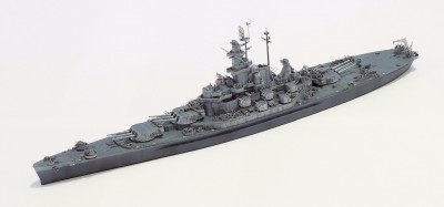

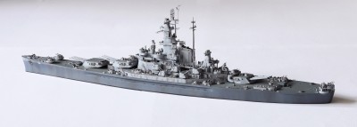

The current state of the build. The core is finished and I just installed the secondary battery, the Mk 37 sights, most of the Bofors and some other details.
More to come.

That looks sharp!
PostPosted: Mon Nov 07, 2022 2:34 pm
Posts: 5060
Very crisp construction!
Best regards: Tom
PostPosted: Mon Nov 07, 2022 7:10 pm
Posts: 1952
Location: Stockholm, Sweden
Crisp is the right word! I will follow this thread with interest as 1946 version is not something I want, but I do have this kit and 1944 sounds about perfect!
You kept the original kit 16in gun houses?

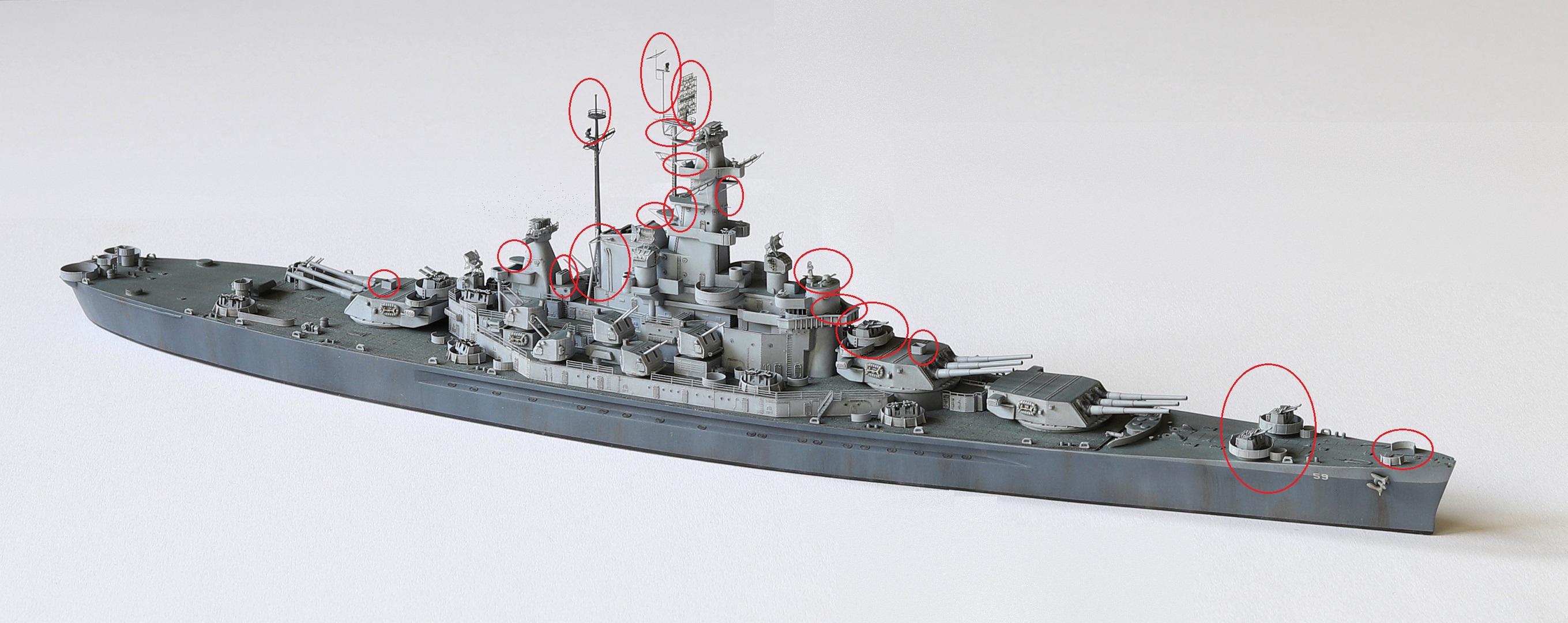

Pavel, the backdating / scratchbuilding basically includes the following:
- Slightly different emplacements for Oerlikons on the bow
- Two Bofors quads on the bow
- A Bofors quad on a top of the Turret 2
- Boxy stations for Mk 51 directors on a top of Turrets 2 and 3
- An uncovered bridge in front of the conning tower
- An Mk 27 radar and a rangefinder on a top of the conning tower
- Different arrangements of the forward superstructure front side
- A different or custom bracing / supports all around the forward superstructure and the foremast
- An SK radar
- A different mainmast including the top arrangement
- A custom bracing / supports of the mainmast
- A third flag locker in front of the rear superstructure
- A platform hanging from the rear superstructure
I might forget something though.
And yes, I used the original 16in turrets. In fact I was not aware of the dicrepancies. Had I knew before, I would probably switched them for Model Monkey's. Too late now (facepalm).

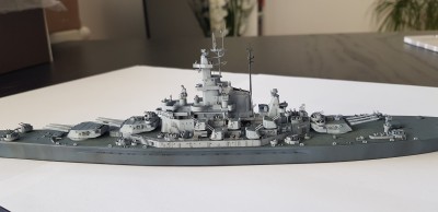

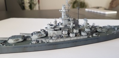

Some small stuff added - most of Oerlikons, Mk 51 directors, Carley floats etc. are in place now.
More to come.

The washes around portholes on superstructure pyramid up top look a little too exaggerated and stick out as if the ship is carrying badges or something. I just thought I point it out as level here is pretty damn high, please dont take it the wrong way. :)

You are damn right, Pavel! :big_grin: However, I don't know if I am able to subtle the effect a bit without messing all around as they are already under a coat of the flat varnish. I try to figure out something... and if to no avail, at least I will be more careful next time. ;-)

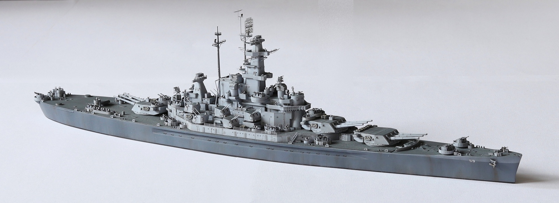

The entire AA battery is in place including ammo boxes for Oerlikons and Mk 51 directors for Bofors quads.
More to come.

A lot of DAP's (Dinky, as parts) there! What I want to know is where you get those 6" long match sticks for comparisons? Scratch built? Very nice building at a small scale!
Best regards: Tom
PostPosted: Sun Dec 04, 2022 3:49 pm
Posts: 8816
Wow. Looking really nice now.
PostPosted: Sun Dec 04, 2022 5:43 pm
Posts: 8339
Yes, she looks sharp. I always thought these were the best looking USN fast battleships. They certainly looked the part.

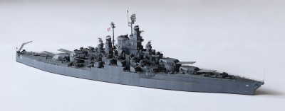

A core of the rear crane placed. More importantly, I tried to apply a bit of dry-brushing for the first time and fortunately it went quite nicely.
In addition, this build brought me among the members of the "scale effect" gang and I am definitely staying there. I added approx. 25 % white to the 5-N, 20-B and black paints and the overall feeling is much better when compared to using non-lightened paints. As much as I was happy with the Washington build, I cannot say it anymore. I will post a couple of comparing photos and the BB-59 is a winner of these by a mile.
More to come.

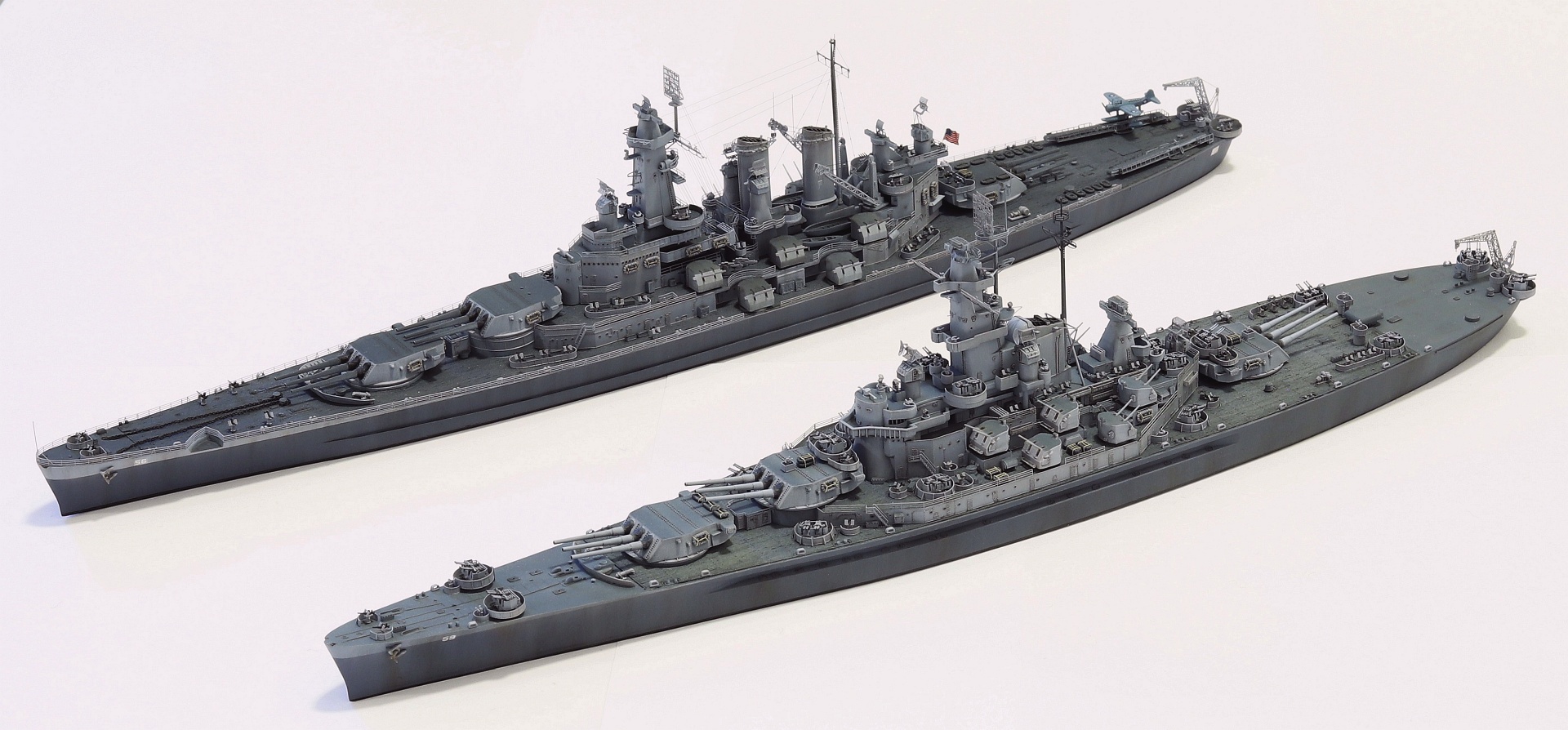

There is the comparison. While there is nothing inherently wrong with the Washington's camo, the 5-N and 20-B just seem way too dark for me and the contrast is too intense for my taste. Massachusetts just feels more "natural." However, it's a purely subjective point-of-view, of course.
I decided to "expend" the previous build (USS California) to find out whether this situation can be remedied. I was somehow able to subtle the overall darkness with a coat of very thinned 5-H all over the ship and applied some drybrushing then. I screwed only the port halyards so the price is rather low. I will build her once again in the future probably, however.

Very nice work!
I think you lightened the camouflage colours just to the right degree.
Very crisp details everywhere and subtle weathering make this model stand out.
The older ones are good as well, but one can surely notice your skills developing.
