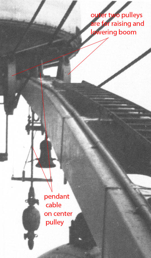

The smaller boat cranes ... I'm not sure about three PE pulleys on the end of the crane boom ...

Here you go on the small boat crane, Olaf.

Thanks Olaf. That's weird, the pictures not showing up. I didn't mean that the PE pipes are missing, just that the instructions are unclear on the correct way to shape them.

Thanks for the clarification on the (not) missing bulwark K73 and the (not) missing platform L24. We could make a contest out of this, just cut off all the parts from the trees, throw them into the box, shake it well and then build the kit, HA! :big_grin: (or we should make your build log sticky for all future Scharnhorst builders ...)
@ Rob ~ Thanks a lot, now it makes sense!
