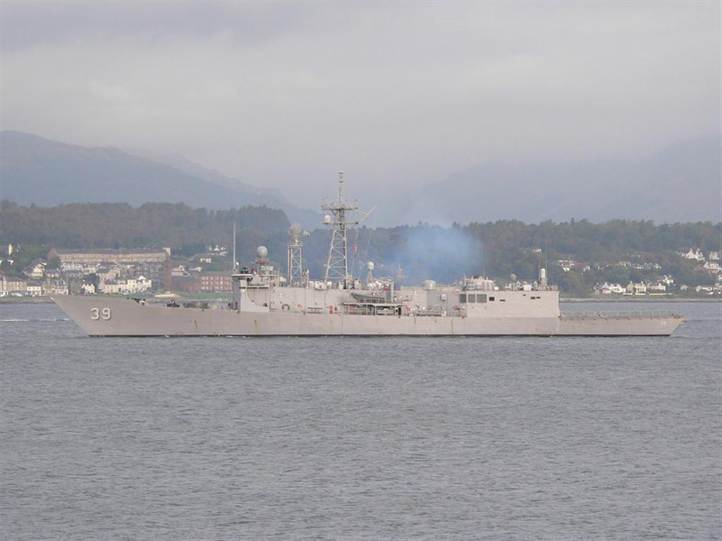

Small update:
Working on adding detail to the port side.
File comment: This is the newest photo of Doyle that I've been able to find, 2005. Since that time I think she has had an update to the SLQ-32ECM. A new sensor box has been added to the bridge wings and the life canisters are stacked.

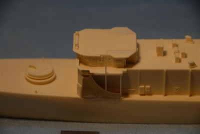

Couple more shots:
File comment: Chiseled off the bulkhead hatches so to relocate them with photo etch. Also added hood intakes and conduit and a boom.
