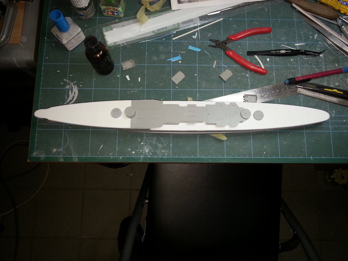

Going on with my work in progress on the RN Pola: :big_grin:
After correcting the hull shapes, I went back to the blueprint I had: both the main turrets A and D seems to be misplaced: I moved both of them about 0.5cm respectively to turret B and D. The original ship had barely enough space to rotate the lower turret without hitting the cylinders on which the raised one were placed
I had bought a wooden deck for this ship some time ago but I had to discard it since the turret were pre drilled on it in the wrong place and, furthermore, the deck adhesive wooden deck is far to short compared to what it was on the original Pola: it looks like the producer has copied the error on the Hobby Boss kit without putting too much thinking on what it should have looked.
The main superstructure on the kit is misshaped: I added the main tripod, delete the three ridges around the funnel and the main bridge tower and corrected several problems on the upper decks.
One of the problems with this ship is that it changed a lot since it's launch in 1930 to it's demise in 1941: several parts oft the superstructure were changed or added, and for this reason it's required to double check each photo trying to determine when they were taken. My Pola will replicate the status of the ship in 1941.
More progress next time :wave_1:

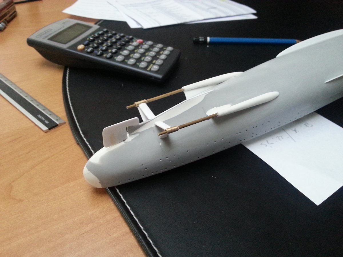

Back, with some news. I rebuilt the whole propeller area of the Pola trying to make it look like one the Luce "Pola Ship Launch" video as much as I could.
The real thing are much larger then what can be found inside the box, so I decided to use plasticard, milliput and brass rods. I'm rather feeling like a sculptor then a kit model builder, but nothing inside my spare box was close to the propeller shafts shape and the way it joins to the keel. I even tried a couple of Mk84 from hasegawa but they looked too fat and generally wrong. The reinforce arm structure joining the shaft near the propellers to the stern was inspired by a hull section drawing coming from Morskie Profile for the Zara sister ship: overall the shape is decent although a bit over angled down (but so is the keel): for now I can live with that. :scratch:
I also rebuilt the anti roll wings trying to get as close as possible to what can be seen in the video and they now look much better then the two ridges moulded on the kit.
See you further down the Pola building road :wave_1:

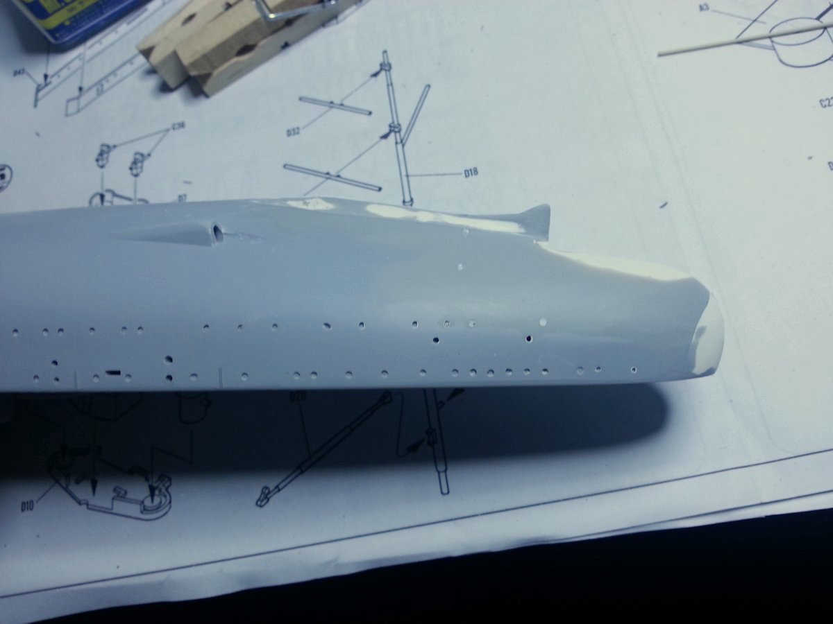

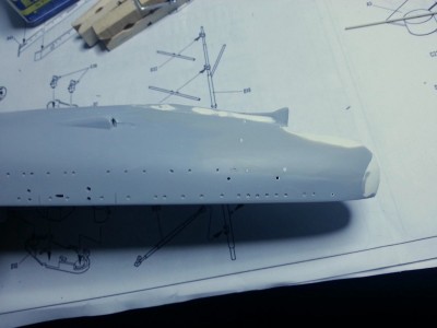

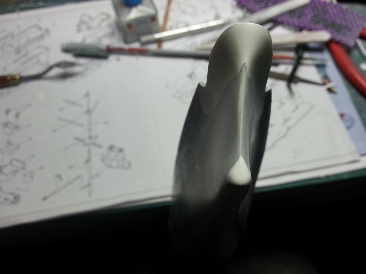

Fast update: trying to simulate hull plating.

For the hull plating I'm using Tamiya spray surfacer medium: I tried to figure out the plating shapes form the usual video "Istituto Luce" about the ship launching and using various ship elements as reference points. this is a good tutorial: ( http://www.youtube.com/watch?v=wCO8mGn7rLw )
Warship Pictorial 23 draw of the top and side of the ship is a very good reference but always double-check for errors, especially on the ship upper decks.
Now I'm trying to figure out the shape of the rear funnel, mostly at the base, where the WS drawing seems to be inaccurate. I'm also trying to carve the deck wood planking since the only Pola 1/350 wood deck is unusable: if the result is unsatisfying I'll probably order a "generic wood deck" and adapt it.
keep in mind that, while the main gun turrets are mostly accurate (you only need to rebuild the telemeter and set the guns closer each other), the secondary gun emplacement are plain crap: I'll need to rebuild one form scratch (not an easy shape to make) and produce 8 copies with resin or something like that: they are out of shape and way too small.
If I had a clue about the extensive problems on the Pola I would have converted it into a "Bolzano" instead: You'd need increase the hull length of about 4cm but that is on the centre of the ship (not an impossible task) but the shape of the hull should be almost perfect. I've seen a very good conversion on this same site (viewtopic.php?f=60&t=151890&hilit=bolzano).
Good luck with your build! :thumbs_up_1:

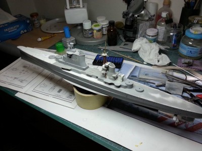

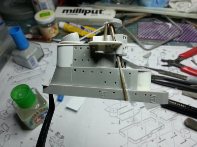

Some (few) progress about the Pola project
I focussed on the rear tripod: unfortunately the photos don't help much as the ship kept changing drom 1931 to it's demise ten years later.
I hope I made something acceptable.
I added some detail on the deck too and the winches are almost ready: I need to cast a certain number in resin from the original I made with a small Unimat lathe.
untill next time ;)
(edit) the rear telemeter structure is turned in the wrong direction! :doh_1: fortunately it's not glued yet and I will set it properly in the next pics..

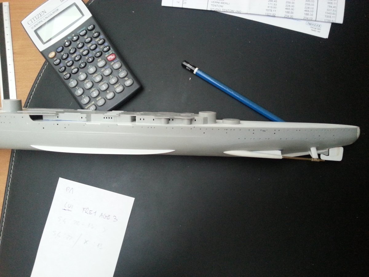

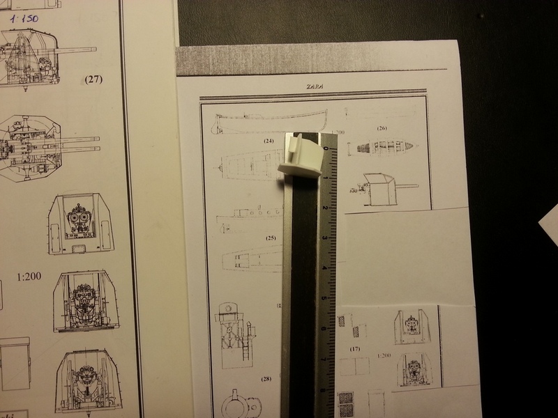

NEVER, EVER assume the scale of a drawing is correct!
I was using Pola Morskie templates as a guide for my ship and rescaling them in 1/350 as a guide for the pieces to rebuild, but after several attempts I was unconvinced because of how the shield I was building as a Vacuum Forming template was coming out. Unfortunately, very small objects can differ by just a few millimetres from the correct scale, so you have to trust your instinct as much as you can.
I spent the whole afternoon trying to figure out what was wrong, but in the end I came to the conclusion that the blueprint I was using and which were labelled 1/200 were in fact more or less 1/150 drawings, and this "JUST" for the shield I was trying to recreate. The rest of the elements in the blueprint were correctly scaled. I obviously had checked the scale of the drawings using a couple of elements the measures of which I had as a testing bench, and the drawings seemed OK: this led me to the false assumption that, if some of the drawings are correct, then everything they put in them had to be as well.
The lesson is: always double check with the real thing, in photo or directly if you can, and you will save yourself several headaches.
Lesson learned! :Oops_1:

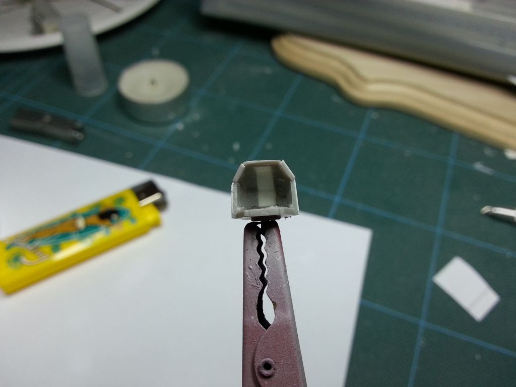

Here is a long overdue update:
The Chinese Ass-hole on e-bay stole my money and never delivered the vacuum forming machine I paid for (97€ damn him!).
I tried building a Copper foil turret from a 70's Polish review with a Pola 1/200 paper model plan, but it ended up having an unconvincing shape.
In the mean time I tried some prehistoric vacuum forming technique by pressing the master on a softened plastic sheet across a shape made in plywood but the thin master did not withstood the heat an got helplessly deformed.
Now I'll try with silicon gum and resin albeit I have no idea on how to anchor the master in order to build the silicon mould and then pour the resin in.
If everything else fails I'll try finding someone with a 3D printer hoping to get somewhere with the damn gun shield.
here are the pics of the second master (the right side need some trimming but glue was not cured enough to proceed):
