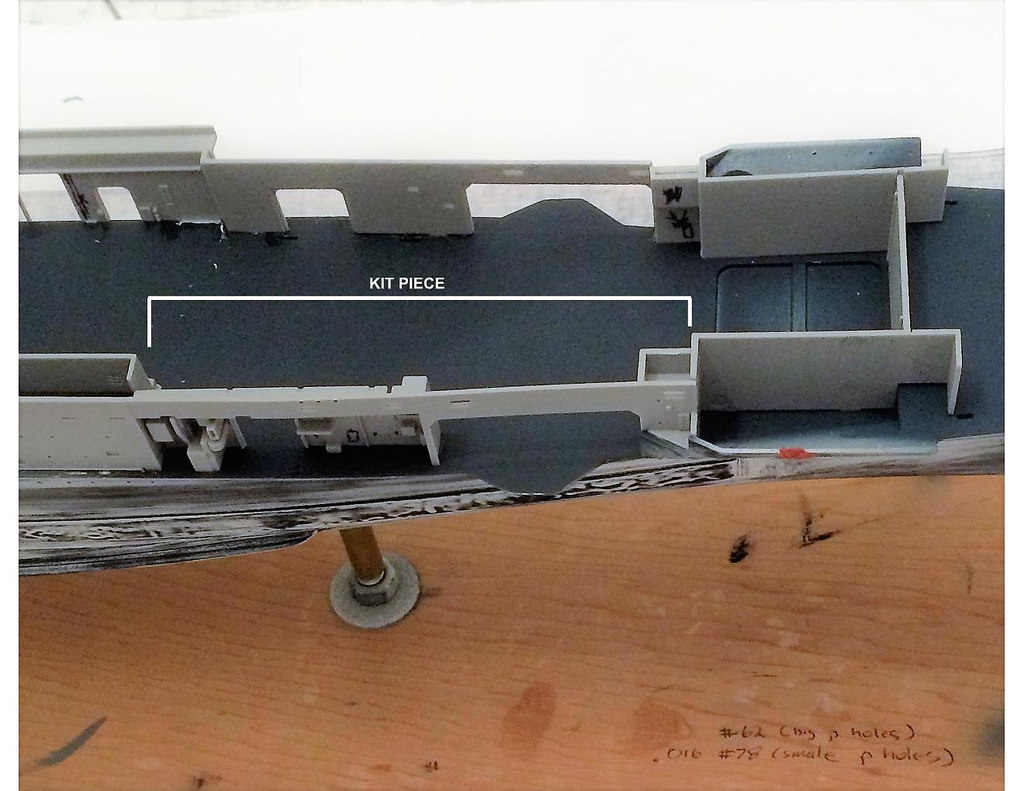

While piecing all this together, I found the kit rendering of the gallery deck (running from the island to the port side above the hanger) to be very odd. The gallery is an 8’ deep deck that fits within the flight deck truss structure. The captain’s quarters, admiral’s quarters and various other ship support spaces are here. To model this, Merit created a solid flat box piece (8 scale feet deep) that is glued between the island structure and port side bulkhead. Then curiously, they molded the walls (that are supposed to be inside the gallery deck) to the bottom of the flat box so they hang down (another 8 scale feet deep) into the hanger.
Aside from not having any reason to do this, it makes the overhead hanger space too low at this point with walls hanging from above.
For fun, I sawed them away and put them inside the box like they should be and set them next to the plans.
I'm going to replace this piece because the whole assembly doesn't make sense.
