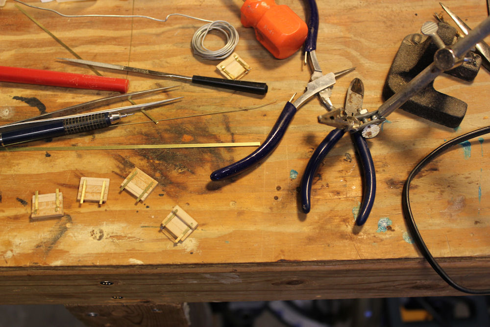

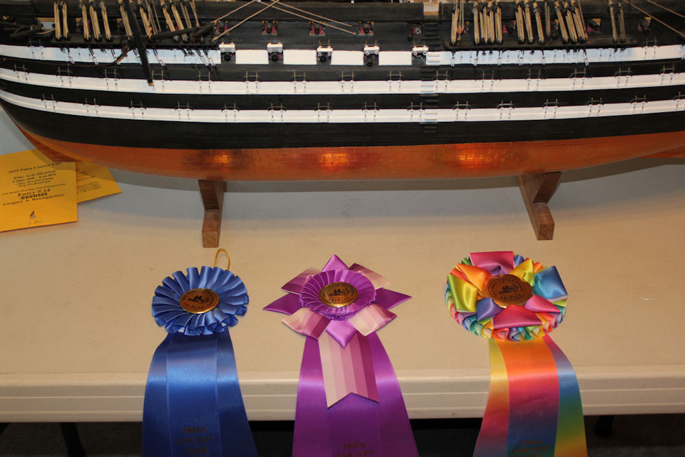

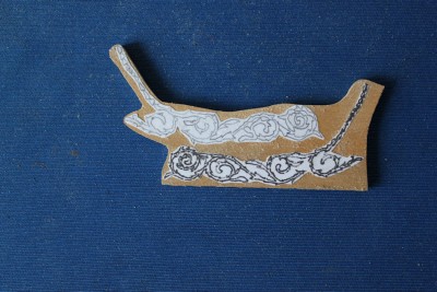

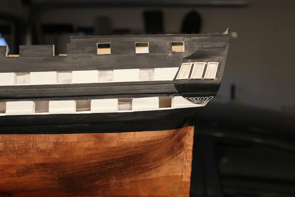

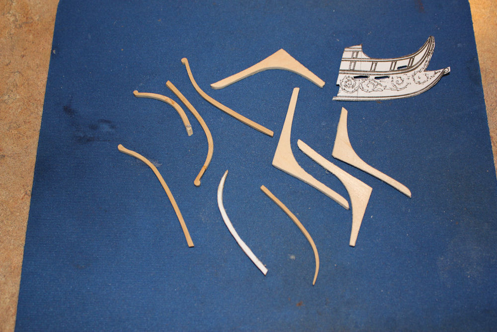

Sorry it has been so long since my last post, been busy, but now have a lot of stuff done. The Pima county fair was April 16 to 26th and i entered my ship in the fine arts non professional category. You can see the ribbons i won, including best of show. I demonstrated model ship building all 10 days for 6 hours each day, got a LOT done! As you can see, all the gun port doors, the hinges on the lower gun port doors, and the middle deck gun port doors which are split and have a hole for the barrel. I made a dozen or so of the hinges, a lot more to file and cut from 1/64 x 1/16th stock. I am getting the windows framed up and the mullions in them, curtains are installed. Also. working on bow scroll work and framing.

I should have mentioned that the ship I entered into the fair was my first scratch build, the USS Pennsylvania 1837, not this build.

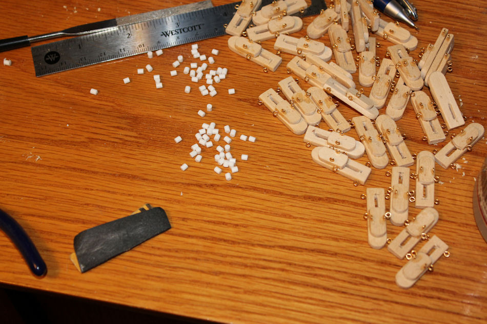

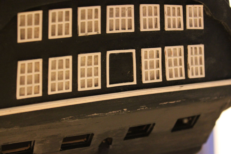

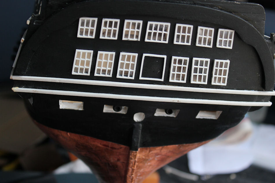

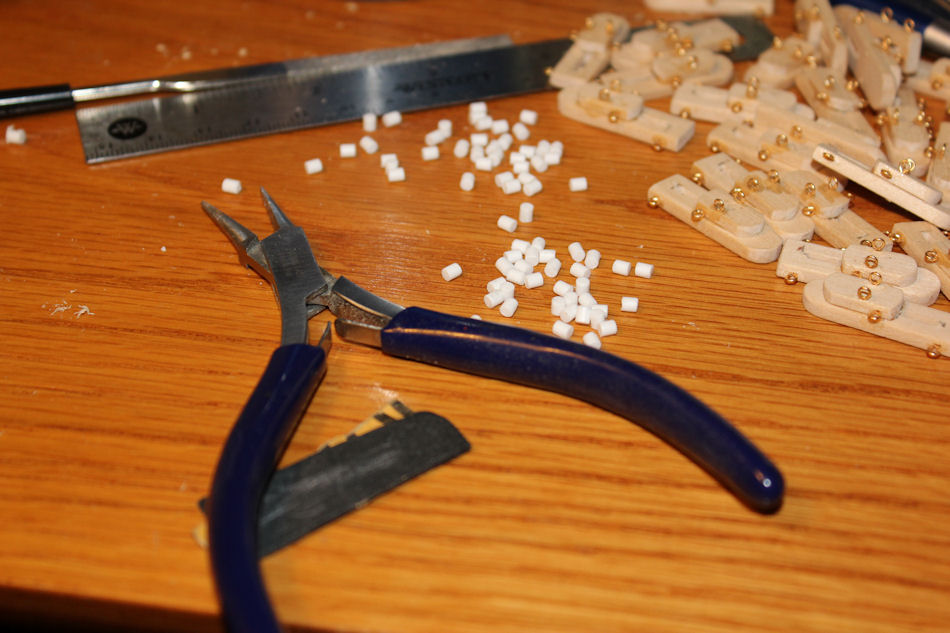

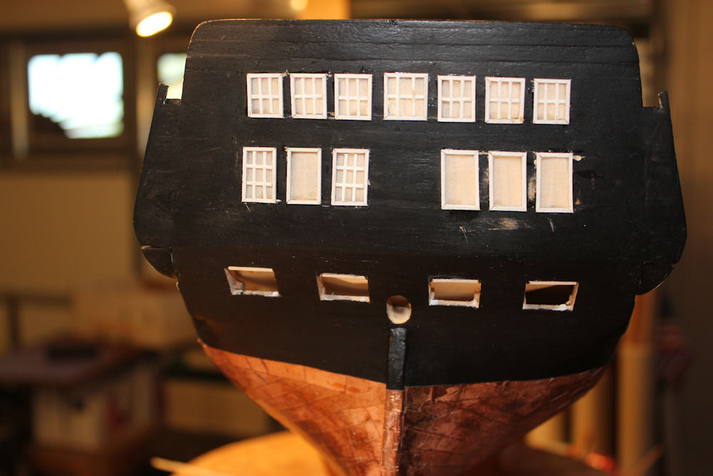

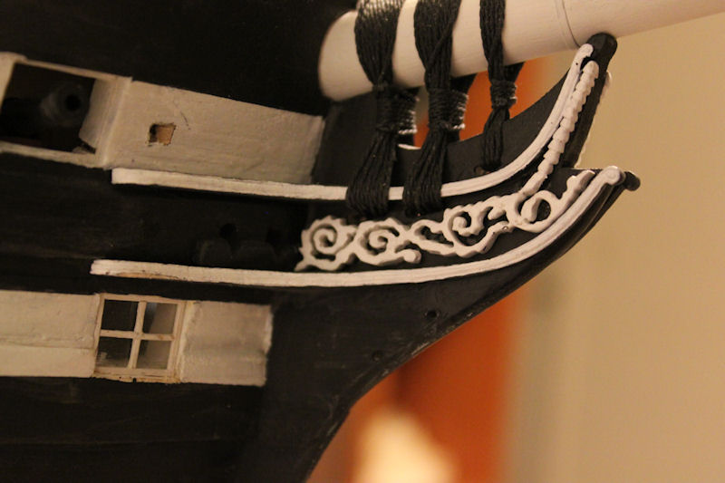

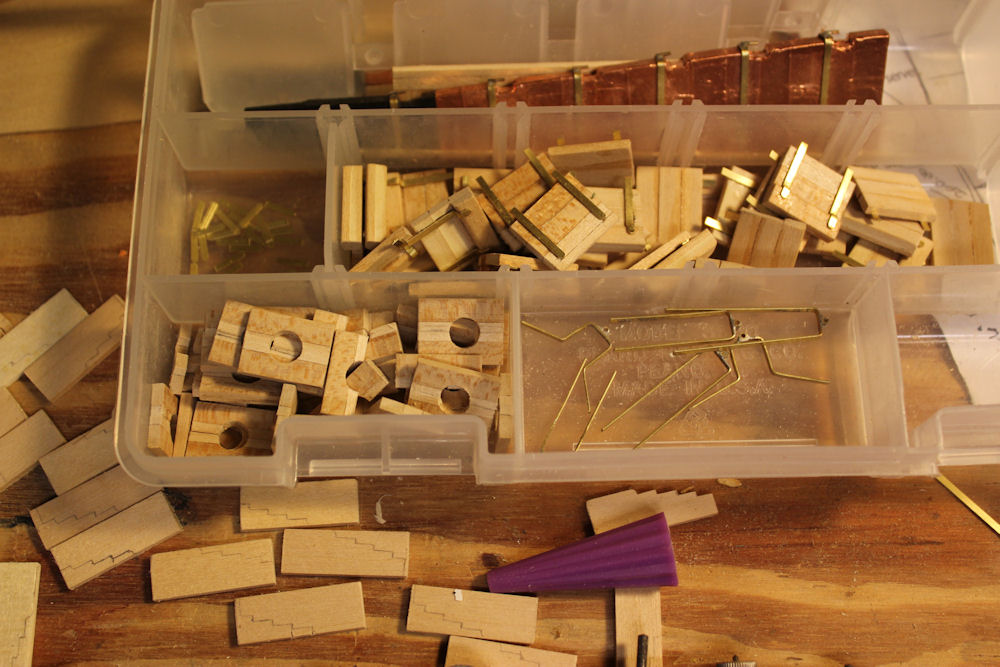

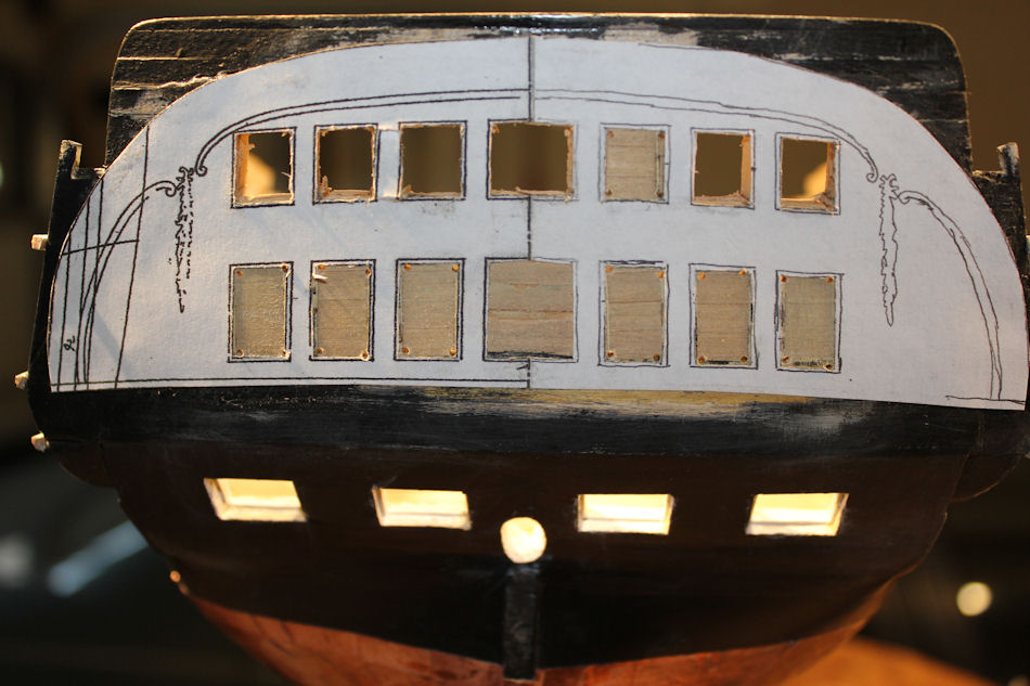

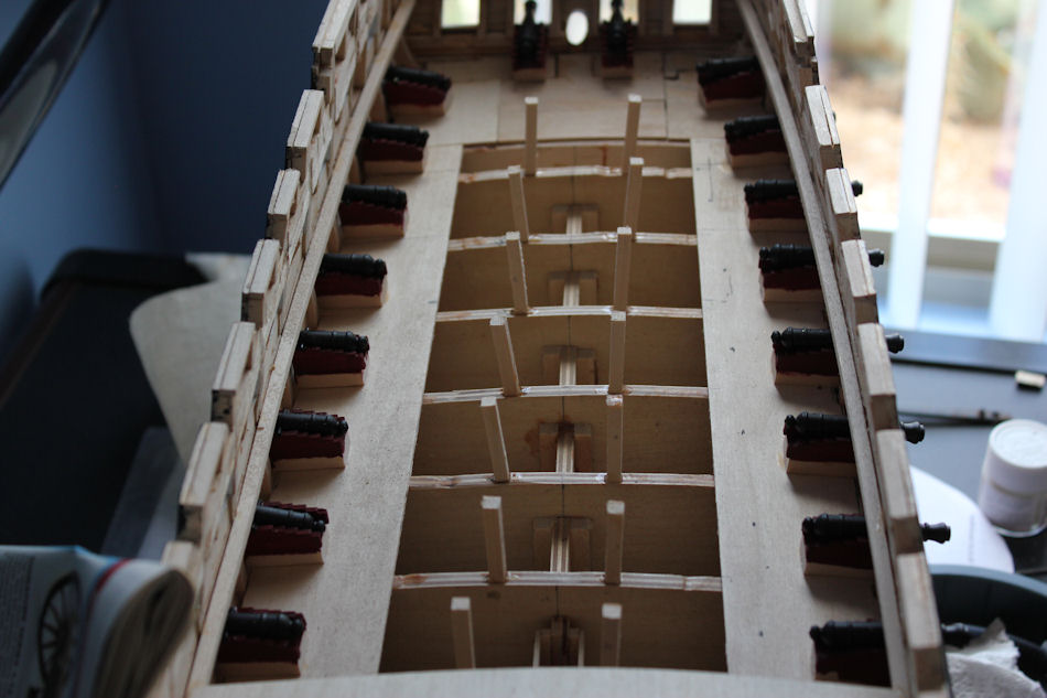

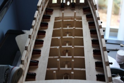

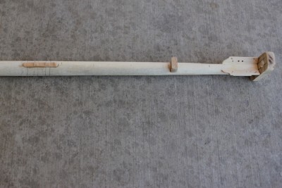

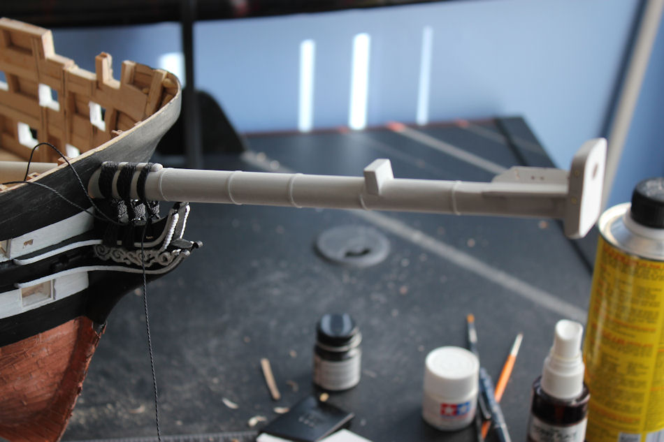

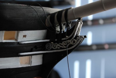

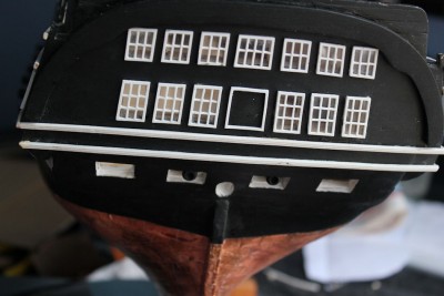

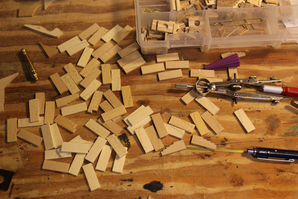

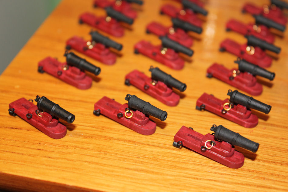

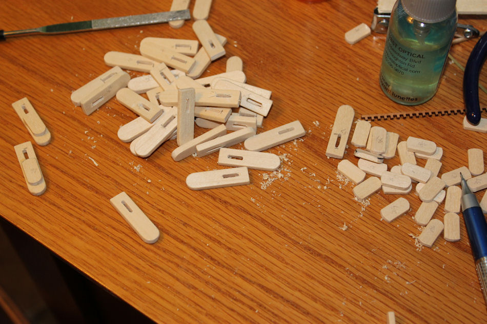

since son moved out a few months ago, i have his room to work in when it is hot in the garage. redoing the windows strern and quarter galleries, was not happy with first attempt. put main gun deck guns in, made bow sprit and a lashed it down. made bow decorations and hawse holes. Made carronade carriages. I am now making blocks for carronades. And installing second gun deck.

yes, block making can be wearisome, but, I make them sitting on the couch watching tv, slowly forming each one with a 2 inch round and half round file and a small needle nose pliers to hold the block. i will need to order more boxwood from my supplier thou, running low. I seems eweird that it is coming along so fast, I will be making the masts before the end of September at this rate. :woo_hoo: :woo_hoo:

I have run into something of a conundrum. I Am getting to the point where I will be installing the cannonades on the spar deck. However, the Chapelle plans for the Columbus show a gun port height of 3 feet, whereas all the plans I have seen of 32 pounder cannonade show a height if about 3'8" from the bottom of the casters to the top of the max diameter of the barrel. Chapelle's book also shows a cut away view of the gundecks of the Delaware that give a much higher gun port dimension for it's spar deck cannonades. I have made all of my cannonades as you can see from previous photos, but, Once I cap the spar deck gun whale, the cannonades I made will not fit. I suspect that the plans of the Columbus spar deck gun ports is incorrect, and, I believe I will deepen the gun ports to fit the cannonades I made,
What do You guys think?

been a long time, made a major mistake on port side, lower and middle gun decks were almost 3/16 inch to far apart, had to redo entire side, I was just so depressed, I just set it aside, and then about 2 months ago I started re planking it and relaying deck. It is back to where it was. making spar deck furniture now, will post photos this week end.

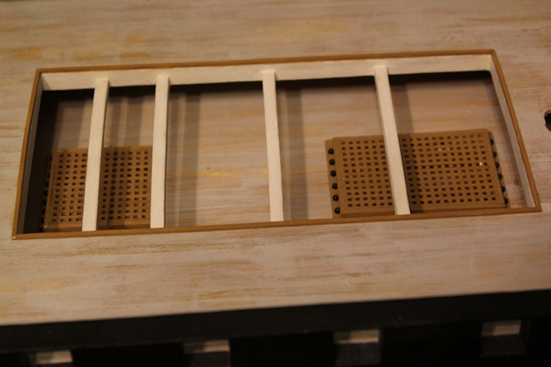

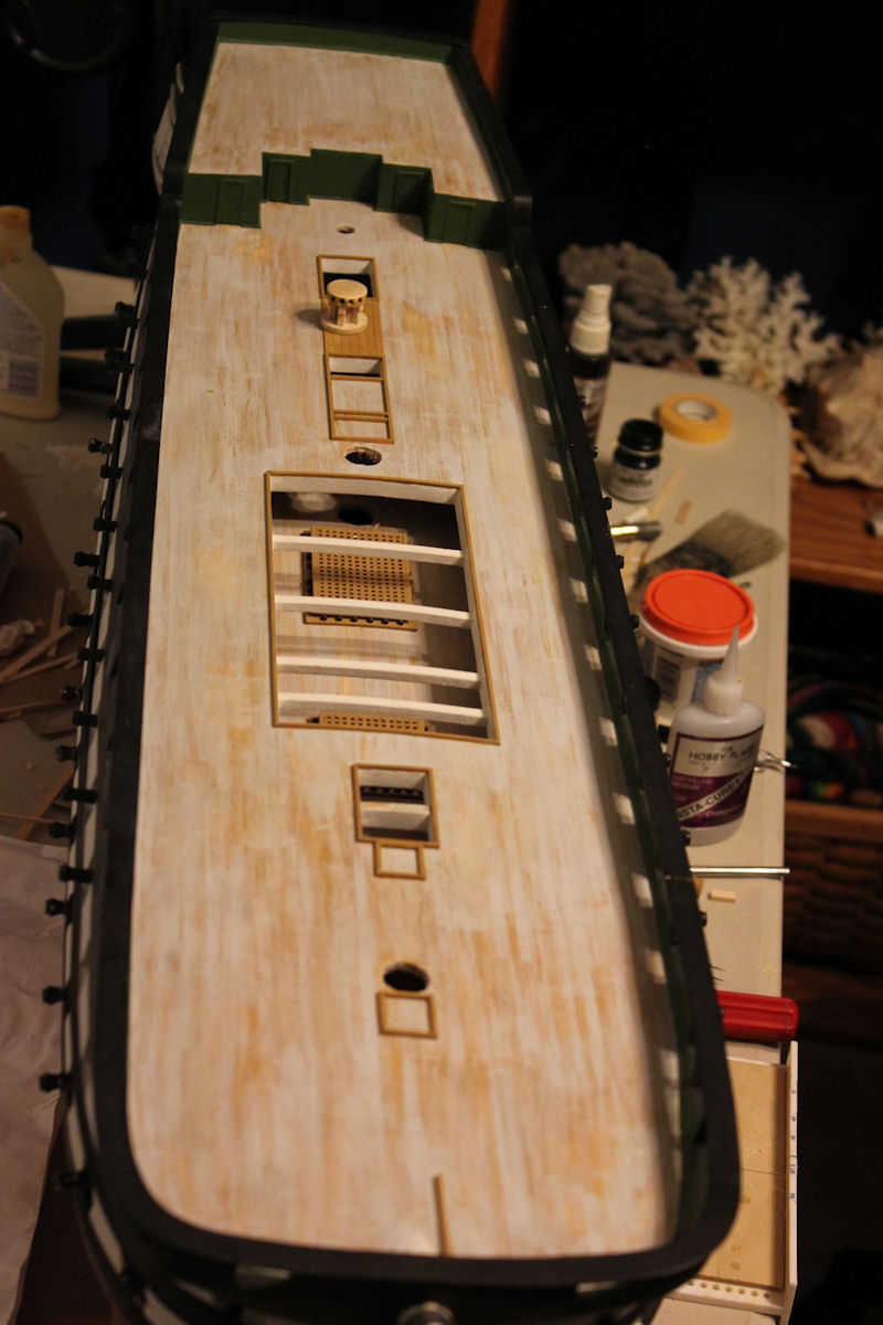

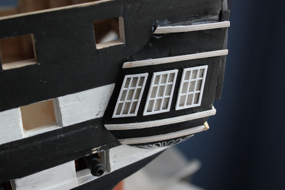

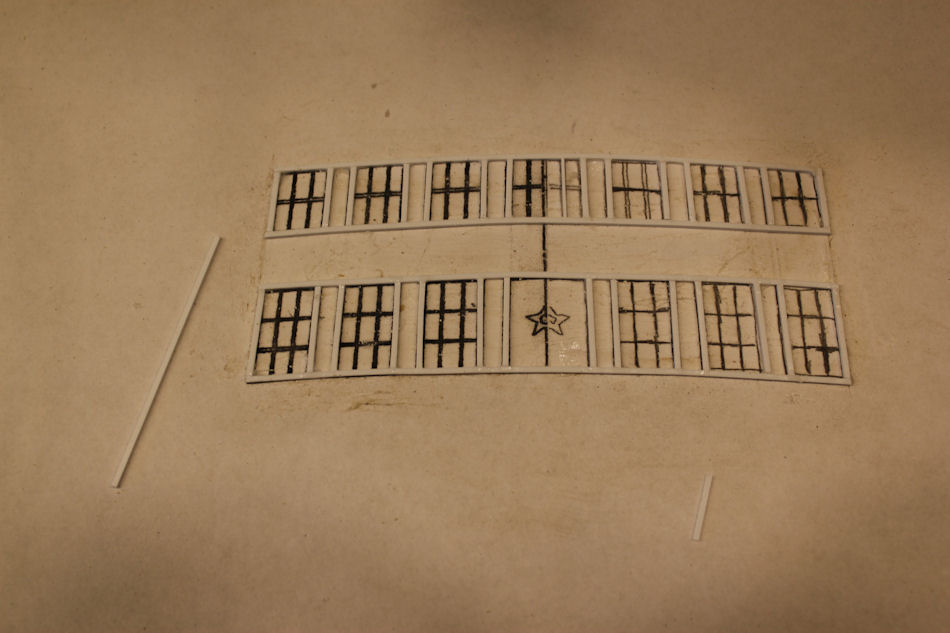

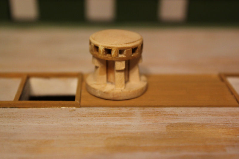

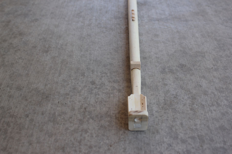

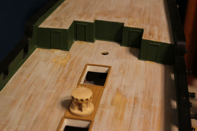

Here are a few photos. The capstan is a work in progress, paint needs touch up here and there, the back windows have been redone.
