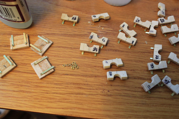

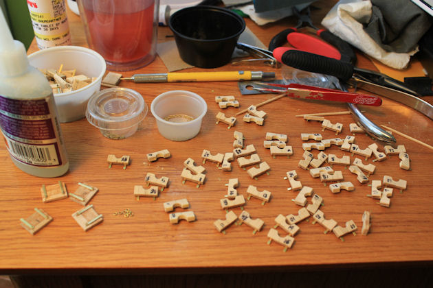

I have a little build station on an end table next to my couch where I sit with my leg up. I constructed all of the half doors and the hinge straps from here. I super glued all the straps to all the doors, then soldered the hinge pins to the the ends of the straps. The heat melted most of the straps off ans I had to re glue almost all of them over. I Used a fresh bottle of super glue and they do stay on better than before. The last photo shows the straps with pins soldered on, after the heat melted the glue.

These plastic side hinge pin pieces should be the last bits to glue onto the gun doors. That is 4 each for the 32 double doors and two each for the 34 sigle doors, you do the math, I would be to intimidated if I actually knew how many it was, lol!

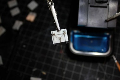

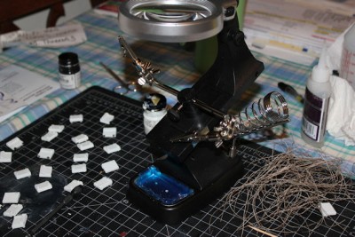

Painted doors and hinge ends. now I have to seize the lift ropes to the eye bolts lots of tedious time consumming work, sigh, I LOVE IT!
Also my new toy!

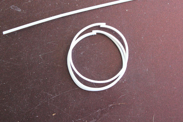

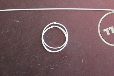

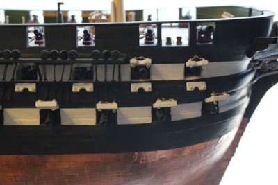

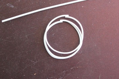

Now that my ankle is better and I am out of my cast, my "winter" outdoor chores need to be addressed. So, my ship modeling has slowed, but not stopped. Before I put the gun port doors on, some of the ports have a rain gutter if you will, above them. I am trying to bend polystyrene into a circle and some how heat it enough that it retains that diameter without melting the plastic. Tried a hair dryer with some success but it seems to need justa little more heat, perhaps running a soldering iron around the outside edge? What do you guys think?

Boiling water is the traditional way to shape styrene. Just wrap the styrene around a suitable form (use a thread or rubber band to hold it), dip in the boiling water, and let it cool. It should hold its shape.

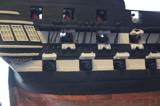

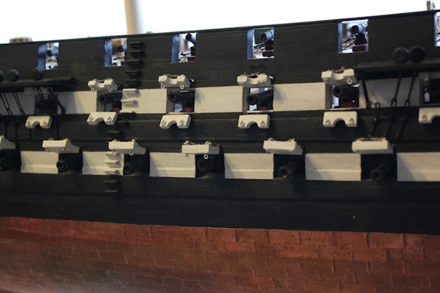

The hot water method worked great. Finished Port side gun port doors and rudder. working on Starboard door now. Will be making lower masts and tops in the coming days

Looking great, as always!
In the British navy, the interior was traditionally painted red (masking blood is the supposed reason?) including the inside face of gunport covers. Did the American navy use a white interior color scheme?

Yes it is white, The British also changed to white Under Nelson to white. I have read the red was to mask the blood splattered on the walls in battle. Nelson said something like the not seeing the blood diminished the sacrifice the sailors gave in battle

great chequerboard effect- !
--- a lot of work there ....
Bravo!

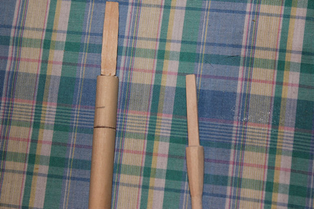

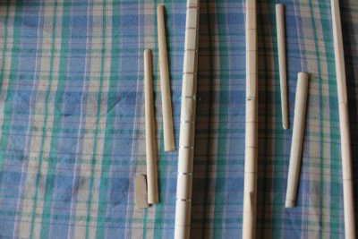

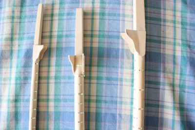

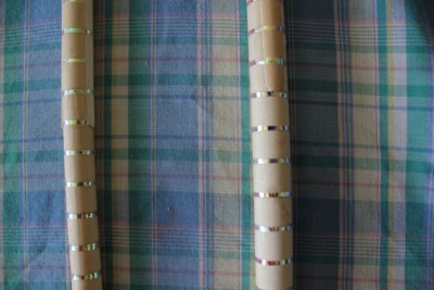

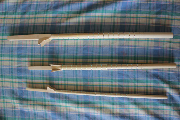

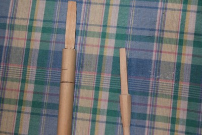

I have been making progress on the masts and to some degree the Tops.

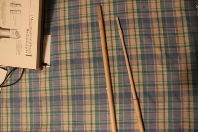

was not quite done yet the fore and main top masts are just getting roughed in. The fore top mast tapering in the lathe went like I had never taken a break from doing the Pennsylvania! I surprised it went so that it went so well the first try!

And,no,the masts are not bowed, that is just an effect the camera angle gave them, just in case anyone noticed and had questions.
