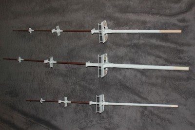

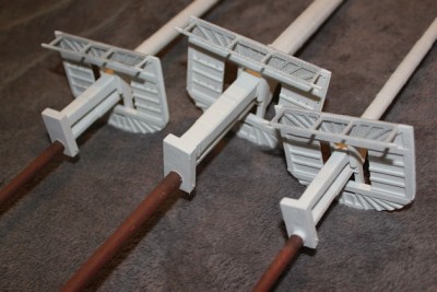

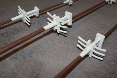

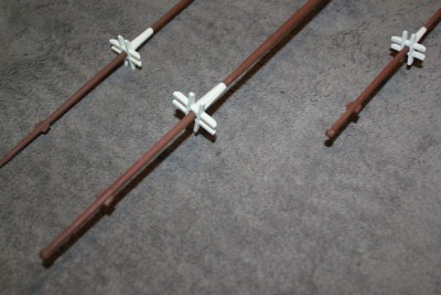

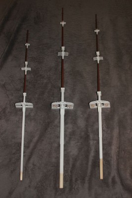

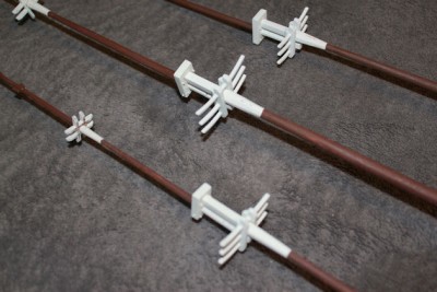

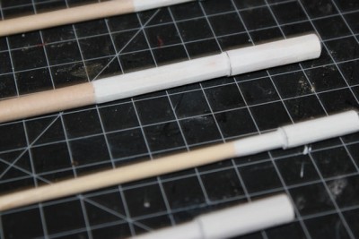

Working on upper masts, tops and cross trees photos show work in progress NOTHING is completely done yet, soon though!

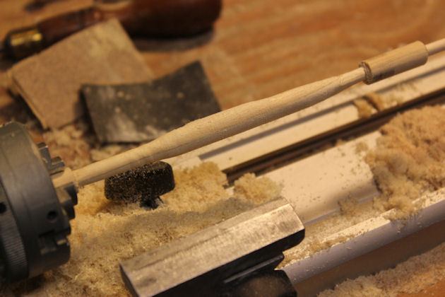

The topgallant/royal masts are one piece, so, I only have one section clamped in at a time, while the other half juts out the chuck end through a 1/2 inch hole in the housing. Only 8 inches or less are worked on at a time so the bending is minimal. Plus, these dowels are hickory. I like hickory for masts and yards for the very reason you ask. They bow very little so I can press down pretty good with my 8 inch file. Hickory does not carve very well with standard carving gouges against the grain so I have to be careful which side I press the gouges against.
But, most of the shaping is with files and sand paper, I only rough it in with gouges.

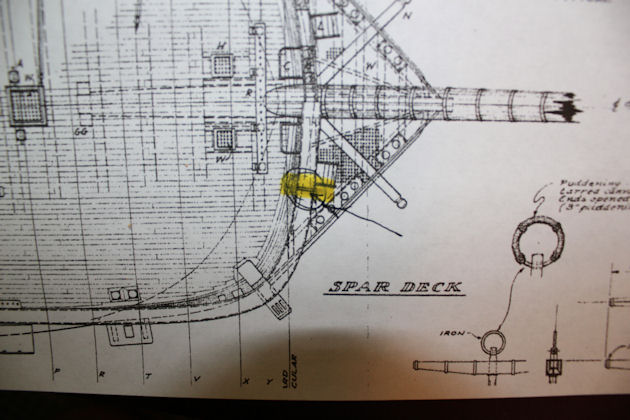

I am allllmost done with all the mast sections, tops, caps, and cross trees. A little more paint and I will be posting the results. However, before I get to much further, I need to put in the hammock "netting". In the 1830's the hammock storage area on the spar deck wale cap was covered over with vertical slats. I cannot be certain, but, I think it is probable that the Columbus was done this way as an "upgrade" at one point. Peace time "decoration" to make the ship more "tidy" was not uncommon.
Soooo, I have posted a photo or her bow with an arrow pointing to where I believe the Hammock netting stopped at the bow. There is a break at the ships' side stairs, and it ends at the raised poop deck rail. Any one disagree with that?

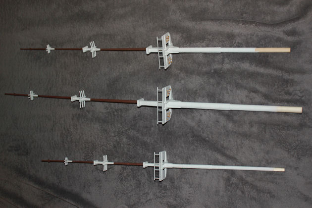

Except for one area under a cross tree, the masts are done. Working on last two bow sprits. And etching planks on hammock surround. Wish I could drag and drop photos like the other modeling site I am on allows.

wife's parents are moving in with us, been busy preparing rooms for them, so not much getting done on ship until they are settled in. yeah, I know the ladder rung on top is crooked, I'll fix it soon. I get along great with them, so, no need to send condolences, lol!

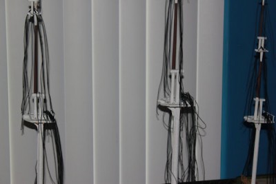

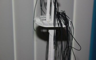

here is what I have done so far though, will be seating masts and remaining two bow sprit sections next. Also I am making rope for the shrouds.

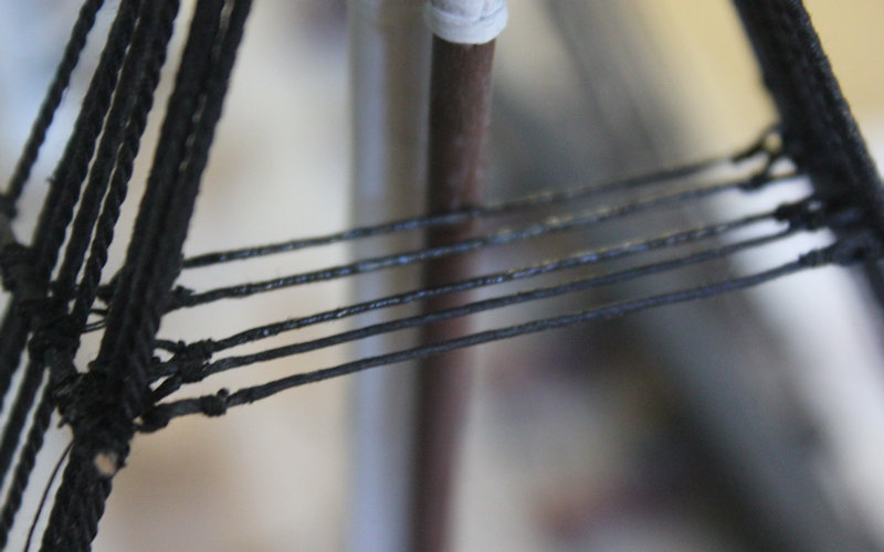

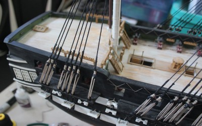

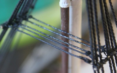

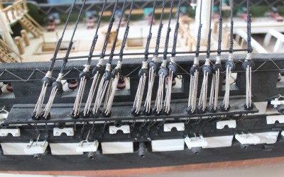

I have some photos to share. The Catharpins are a beach to rig.
