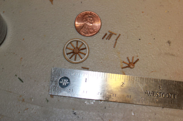

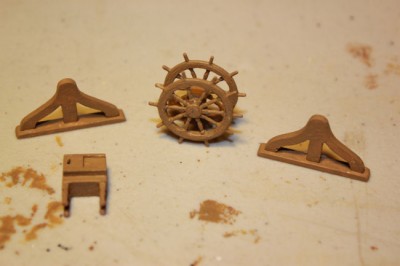

Damn, i m gettin old! All that work on the ship wheel and then Here I notice it has eight spokes instead of the ten it is suppose to have, cuz only 8 will fit around the rim of the center piece, have already made 20 smaller ones, so the wheel will look different when next i post photos, lol!

Ouch! You know, though, there's a perfectly acceptable tradeoff between accuracy and scale. For example, rivets on airplane models are often oversized and out of scale. Despite this, the rivets convey a structural item that is present even if the model has them overscale. Most people seem to prefer to see the rivets rather than adhere to strict accuracy and scale. Or, another example, I've often portrayed the supporting grid work under platforms by simplifying it to convey the idea without having to try to construct something that is totally accurate but beyond my abilities for the scale.
That's a long winded way of saying that your wheel is perfectly acceptable in that it conveys the construction technique and appearance even if the exact number of spokes is off. Of course, if you prefer to redo it for greater accuracy then by all means do so. Either way, you're looking good! :thumbs_up_1:

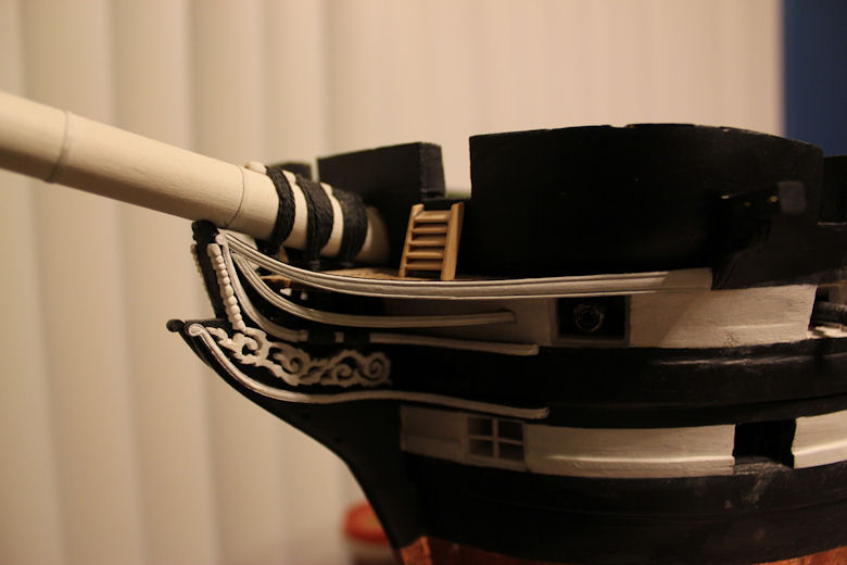

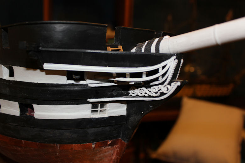

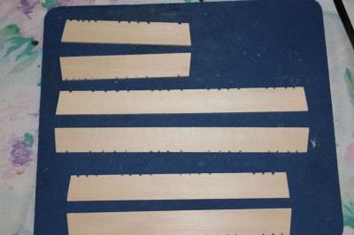

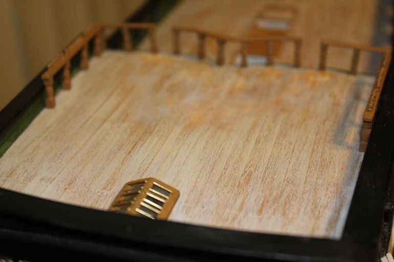

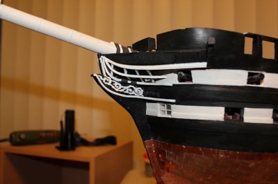

ok, been at it slowly, the vertical head timbers were very frustrating. I am drilling the holes in the pin rails now, as I will soon be finishing up the deck furniture install so I can get going on the carronades. lots of hole drilling in my future for all the eye bolts for the carronades!

as ever--very fine work!
:thumbs_up_1: :thumbs_up_1:
JIM B :wave_1:

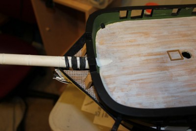

Very nice! I know the rails are difficult with the compound curves but you've done an excellent job on it. I also like the grating. Very sharp and well defined. I don't know American ships of the line that well - are there seats of ease in the head?
The bowsprit penetrates the deck. Is there some type of seal or weatherseal around the penetration of the deck or does the planking just butt up against it?
I look forward to more!

Yes there is a weather seal around the bowsprit where it penetrates the deck, as well as a small air scuttle on either side of it that I have yet to make/install. There are a few things around and near the poop deck as well. and, there are seats of ease in the beak head grated area, again, not quit there as to make/install, I am doing the pinrails around the fore and main mast, as well as making the belaying pins from scratch. Which reminds me, are the actual pins 18 or 16 inches long, got to be at least that to hold the coils of rope they drape over them, right?

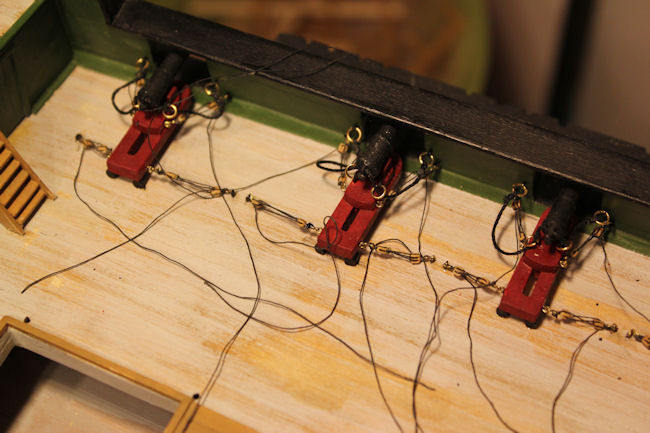

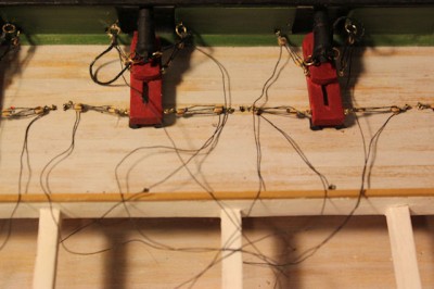

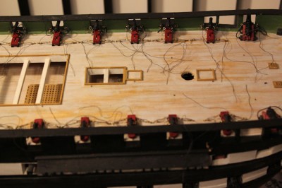

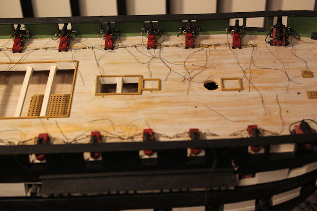

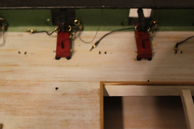

Here are the carronades all rigged, just need to tie off the ends. Then I move on to deck furniture all made but ships wheel, so should go fast.

Great detail with the rigging on the guns. Love it!

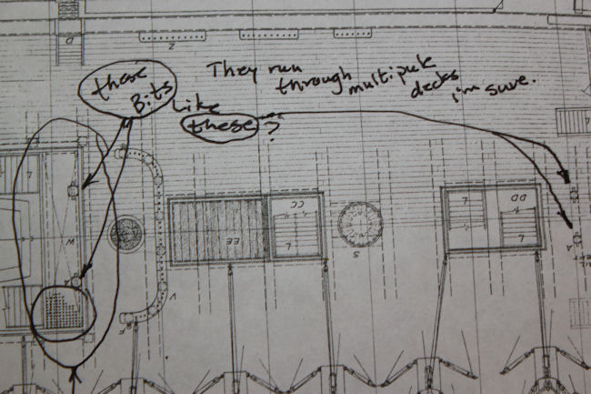

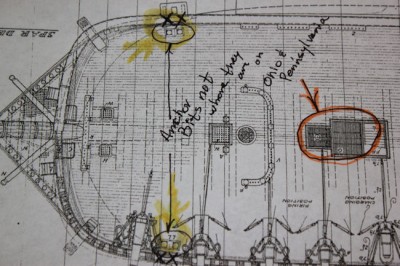

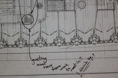

Now that I am installing the deck furniture on the spar deck, I have noticed a few things now that I look closer that I did not really notice before. Just foward of the main mast is a section of grating that appear to have 2 bits projecting out of it as they do near the fore mast. As the ladders seem mounted in front of this section of grating am I correct to think that this grating is more or less battened down all the time? And I will need to make a frame work under that section of grating to make it appear as if it is holding that grating in place.
At the bow where the stove pipe pierces the spar deck, the covering appears to be something other than the normal wooden grating. Both the small section and the larger one behind it seem to be a metal mess or something fairly fireproof so the heat in the galley stove does not set it afire? That sound right to you guys? All so, the anchor bits where the wales are pierced for the anchor fluke seem to be more in board than on other large US warships such as the Ohio and the Pennsylvania who's bits are part off the hull and appear where I have marked them with a black "x" I am lead to believe this is just a variation between certain ships.
The framing or the spar deck openings need to be widened as they are too skinny to mount brass posts to for the ladder railings. I will do this as I breathlessly await your sage answers to these questions.

I am going with what I suspect is the case, since no is actually disagreeing with what I am postulating. Making good progress, it is looking real nice if I do say so myself. Photos in a few days or so.

I have nothing definitive to offer so take this for what it's worth ...
The bits in front of the main and fore masts appear to be the riding bits. The small line through the bit seems to be the barracuda which was a metal pin. The bit and barracuda were an evolution of the older riding bits for anchor cables which consisted of bit/crosspiece/standard. The newer arrangement was an evolution intended to handle anchor chains when chains replaced rope cables.
If the above is correct, the bits would, indeed, have extended down a couple of decks and been bolted at each level to beams in order to ensure the needed strength and stability.
Goodwin has a drawing of such an arrangement and a photo of one on Foudroyant.
As I said, this may or may not be what you're seeing on the plan but they're in the right place and I don't see any other item that would fill the purpose.
As far as the "anchor bits", I don't know what to make of those. I've not seen anything like that in any English ship. Could be a purely American variation?

I thought the spar deck furniture would be a snap, forgot about redoing ships wheel from 8 spokes to 10, Five trys to finally get them all roughly the same length and spaced around the outer wheel. I have the binnacle done too. Also the ships bell tower and the hatch behind the stove pipe covered. Working on railing for steps coming off the quarter deck, and the platform and rope ladder fron the wale steps, over the wale cap and down to the deck, which is just a rope ladder. Also the rope railings on the ladders I do not have enough brass posts to "fence" off the Main hatch. Might leave it off like I did on the Pennsylvania.
